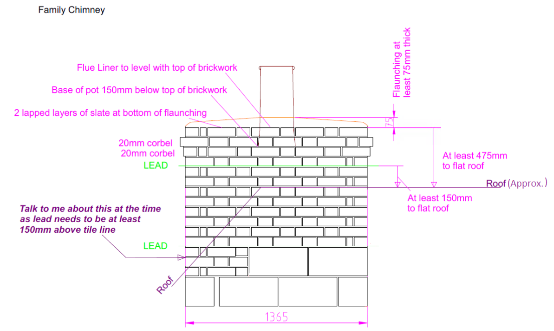

MortarThePoint Posted March 22, 2021 Author Posted March 22, 2021 Well this is what I've produced as drawings:

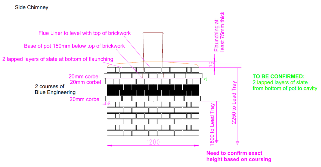

epsilonGreedy Posted March 23, 2021 Posted March 23, 2021 Interesting to note we both plan to use blues to visually enhance the impact of the corbel. My pattern going up will be: +20mm corbel Blue +20mm corbel Regular brick Regular brick -20mm corbel Regular brick Flaunch
MortarThePoint Posted March 23, 2021 Author Posted March 23, 2021 (edited) 1 hour ago, epsilonGreedy said: Interesting to note we both plan to use blues to visually enhance the impact of the corbel. My pattern going up will be: +20mm corbel Blue +20mm corbel Regular brick Regular brick -20mm corbel Regular brick Flaunch That will look nice. My inspiration on it was reading that two layers of engineering bricks could be used as DPC at the top of the chimney. I'm not so much using it as that but it made me think what it would look like and I think it's nice. A note of caution on blue engineering bricks though. Their colour can be very different manufacturer to manufacturer and indeed batch to batch. I loaded about 10 into the boot of the car before I really noticed they were almost purple. I like the type that when dry have an almost metallic grey shine (Wienerberger Terca). Second note of caution if you aren't aware, make sure you keep them dry before laying as they are a pig if wet. If I were to do it all again, I'd use blue engineering bricks at house DPC level as well. Another note: you'll be getting solid engineering I presume, not perforated. Edited March 23, 2021 by MortarThePoint
epsilonGreedy Posted March 23, 2021 Posted March 23, 2021 1 hour ago, MortarThePoint said: That will look nice. I hope so. For others wondering about this, the idea is that a dark course of bricks under a chimney corbel (flare) will trick the eye into thinking the corbel band at the top of the chimney is bigger. 1 hour ago, MortarThePoint said: A note of caution on blue engineering bricks though. Their colour can be very different manufacturer to manufacturer and indeed batch to batch. I loaded about 10 into the boot of the car before I really noticed they were almost purple. I like the type that when dry have an almost metallic grey shine (Wienerberger Terca). Yes I had different deliveries for the garage and main house below dpc facing bricks and noted both colour types were delivered. Just popped my head outside and the colour difference is not noticeable between the two adjacent structure. My main bricks are buff multi so either colour will work at the top of the chimney. 1 hour ago, MortarThePoint said: Another note: you'll be getting solid engineering I presume, not perforated. Yup I will ensure they are proper solid engineering bricks for the chimney. Got the perforated type in the main house below dpc, I nearly sent them back when delivered but have forgotten about it now. Regular F2s would have been ok below dpc which means the perforated blues are not a specification fail but they don't seem like the real thing however. 1 hour ago, MortarThePoint said: If I were to do it all again, I'd use blue engineering bricks at house DPC level as well. It has worked out well for my house design with buff multi elevations. I nearly went for red engineering bricks but then another self build neighbour chose that combination, so my dark dpc band helps mix up the overall picture of the 3 house estate.

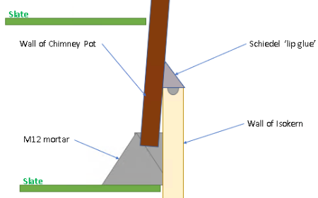

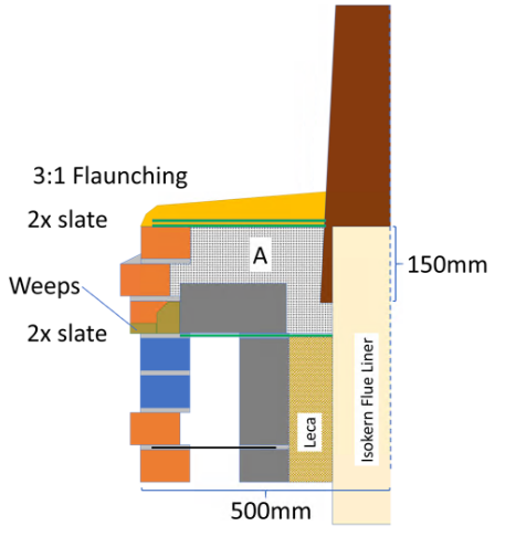

MortarThePoint Posted March 24, 2021 Author Posted March 24, 2021 (edited) Here's a section through the chimney at its top showing the slate etc. I'll ask them to angle the slates ever so slightly to fall away from the centre of the chimney, but that may be easier said than done. The 'A' labels what will be blocks cut and packed with stiff mortar. Edited March 24, 2021 by MortarThePoint corrected drawing corbel
PeterW Posted March 24, 2021 Posted March 24, 2021 Never seen slate inside a liner - pot is normally larger than the liner and you flaunch the inside too.
epsilonGreedy Posted March 24, 2021 Posted March 24, 2021 1 hour ago, MortarThePoint said: Here's a section through the chimney at its top showing the slate etc You are good at knocking up these diagrams, do you do this in your job? Re. the height of pot support, I make that 250mm including the flaunching. Is this amount of pot support recommended? I ask because it results in a lot of material up there that might hold moisture.

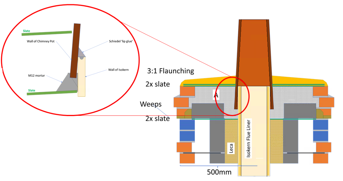

MortarThePoint Posted March 24, 2021 Author Posted March 24, 2021 1 hour ago, PeterW said: Never seen slate inside a liner - pot is normally larger than the liner and you flaunch the inside too. It is on the outside. My second image probably wasn't put into context well. It's a closer look like this:
MortarThePoint Posted March 24, 2021 Author Posted March 24, 2021 (edited) 32 minutes ago, epsilonGreedy said: You are good at knocking up these diagrams, do you do this in your job? Re. the height of pot support, I make that 250mm including the flaunching. Is this amount of pot support recommended? I ask because it results in a lot of material up there that might hold moisture. Thanks, I use two cheap tools QCAD and PowerPoint. Very different to the day job, but useful to convey the details. Yes, as conceived the pot is embedded by minimum 225mm. This is embedded 150mm in the cut blocks and mortar ('A'). Most of this is below the upper layers of slate though so will hopefully not get too moist. Edited March 24, 2021 by MortarThePoint

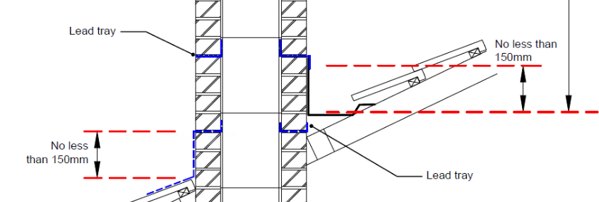

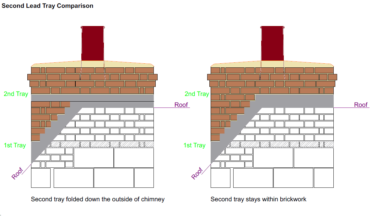

MortarThePoint Posted March 25, 2021 Author Posted March 25, 2021 (edited) I'm getting confused about the second lead tray on the other chimney now which is going in tomorrow. I have had both trays made large enough to extend out of the brickwork and lap up or down the brickwork by 75mm. I definitely need that for the first tray that is mostly within the roof space. On three sides of the chimney, that first tray will be lapped up the brickwork and on the fourth side it will lap down the brickwork. That puts the apron a brick course below the last bit of stepped flashing on the sides of the chimney. I've convinced myself somehow that the second tray is supposed to lap down the outside of the brickwork. However I have seen various diagrams online that seem to show it stopping at the edge of brickwork so not actually coming out and lapping onto the outer surface of the brickwork at all. Which is correct? I have drawn the two options below as viewed from the side of the chimney. It's a bit difficult to tuck the lead flashing in below the tray in the right hand approach. I guess the tray could come out wherever the flashing meets it, highlighted red here: Edited March 25, 2021 by MortarThePoint
MortarThePoint Posted March 25, 2021 Author Posted March 25, 2021 Have you had to work this out for your chimney @epsilonGreedy
epsilonGreedy Posted March 25, 2021 Posted March 25, 2021 (edited) 52 minutes ago, MortarThePoint said: Have you had to work this out for your chimney @epsilonGreedy I am not that far ahead. I thought I read in this thread or viewed a Peter Scholey video where he shows the tray with a short 35mm or 40mm upturn on three sides and a downturn on the main wall side. Jump to 4 minutes 35... https://www.youtube.com/watch?v=AAdcYazFIio In general I wonder if you are trying to create cover flashing out of the tray in error. This next PS video shows an independent rear gully cover flashing fitted over the back gully lead, note how it wraps around the sides and over the side step flashing. I doubt your lead tray flaps would do this so well. Jump to 6 minutes 50... https://www.youtube.com/watch?v=5lov8yAFI-I Thinking about your situation some more is it legit to tuck the top flange of the cover flashing under the full tray in the same brick course? We need an expert to answer that. Edited March 25, 2021 by epsilonGreedy
MortarThePoint Posted March 25, 2021 Author Posted March 25, 2021 7 minutes ago, epsilonGreedy said: In general I wonder if you are trying to create cover flashing out of the tray in error. This next PS video shows an independent rear gully cover flashing fitted over the back gully lead, note how it wraps around the sides and over the side step flashing. I doubt your lead tray flaps would do this so well. Jump to 6 minutes 50... https://www.youtube.com/watch?v=5lov8yAFI-I Thinking about your situation some more is it legit to tuck the top flange of the cover flashing under the full tray in the same brick course? We need an expert to answer that. Is there anything wrong with using the tray to form the cover flashing? There may not be enough lead to reach down 150mm though, probably just 75mm. This is from the LABC technical manual and looks to be showing the tray forming the cover flashing: I wondering is @PeterW knows if this is OK or if the top flange of the cover flashing can be tucked into the same bed as a tray.

MortarThePoint Posted March 27, 2021 Author Posted March 27, 2021 3 hours ago, PeterW said: wrap over is fine - bead of lead seal would help keep it watertight on the overlap Thanks. Do you like the approach of having it half lapped and half flush? Viewed from above, it means the tray has to be cut to this shaper where the green portion ends up embedded in brickwork and the orange portion sticks out to then get bend down over the flashing and back gully.
