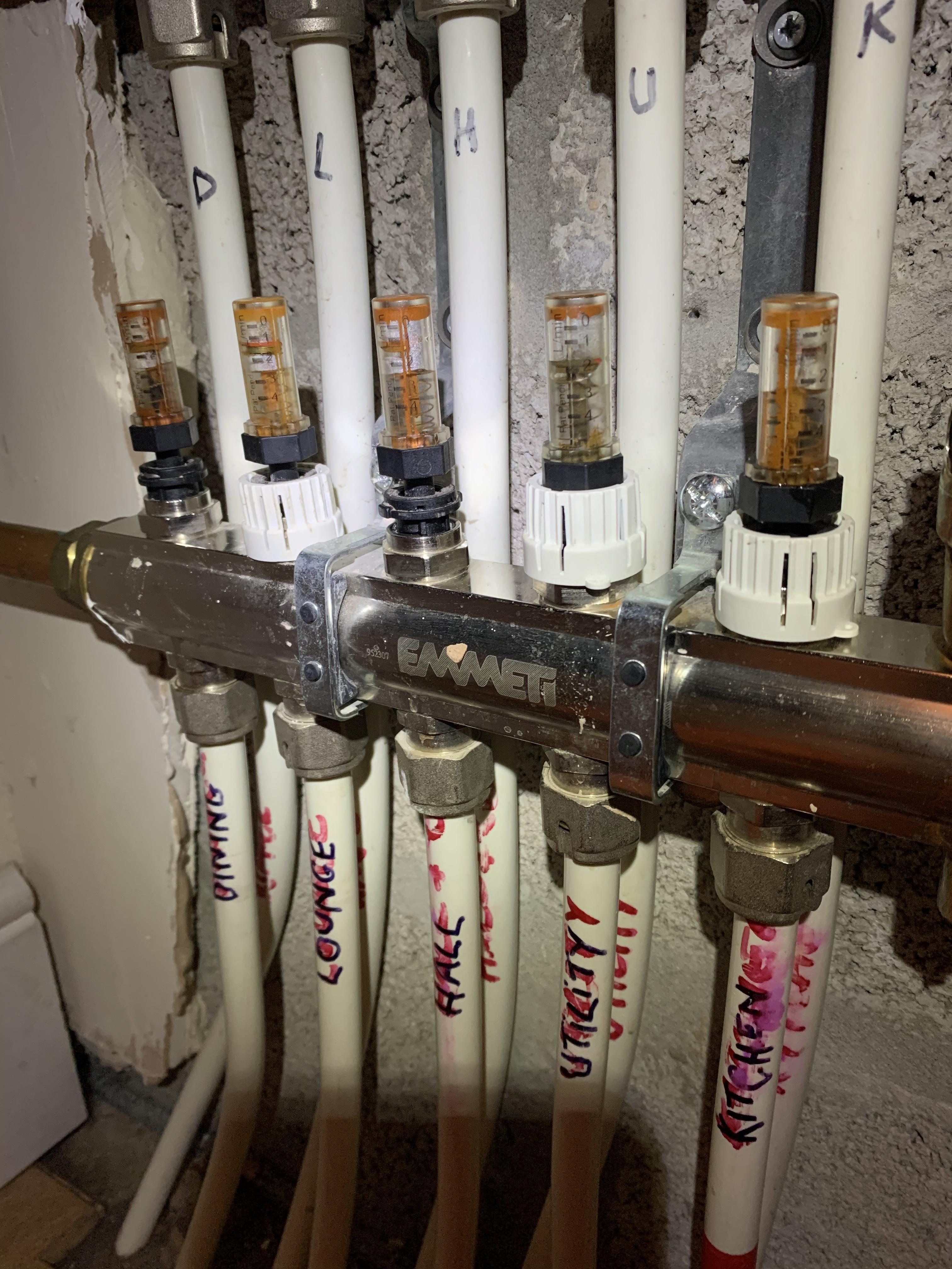

Chriswills Posted January 15, 2021 Posted January 15, 2021 Hi, my first post in here. Hello all. I have UFH downstairs with 5 zone controllers. I have just cleaned all the plastic tubes to see what the flows are and had a play with them. Seems I can’t turn the flow up anymore than 2l/min and they are all fully open. Is this normal and what should they be?
ProDave Posted January 15, 2021 Posted January 15, 2021 That's probably about right. A faster pump speed would give more if you need it but may make it noisy.

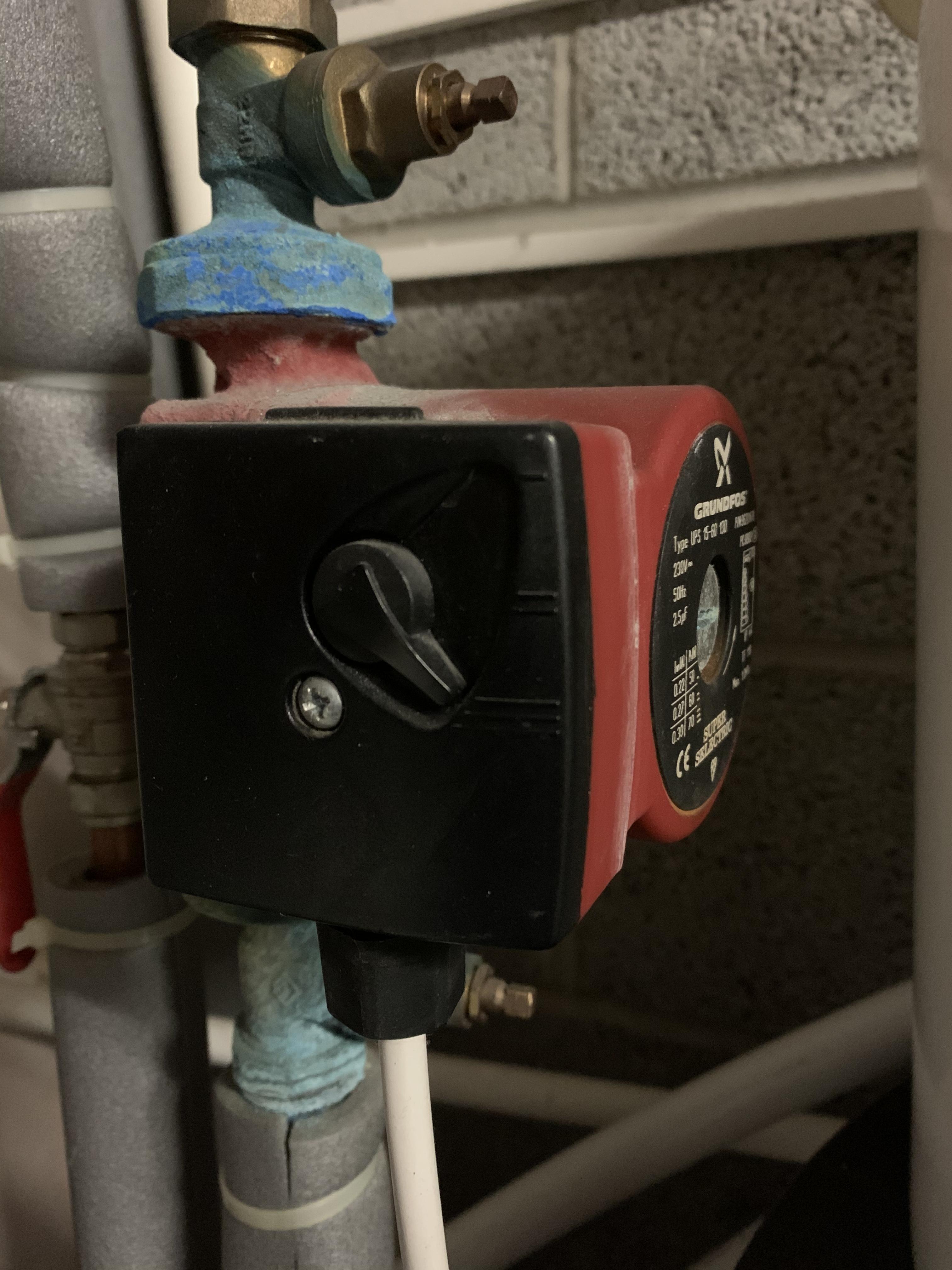

Chriswills Posted January 15, 2021 Author Posted January 15, 2021 Thanks. I have grundfos pump but it’s not on the manifold it’s by the buffer tank on speed 3. Is that OK?

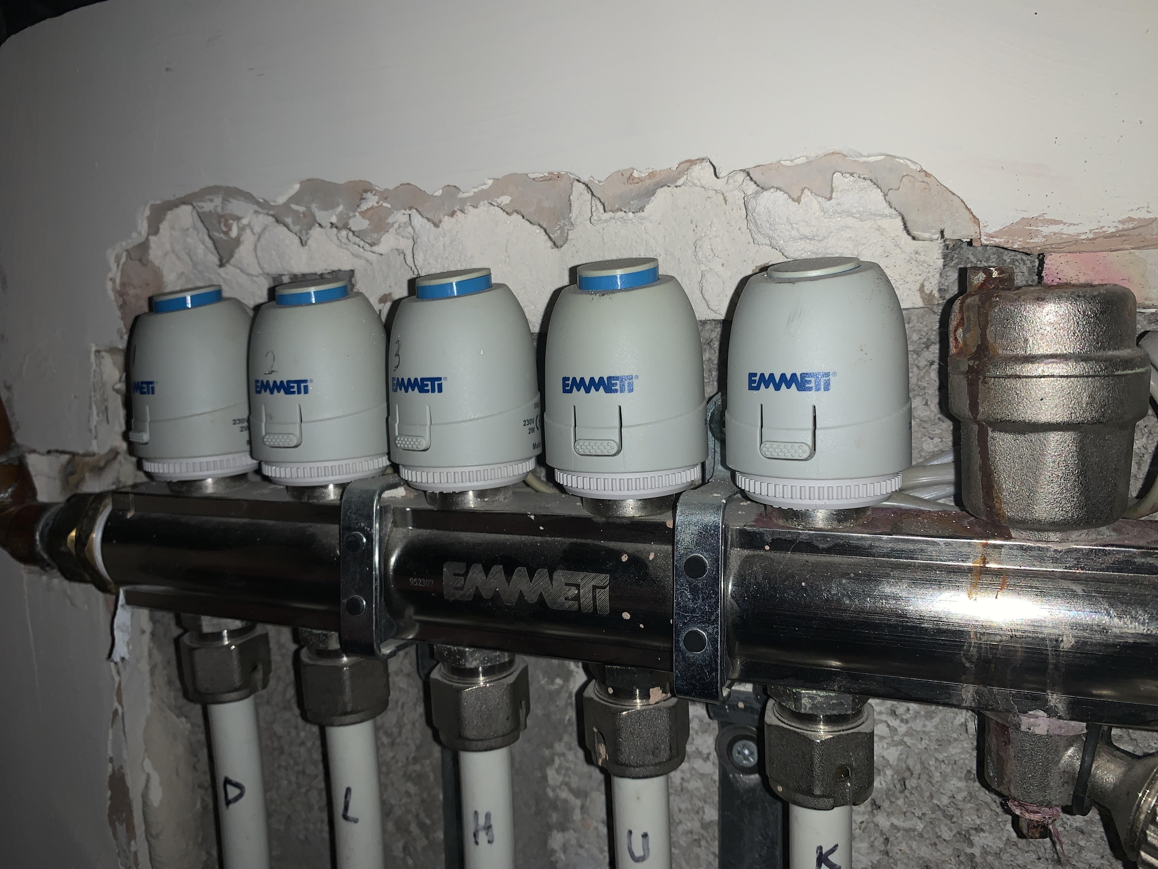

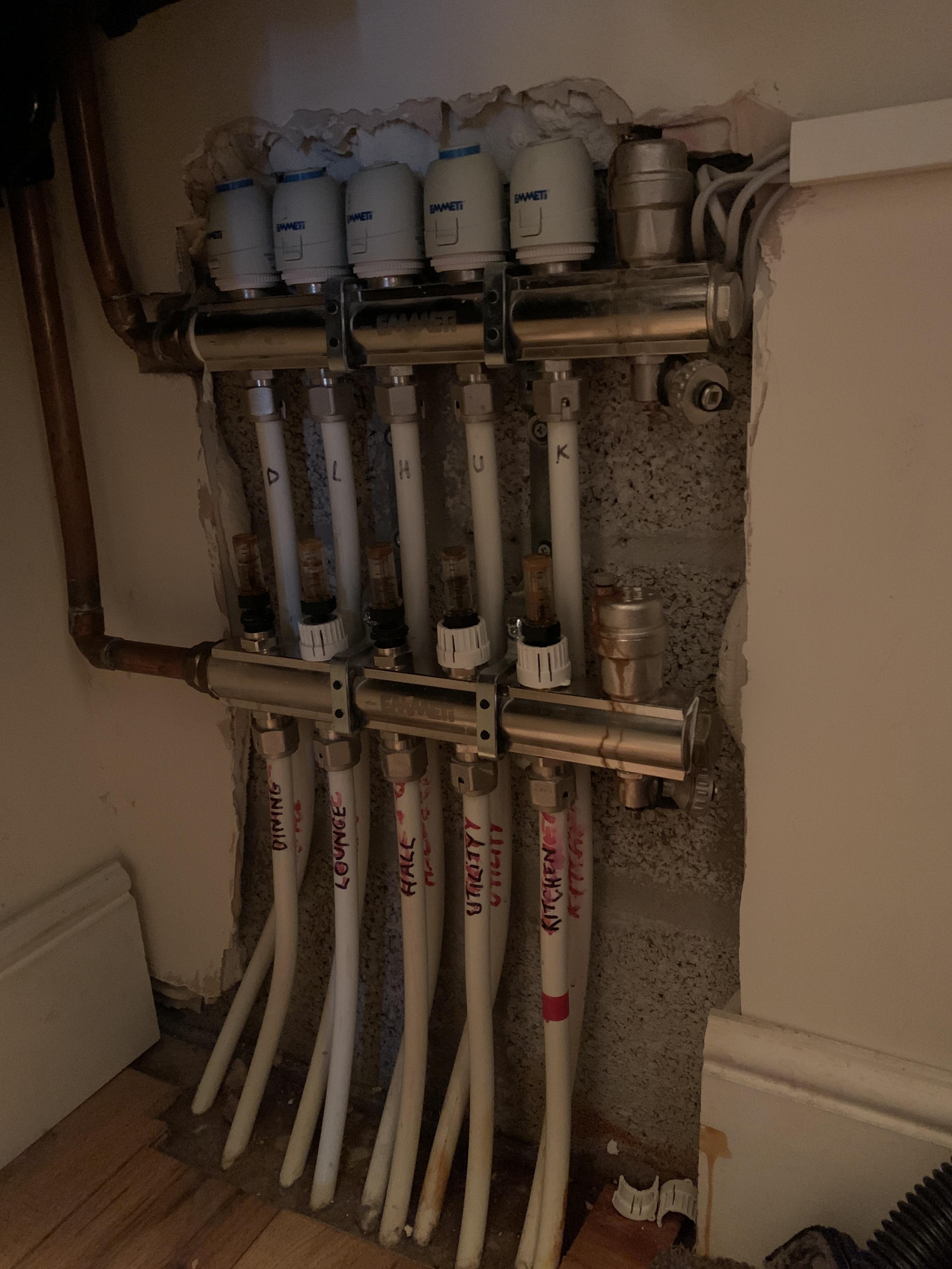

ProDave Posted January 15, 2021 Posted January 15, 2021 How old is the system? Is it actually working adequately? The usual (correct?) thing is the UFH manifold has it's own temperatuer blending valve and circulation pump. for some reason a lot of systems are coming to light recently where they rely on just one circulation pump for everything which is not ideal. Can you show a more zoomed out picture of the whole manifold?
Chriswills Posted January 15, 2021 Author Posted January 15, 2021 Is about 10 yr old. Runs off ASHP. works ok but not too efficiently in my opinion. rads to other 2 floors also run off this pump from the buffer
ProDave Posted January 15, 2021 Posted January 15, 2021 Any idea what temperature it is running at? If you get a "proper" design for an UFH system you will be offered a manifold with a temperature blending valve and it's own pump. I am guessing this was built by a developer who thought he knew better and could save £300 by not including these "unecessary" parts? If the water is hot enough for radiators it is likely too hot for UFH and in any event because of the very different warm up times it would be preferable to have the UFH and radiators on separate time and temperature controls, which you could do with a proper system. What do you know about the house re it's construction and levels of insulation?

Chriswills Posted January 15, 2021 Author Posted January 15, 2021 Thanks Dave. Would you suggest fitting a mixer and pump type manifold or leave as is? As it stands the actuators have no way of telling the pump to switch off. It’s mad really. My problem then I have only 1 pump so upstairs rad will go off too.
PeterW Posted January 15, 2021 Posted January 15, 2021 51 minutes ago, Chriswills said: Thanks Dave. Would you suggest fitting a mixer and pump type manifold or leave as is? As it stands the actuators have no way of telling the pump to switch off. It’s mad really. My problem then I have only 1 pump so upstairs rad will go off too. Yes and .. yes.. So that needs re-fitting with a mixer if possible - you may have to take the manifold off the wall although it looks like someone removed the board with a spoon anyway ... Depending on how far from the buffer that manifold is, the manifold pump may well pull the hot water into the system anyway. If you can move the “other” pump and make sure it’s before any tee to the mandifold even better. You could wire the rads to a zone valve - use that to switch the pump on only when the rads want heat and let the manifold pump be controlled by the actuators. All pretty easily doable

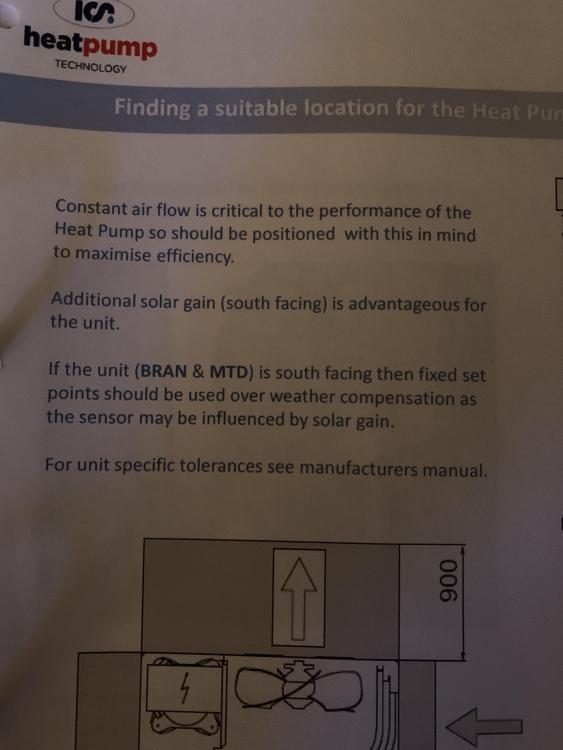

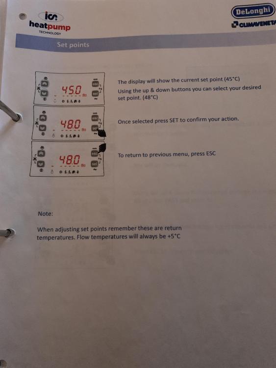

Chriswills Posted January 16, 2021 Author Posted January 16, 2021 (edited) Thanks so much for the advice guys. I was beginning to think about changing the manifold so it does the job properly. any recommended components to use, eg, manifold with flow meters on lower, wiring centre etc. I did read in the supplier manual not to change the weather switch compensation to on if the unit was south facing. See pic. None of this has been commissioned, guy went bust and I had to pick up the pieces with other people. Although we had 10 years I’ve kind of just gone along with it as never had time, working away. Now I’m deep diving into it all. Max temps at 32 would do nothing for my rads either. This morning, after reducing the return temp on the ASHP to 35 (flow 40-always plus 5) the actuators are all open (bar 1) on the UFH and HP running trying to get more heat in I guess. What if I started to reduce flows to try and force more water where needed as the hall is now up to temp. Turned up by 2 degrees now to see if I can get the UF up to temp. Bit of a trade off in my opinion. UFH room stats are set to 18. Edited January 16, 2021 by Chriswills Pics added
PeterW Posted January 16, 2021 Posted January 16, 2021 Solar gain for a heat pump is negligible but the air sensor on the back may be susceptible to solar warming. There is nothing intrinsically wrong with that set up. Emmeti are a decent brand, it just seems like it has been half installed ..! Depending on how “handy” you are then you can probably re-pipe a lot of that as it stands with some off the shelf components rather than use a new manifold and pump set. Couple of things to check though. Is there a sensor or thermostat on the buffer tank ..? What triggers the circulation pump to run..? What triggers the heat pump to run ..? What timer / controller is installed ..?

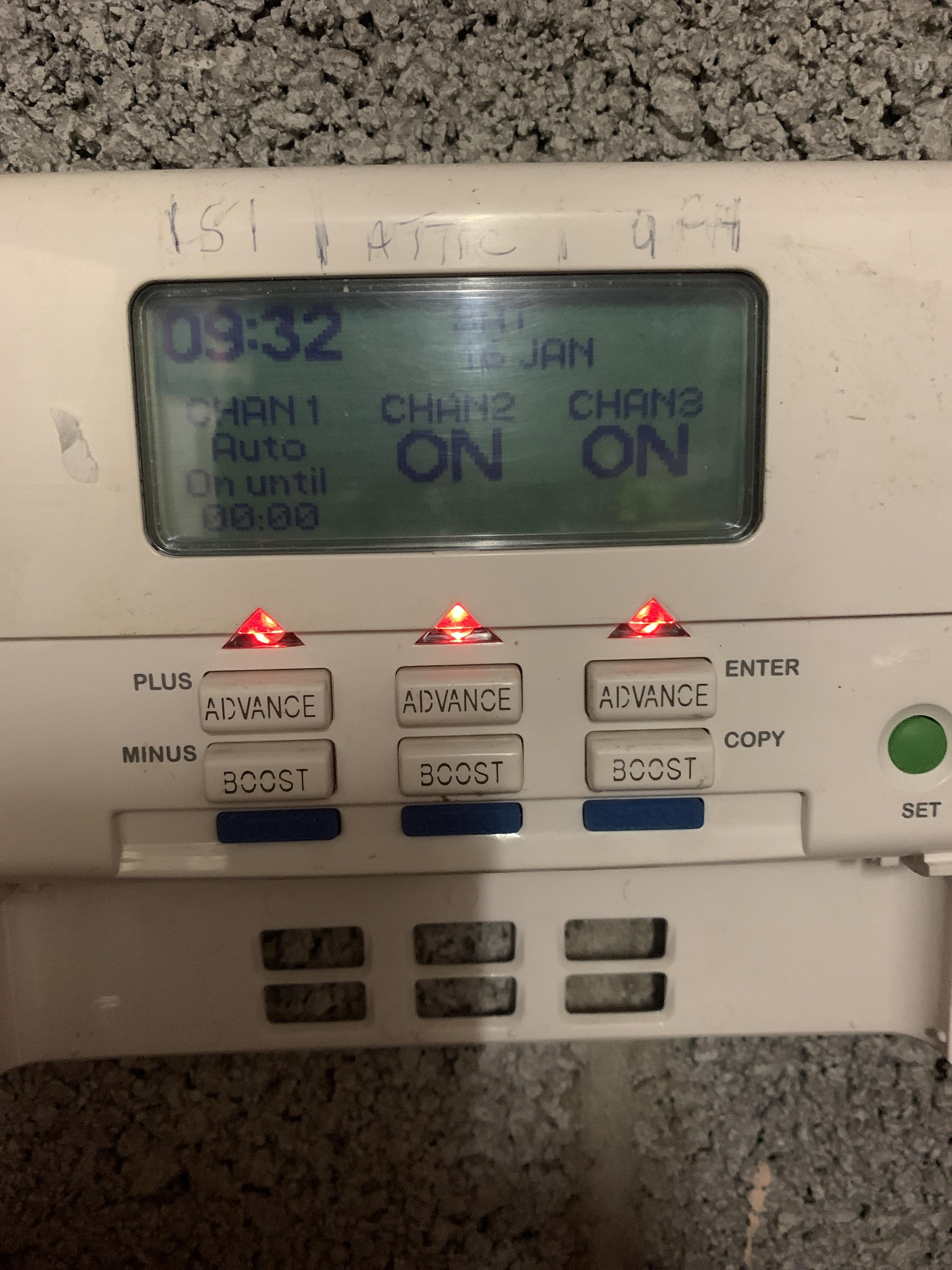

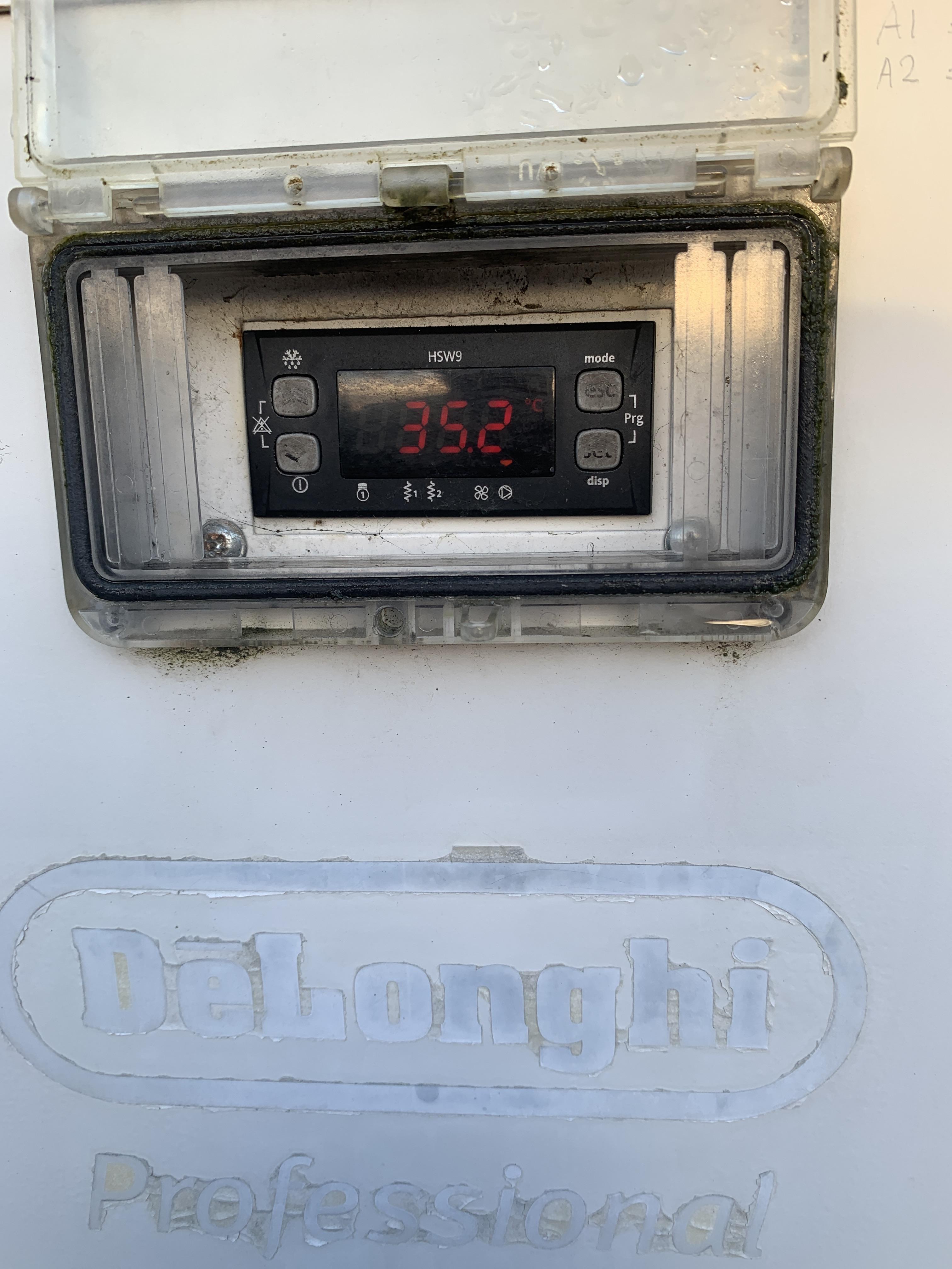

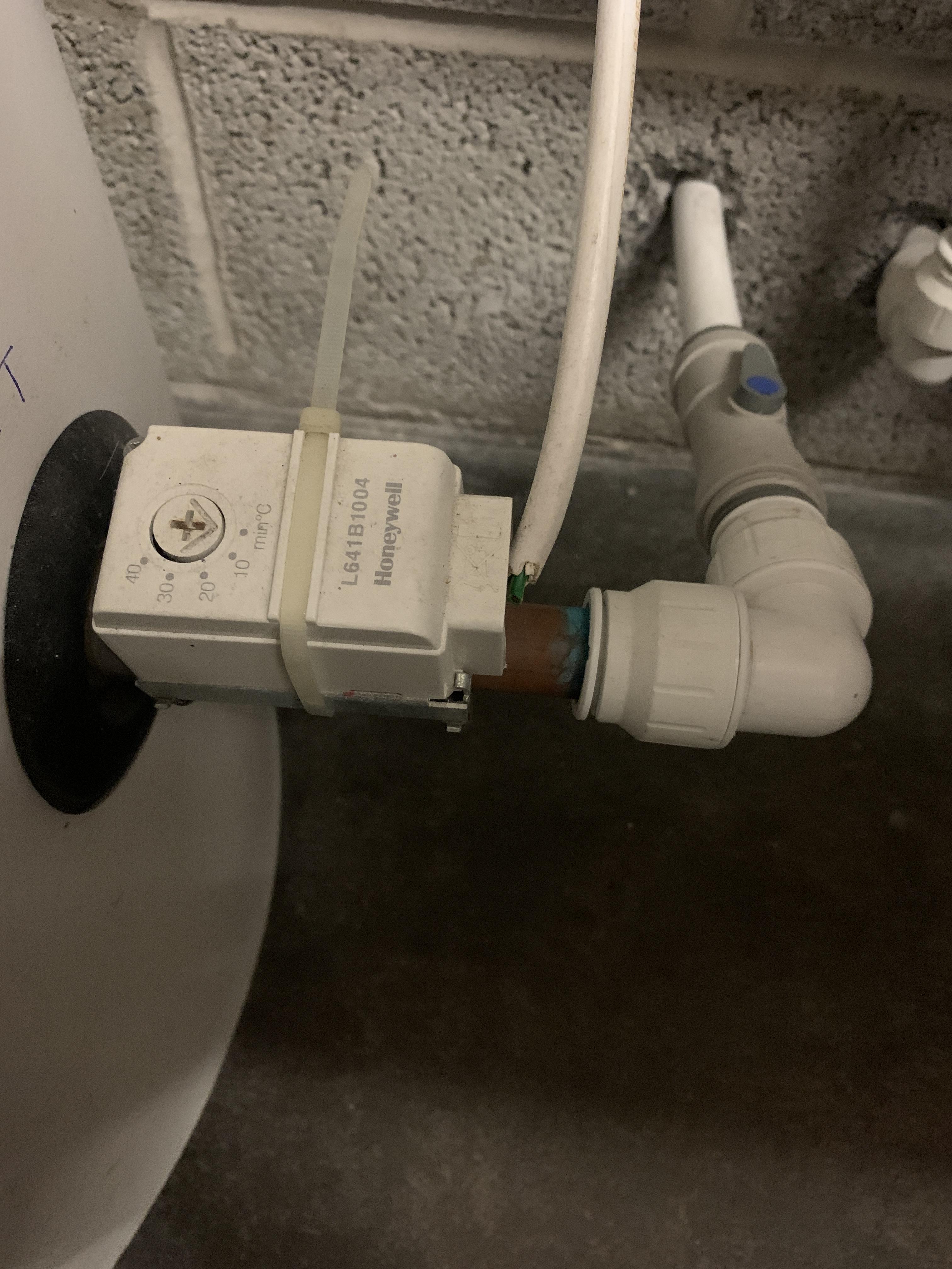

Chriswills Posted January 16, 2021 Author Posted January 16, 2021 There is a temp switch on the buffer return tank which I can set. It works based on the return temp to the HP. So for example it can be set to activate the pump only if the temp is 35 any lower then the grundfoss doesn’t come on. At the moment I have it switched off and the GP runs 24/7. HP runs when the return temp setting minus 3 is reached. Eg: return set to 37. Pump activates at 34. Pic shows 35 so unit is off. Timer is on 24/7 for UFH and from 6am until 12 pm for rads upstairs. Although most of the rads are off. Here’s some pics:

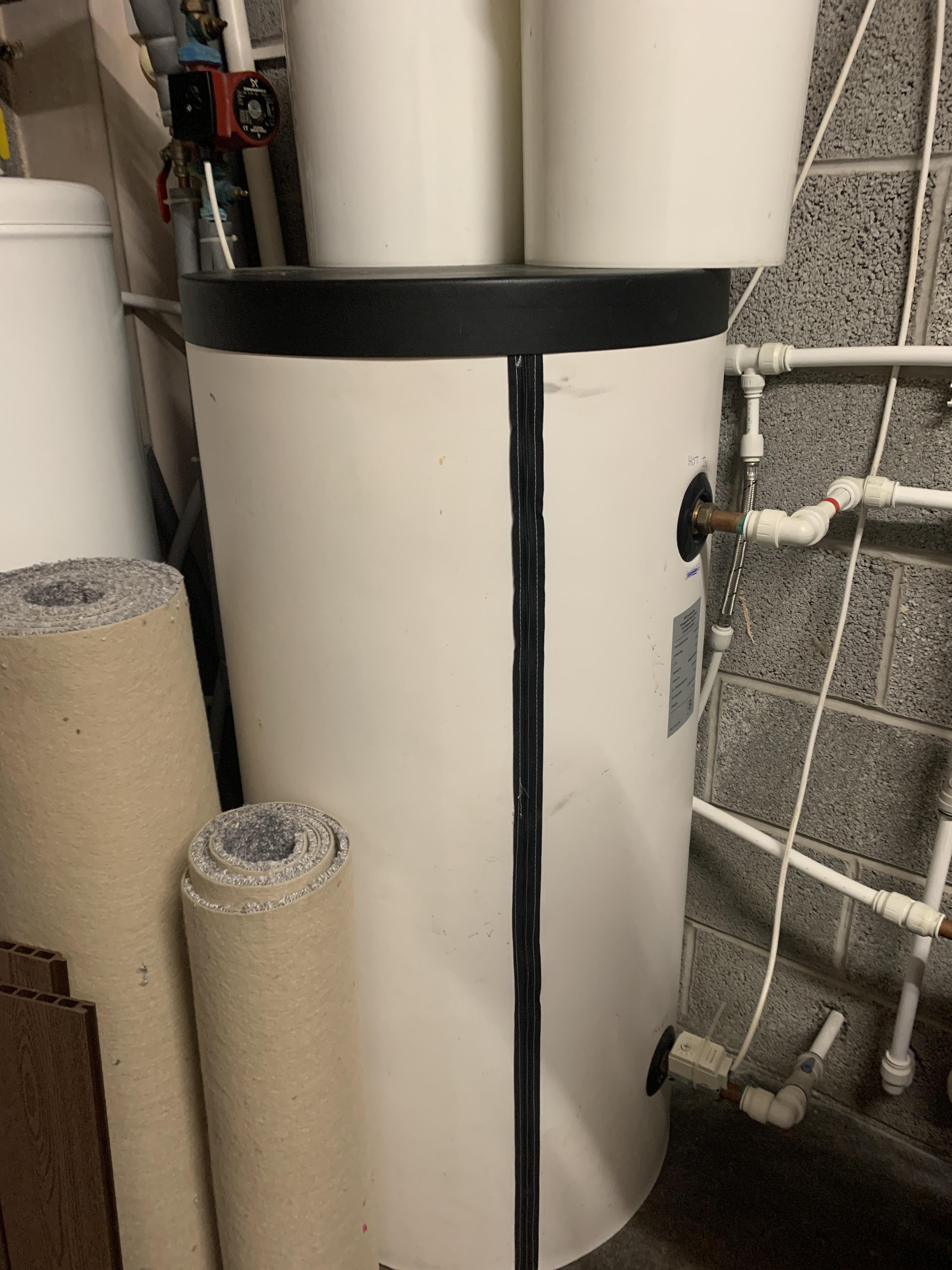

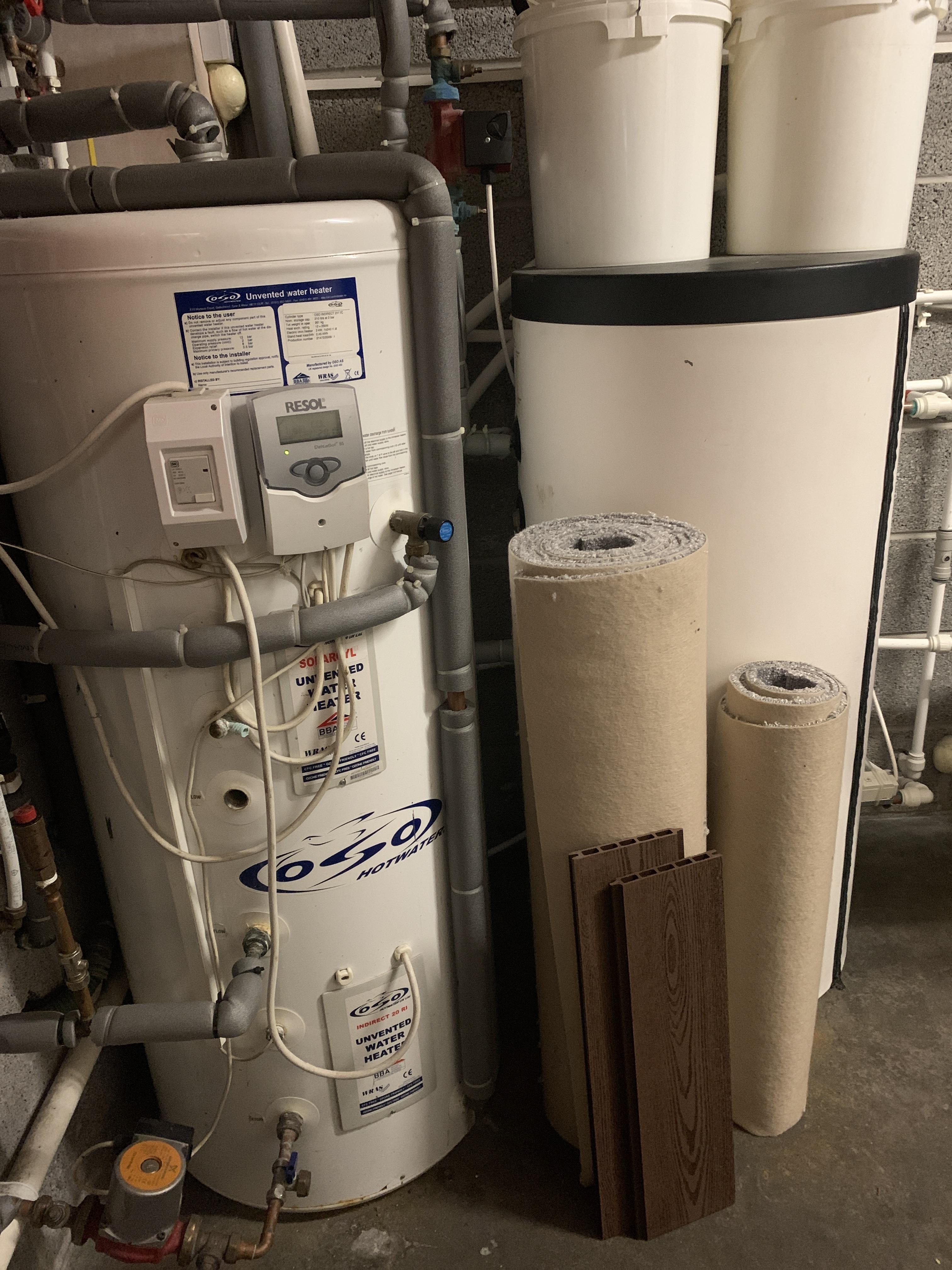

PeterW Posted January 16, 2021 Posted January 16, 2021 Bit of pipe insulation in there wouldn’t go amiss ... ? GP..?? Grundfoss Pump ..? What is doing the hot water in the house ..?

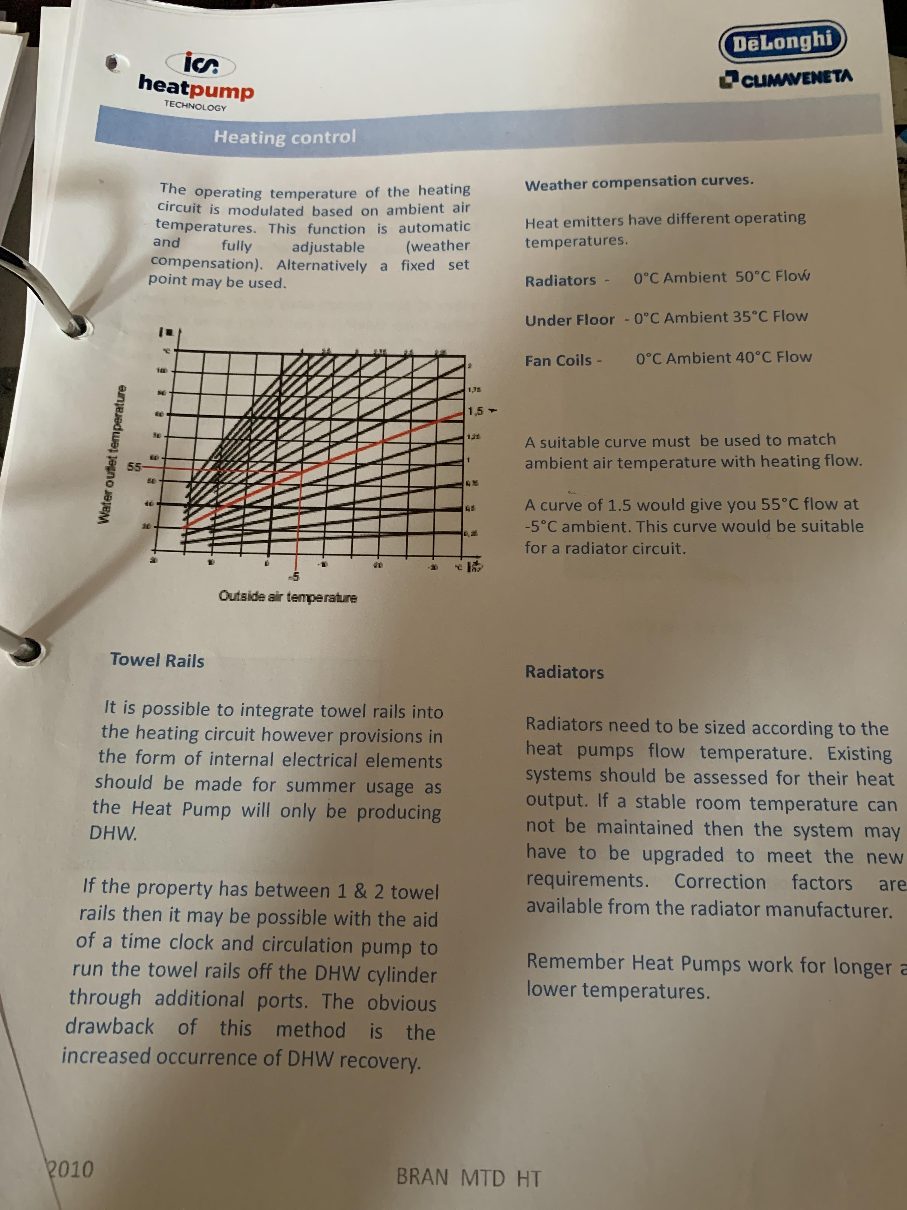

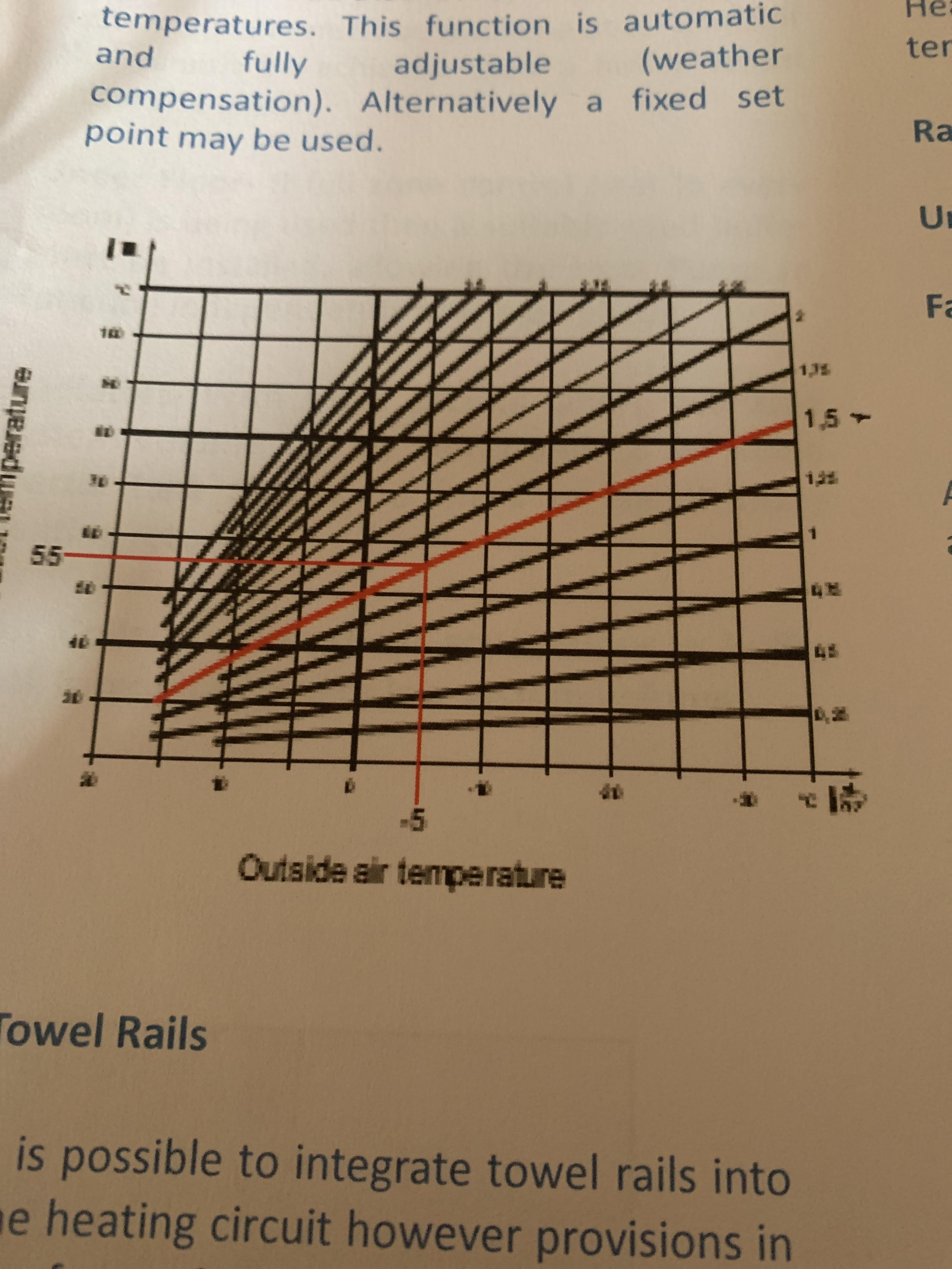

Chriswills Posted January 16, 2021 Author Posted January 16, 2021 Yes GP grundfoss pump. hot water is solar thermal and immersion heater. by End March I usually switch the Ashp off heres an image of weather compensation graph. Is it worth a play?
PeterW Posted January 16, 2021 Posted January 16, 2021 Any reason the HP doesn’t do the hot water to at least 40°C as it would be a massive improvement on the immersion. Does the tank have just the solar thermal coil..??
Chriswills Posted January 16, 2021 Author Posted January 16, 2021 It’s not plumbed in to. Solar cylinder is separate to buffer. I’m on about 40-50 kWh a day now in winter at 12p a kw so not too bad. In summer it’s a lot less.
ProDave Posted January 16, 2021 Posted January 16, 2021 8 minutes ago, Chriswills said: It’s not plumbed in to. Solar cylinder is separate to buffer. I’m on about 40-50 kWh a day now in winter at 12p a kw so not too bad. In summer it’s a lot less. Is that the DHW usage? If so that seems high. I used 31kWh in the last week heating HW with the ASHP.
Chriswills Posted January 16, 2021 Author Posted January 16, 2021 That’s total electricity used per day heating, water and everything else. I don’t have gas installed, just have a bottle for the job that’s all.

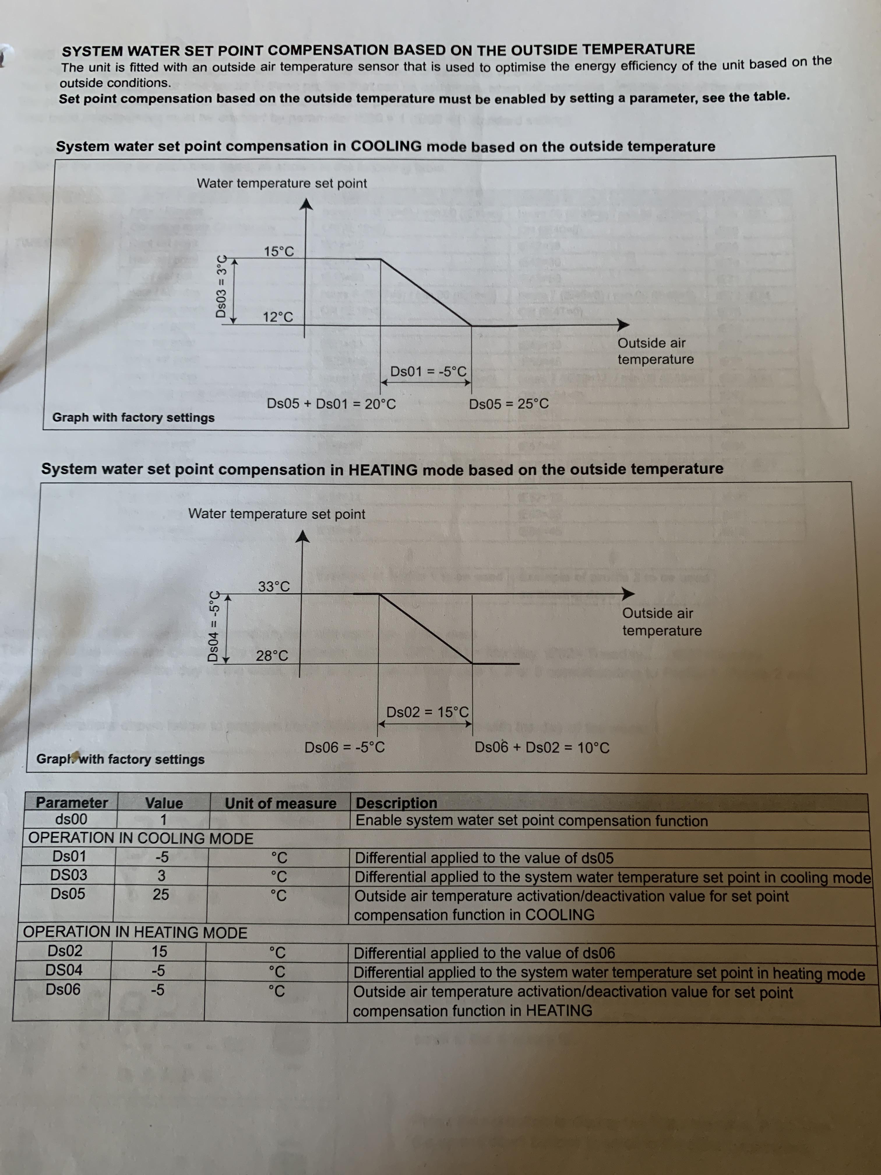

Chriswills Posted January 16, 2021 Author Posted January 16, 2021 I wouldn’t mind a go at trying the weather compensation option. Got the manual info but need a bit of plain English if anyone can help please? Current settings are: DS00 = 0 which is off, needs to be 1 to activate. DS02 = 22 DSO4 = 15 DS06 = -5 these are the factory sets I assume and here is the page from the manual:
PeterW Posted January 16, 2021 Posted January 16, 2021 So for an increase of 15°C of outside temp (-5°C to 10°C) the heat pump will reduce the flow temperature set point by 5°C reading that. So if you set it at 35°C and it’s 10°C outside, then the HP will change it to 40°C when it’s -5°C or lower. I would possibly move the curve up slightly (although this looks linear ..!) and move the differential start (ds06) to -2°C but make it -3°C on ds04 to begin with. Nice and simple this one to understand ..!
Chriswills Posted January 16, 2021 Author Posted January 16, 2021 3 minutes ago, PeterW said: So for an increase of 15°C of outside temp (-5°C to 10°C) the heat pump will reduce the flow temperature set point by 5°C reading that. So if you set it at 35°C and it’s 10°C outside, then the HP will change it to 40°C when it’s -5°C or lower. I would possibly move the curve up slightly (although this looks linear ..!) and move the differential start (ds06) to -2°C but make it -3°C on ds04 to begin with. Nice and simple this one to understand ..! Glad someone thinks it’s simple and Thankyou so much? Could you just run through the settings please to achieve best efficiency, DS02, 04 and 06?
