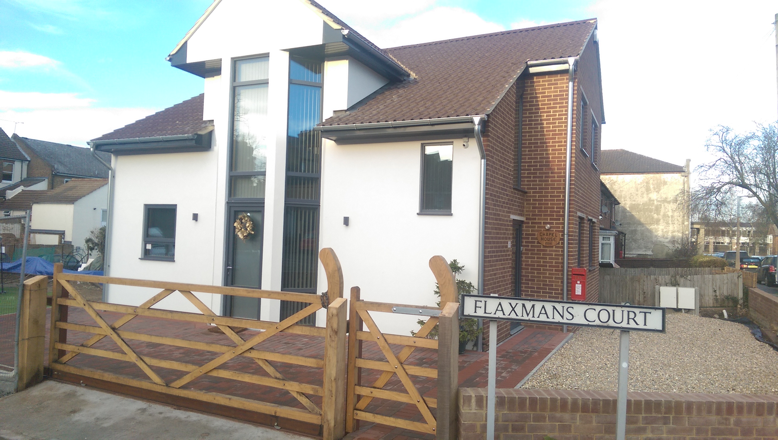

DH202020 Posted February 2, 2017 Posted February 2, 2017 We finally moved in on December 3rd after 9months selfbuilding. Have been monitoring our gas usage and was wondering if this is about right for the type of house built?.... Gas Usage: approximately 100m3 or 111kh per month (been cold for SE area). 2x people, living in 72sqm (ground floor) Underfloor heating one zone only. Very good floor/wall/roof insulation. triple glazed. Gas combination boiler (worc/greenstar 32dci). 2x showers per day Hob gas only (used infrequently) House set to 19.5° constant. Does this all add up? Was hoping gas usage would be less Anyone with similar design/usage?? Thanks David.
