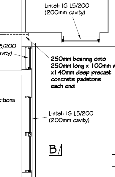

sean1933 Posted January 14, 2021 Posted January 14, 2021 (edited) I am at the stage where we are ready to get the joists ordered and I've been struggling to deal with a few issues that have given me a headache. Our house is rather complicated with a lot of of glass including floor to ceiling windows on both floors. Construction is brick and block 200mm cavity. I initially wanted to go down the route of timber plates and resin bolts to help with air tightness but the structural engineer for various reasons wasn't keen. I have therefore resorted to a combination of built in, and top cord hung onto various steels (some without a timber plate). Obviously I want a flat floor and various steels being up to 4mm out of size caused a few headaches, but nothing a steel packer plate at the bearing ends wont fix. There is one problem however that I'm struggling to overcome and my head hurts, any solutions welcome! Joists (posi or easi joist) are 254mm Ceiling height being 2.4m. In a couple of areas of the house we have floor to ceiling windows both above and below the Birley HD190 cavity lintels - I believe this rules out hangers due to no downward load above. The frustration I have is that where the joists are built in they obviously go from bearing on a block, to bearing on the lintel (which is some 5mm thick + mortar bed = 10+mm)... thus meaning they are some 10mm out of level the joists next to them. Solutions I have considered: - Joists with trimmable ends. Wolf say this is length ways and the bottom bearer cannot be trimmed down more than 6mm - this mitigates a bit but doesn't fully fix the problem. - Pack out the bottom of every block bearing joist with packers - bit bodge like....and laborious. - Accept a slightly uneven floor and hope it isn't noticeable or if it is fix with a thin latex fibre screed - as above... - I did consider switching to top cord hung joists at these points (or maybe the entire floor) but comparing old technical documents from Wolf vs the newer version, this option isn't included so I can only assume it is discouraged. I have asked Wolf, but no reply yet. I seem to recall reading something similar on here but cannot find it for the life of me... Any solutions greatly requested! Edited January 14, 2021 by sean1933

sean1933 Posted January 14, 2021 Author Posted January 14, 2021 (edited) joists and block infills would be located where the block is shown in the above diagram, with 1 further brick above to make up the 300mm spacing between floors. Hopefully the below helps: Edited January 14, 2021 by sean1933
PeterW Posted January 14, 2021 Posted January 14, 2021 How wide is that ..? Can’t you land joists either side ..?

sean1933 Posted January 14, 2021 Author Posted January 14, 2021 4 minutes ago, PeterW said: How wide is that ..? Can’t you land joists either side ..? Its 1200mm with joist span being 4m to spine wall, currently at 400c's. This problem also happens at 2 other locations seen below - one being a door opening 2250mm wide...

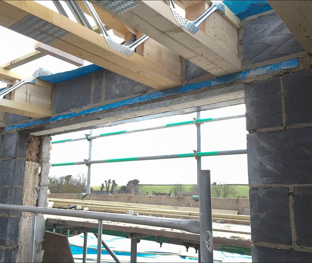

mvincentd Posted January 15, 2021 Posted January 15, 2021 16 hours ago, sean1933 said: I believe this rules out hangers due to no downward load above. Maybe...add a small box section steel above the lintel similar to the blue one shown in pic below....hang off that. Might need bespoke hangers, or fab' hangers into the box section even! That one pictured is a 1.8m wide window below, green roof above, and the pozi's over the window also support a 240kg skylight....the SE didn't spec the box section, it was at my insistance. G20789AC Posi Flat Roof (Higher Roof) Layout 31_01_2018.pdf

mvincentd Posted January 16, 2021 Posted January 16, 2021 7 hours ago, Gus Potter said: Catnic for example quote the capacity of their lintels base on a uniformly distributed load. That means that roughly the load is applied fairly evenly along the length of the lintel. Just as importantly they also specify what is called a load ratio. To allow the lintel to meet the stated capacity both the inner and outer flange loads have to fall within certain limits. In other words you can't put all the load on the inner flange and expect to get away with it as the lintel starts to twist too much. Having a cursory glance at the photo it seems that we have two double joists on the inner flange and very little load on the outer flange. All is not lost however if you want to go off piste and the load ratio is exceeded. You can contact the manufacture and ask them to check that what you propose is ok. The overall load may be less, while the load ratio may exceed the brochure limits they can check it will still be adequate. All very interesting, particularly this bit. Not to hijack the main purpose of @sean1933's thread i'm interested in this because you're right about my load diffential between inner and outer leafs there. Outer is the pretty negligible 1 block height, whereas inner carries the roof and all that entails. So my Pozi's were specced and supplied by Crendon working off drawings from my SE which identified that Catnic lintel. I raised a slight concern over it with my SE....he responded; "....capacity of the catnic lintels is actually within the required loadings, so theoretically the lintels should be fine. That said, if they do feel flimsy as per your description on the phone then perhaps we should take note and include say a 100x100x5 angle as a protective measure, almost as a bit of insurance...With lintels we do not often get feedback from site, they are usually just constructed by the relevant contractor and that is it, but since you raised this concern it makes sense in our eyes, to eradicate any doubts, especially if you have sourced some additional steelwork already, to include an additional angle where the joists span onto the lintels." No mention/discussion of 'load ratio' and no references to it in Catnic product details/specs, so I wonder if contractors ever give it consideration....or ever need to, perhaps the standard tolerances of standard lintels is wide enough that it would be a bespoke steel rather than a standard lintel being specced when load ratio is a factor? Overall i'm unsure if my SE was just humouring my paranoia, or was overly casual in his original spec', or genuinely acknowledging in-practice observations deserve a weight of consideration against 'the maths'. In summary i'd agree @Gus Potter not to change SE details without checking with them....but do check, don't dismiss bricky opinions or your own instincts, and don't entirely be slavish to the presented maths. I'd also absolutely go through all pozijoist specs carefully as I suspect the estimators at those organisations likely churn out quotes avoiding direct dialogue with SE's on fine detail....put your pozi quote in front of your SE. (just for the eagle eyed....yes the steel isn't 100x100x5.....my fabricator had some 80x40x5 and the SE approved that!) 1
