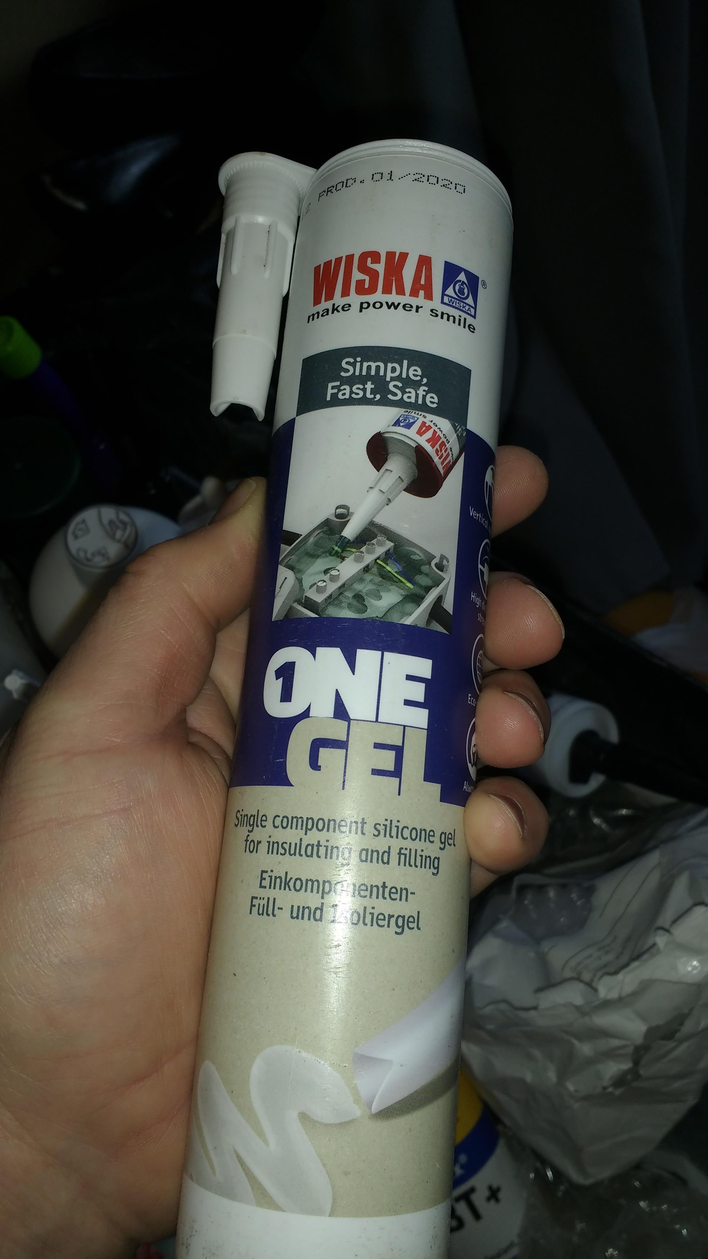

Onoff Posted January 10, 2021 Posted January 10, 2021 15 minutes ago, SuperJohnG said: So does anyone know the answer to the original question? Whats the norm with running cables out to these items. Cable in duct through slab? Then juts adjacent to the related duct/ soil pipe? It's a no brainer for me. Run in duct, even SWA. Darn sight easier to replace/upgrade later especially where the capable goes through a slab. If a control cable running alongside mains then just put it in a smaller duct within the big duct. You will need to consider how to form an air / gas tight seal where the cable comes up out of the duct into the house. Some favour expanding foam then silicone. I prefer this as it's "re enterable". The last two ducted services I've run, new water main and new supply to gates, I've had to core through an existing slab. A mission in both cases!

PeterW Posted January 10, 2021 Posted January 10, 2021 3 minutes ago, Onoff said: You will need to consider how to form an air / gas tight seal where the cable comes up out of the duct into the house. Some favour expanding foam then silicone. I use a plastic bag and then inject the foam into that so it can be pulled out at a later date, and then cheap LMN silicone over the top. 1
