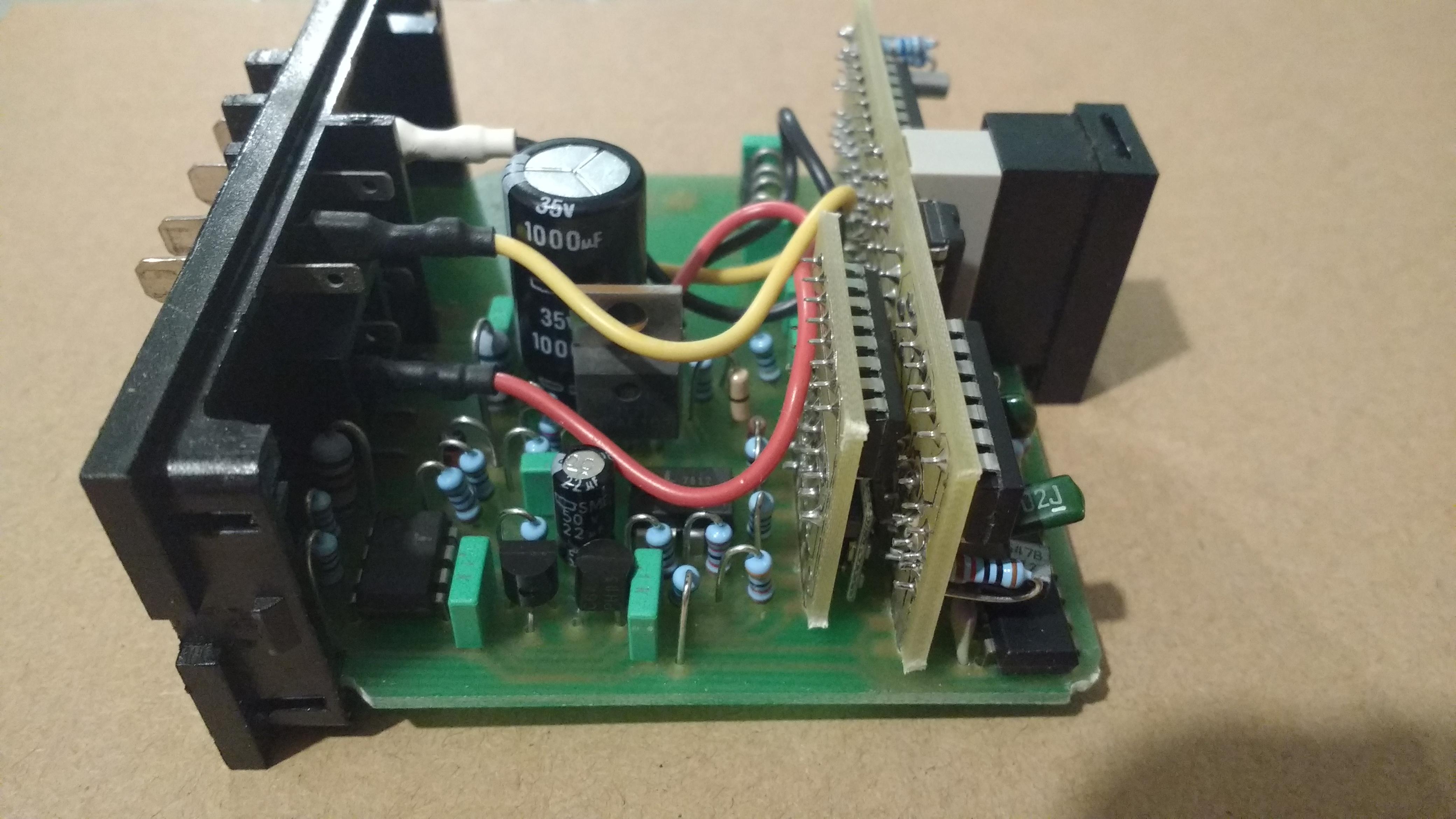

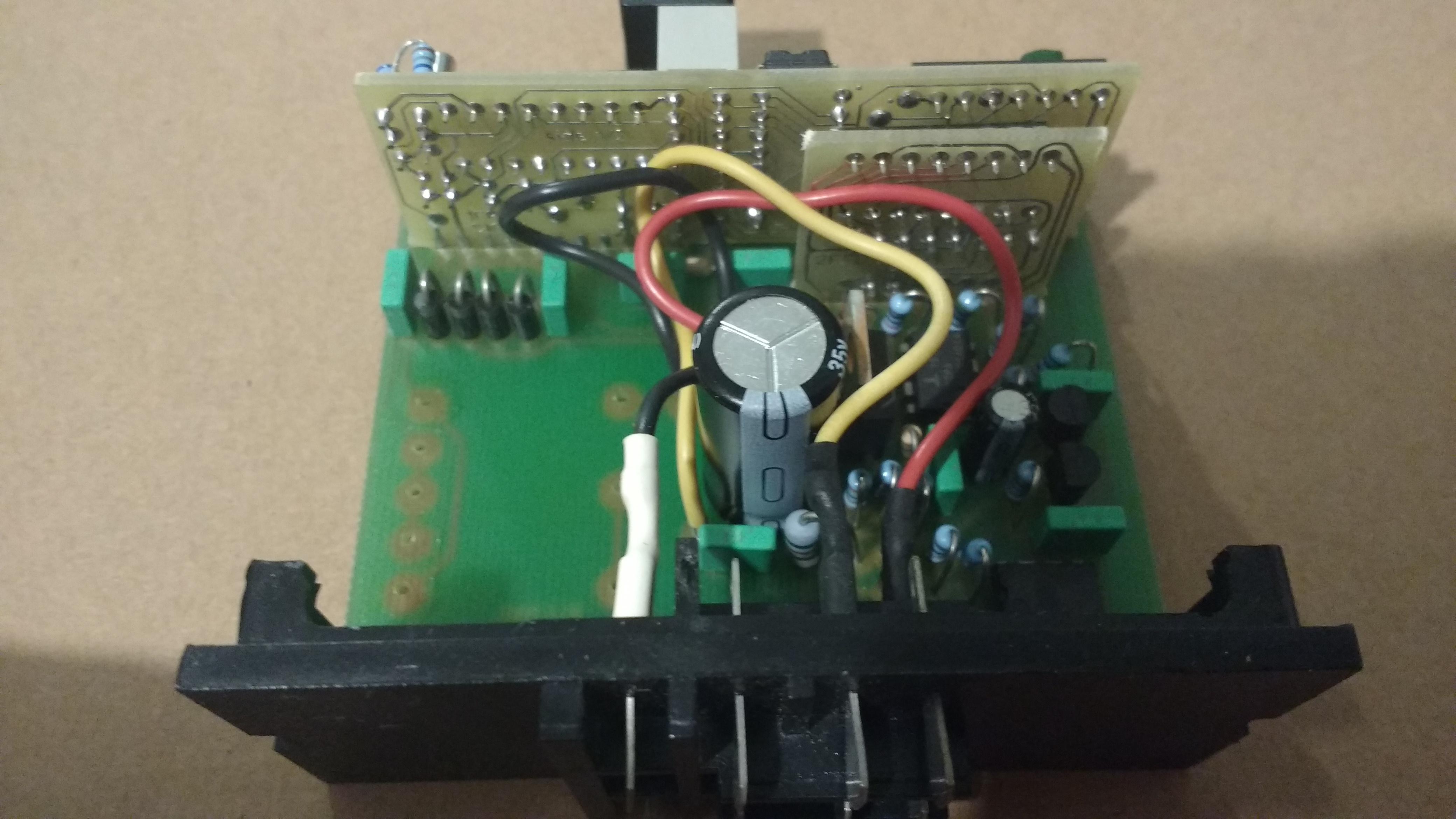

Anyone help in identifying this PCB transformer make /spec? Other than it has a 220VAC primary originally. It's a bit cooked. I've Googled etc but drawn a blank.
There's a label says 010921 420461.
Then one side is screen printed:
DT-4362-1
3323012
18/04/01
IMG_20210109_151706521.thumb.jpg.66c06c4c7f3bbef0aa8d05d47fd3400a.jpgIMG_20210109_151623266.thumb.jpg.ae7ca864c404b7980ed818025cda09a1.jpg

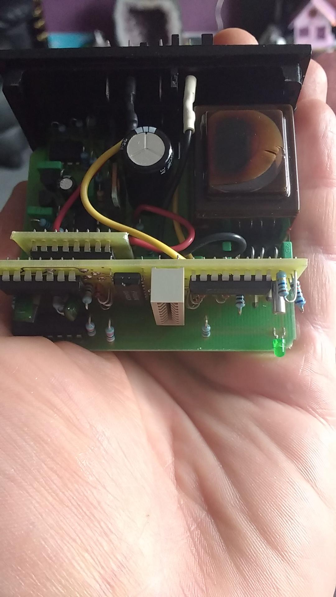

Can you post a pic of what it came from, presumably you have just de soldered it from a PCB?  I take it the item was not working, are you sure it's the transformer, e,g a shorted bridge rectifier would stop it working and make the tx get all hot and bothered.
2 hours ago, TonyT said:
Are the windings intact and you can just measure the primary and secondaries?
Intact? It's swollen and stinks to high heaven! Crispy is the word I'd use! ?Meters I have here measure up to 200MOhm. Open circuit on primary.

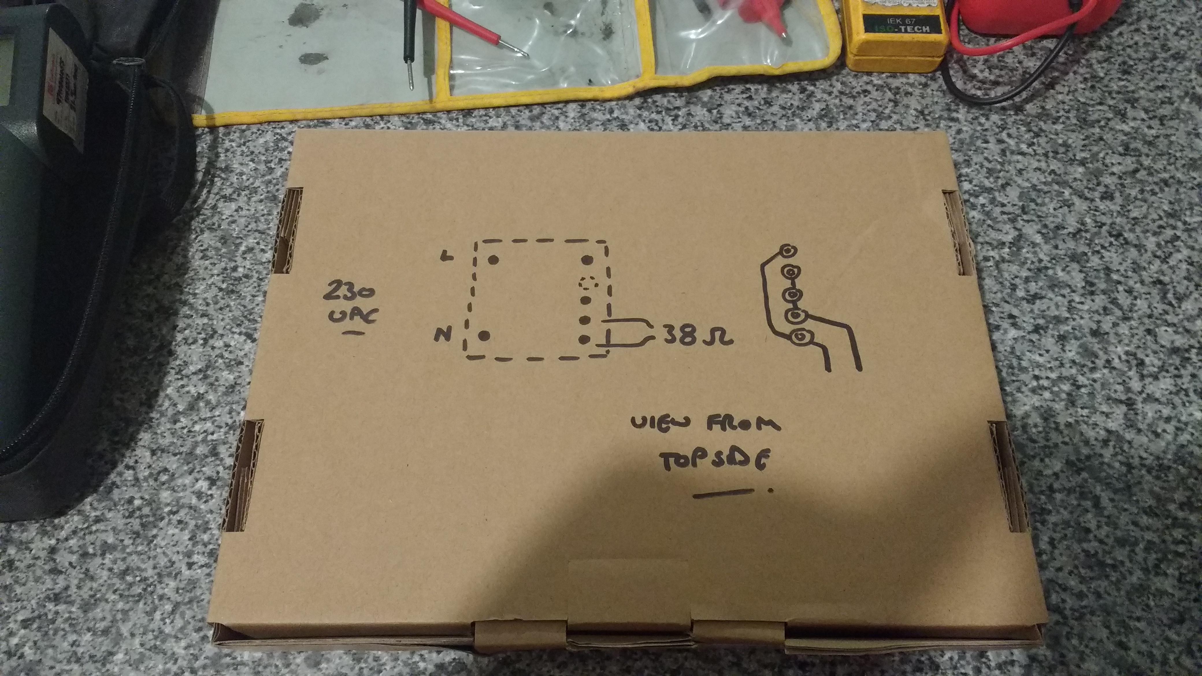

This is all I get on the secondary:

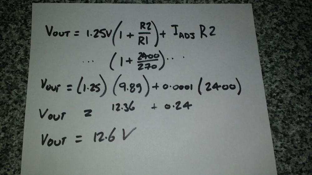

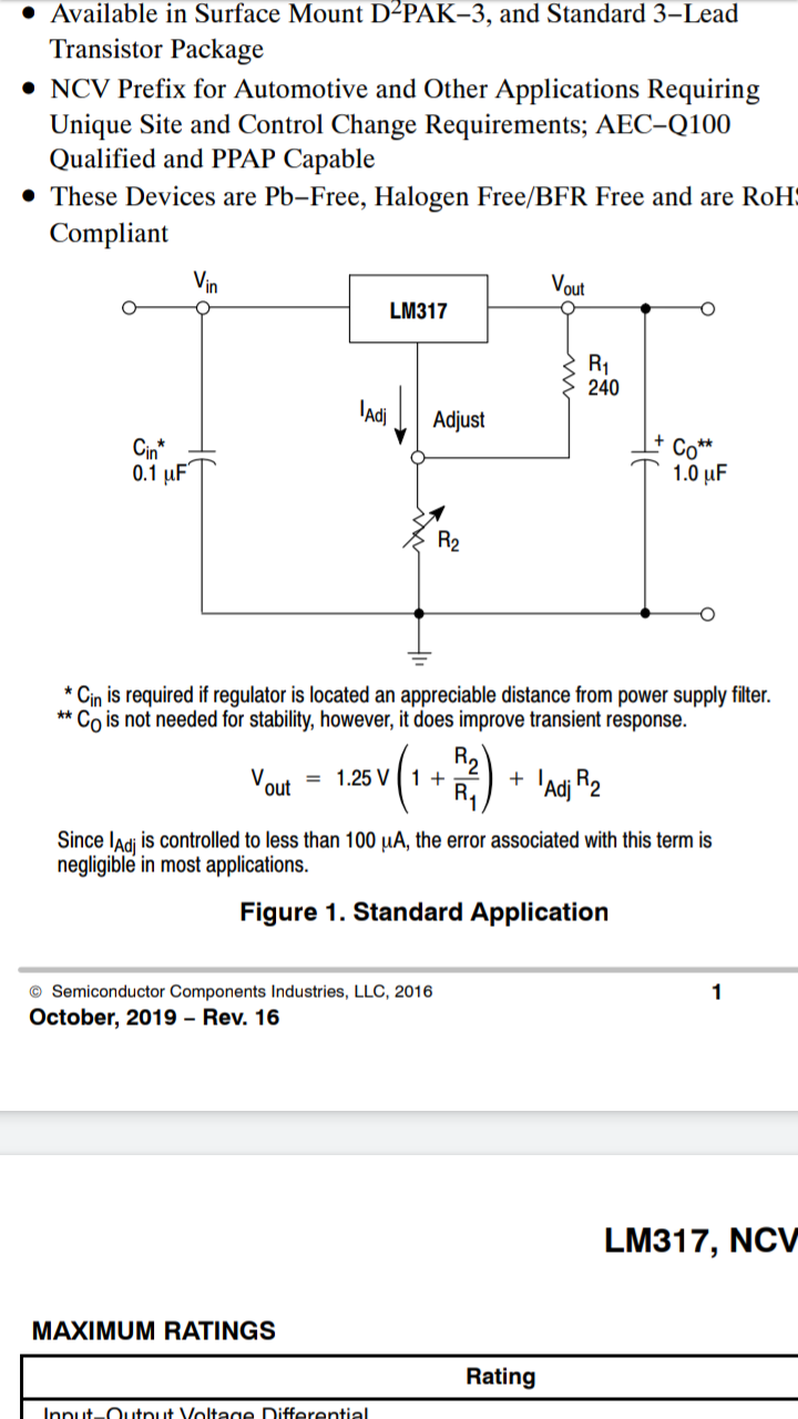

The 4 diodes of the rectifier circuit check out OK. This then from the regulator datasheet:
R1 in this case is 270R, R2 is 2400R. Not sure about IAdj so I just plumbed in 100uA as a figure. Vout then calcs as 12.6V.....I think?
Edited by Onoff
Okay so 12V out, I would try and find a 15V transformer.  Buy the largest in terms of power that will fit the space.  If you can find a pcb mount one with a matching pinout then happy days but unlikely and you might need to do some butchery.

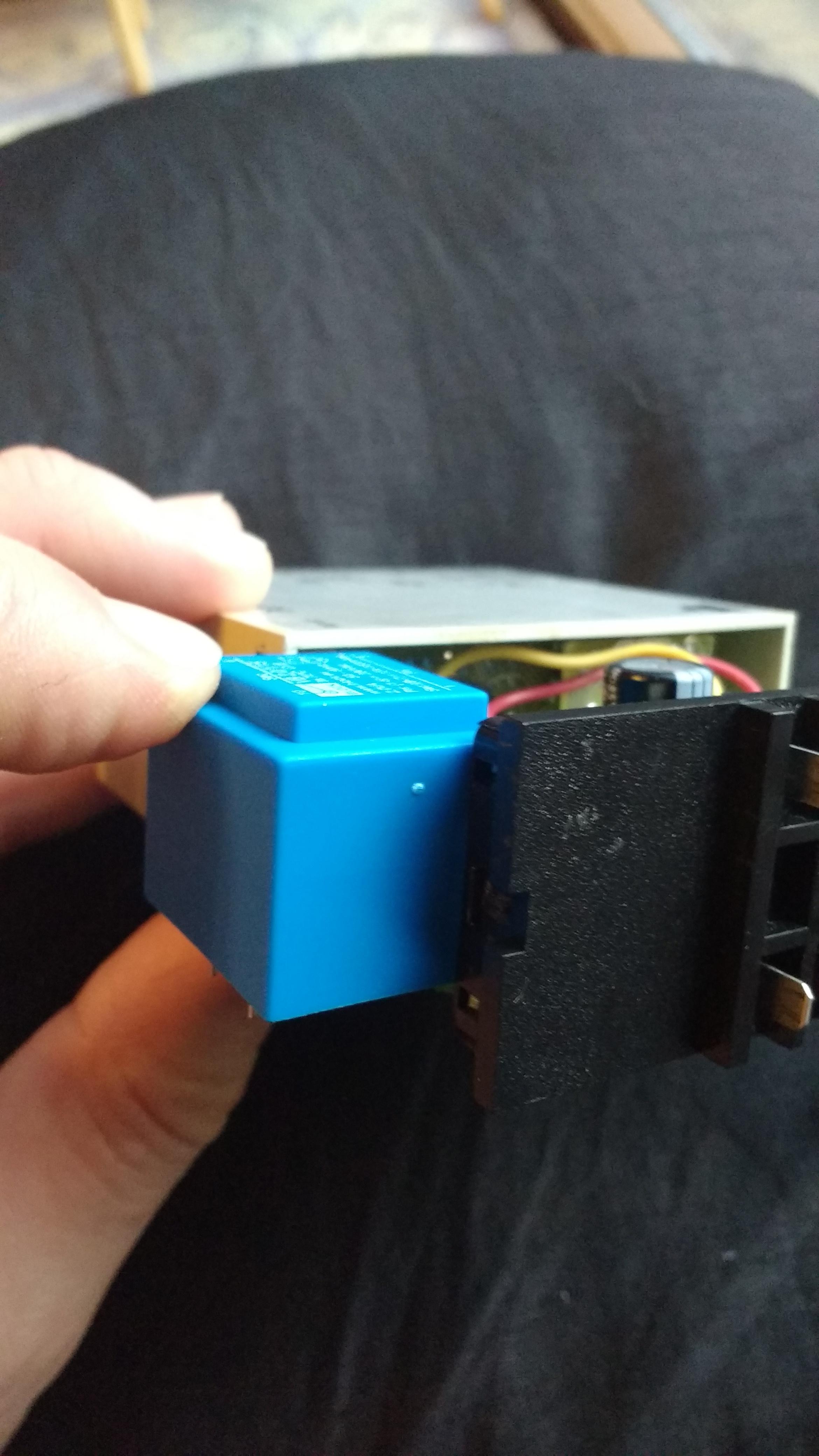

The 2VA trannie turned up. Though it'll fit on plan I reckon it'll be tight up against the case. Thinking a bit of airflow over the top is a good idea so I've ordered a 1.5VA. That'll give the nom. 3mm clearance like the original one had.

Smaller one's coming tomorrow. All of £3 I think it was. The only thing is when it's in its stainless steel enclosure on a roof, in the height of Summer it can get pretty hot in there. I've seen smd stuff literally dripping off of inverter boards.

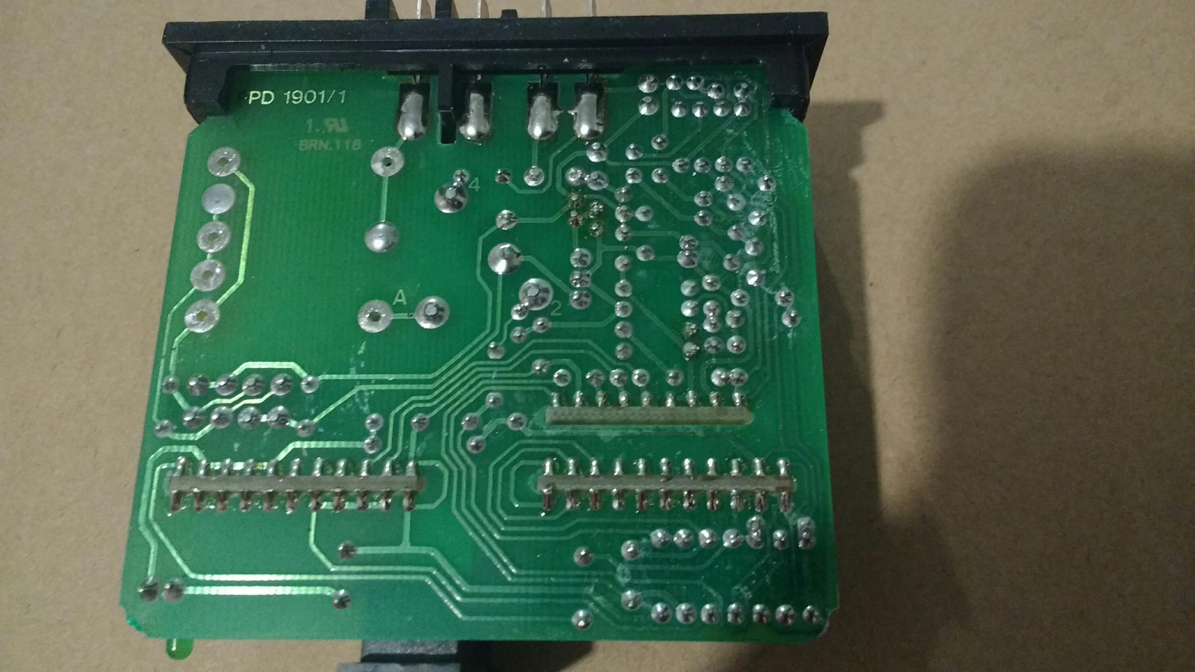

New 15VAC transformer fitted. Off load it measures nom 22VAC on the secondary.
I've renewed the 4 diodes of the bridge rectifier, Cin the 1000uF cap and the voltage regulator.
Applying power and measuring between Vout and ground and I'm seeing 4VDC. I calculated that should be just over 12VDC with the current values of R1 and R2.
So what's pulling it all down I wonder...
On the output of the unit itself I'm only seeing 1VDC...where I'm expecting around 8.2VDC.
Pretty sure the output of this unit saw a prolonged short to ground which is what cooked the trannie in the first place.
Edited by Onoff
