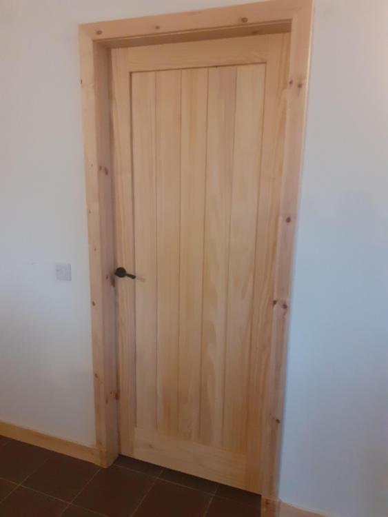

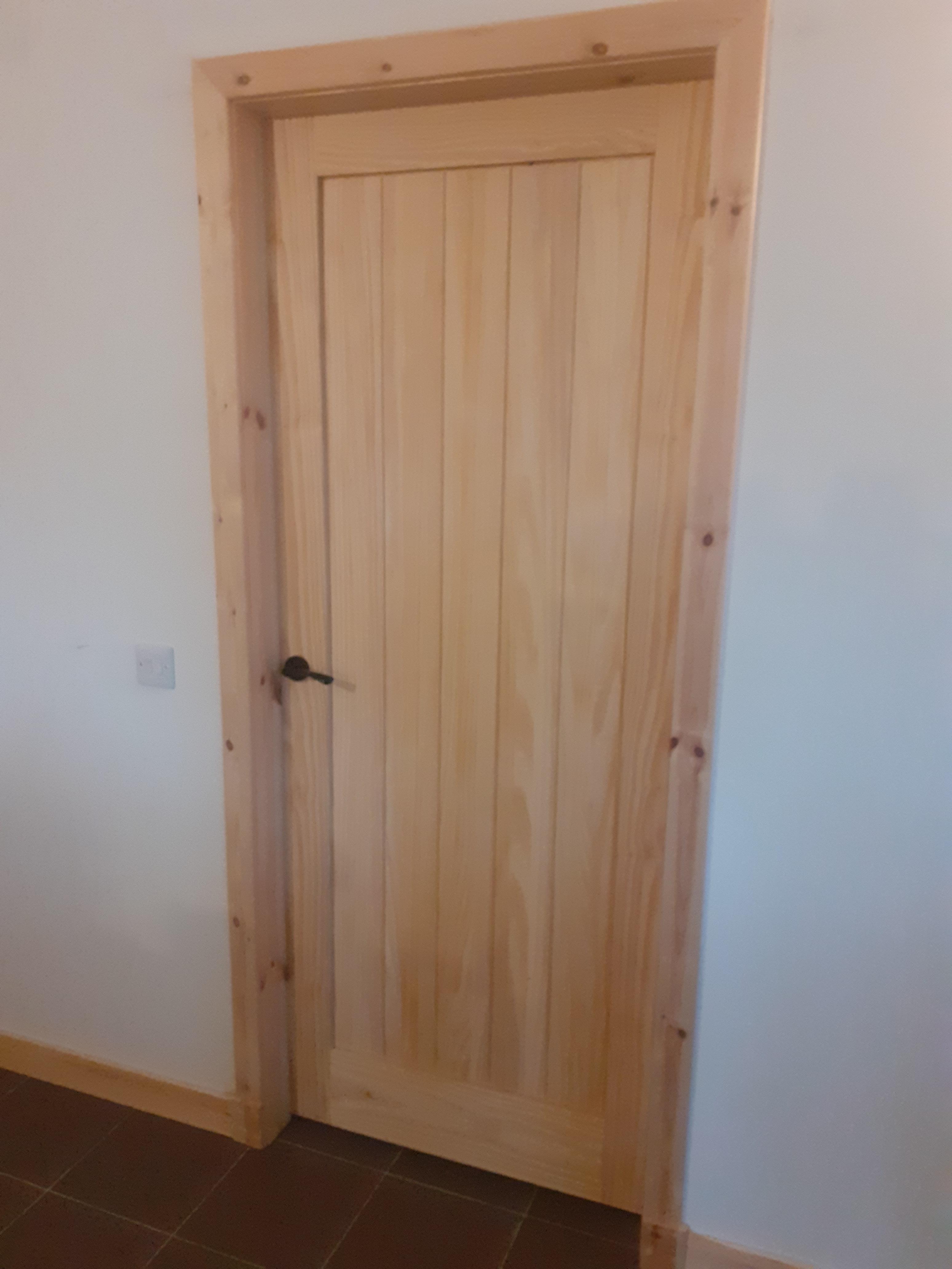

jamieled Posted January 8, 2021 Posted January 8, 2021 @trialuser we did something very similar. We wanted a larder that was thermally broken from the rest of the house, accessed from the kitchen. We got a company to make us an airtight door and frame. Our internal doors are pine, and so the airtight door is too (looks like the vertical planked oak, but in pine. Wasn't cheap though, so I'd imagine the doors strips might be more cost effective if you can get them to work. 1

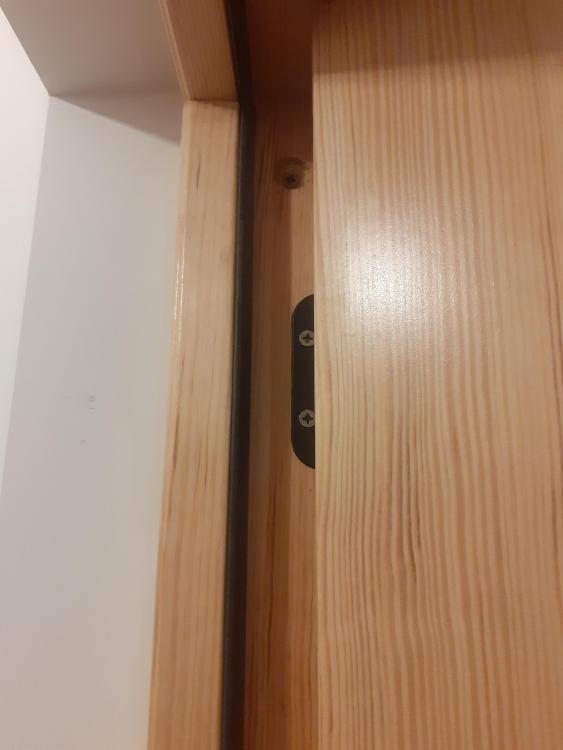

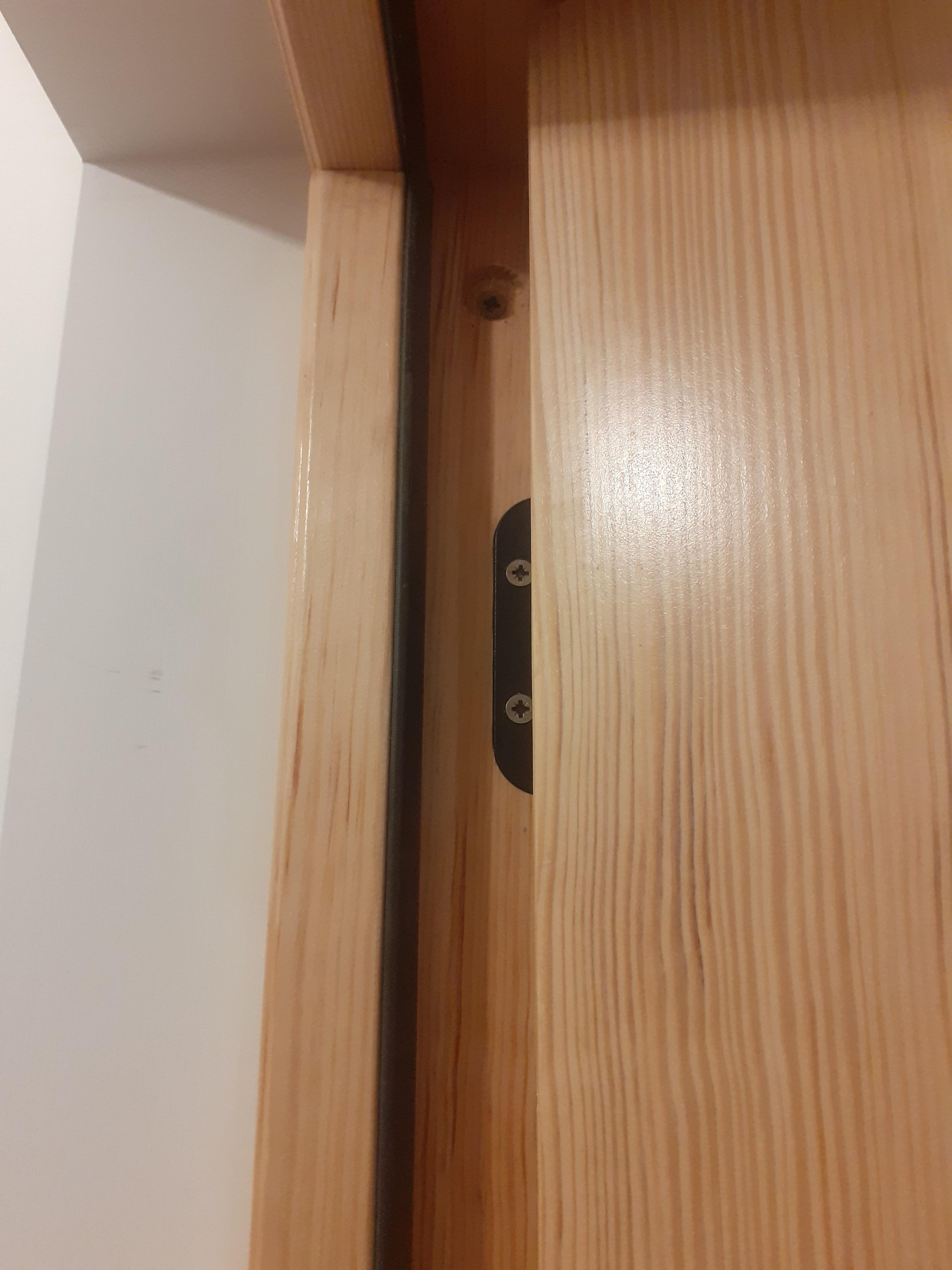

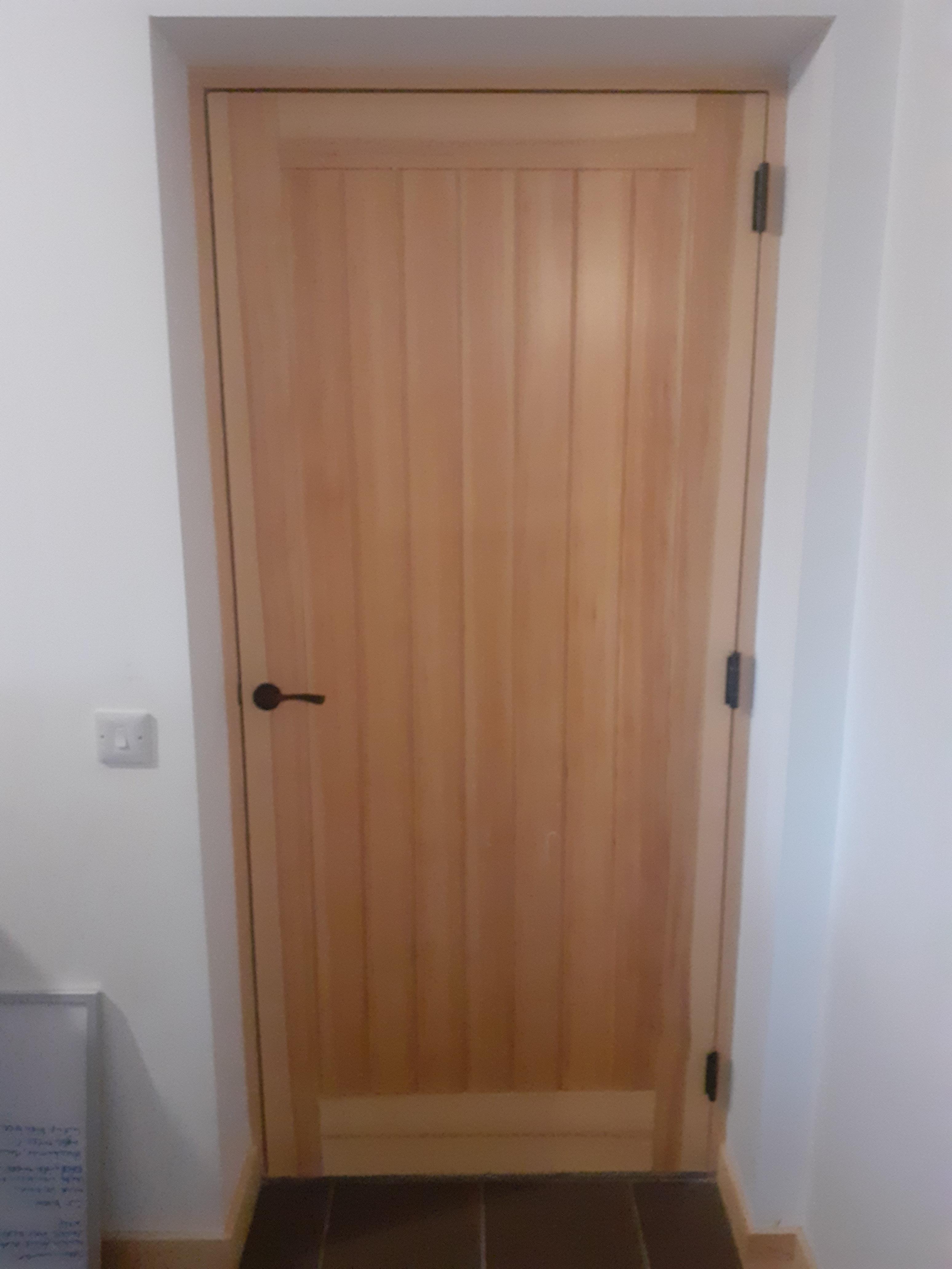

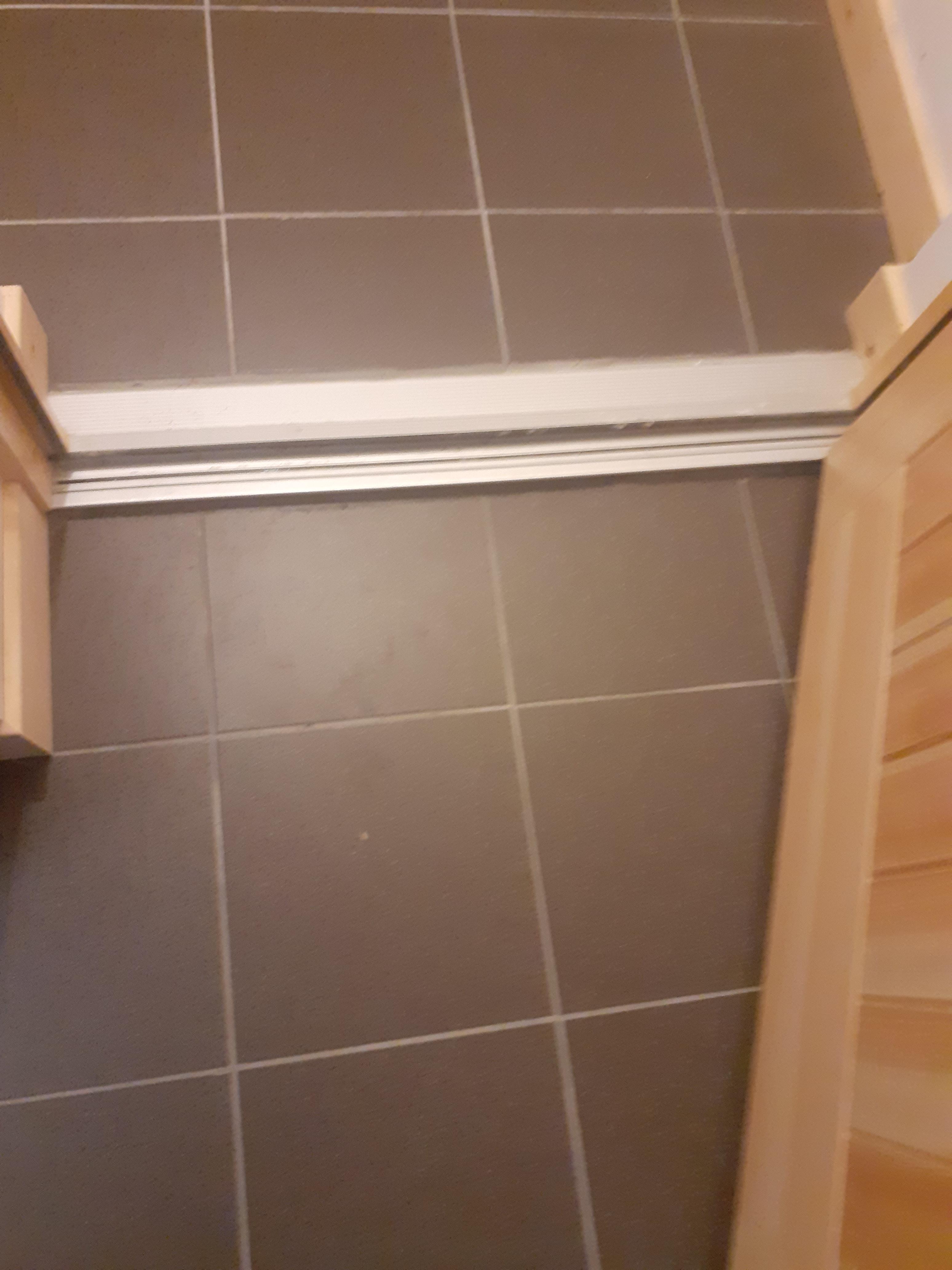

jamieled Posted December 7, 2021 Posted December 7, 2021 (edited) I used a small ish local company called treecraft woodwork (we used them for our front door as well). There's probably quite a few decent joinery shops around that could do this though. It wasn't cheap, only a bit cheaper than an external door, but it does look good. The door has some insulation in it to provide a thermal break which is important for us. House temp is around 18 degrees, larder temp currently about 4! Couple of photos below. Edited December 7, 2021 by jamieled 1
