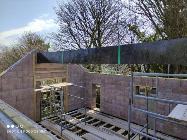

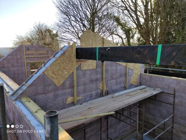

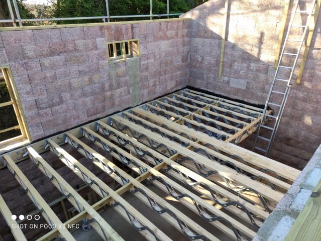

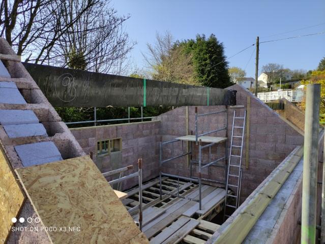

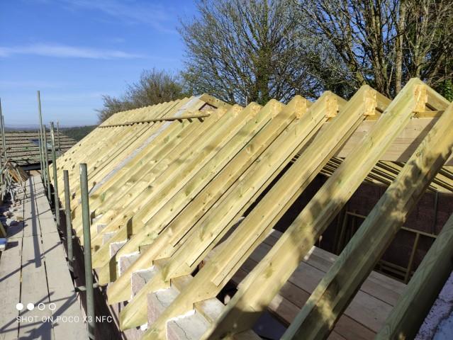

Have done the final pour today and fitted the glulam ridge beams, all went well so happy days will get the wall plates fitted tomorrow and will start the roof weekend.
I PU glued the blocks for the gables so the beams could be sat in place and this worked a treat. Also managed to get the floor joist fitted this week. So good progress?

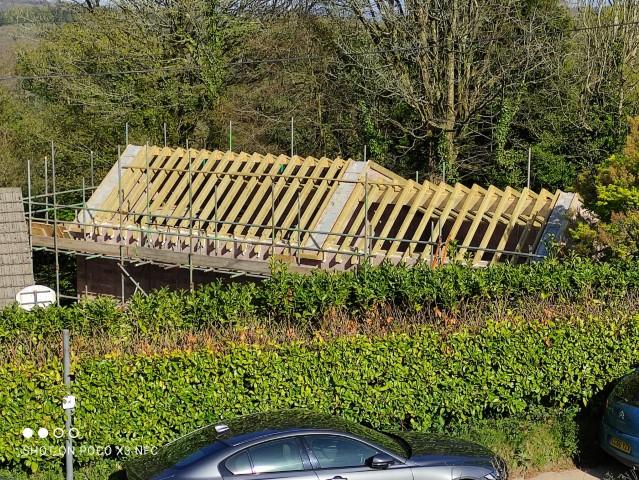

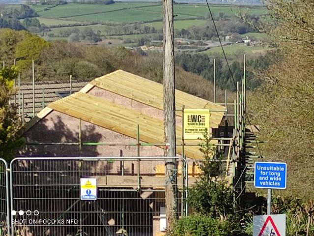

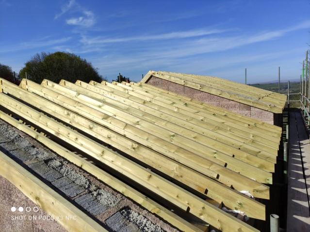

Hi its been a hard week or so it seams but have managed to get the roof cut in and ready for felt and batten so progress made if but slow. I went up to the train station platform to see how much of the view the house blocked as this was the only objection to planning from the ANOB the nimby group.

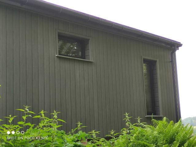

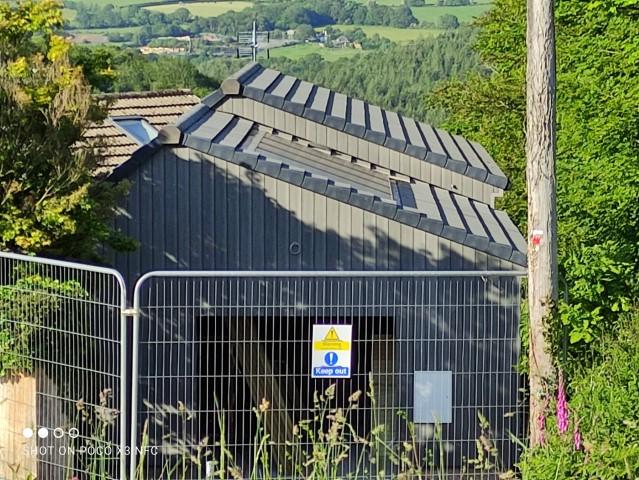

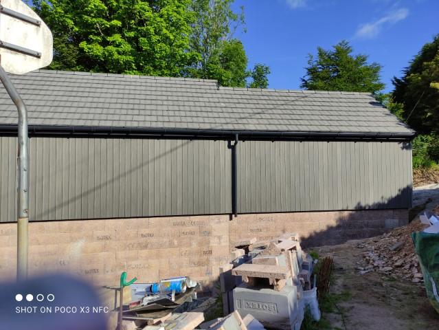

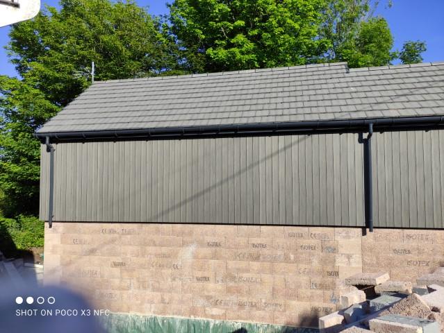

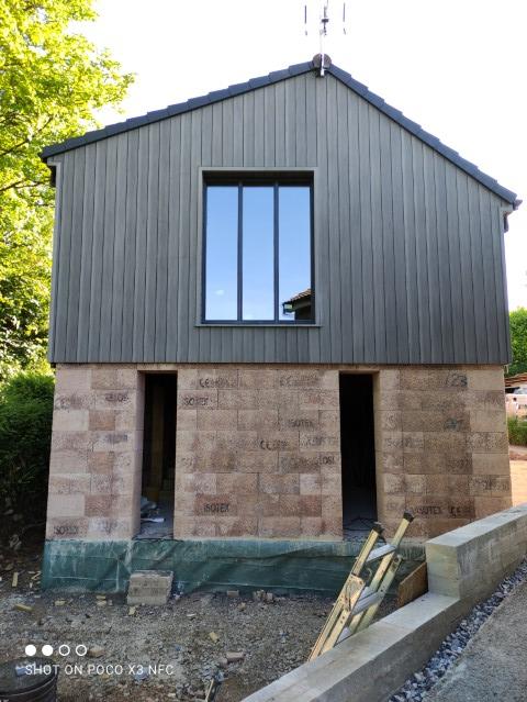

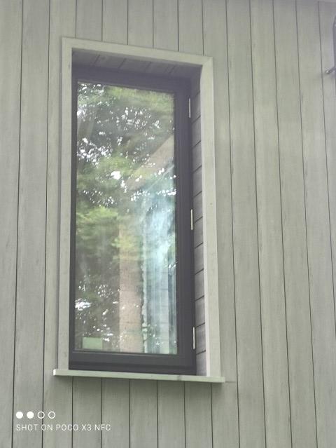

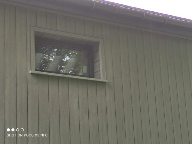

The last six weeks have been a bit of a slog but have finely got the roof finished, PV fitted and first floor cladding and windows fitted. Scaffolding came down yesterday 3 weeks longer than planed big hole in wallet. First floor chipboard flooring down so will start on the ground floor windows  and studwork. But now back to real work as well.
