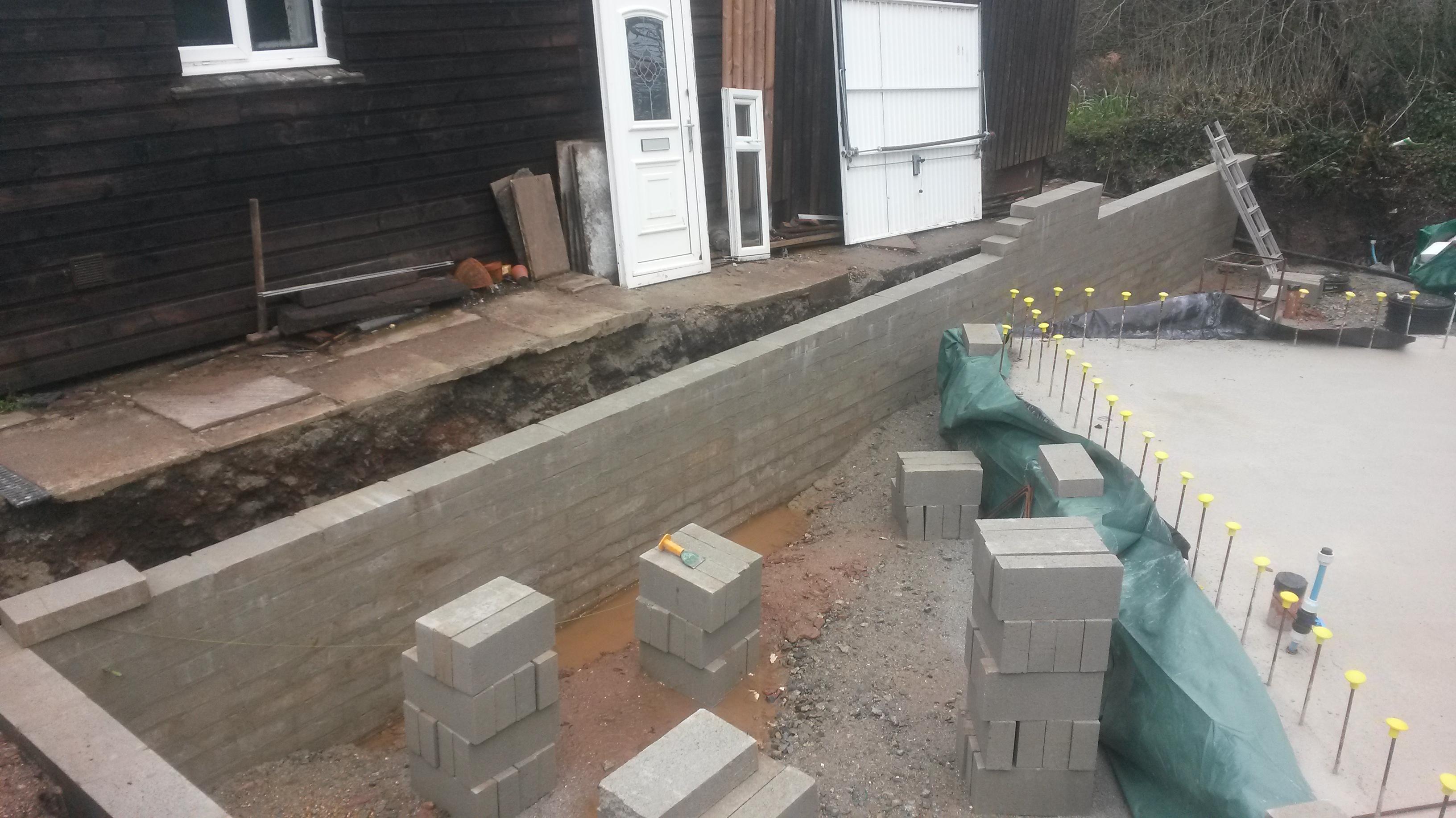

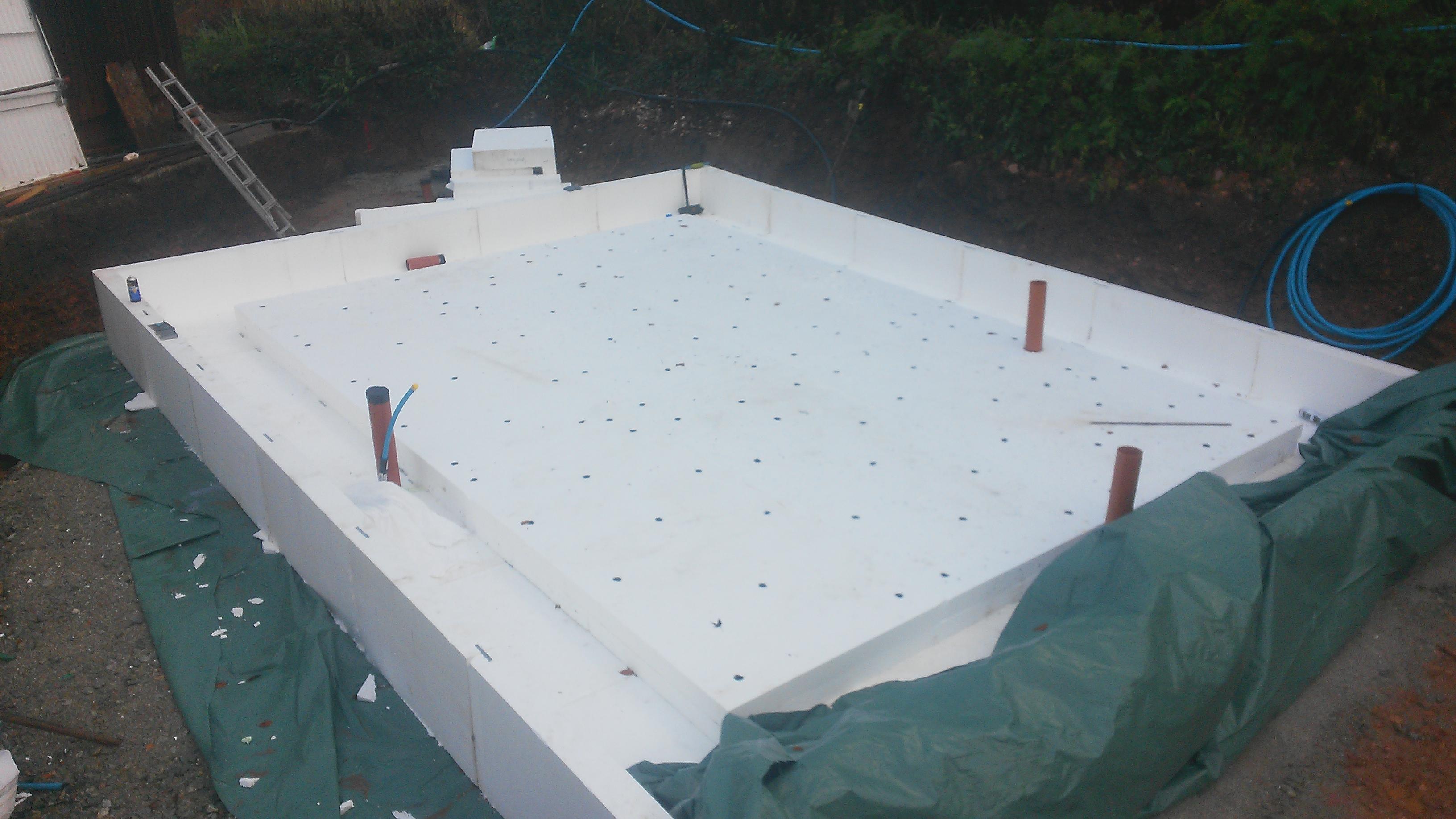

keith65 Posted January 4, 2021 Author Share Posted January 4, 2021 Hi and thanks for the welcome. Its a two story build but on a small plot next to a bungalow on a sloping sight so have to dig down a lot. So have gone for the isotex insulated raft and blocks as some is a retaining wall. So not low embodied carbon but hope to have very low emissions. I will up load some plans and pic later today we just managed to get the raft in before Christmas after shifting 400 tones of soil. Link to comment Share on other sites More sharing options...

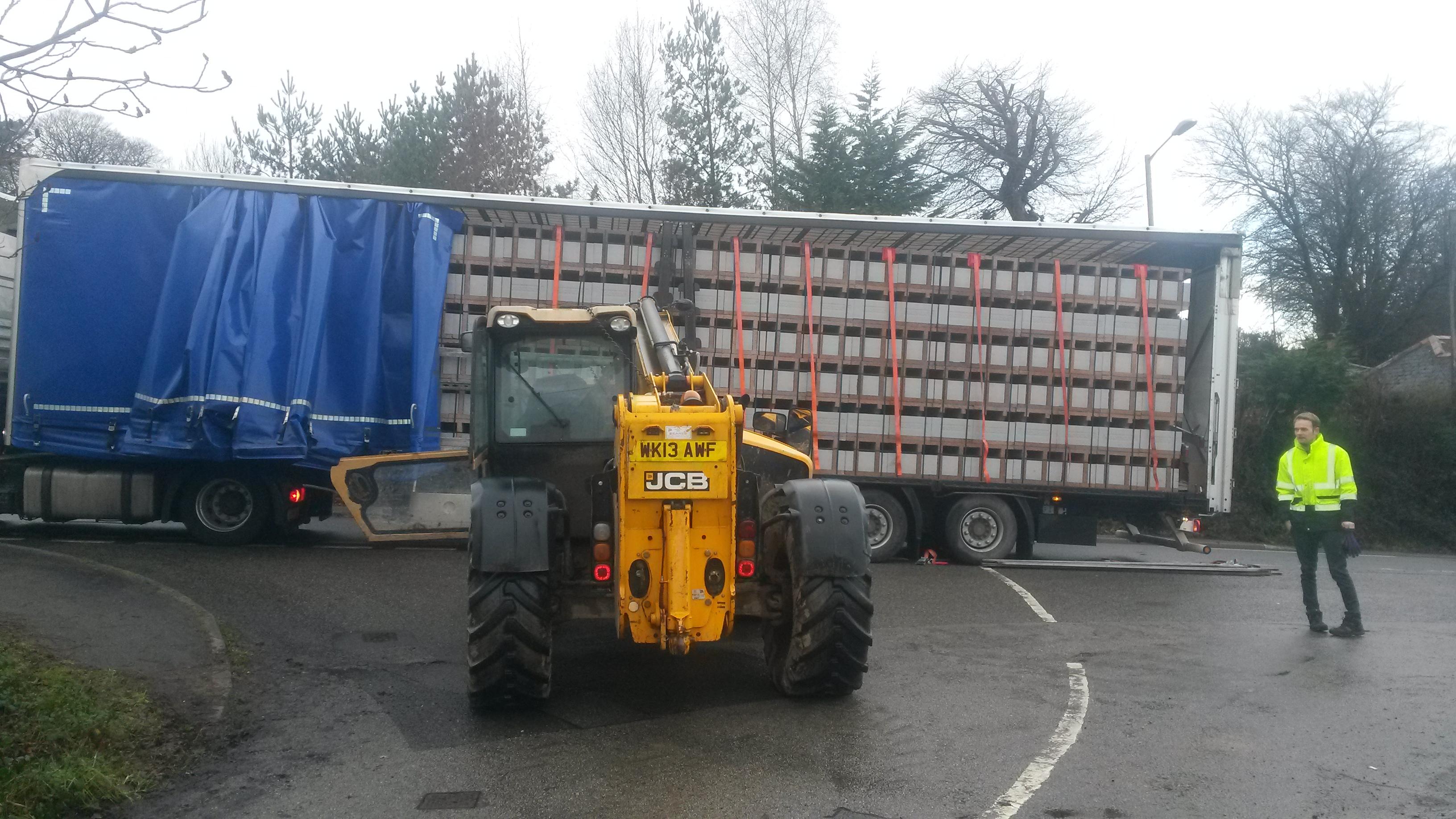

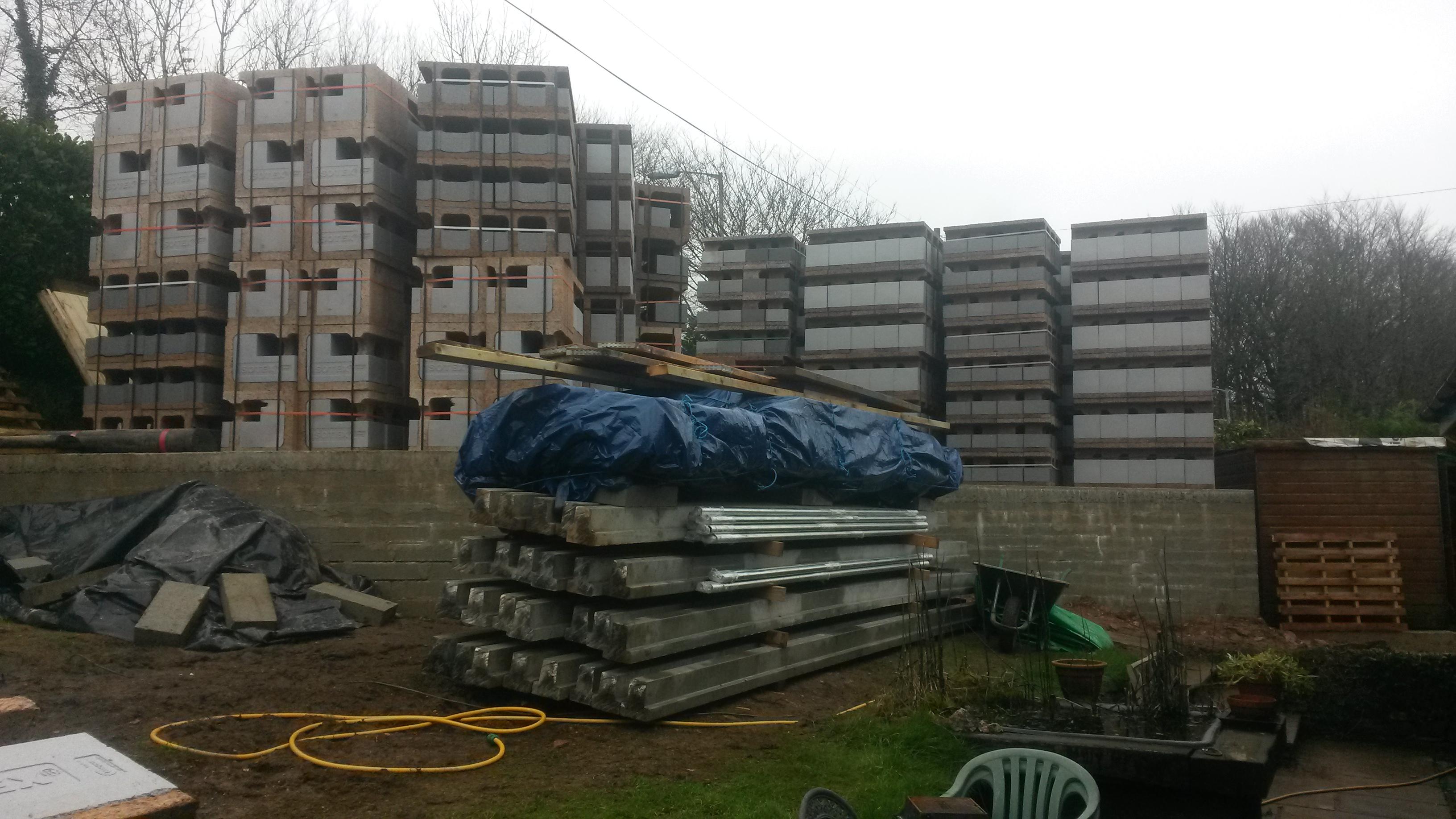

keith65 Posted January 21, 2021 Author Share Posted January 21, 2021 First load of Isotex block arrived today! Just need to finish the retaining wall to ground level and can start building? 1 Link to comment Share on other sites More sharing options...

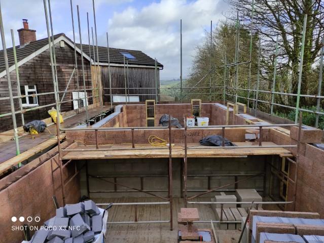

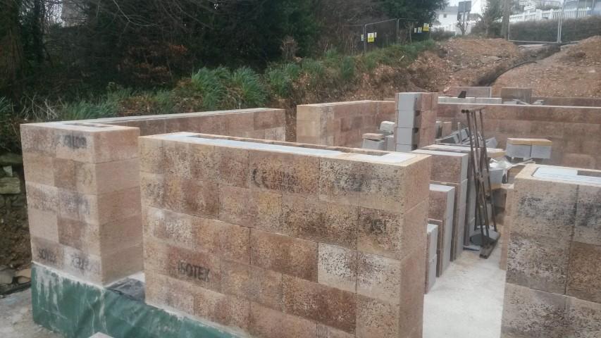

keith65 Posted February 21, 2021 Author Share Posted February 21, 2021 Hi Walls are going up a lot of shifting about as small sight and no space and access for forks so all hand ball. Should be ready for the first pour this coming week. I have the bracing and rebar to cut to be ready. Looks like we may get some dry days can`t believe the rain we have had since we got started. 4 Link to comment Share on other sites More sharing options...

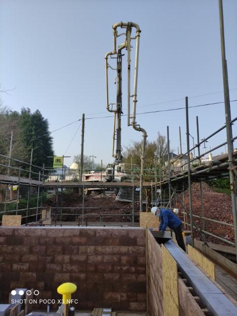

keith65 Posted March 2, 2021 Author Share Posted March 2, 2021 Hi Have done the first pour today and all went well and no blowouts so happy days ? Must say a big thanks to Dennis from Insul Hub for all the help. Sleepless night before hand and concrete came late as a brake down at plant but all done and cleaned up by 2pm. 4 Link to comment Share on other sites More sharing options...

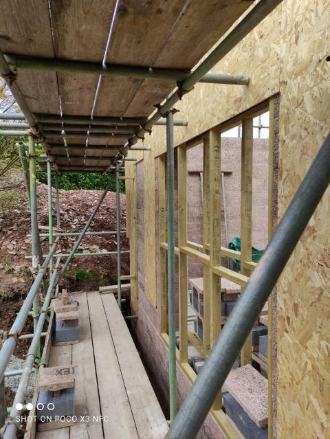

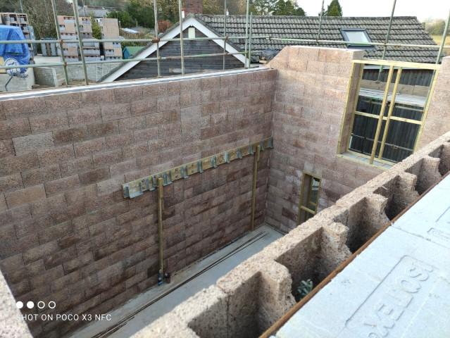

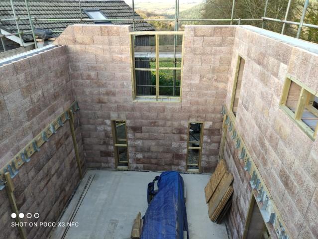

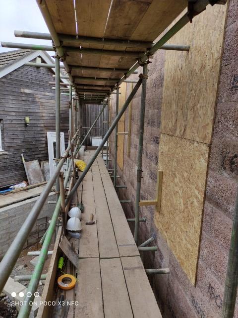

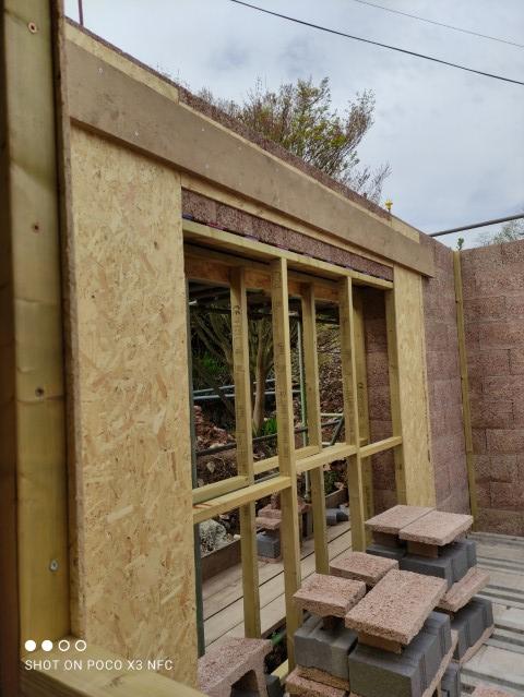

keith65 Posted April 2, 2021 Author Share Posted April 2, 2021 Hi have got up to wall plate and braced the walls, also fitted the pole plates to the walls for the floor joist so the fixings will be set into the concreate. The second pour was Thursday and all went well, so will be building up the gables over the Easter brake and then onto cutting in the roof. So making some progress. 4 Link to comment Share on other sites More sharing options...
Chanmenie Posted April 6, 2021 Share Posted April 6, 2021 You are clearly not taking any chances keith, that looks a lot more bracing than is usually specified, but well worth it for the piece of mind Link to comment Share on other sites More sharing options...
keith65 Posted April 6, 2021 Author Share Posted April 6, 2021 (edited) Talking to the fitters from Isotex it would seem to be about what you should use if your are pouring 10 courses one side was 11 so better to be safe. I have had two pours and all been ok so worth taking the time as I still did not sleep well the night before? Edited April 6, 2021 by keith65 1 Link to comment Share on other sites More sharing options...
SteamyTea Posted April 6, 2021 Share Posted April 6, 2021 Are you going to put some glazing into the opening's bracing. You seem to have a better fit that a window company. 3 hours ago, keith65 said: I have had two pours One drekley after the other? Link to comment Share on other sites More sharing options...
keith65 Posted April 7, 2021 Author Share Posted April 7, 2021 I have made the windows and they are sitting in the workshop ready to be fitted after I have cut the roof in. The second pour was a couple of weeks later so drekley as they say. 1 Link to comment Share on other sites More sharing options...
