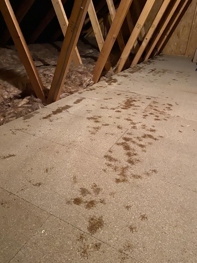

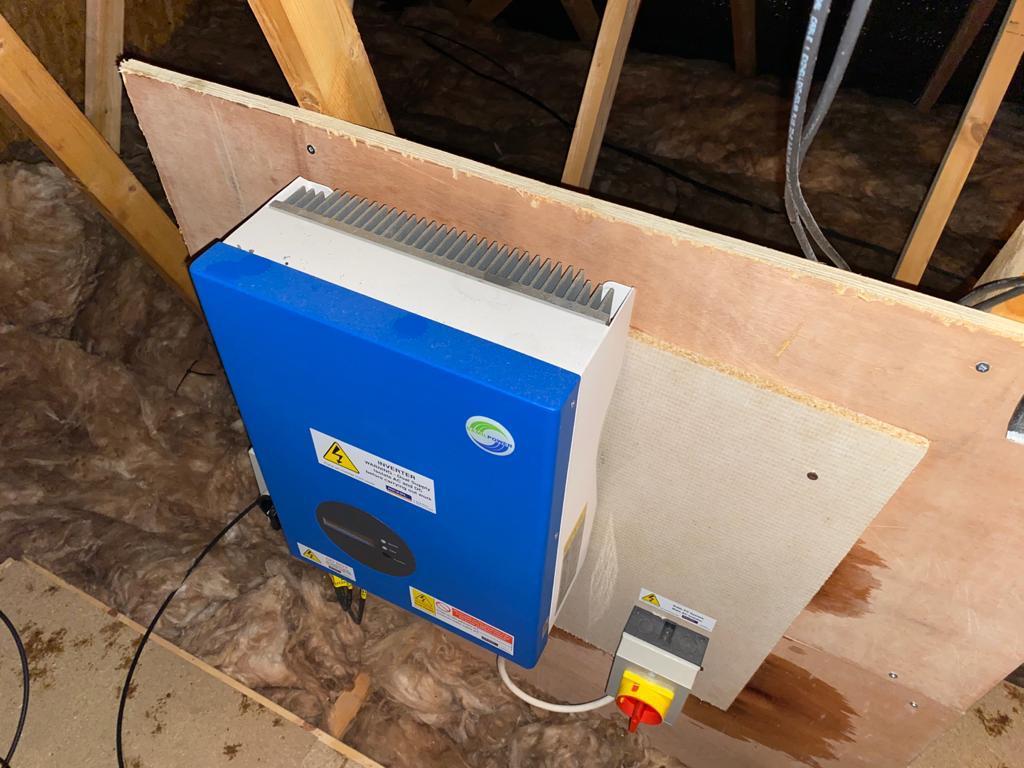

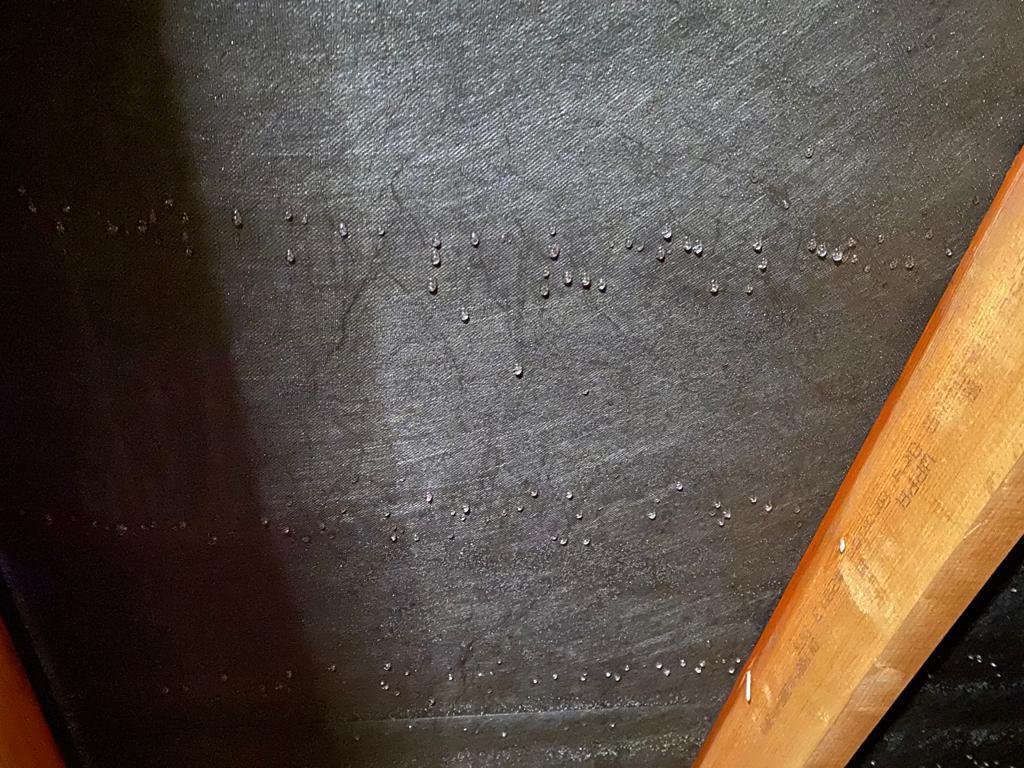

nod Posted January 2, 2021 Posted January 2, 2021 Just had a call from our daughter Roof is leaking She’s recently moved into a two year old RedRow home From the photos it looks like pretty bad condensation She has inset solar panels on the opposite side of the roof All was dry up there when I fitted an Ariel 6 weeks ago Like most we’ve had freezing temps and a Flurry of snow this afternoon Im going up there tomorrow But the reason for posting is could it be anything to do with the solar Its so difficult to tell from photos But any input would help
tonyshouse Posted January 2, 2021 Posted January 2, 2021 Don’t panic, does it dry out again during the following day? I think yes. I dint like it dripping on the solar inverter, fix something above it to divert the drips and may as well protect the ply boards and switch too. to eliminate solar, is it happening on both sides of the roof? Are they leaving the loft trap ajar? 1
AliG Posted January 2, 2021 Posted January 2, 2021 (edited) There are many different roof build ups, but I am used to seeing sarking boards with gaps to let moisture out of the roof. Is there any ventilation in the roof space? Or a VCL layer below it? Edited January 2, 2021 by AliG 1
nod Posted January 2, 2021 Author Posted January 2, 2021 5 minutes ago, tonyshouse said: Massive bonus points for uncluttered loft Ha ha It’s not happening on both side The hatch was my first thought I’ve asked her if it is warm up there Her reply was Freezing While I’m a builder she’s an accountant So warm air could be getting in Id expect everything to be cold up there there Ive never seen condensation that bad in a loft before I will no better tomorrow
Mr Punter Posted January 2, 2021 Posted January 2, 2021 It is warm moist air getting in from the house. Probably no vapourcheck at ceiling level and maybe holes for lights etc. Is the top of the wall cavity closed off? Often have plasterboard on dabs letting air in from below. 1

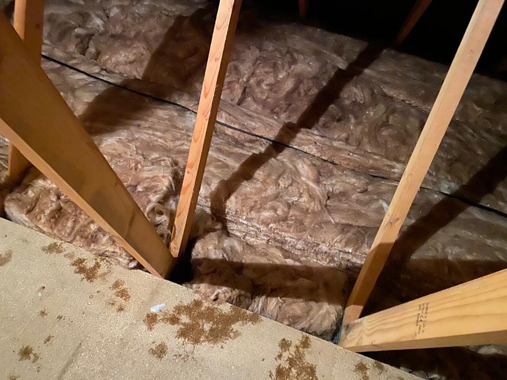

nod Posted January 2, 2021 Author Posted January 2, 2021 7 minutes ago, Mr Punter said: It is warm moist air getting in from the house. Probably no vapourcheck at ceiling level and maybe holes for lights etc. Is the top of the wall cavity closed off? Often have plasterboard on dabs letting air in from below. Good point also As I stated above the house is two years old The previous owner has boarded out the loft and will have certainly removed some of the insulation We put 500 mil down There certainly isn’t that Thanks for the replies I will update this when I’ve had chance to look
nod Posted January 2, 2021 Author Posted January 2, 2021 13 minutes ago, AliG said: There are many different roof build ups, but I am used to seeing sarking boards with gaps to let moisture out of the roof. Is there any ventilation in the roof space? I would suspect that there is adequate ventilation But you never no with mass produced housing I’m leaning towards the previous owners having the insulation striped out for the loft boarding Both where busy doctors So it’s unlikely they would have done of themselves

MikeGrahamT21 Posted January 3, 2021 Posted January 3, 2021 In theory the roof membrane should be breather membrane, however you could put some small wedges in the laps to increase ventilation. I suspect moisture is coming through the ceiling into the loft and the membrane simply can’t disperse it fast enough, so it simply condenses and then drips. remember not all breather membrane is created equally, so try some methods such as the simple one I’ve suggested to increase airflow 1
