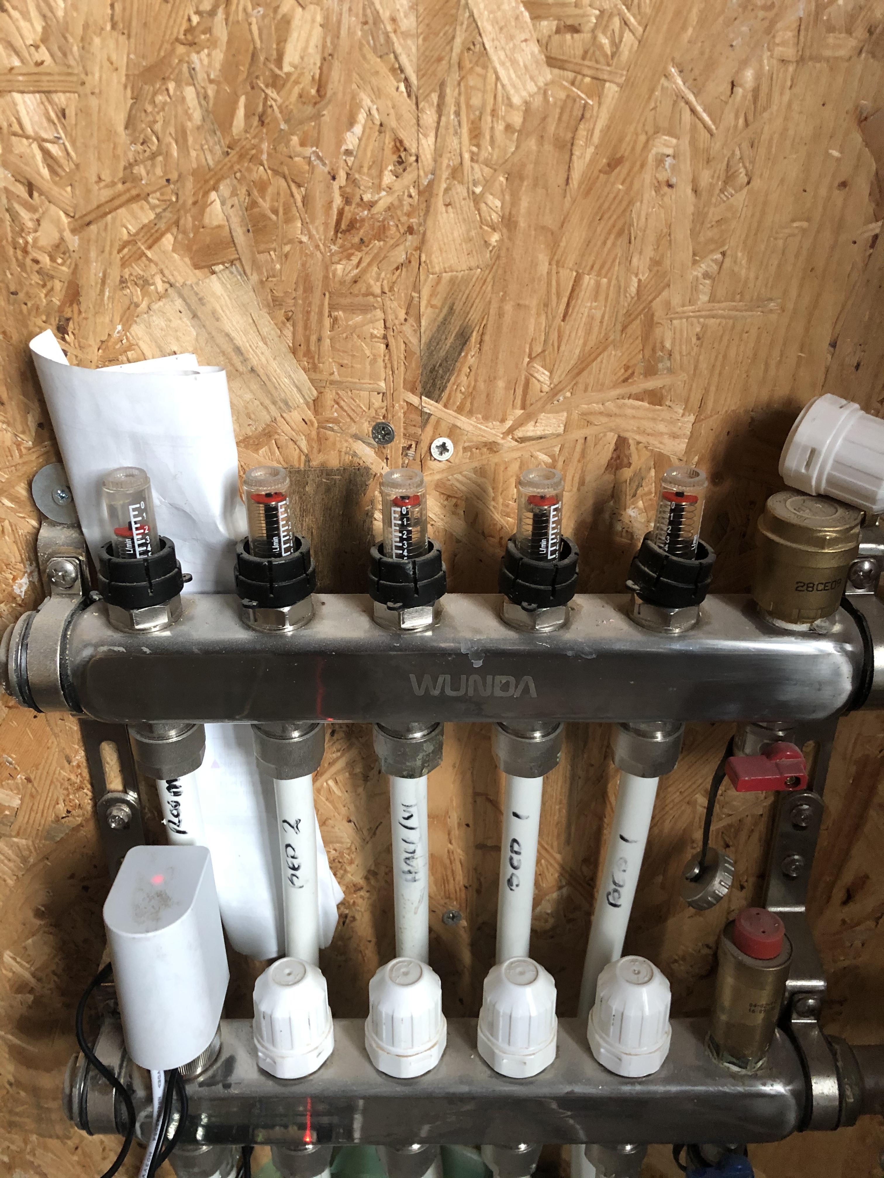

Gav_P Posted January 16, 2021 Posted January 16, 2021 My actuators are off until powered. The the top raises up - I assume it’s lift the pin of the actuator, which in turn lets the pin on the manifold raise opening the circuit.
ProDave Posted January 16, 2021 Posted January 16, 2021 Most manifolds, the pin is spring loaded and with nothing attached the pin is up and the flow is ON Most actuators push down on the pin and thus shut the water OFF when not energised. When you energise an actuator it's pad retracts, allowing the pin to push up under it's spring tension and turn the flow ON did you buy these 2 core actuators as something special e.g normally closed or normally open?
Pocster Posted January 16, 2021 Author Posted January 16, 2021 On 16/01/2021 at 15:06, Gav_P said: You should be able to see if the other zones are circulating by looking at the flow regs? Expand If you zoom in on my previous photo the flow regs can be seen
Pocster Posted January 16, 2021 Author Posted January 16, 2021 On 16/01/2021 at 15:44, ProDave said: Most manifolds, the pin is spring loaded and with nothing attached the pin is up and the flow is ON Most actuators push down on the pin and thus shut the water OFF when not energised. When you energise an actuator it's pad retracts, allowing the pin to push up under it's spring tension and turn the flow ON did you buy these 2 core actuators as something special e.g normally closed or normally open? Expand Not sure https://www.wundatrade.co.uk/shop/home/quick-shop/wundatherm-quick-shop/controls-quickshop/actuator-auto-balancing/
Gav_P Posted January 16, 2021 Posted January 16, 2021 I wunda (ha ha see what I did there ?) if the auto balancing bit is doing something clever with the 7 degree delta that it’s supposed to maintain?
Pocster Posted January 16, 2021 Author Posted January 16, 2021 On 16/01/2021 at 16:13, Gav_P said: I wunda (ha ha see what I did there ?) if the auto balancing bit is doing something clever with the 7 degree delta that it’s supposed to maintain? Expand Maybe . But I’m still confused ! ( not hard to do ) . It would seem actuator powered is zone off I.e pin down . But in that case pump should be off . or I’ve got this all wrong ( ? ) . Ignoring the clever delta stuff - power to actuator means zone on or off ....??
Gav_P Posted January 16, 2021 Posted January 16, 2021 On 16/01/2021 at 16:36, pocster said: Maybe . But I’m still confused ! ( not hard to do ) . It would seem actuator powered is zone off I.e pin down . But in that case pump should be off . or I’ve got this all wrong ( ? ) . Ignoring the clever delta stuff - power to actuator means zone on or off ....?? Expand Power on should be zone on and pump on.
Pocster Posted January 16, 2021 Author Posted January 16, 2021 On 16/01/2021 at 16:57, Gav_P said: Power on should be zone on and pump on. Expand That’s what i would assume . But that flow / return on the actuator zone was cold

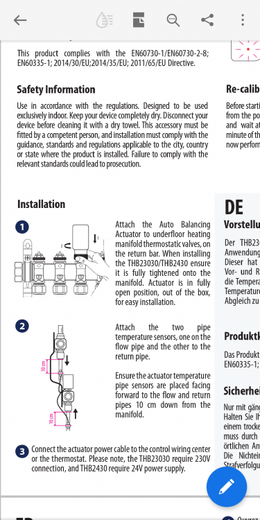

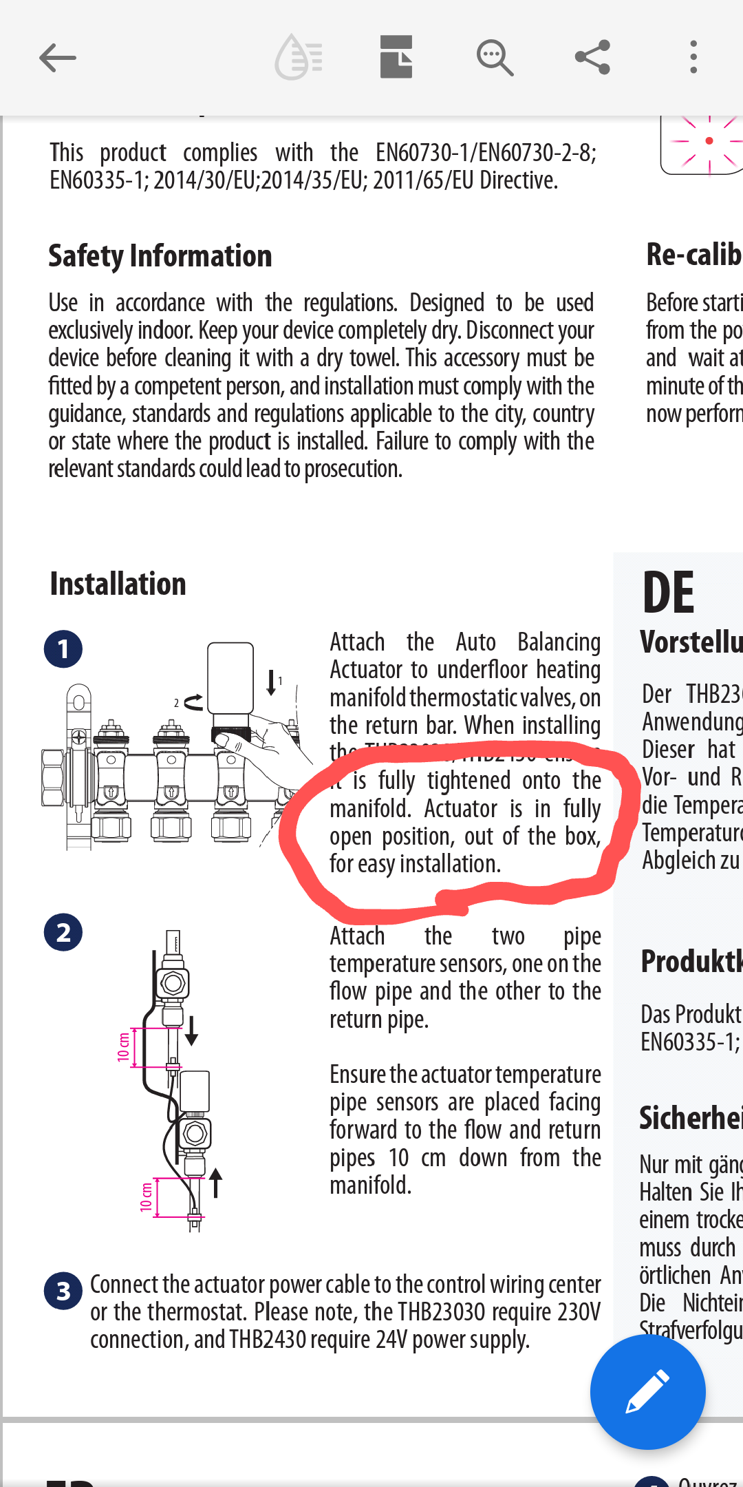

JFDIY Posted January 16, 2021 Posted January 16, 2021 (edited) Don't they come with the pin retracted for easy fitting. When powered up it releases then does the calibration exercise Edited January 16, 2021 by JFDIY
Pocster Posted January 16, 2021 Author Posted January 16, 2021 On 16/01/2021 at 20:09, JFDIY said: Don't they come with the pin retracted for easy fitting. When powered up it releases then does the calibration exercise Expand Yeah I think so . Did search the forum and found some other threads on the issue . Will experiment next week ? It was just strange that the return / flow on that zone were cold after a few hours - even though actuator was on .

Pocster Posted January 18, 2021 Author Posted January 18, 2021 Bathroom actuator on . Others screwed right down so no ( ok , very little flow ) . Bathroom a chilly 10 degrees . Going to leave this overnight see what happens by tomorrow.
JFDIY Posted January 18, 2021 Posted January 18, 2021 Try the re-calibration procedure, sounds like something went wrong when you first switched it on. You have to have stable or rising temperature on the hot side of manifold. Also if your floor was warm to start with it will have possibly fooled it with calculating the flow direction as water in return side was already hot. 1
Pocster Posted January 18, 2021 Author Posted January 18, 2021 (edited) On 18/01/2021 at 12:26, JFDIY said: Try the re-calibration procedure, sounds like something went wrong when you first switched it on. You have to have stable or rising temperature on the hot side of manifold. Also if your floor was warm to start with it will have possibly fooled it with calculating the flow direction as water in return side was already hot. Expand You might be right . Started it from all cold today and set re calibrate. Bathroom floor starting to warm up . Two temp sensors in bathroom ; one at 10.4 other at 11.3 . Floor doesn’t feel cold to the touch now . Edited January 18, 2021 by pocster 1
Pocster Posted January 19, 2021 Author Posted January 19, 2021 Well 24hrs just the bathroom has been on and it’s gone from 10 degrees to 13.5 Ive got the ASHP on the lowest setting . Rather have it run efficiently than heat quicker . But does that sound correct??
JFDIY Posted January 19, 2021 Posted January 19, 2021 Is the rest of the house sapping the heat? I had issues with one of those actuators trying to get it to calibrate, the floor was always warm. In the end I loosened the body about one turn, did the calibration, then once completed tightened it back down on the manifold. Been fine since, I did email salus but never got a reply. I'd try running the calibration exercise a few times as I'm sure they get better each time. Failing that You could try the opposite of my bodge, but you'd need to just slacken the actuator to allow the pin to come up more after calibration to prove it. then contact wunda or salus to check if it's a common issue 1
ProDave Posted January 19, 2021 Posted January 19, 2021 On 19/01/2021 at 09:05, pocster said: Well 24hrs just the bathroom has been on and it’s gone from 10 degrees to 13.5 Ive got the ASHP on the lowest setting . Rather have it run efficiently than heat quicker . But does that sound correct?? Expand What is this "lowest setting"? do you mean you have the water temperature turned right down? What is the water temperature set to?
Pocster Posted January 19, 2021 Author Posted January 19, 2021 On 19/01/2021 at 10:00, JFDIY said: Is the rest of the house sapping the heat? I had issues with one of those actuators trying to get it to calibrate, the floor was always warm. In the end I loosened the body about one turn, did the calibration, then once completed tightened it back down on the manifold. Been fine since, I did email salus but never got a reply. I'd try running the calibration exercise a few times as I'm sure they get better each time. Failing that You could try the opposite of my bodge, but you'd need to just slacken the actuator to allow the pin to come up more after calibration to prove it. then contact wunda or salus to check if it's a common issue Expand Rest of house has zero heating so it’s highly possible the heat is just leaving the bathroom ( no doors anywhere ) and just heating the entire build . I’ll leave it another 24 hours
Pocster Posted January 19, 2021 Author Posted January 19, 2021 On 19/01/2021 at 10:09, ProDave said: What is this "lowest setting"? do you mean you have the water temperature turned right down? What is the water temperature set to? Expand 30 I believe
ProDave Posted January 19, 2021 Posted January 19, 2021 On 19/01/2021 at 10:10, pocster said: Rest of house has zero heating so it’s highly possible the heat is just leaving the bathroom ( no doors anywhere ) and just heating the entire build . I’ll leave it another 24 hours Expand Very likely. For a long time early in the build we had cardboard doors on most of the rooms. 1
