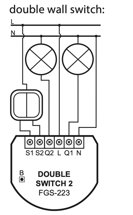

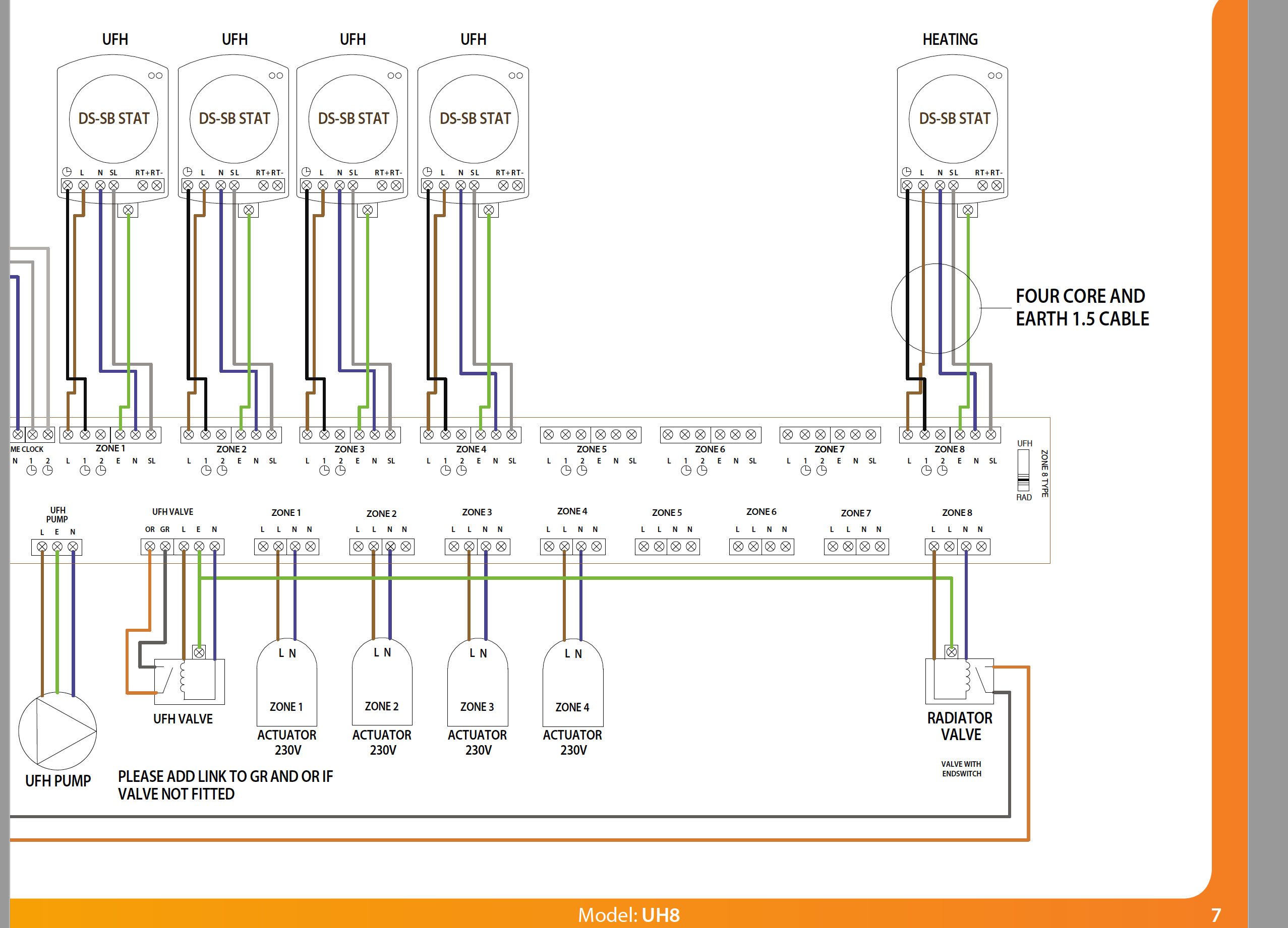

Pocster Posted January 1, 2021 Posted January 1, 2021 (edited) Preparing to wire up and automate my wet UFH I've purchased some actuators to sit on the manifold https://heatmisershop.co.uk/underfloor-heating-actuator-heatmiser-ta230/ A wiring centre https://heatmisershop.co.uk/heatmiser-uh8-8-zone-230v-underfloor-heating-wiring-centre/ Apparently it's easier to use this as it will turn on/off the ufh pump based on whether actuators are open or not i.e. one less thing for me to mess up Then to control each actuator https://www.vesternet.com/products/z-wave-fibaro-double-switch-2-gen5?utm_campaign=order-confirmation-email&utm_medium=email&utm_content=product&utm_term=link&utm_source=OrderlyEmails All 230v stuff. So! The wiring to the wire centre and pump seems simple enough, as does to the actuators. The fibaro double relay confuses me though on how this is wired to the wiring centre It's 1 fibaro for 2 zones as it's a double relay N to neutral obviously L to live Both the above on fibaro and wiring centre zone input Q1 to SL 1 for zone 1 Q2 to SL 2 for zone 2 That in essence it? Assuming that's correct I presume I should take 1 mains input to some kind of multi connector so that each fibaro comes off that; any suggestions what is best to use for that? Just a standard terminal block? Any advice or fear welcome! Edited January 1, 2021 by pocster
Pocster Posted January 1, 2021 Author Posted January 1, 2021 Perhaps some kind of Wago junction box???

Temp Posted January 1, 2021 Posted January 1, 2021 (edited) Ok so I've had a look at the Fibaro manual here.. https://manuals.fibaro.com/content/manuals/en/FGS-2x4/FGS-2x4-T-EN-1.0.pdf It has two relay outputs (Q1 and Q2) but the other relay terminals inputs appear to be connected together internally to the IN terminal. That makes it slightly more difficult to use both channels but not impossible. I think it would be necessary to use Room Thermostats that have volt free relay contacts (eg not the stat shown on the Heatmiser wiring diagram you posted as that only has a switched live output). Firstly I would power both the Fibaro and the room stat from the wiring centre L & N. The control signal path I would wire up as follows. The basic logic pathway would be... Live > Fibaro > Room Stat > Wiring Centre > Actuator Wiring would be.. 1) L on Wiring Centre ------> Fibaro IN (Can be a jumper/link at the Fibrao) 2) Fibaro Q1 output -------> Stat 1 Relay Input 3) Stat 1 Relay Output ------> Switched Live 1 on WC Then for the other channel just need 4) Fibaro Q2 output -------> Stat 2 Relay Input 5) Stat 2 Relay Output ------> Switched Live 2 on WC In operation this would mean that the UFH Loop actuator would only be enabled when both the Fibaro AND the room stat call for heat. I assume you would never want the Fibaro to over rule the room stat and call for heat when room stat was already satisfied. The opposite is possible (eg Fibaro turn off heat when stat isn't satisfied). Edited January 1, 2021 by Temp 1
Temp Posted January 1, 2021 Posted January 1, 2021 Occurs to me that for the above to be possible you may need more wires to the room stat than planned. L & N to power the stat then wires 2) and 3) above. That's a 4 core and earth rather than a three core and earth. 1
Pocster Posted January 1, 2021 Author Posted January 1, 2021 (edited) 12 minutes ago, Temp said: Ok so I've had a look at the Fibaro manual here.. https://manuals.fibaro.com/content/manuals/en/FGS-2x4/FGS-2x4-T-EN-1.0.pdf It has two relay outputs (Q1 and Q2) but the other relay terminals inputs appear to be connected together internally to the IN terminal. That makes it slightly more difficult to use both channels but not impossible. I think it would be necessary to use Room Thermostats that have volt free relay contacts (eg not the stat shown on the Heatmiser wiring diagram you posted as that only has a switched live output). Firstly I would power both the Fibaro and the room stat from the wiring centre L & N. The control signal path I would wire up as follows. The basic logic pathway would be... Live > Fibaro > Room Stat > Wiring Centre > Actuator Wiring would be.. 1) L on Wiring Centre ------> Fibaro IN (Can be a jumper/link at the Fibrao) 2) Fibaro Q1 output -------> Stat 1 Relay Input 3) Stat 1 Relay Output ------> Switched Live 1 on WC Then for the other channel just need 4) Fibaro Q2 output -------> Stat 2 Relay Input 5) Stat 2 Relay Output ------> Switched Live 2 on WC In operation this would mean that the UFH Loop actuator would only be enabled when both the Fibaro AND the room stat call for heat. I assume you would never want the Fibaro to over rule the room stat and call for heat when room stat was already satisfied. The opposite is possible (eg Fibaro turn off heat when stat isn't satisfied). There is no room stat connected ; it's a wireless device. So the HA would simply ( wirelessly ) trigger the Fibaro. My potentially flawed logic was the fibaro acts as the room stat i.e. just switches the actuator on/off via the writing centre. For the moment I just want to wirelessly control the fibaro which intern activates the actuator. Actually adjusting to temperature/usage of the room etc. I'll add later. Edited January 1, 2021 by pocster

PeterW Posted January 1, 2021 Posted January 1, 2021 You’ve bought the integrated Heatmiser system - why..?? That wiring centre isn’t dumb so you’re going to have issues with the Fibaro I reckon - you just needed a really basic wiring centre as that has loads of built in functions that you will need to override. Have you installed it ..?
Temp Posted January 1, 2021 Posted January 1, 2021 25 minutes ago, PeterW said: You’ve bought the integrated Heatmiser system - why..?? That wiring centre isn’t dumb so you’re going to have issues with the Fibaro I reckon - you just needed a really basic wiring centre as that has loads of built in functions that you will need to override. Have you installed it ..? It looks virtually identical to my Heatmiser wiring centre and isn't complicated. Nothing in it to program or override. For example the timer stuff mentioned in the manual needs a separate time clock that does all that stuff. If you don't have that timer the wiring Centre itself is basically just a big OR gate to control the pump. 1
PeterW Posted January 1, 2021 Posted January 1, 2021 7 minutes ago, Temp said: It looks virtually identical to my Heatmiser wiring centre and isn't complicated. Nothing in it to program or override. For example the timer stuff mentioned in the manual needs a separate time clock that does all that stuff. If you don't have that timer the wiring Centre itself is basically just a big OR gate to control the pump. Not how I read this ..? On board the UH8 are two heating time channels, each zone allows you to specify which time channel it should follow. 2 additional time channel connections are provided for hot water control or other auxiliary devices.
Temp Posted January 1, 2021 Posted January 1, 2021 (edited) 15 minutes ago, PeterW said: Not how I read this ..? On board the UH8 are two heating time channels, each zone allows you to specify which time channel it should follow. 2 additional time channel connections are provided for hot water control or other auxiliary devices. Clever marketing I'm afraid. The "channels" are just wires inside the wiring centre. They go from clock inputs to the connectors for the room stats. No timer inside. Some people will have one time clock connected to the wiring centre so they would connect all stats to the ?1 pin. Others want upstairs and downstairs to be controlled by different clocks so the upstairs stats might be connected to the ?1 pin and downstairs to the ?2 pin. If you have fully programmable room stats with built in timers (like me) or a HA system you just ignore those clock terminals and connect the stats/Fibaro to L&N. Edited January 1, 2021 by Temp 1
PeterW Posted January 1, 2021 Posted January 1, 2021 And that’s why I steer well clear of that brand ..!!! So £75 gets this, when you can get the same functions for half that without the HM sticker on it ... 1
