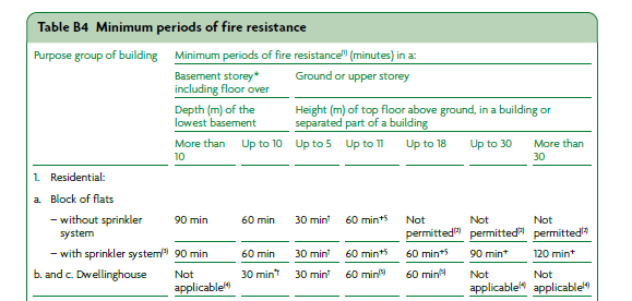

Anything over The beams need 60 minutes protection
Yet again this is incorrect, single storey buildings do not require fire resistance,.
Two storey buildings of any type most definitely require fire resistance, and this is dependent on their use, height and whether they are sprinklered this can be 30. 60, 90 or 120 minutes.
In the vast majority of domestic dwelling houses this is 30 minutes, unless a floor level is over 5m in height then one hour applies.

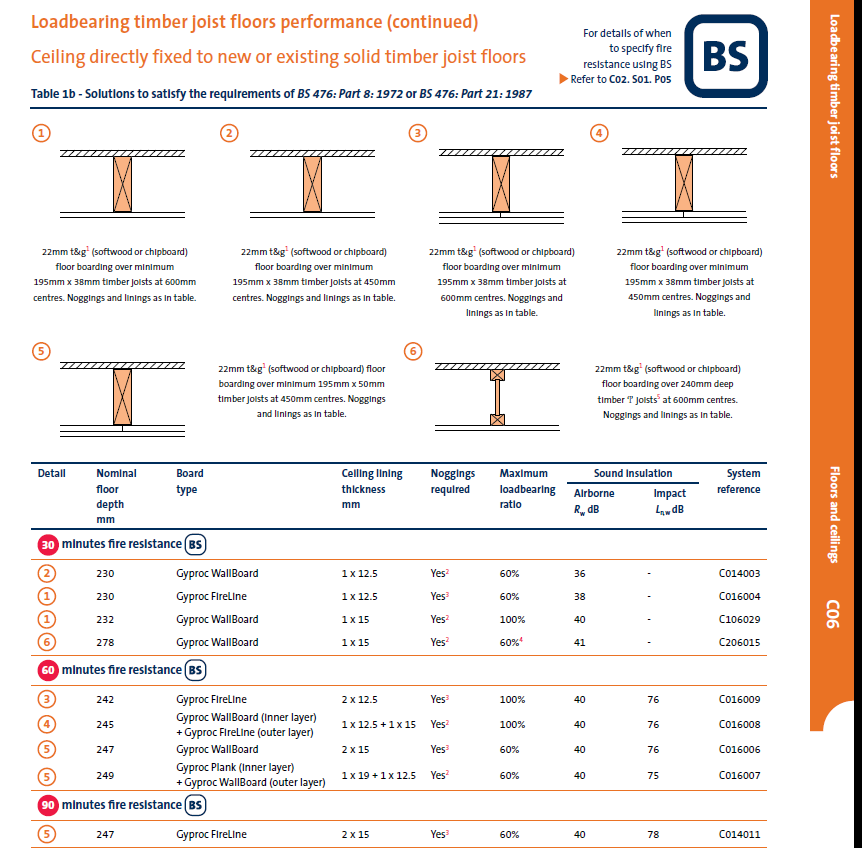

On the other hand if you have fixed your plaster board to big solid joists with good "chunky dwangs (noggins) then your ok. Below is a link to the British Gypsom White book.
https://www.british-gypsum.com/literature/white-book/floors-and-ceilings
There is lot's of good info in the white book for example, often worth just a rough peruse.
A good example of the above is to look at page C6 SO6 P04 Here you can see how you can get your 30 min with their product but the info they give only covers you for certain joist sizes and floor thickness etc.  I have screen shotted part of the page above. The big solid joists etc contribute to the integrity. the plaster board etc to the "insulation" giving the "fire resistance"

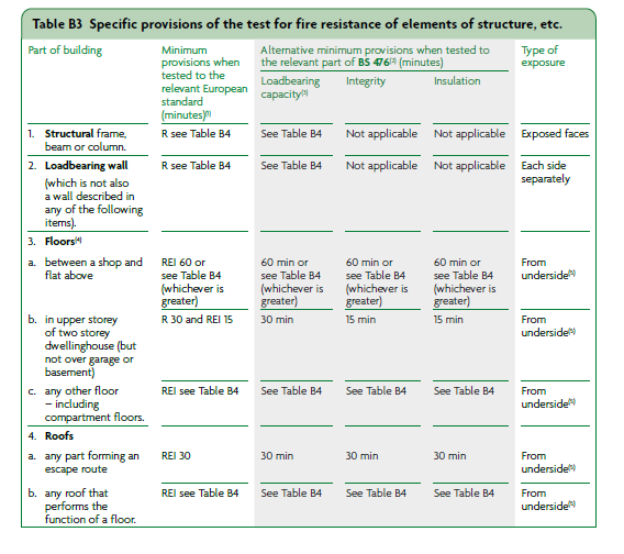

Hi, just bringing this subject back up with a quick q.
Self building bungalow with habitable first floor (attic) level below 5m height. Lots of steel in attic for purlins and to support dormer walls.
I have installed metal stud frames for walls, the top railings of a couple of which I glued to the lower face of the beams with the idea that when we plaster board we will also cover all steel for fire protection. Rockwool to go inside walls.
Plaster boarder visited yesterday for quote and says I MUST take the railings off to first box in the steel. Is that right? Does not make sense to me given what I have read.
I kept asking why the impacted beams must be boxed in rather than be enclosed within the wall space but best he had was it was British Gypsum training/work requirement.
FYI I also ended up arguing with him about not needing to double board for boxing in(but happy with fire rated).
Also wanted to double board the ceiling as have some thin steel C-sections used as rafters. Still think 15mm or fire rated boards
should be fine for the ceiling.
It is my own house and will have kids living there but at the same time i don’t want to do something which is completely unnecessary. 30-45 mins is plenty to escape through windows (and we are also fire rating/protecting the stair case for extra measure) but just do not want to listen to someone saying I MUST build it like a 3 storey block of flats if I don’t really have to.
Thanks in advance for any advice!

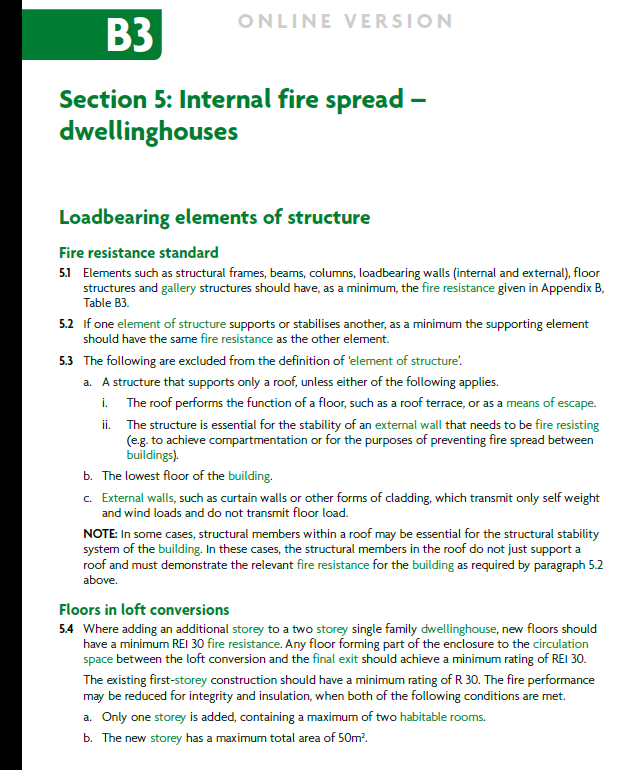

Have copied extracts from the regs below for reference.
Thanks - that all seems to back up my rudimentary understanding, which could be summarised as:
Single dwelling house of 2 stories (<11m) = 30min fire protection to elements which hold up floors, walls or escape routes.
Fire protection to roofs not necessary.
I suppose the question is, does the dormer class as a wall, or is there further structural support offered by the roof which would warrant fire protection?

Hi George. Good summary but where folk get confused is when say a beam that on first appearance seems to be carrying only vertical loading suddenly needs a lot more fire protection, often jumping to one hour when you have a boundary condition. The reason is that often it may be providing lateral restraint to another element of the structure that relies on this lateral support to maintain stability during and after (not covered in the regs but good design should consider keeping our emergency services safe) a fire.
I posted earlier some extracts from the English regs earlier (not checked the NI regs yet but assume they say the same). Clause 5.2 covers this. The Scottish regs are similar in this respect.
The dormer? My starting point would be to ask.. is the dormer part of the roof / rafters? Is it sacrificial like the rest of the pitched part of the roof. I makes no logical sense that you can let the rest of the roof burn away but have to fire protect the dormer cheeks to a more onerous level as the support stucture for the dormer would have burnt away.
