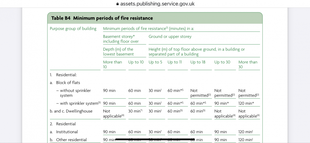

So on the basis that the steel beam is structural, is it OK to just have have it in the floor zone with plasterboard on the underside to give the 30 mins or 60 mins protection required?  I sometimes get asked to spray with intumescent coating or encase the whole in plasterboard.  It is hard to find consistent advice.  The intumescent coating only works if you leave space around the beam, which in domestic floor zones can be impossible, but BC don't seem concerned with that aspect.
The product manufactures understandably tend to just promote and test systems that include lots of their product.
57 minutes ago, PeterW said:
@juncopartner instead of playing the person - which you are - perhaps you could use your professional guidance and quote the correct regulations instead of telling everyone what the answer isn’t ..??
From ADB, 2020 amendments, a ceiling in a 2 storey residential class 1.(c) property doesn’t require anything more than 30 minutes fire resistance and this can be achieved with 12.5mm standard plasterboard. A steel enclosed in this floor space is therefore protects from the effect of fire and requires no further protection.
Correct or incorrect ..?

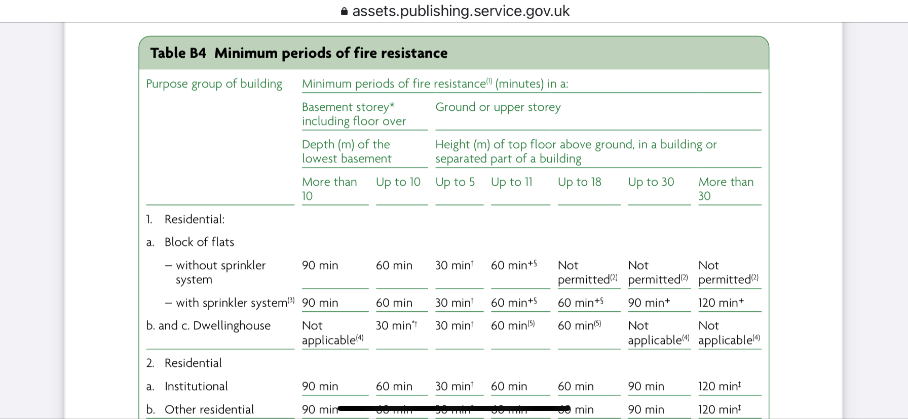

The requirement for fire protection is based on height (for English regs) as this table in Appendix B4 of Part B
Yes, it’s okay just to have it in the floor zone but see my comments in the first post I made in this thread, and as with anything to do with Building Regs it depends on the opinion of the Building Inspector.

Thanks both.  I have a project at present where the architect has specified intumescent paint to beams in a ceiling with 2 x 15mm plasterboard.  We need 60 mins but architect insisted.
What is the use of the building.
3 flats - 1 per floor.
