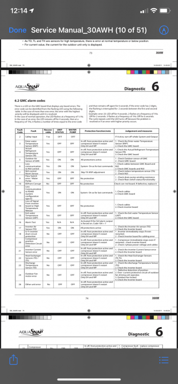

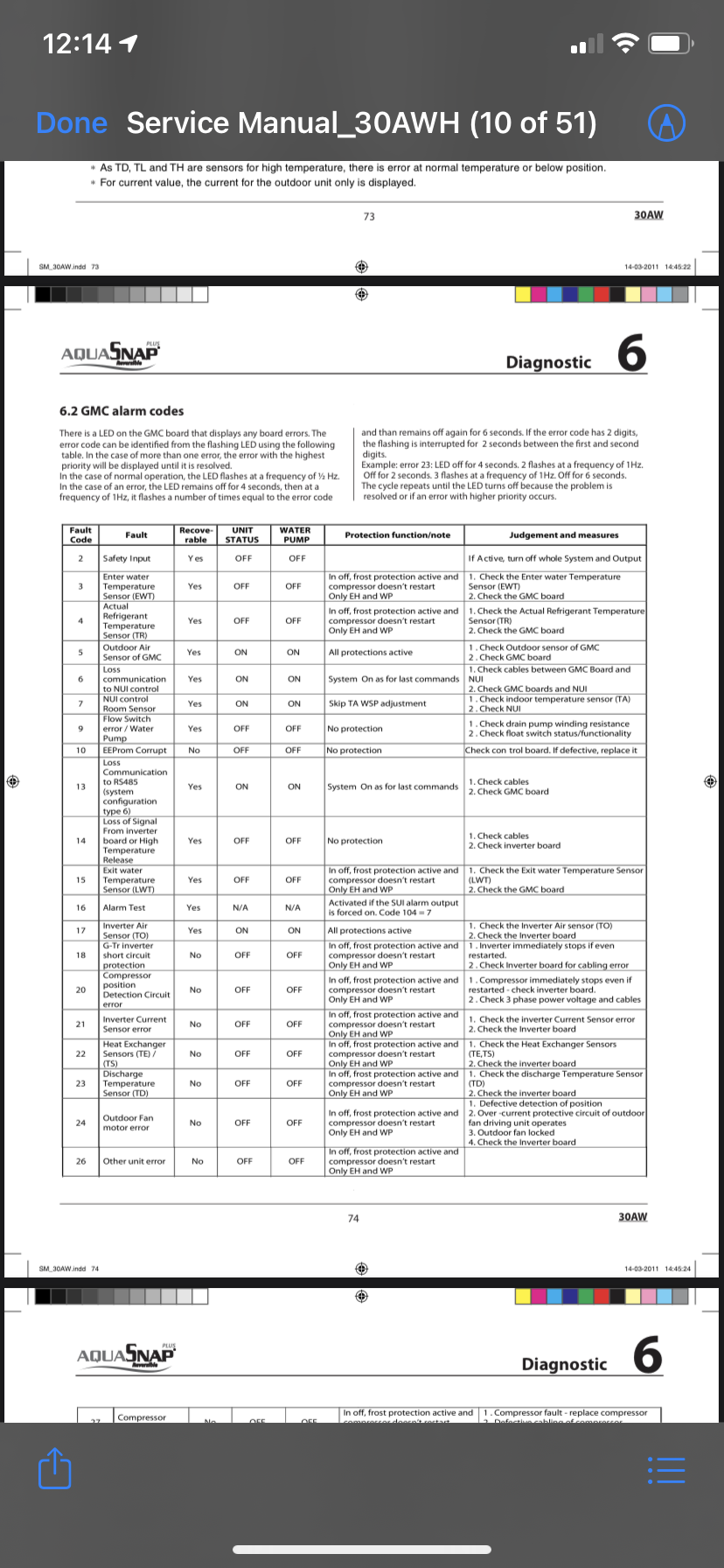

ProDave Posted December 22, 2020 Posted December 22, 2020 A quick google finds a fault code chart here https://www.manualslib.com/manual/876339/Kingspan-Aeromax-Plus-Air-Source-Heat-Pump-Package.html?page=10 Code 14 means "Loss of Signal From inverter board / High Temperature Release (Thermostat on compressor: 120° ± 4° C)" So unlikely to be related to a fault in the house plumbing.

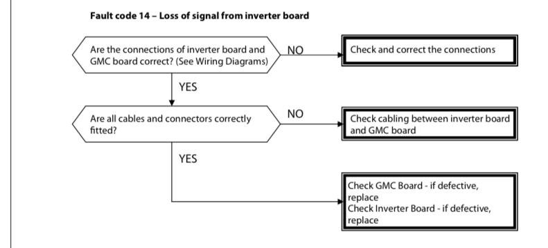

Gav_P Posted December 22, 2020 Posted December 22, 2020 (edited) Unfortunately the service manual doesn’t offer much of use either: Check cables check Inverter board Edited December 22, 2020 by Gav_P Change ‘gmc’ to ‘inverter’
Gav_P Posted December 22, 2020 Posted December 22, 2020 @joe90 any ideas? This is definitely one which @Jeremy Harris could have helped with.
