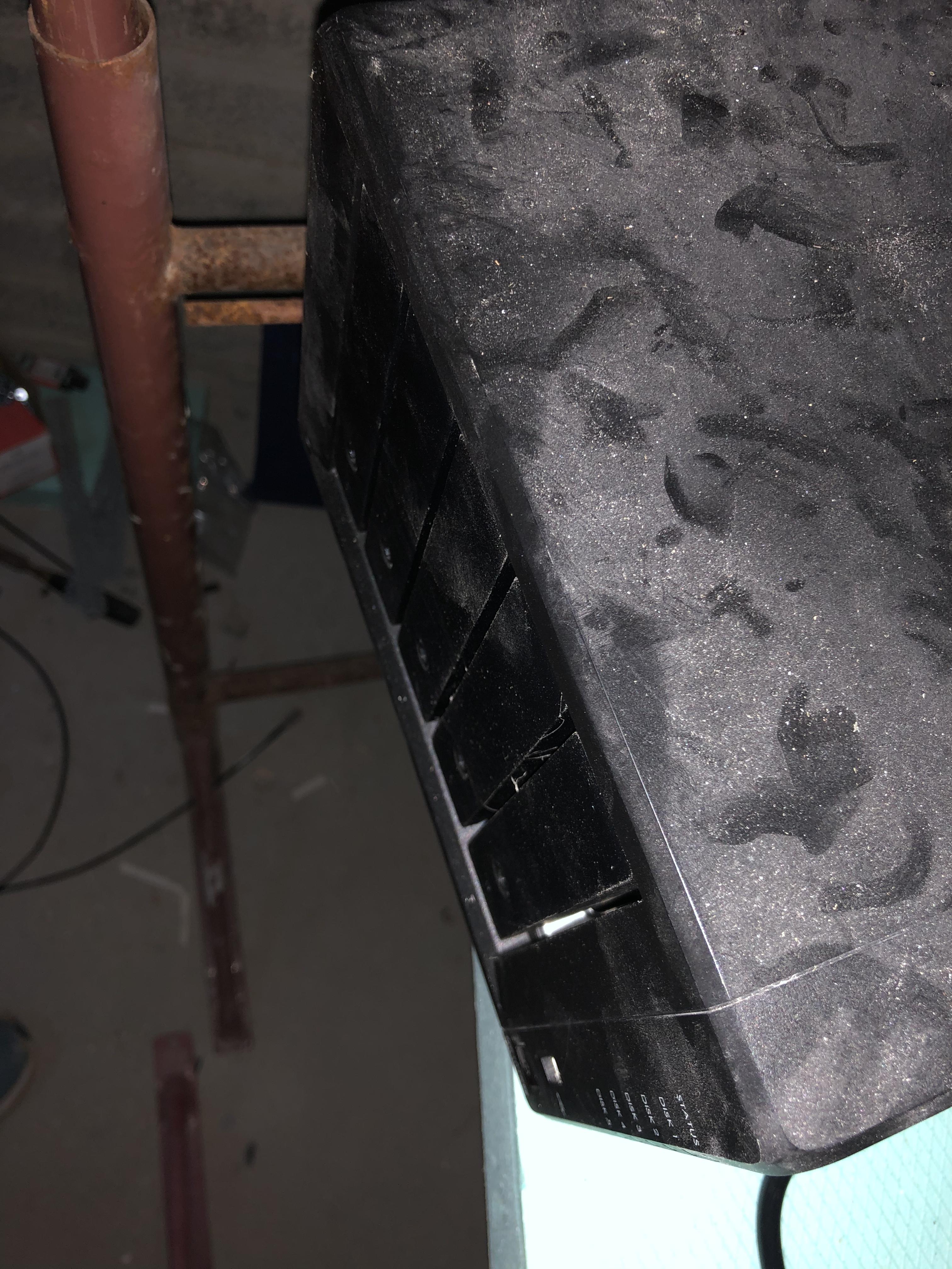

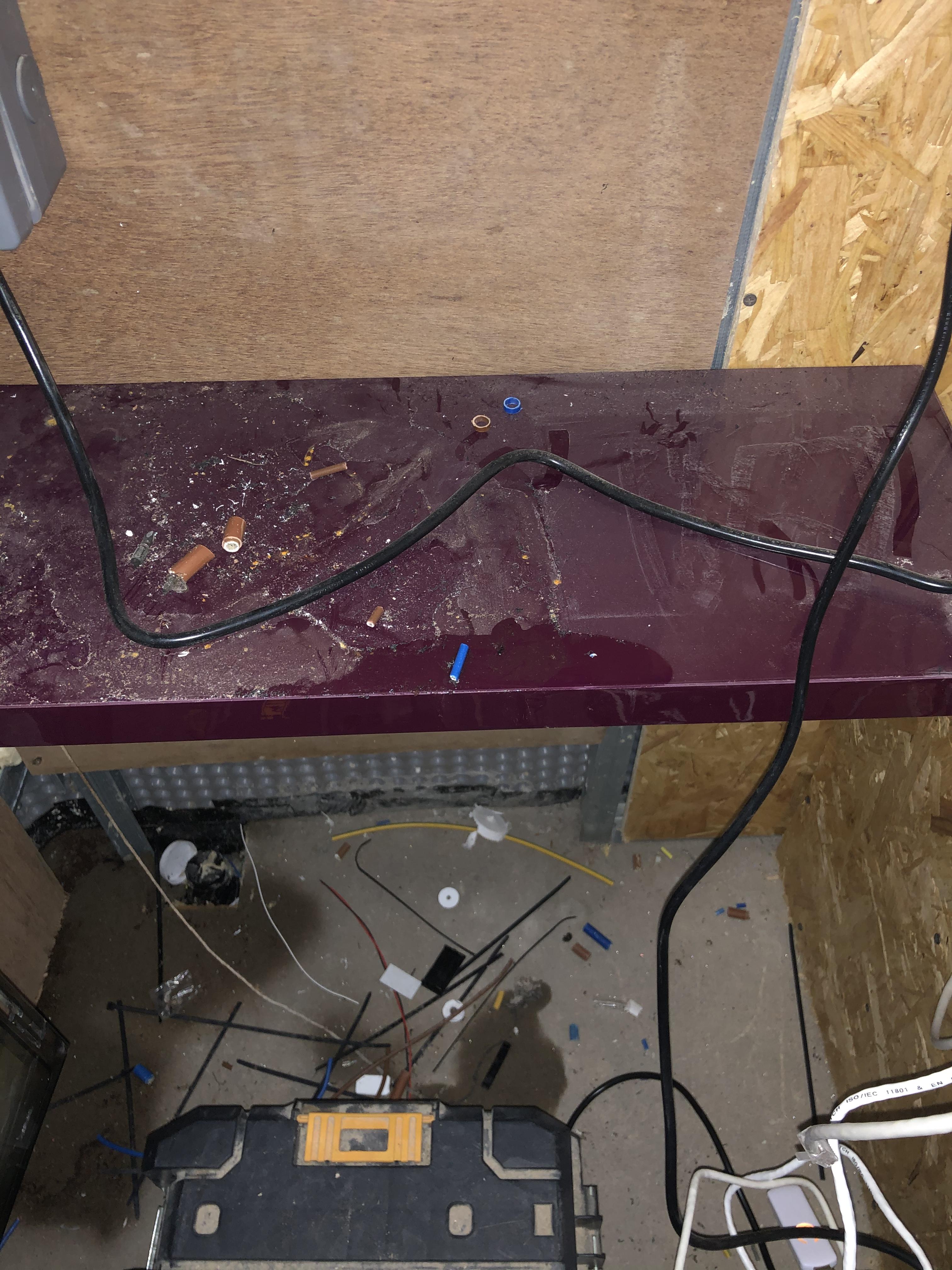

Pocster Posted December 20, 2020 Posted December 20, 2020 My electrics tripped again when not on site . Decided to remove the ups to eliminate that . I notice some water on the edge of this shelf precisely under the nas ! Assuming a leak from above - nothing . Perhaps tracking down a cable - nothing . You’ll see the shelf is dusty / dirty with no obvious tracking marks . Could a nas generate condensation???! Underground of course . No heating . Possible ??
Pocster Posted December 20, 2020 Author Posted December 20, 2020 Before anyone says I’m aware of the ingress of water on the floor in the corner . This is directly beneath my utility access hole . I foamed that now .

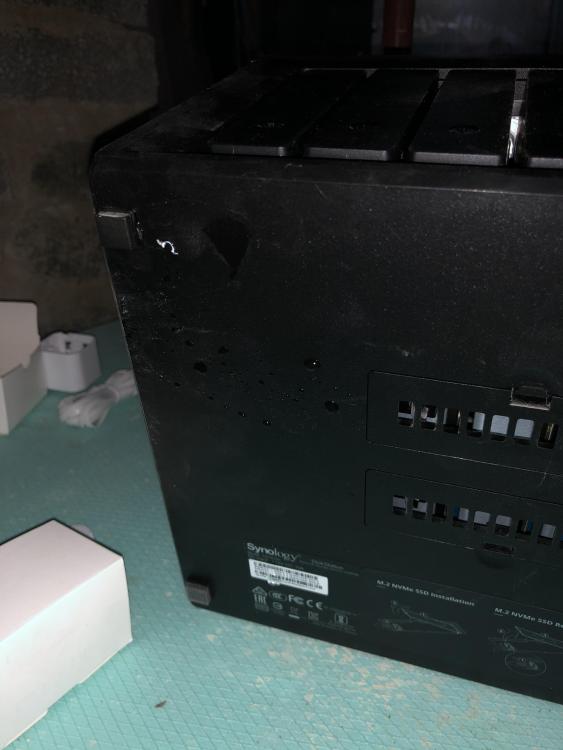

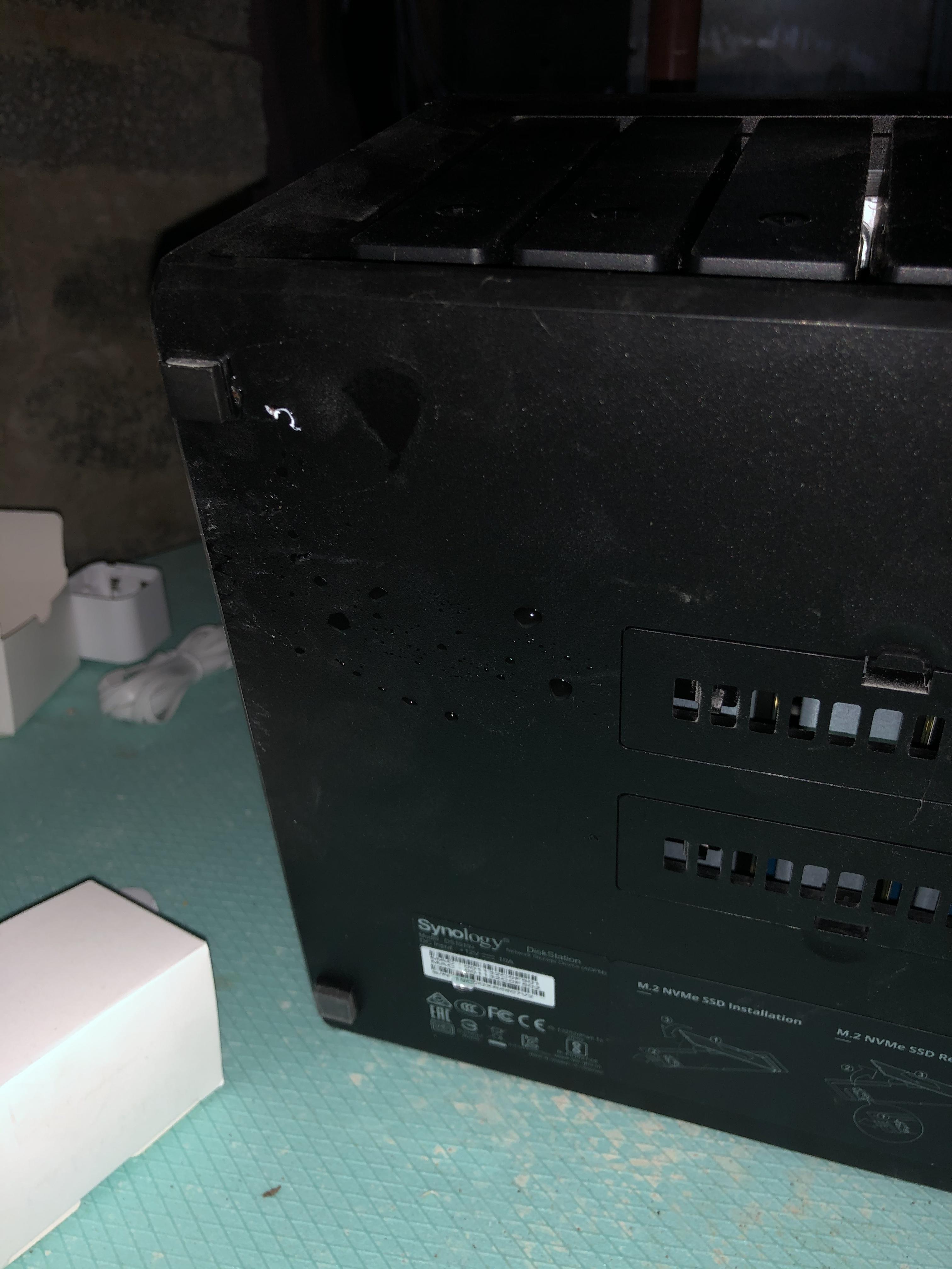

Pocster Posted December 20, 2020 Author Posted December 20, 2020 Top of nas - dusty but no indication of water . Underside - if you zoom in you can see droplets . I’m assuming I’ve got 3 problems here 1 ) water down utility pipe - now foamed 2 ) something tripping rcd - blame ups for now 3 ) nas condensation ?!?!?!?
Mr Punter Posted December 20, 2020 Posted December 20, 2020 Could it be dripping down from the walk on glass?
Pocster Posted December 20, 2020 Author Posted December 20, 2020 12 minutes ago, Mr Punter said: Could it be dripping down from the walk on glass? Assuming you are being funny . But no it’s not under the glazing . Zero water tracks on ceiling

Onoff Posted December 20, 2020 Posted December 20, 2020 Raise the NAS up on some blocks for a bit. Could be the hot NAS / cold shelf interface. 1
Pocster Posted December 20, 2020 Author Posted December 20, 2020 2 minutes ago, Onoff said: Raise the NAS up on some blocks for a bit. Could be the hot NAS / cold shelf interface. Yeah this is what I’m thinking . I can position the nas upstairs ; to eliminate the issue of ‘condensation’

Onoff Posted December 20, 2020 Posted December 20, 2020 Can you get a look inside the guts of the NAS? I've seen some horrors in the enclosures of external kit, water literally running down components that then go t!ts up. Often a tell tale smell (like TCP). 1
