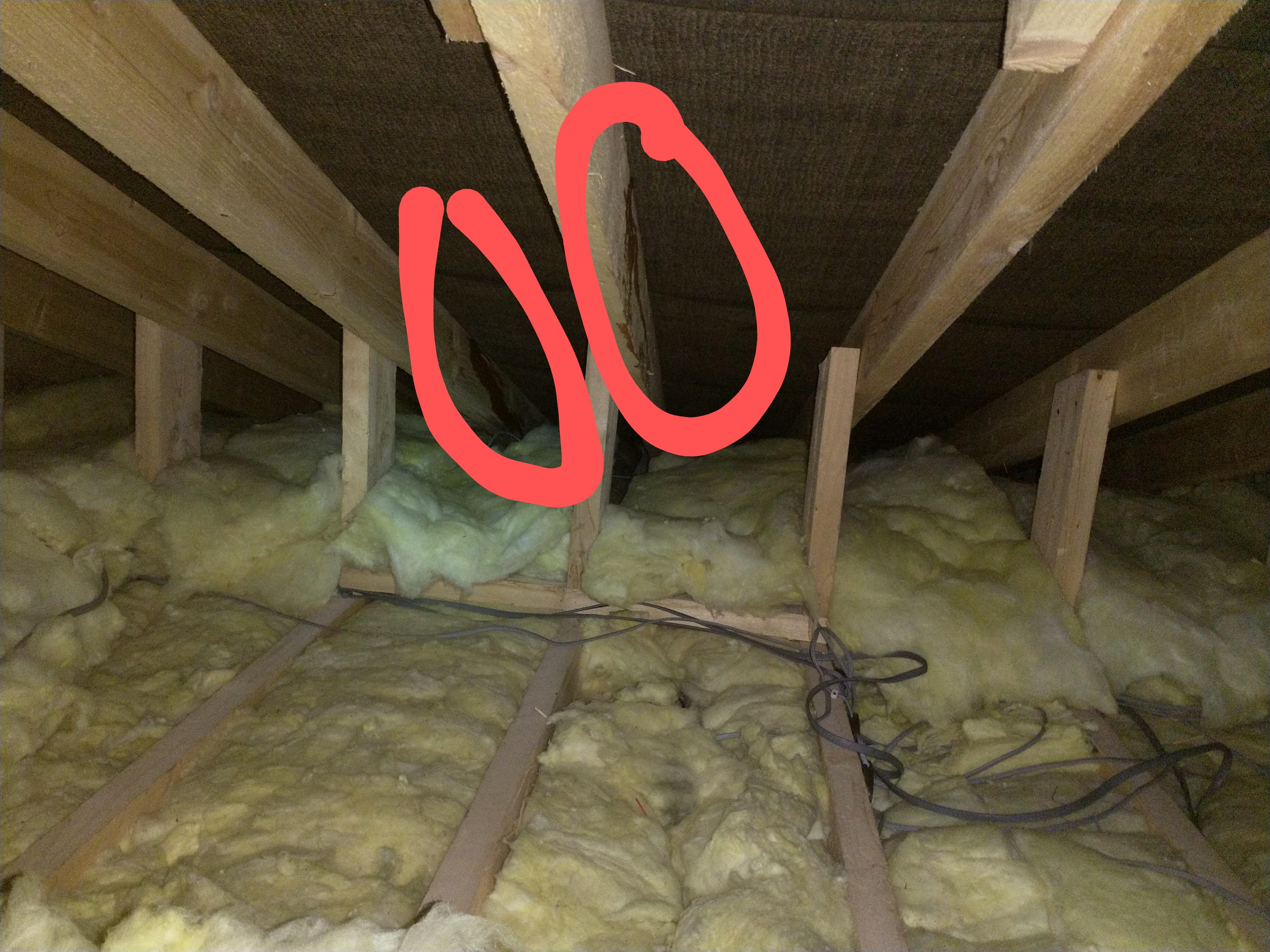

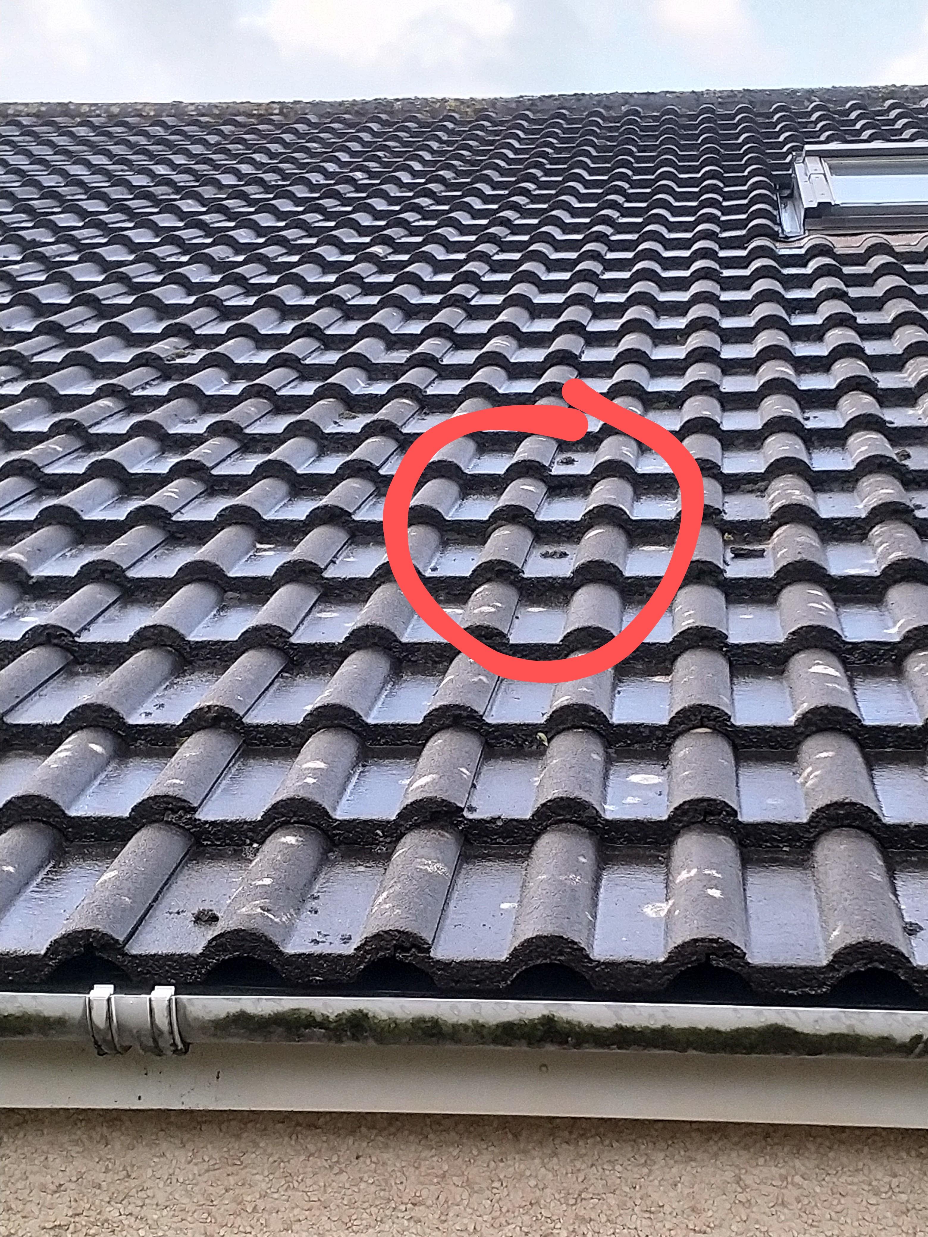

Linto Posted December 19, 2020 Share Posted December 19, 2020 So after it not stopping raining for what feels like a month the roof has started to leak. It's not a massive leak and not all the time its raining but it appears after a prolonged period. Looking in the loft the water looks to be running down a rafter after coming through the tar paper at a nail hole, se the 2 areas highlighted in the photo. I can't see any obvious broken/loose tiles but the leak is a little below and to the side of a velux window. So how do I go about identifying where exactly it's coming through and what to do to fix it? To say this is a bit annoying is an understatement as the roof is getting replaced when we do the loft conversion so if I can avoid expensive repairs that will only be getting ripped out a few months later I'd like to hear about how to do it! Cheers Link to comment Share on other sites More sharing options...
ProDave Posted December 19, 2020 Share Posted December 19, 2020 Can you show a much closer view of the velux window and it's flashing? I suspect the tiles at the sides are too far away from the window, and missing the first rain barrier, and in heavy rain some is getting under, running down the felt and finding your nail hole. Link to comment Share on other sites More sharing options...
Simplysimon Posted December 19, 2020 Share Posted December 19, 2020 +1 to the above and if it's not serious enough to come through the ceiling below, don't worry, especially as the roofs being re-done soon Link to comment Share on other sites More sharing options...
Linto Posted December 19, 2020 Author Share Posted December 19, 2020 I'll try to get a closer view of the velux once it's stopped raining, so will probably be in the new year! Link to comment Share on other sites More sharing options...
PeterW Posted December 19, 2020 Share Posted December 19, 2020 You can see from that photo that the tiles don’t come over the edge of the flashing properly so it’s basically coming in that way. If it’s all coming off then get a tube of gutter sealant and smear onto the nail hole as it will stick to anything including wet surfaces. Link to comment Share on other sites More sharing options...
