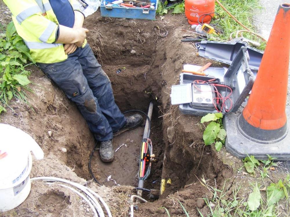

ProDave Posted December 18, 2020 Posted December 18, 2020 Our connection was made in a connection pit about 1 metre square. Within the grass verge but right adjacent to the single track road. 1
