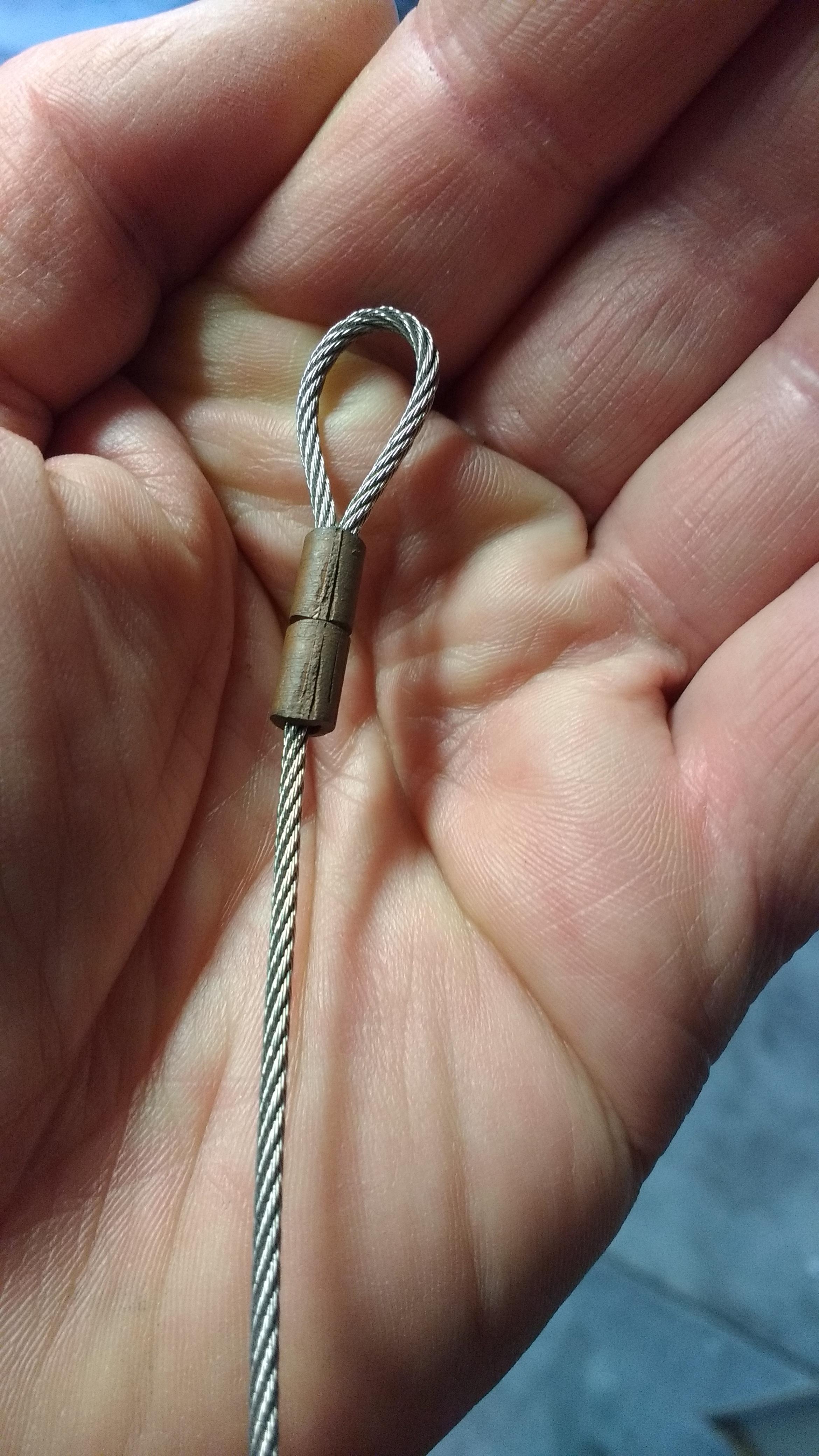

Onoff Posted December 15, 2020 Posted December 15, 2020 I can pop a good length of 2mm dia stainless 7x7 wire rope in the post and some copper ferrules like this: Really you need a proper crimping tool but I can't post that! You can achieve a good enough crimp using electrical crimp tool or mole grips and a pop rivet shaft for the light loads I imagine you're taking about. It'll be a good test of your air tightness if it sways in the breeze! ?
