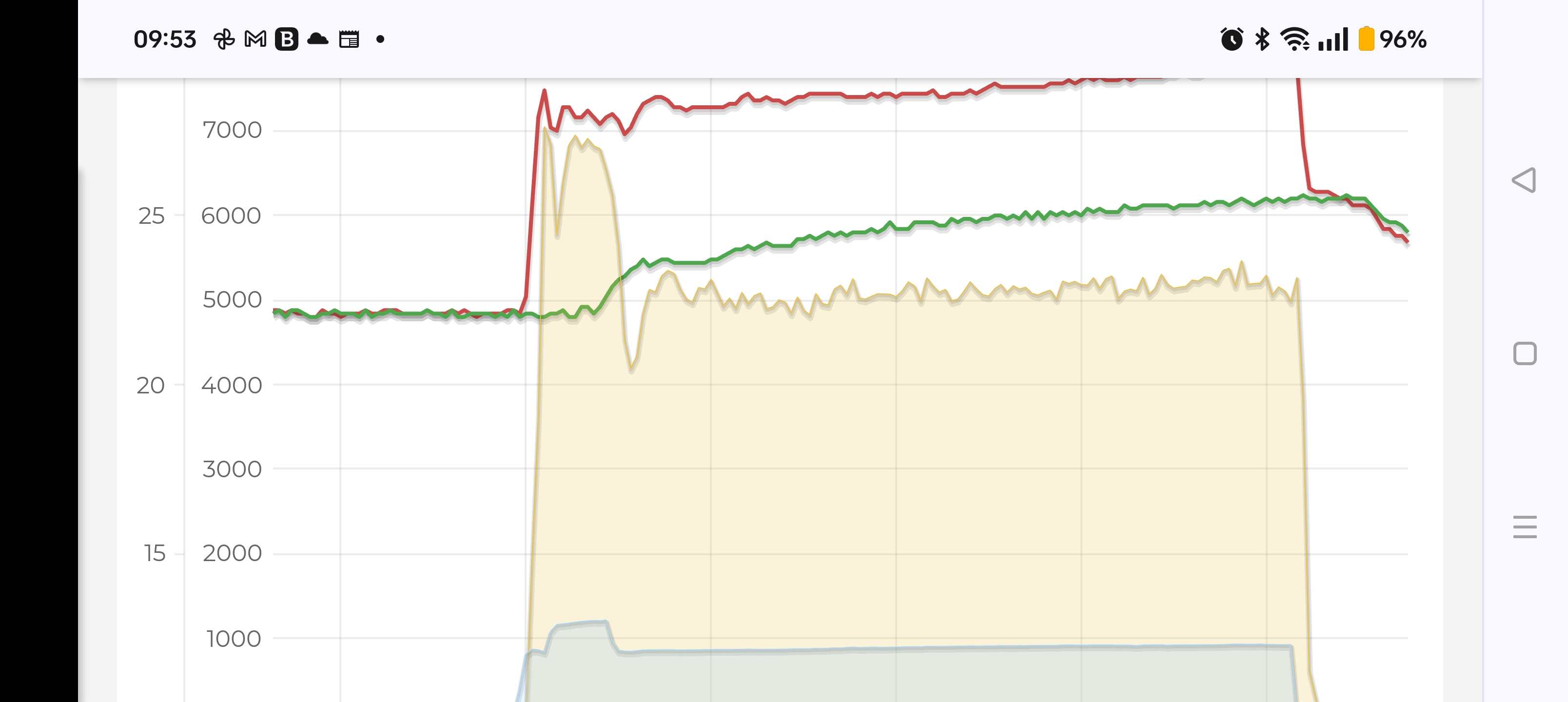

Dreadnaught Posted September 14, 2024 Share Posted September 14, 2024 Thanks @IGP. Yes, I had read that post too. All very interesting. Another thing I have noticed is regarding ΔT. My understanding is that heat pumps generally target a ΔT of about 7º (or sometimes I have seen 5º referenced), which is unlike gas boilers that target something around 20º. However in @Dan F's chart above, the ΔT is just 2º after about 20 minutes of heating (24.5º supply, 26.5º return), which surprised me. Its just an observation and I am sure there is a good explanation for it. I wonder if this is just a consequence of the modulation flexibility of the compressor in the Arotherm Plus. The compressor can only modulate down to a minimum 25% of full speed, not lower. (I do note that the ΔT is user definable (setting "Compressor hyster. Heat." in the installer-level heat-pump controller settings.) Link to comment Share on other sites More sharing options...
JohnMo Posted September 14, 2024 Share Posted September 14, 2024 (edited) 28 minutes ago, Dreadnaught said: My understanding is that heat pumps generally target a ΔT of about 7º (or sometimes I have seen 5º referenced), which is unlike gas boilers that target something around 20º. However in @Dan F's chart above, the ΔT is just 2º after about 20 minutes of heating (24.5º supply, 26.5º return), which surprised me. Its just an observation and I am sure there is a good explanation for it. Bit of a generalisation on gas boilers, my Atag boiler and most low temp boilers do not work at a dT of 20, when I was flowing 30 degs the dT was closer to 5. dT is variable dependant on heating system and flow rate. During a heating cycle our ASHP will start at about 7 dT, and slowly close this down to about 3.5. reason is simple the return temp rises over time, and target flow temperature is fixed. Edited September 14, 2024 by JohnMo Link to comment Share on other sites More sharing options...
Dreadnaught Posted September 14, 2024 Share Posted September 14, 2024 12 minutes ago, JohnMo said: dT is variable dependant on heating system and flow rate. During a heating cycle our ASHP will start at about 7 dT, and slowly close this down to about 3.5. reason is simple the return temp rises over time, and target flow temperature is fixed. I wonder how then is compressor modulation controlled by the system? A direct response to ΔT (within the operating limits of 25% to 100%)? Link to comment Share on other sites More sharing options...
JohnMo Posted September 14, 2024 Share Posted September 14, 2024 14 minutes ago, Dreadnaught said: I wonder how then is compressor modulation controlled by the system? A direct response to ΔT (within the operating limits of 25% to 100%)? Generally when the compressor starts it tries to get the target dT fixed with as little heat input possible. Once target dT is there it manages dT by either modulating output down (if it can) or to add additional heat to flow temp as return gets hotter. Once at target flow temp it allows dT to reduce. Once the heat pump controller is no longer happy the compressor is switched off. Mine running - 25 mins running. Yellow/tan shaded area is power output big load initially and then quickly goes to the main modulation it can. Red flow temp slowly increases and dT between green (return) closes Link to comment Share on other sites More sharing options...

Dreadnaught Posted September 14, 2024 Share Posted September 14, 2024 3 hours ago, JohnMo said: Mine running - 25 mins running. Thanks @JohnMo I see the ΔT shown in your chart is about 3.5º. - Is your's set at the factory-default of 7º ΔT? - Would you be able to overlay on that chart a line for compressor modulation (%)? My theory is that, with the well-insulated houses that are common to those on this site, such heat pumps will hit their lowest-level limit of modulation for much of the time (which is 25% max compressor speed) because heat demand from the house is just so low. That includes yours during the period shown in your chart and would explain the ΔT. Link to comment Share on other sites More sharing options...

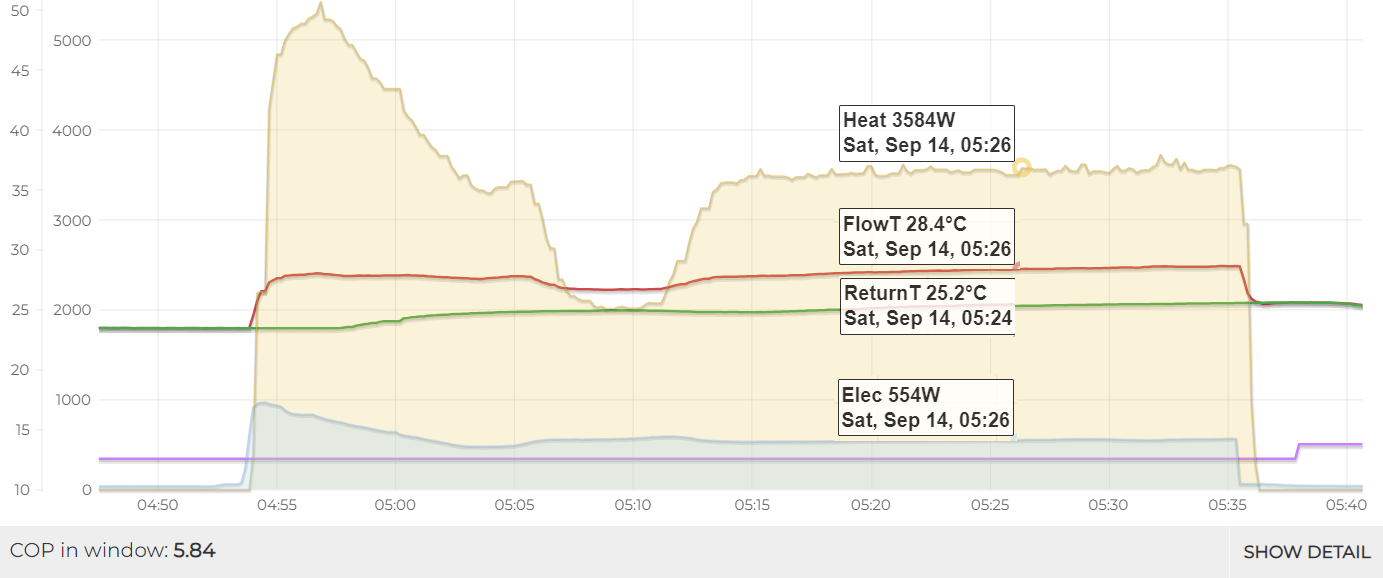

mk1_man Posted September 14, 2024 Share Posted September 14, 2024 @JohnMo : What make / model is your heat pump? Your traces are very similar to mine. I get the initial spike followed by a period of modulated output then after a period of less than 1hour heat pump turns off, waits about an hour then does same again. Mine is an Arotherm 7kW : Link to comment Share on other sites More sharing options...
Dreadnaught Posted September 14, 2024 Share Posted September 14, 2024 6 minutes ago, mk1_man said: Mine is an Arotherm 7kW Ah, @mk1_man, yours shows a ΔT of about 3.2º. Interesting again. Are you able to look at the compressor modulation % during that period? Link to comment Share on other sites More sharing options...

Dan F Posted September 16, 2024 Share Posted September 16, 2024 On 14/09/2024 at 08:23, Dreadnaught said: I wonder do you happen to know whether "Hc2ActualFlowTempDesired" is targeting the temperature of the flow to or return from the home? flow 1 Link to comment Share on other sites More sharing options...
Dan F Posted September 16, 2024 Share Posted September 16, 2024 On 14/09/2024 at 08:49, Dreadnaught said: My understanding is that heat pumps generally target a ΔT of about 7º (or sometimes I have seen 5º referenced), which is unlike gas boilers that target something around 20º. However in @Dan F's chart above, the ΔT is just 2º after about 20 minutes of heating (24.5º supply, 26.5º return), which surprised me. Its just an observation and I am sure there is a good explanation for it. I wonder if this is just a consequence of the modulation flexibility of the compressor in the Arotherm Plus. The compressor can only modulate down to a minimum 25% of full speed, not lower. The aroTHERM works a bit differently. It uses a constant flow rate and varies delta-t between around 2 and 10K. 1 Link to comment Share on other sites More sharing options...
Dreadnaught Posted September 16, 2024 Share Posted September 16, 2024 13 minutes ago, Dan F said: and varies delta-t between around 2 and 10K. Thanks @Dan F. Very interesting. With the Arotherm Plus, do you happen to know how the user-selectable setting of "Compressor hyster. Heat.", which seems to define a ΔT, is relevant? Its default is 7℃ and the range of possible settings is 0 to 15 ℃. (The setting is not accessible via the VRC 720 but only via the heat-pump controller - which in my case is part of the UniTower). In operation, my guess has been that the controller targets a ΔT according to the value set for this setting and uses the "target flow temperature" only for the "Energy Integral" calculation, to define when the heat pump turns off (or on), but I might be over-simplifying. With a constant flow rate (which we know is an idiosyncrasy of the Arotherm Plus), one might think that targeting both "ΔT" and "Target flow temperature" at the same time would more often than not be contradictory when the only parameter subject to control is the compressor speed, hence my enquiry. Link to comment Share on other sites More sharing options...
Dan F Posted September 16, 2024 Share Posted September 16, 2024 (edited) 12 minutes ago, Dreadnaught said: Thanks @Dan F. Very interesting. With the Arotherm Plus, do you happen to know how the user-selectable setting of "Compressor hyster. Heat.", which seems to define a ΔT, is relevant? Its default is 7℃ and the range of possible settings is 0 to 15 ℃. (The setting is not accessible via the VRC 720 but only via the heat-pump controller - which in my case is part of the UniTower). In operation, my guess has been that the controller targets a ΔT according to the value set for this setting and uses the "target flow temperature" only for the "Energy Integral" calculation, to define when the heat pump turns off (or on), but I might be over-simplifying. With a constant flow rate (which we know is an idiosyncrasy of the Arotherm Plus), one might think that targeting both "ΔT" and "Target flow temperature" at the same time would more often than not be contradictory when the only parameter subject to control is the compressor speed, hence my enquiry. It targets a flow temperature and adjusts the compressor speed to achieve this, it doesn't target a ΔT. The "Compressor hyster. Heat." is not a target ΔT, but rather the maximum difference between target and actual flow temperature allowed before the compressor shuts down. In a large volume system when heat demand is low (autumn/spring) the primary (or potentially only) mechanism that decides when to turn compressor on/off is the energy integral calculation. This is because the flow temperature never overshoots enough to hit the 7K hysterisis limit. But, with a low-volume system, or one with too many zone controls, the 7k hysteresis will likely be the primary mechanism that controls when compressor turns off. Edited September 16, 2024 by Dan F 1 Link to comment Share on other sites More sharing options...
Dreadnaught Posted September 16, 2024 Share Posted September 16, 2024 (edited) @Dan F, thank you. That makes full sense now. It's effectively a double limit for when the compressor is turned off: (i) the energy integral; (ii) and a ΔT between the "target flow temperature" and the "actual flow temperature" (not the return temperature) . Local and system conditions will define which limit is hit first, as you say. An example: if the "target flow temperature" is set at 25º, the compressor will operate until the flow temperature reaches (25+7) = 32º (the return temperature is irrelevant), OR if the "Energy Integral" has reached "0" (from its user-selectable starting value, with default -60 ºmin). Is that correct? Regarding when the compressor restarts after being shut down, do you happen to know whether it is only the "Energy Integral" that does so, or whether "Compressor hyster. Heat." also does so at the other extreme (in my example above 25-7 = 18º)? Edited September 16, 2024 by Dreadnaught Link to comment Share on other sites More sharing options...
Dan F Posted September 16, 2024 Share Posted September 16, 2024 (edited) 9 minutes ago, Dreadnaught said: @Dan F, thank you. That makes full sense now. It's effectively a double limit for when the compressor is turned off: (i) the energy integral; (ii) and a ΔT between the "target flow temperature" and the "actual flow temperature" (not the return temperature) . Local and system conditions will define which limit is hit first, as you say. An example: if the "target flow temperature" is set at 25º, the compressor will operate until the flow temperature reaches (25+7) = 32º (the return temperature is irrelevant), OR if the "Energy Integral" has reached "0" (from its user-selectable starting value, with default -60 ºmin). Is that correct? Regarding when the compressor restarts after being shut down, do you happen to know whether it is only the "Energy Integral" that does so, or whether "Compressor hyster. Heat." also does so at the other extreme (in my example above 25-7 = 18º)? Yes, thats correct. Yes, hysterisis of 7K will mean compressor comes on at 18C. You ideally want your system designed and installed to never really use the hysterisis though IMO. If your system volume is good, but not very big, it can be a good to increase the hystersis just so that when the compressor comes on (before it dials back to minumum) it doesn't hit the 7K and turn off prematurely. This does however depend on if you have a buffer, are/aren't using mixed circuit and what your emitters are though. In some cases it may not be a good idea to have water 7-15k above target even for a short period of time. In my case I have a buffer + mixed circuits so it only means the buffer gets hotter, the circuits don't. But if you had open-loop with radiators this might not be a good idea. Edited September 16, 2024 by Dan F 2 Link to comment Share on other sites More sharing options...
