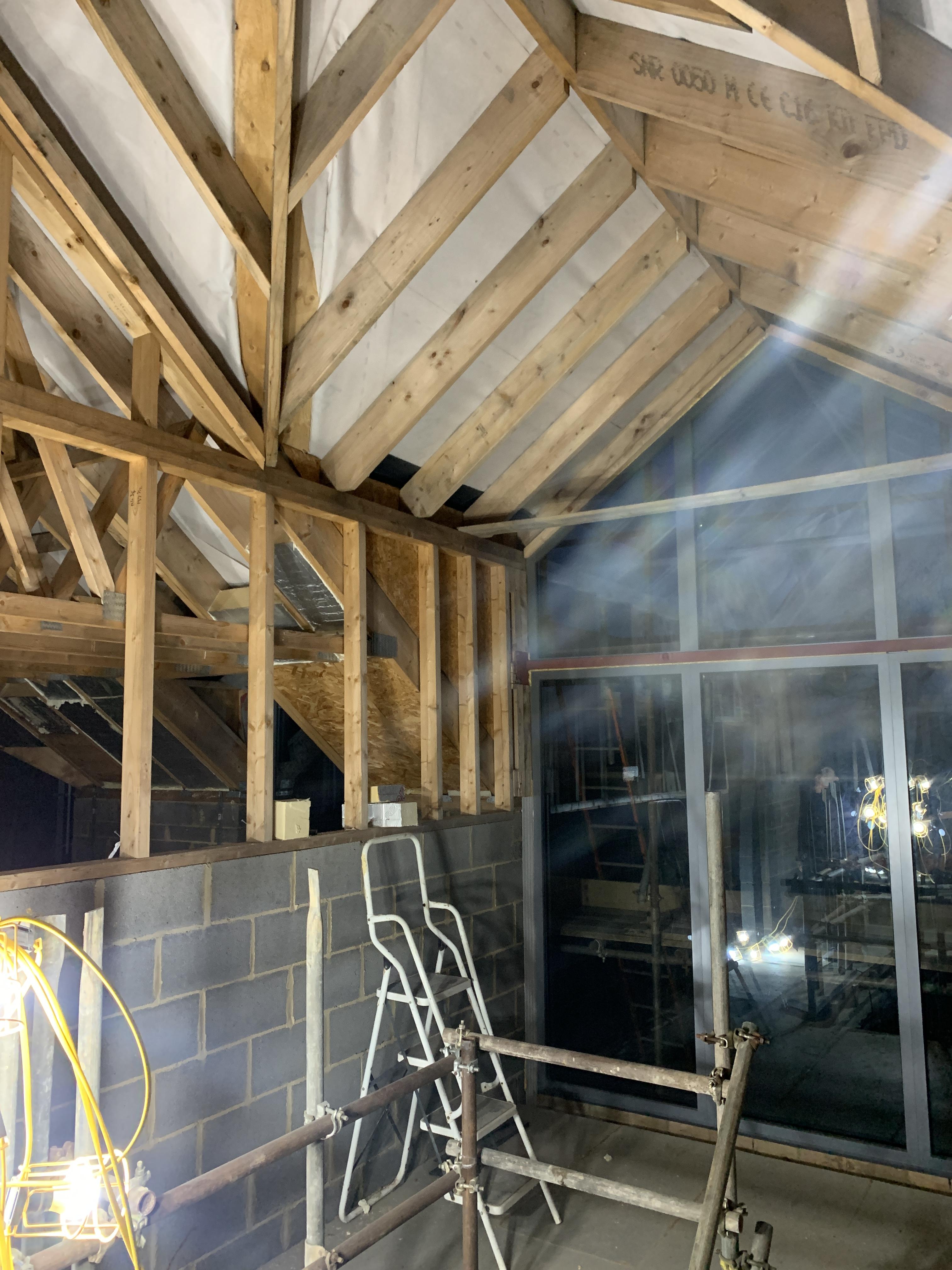

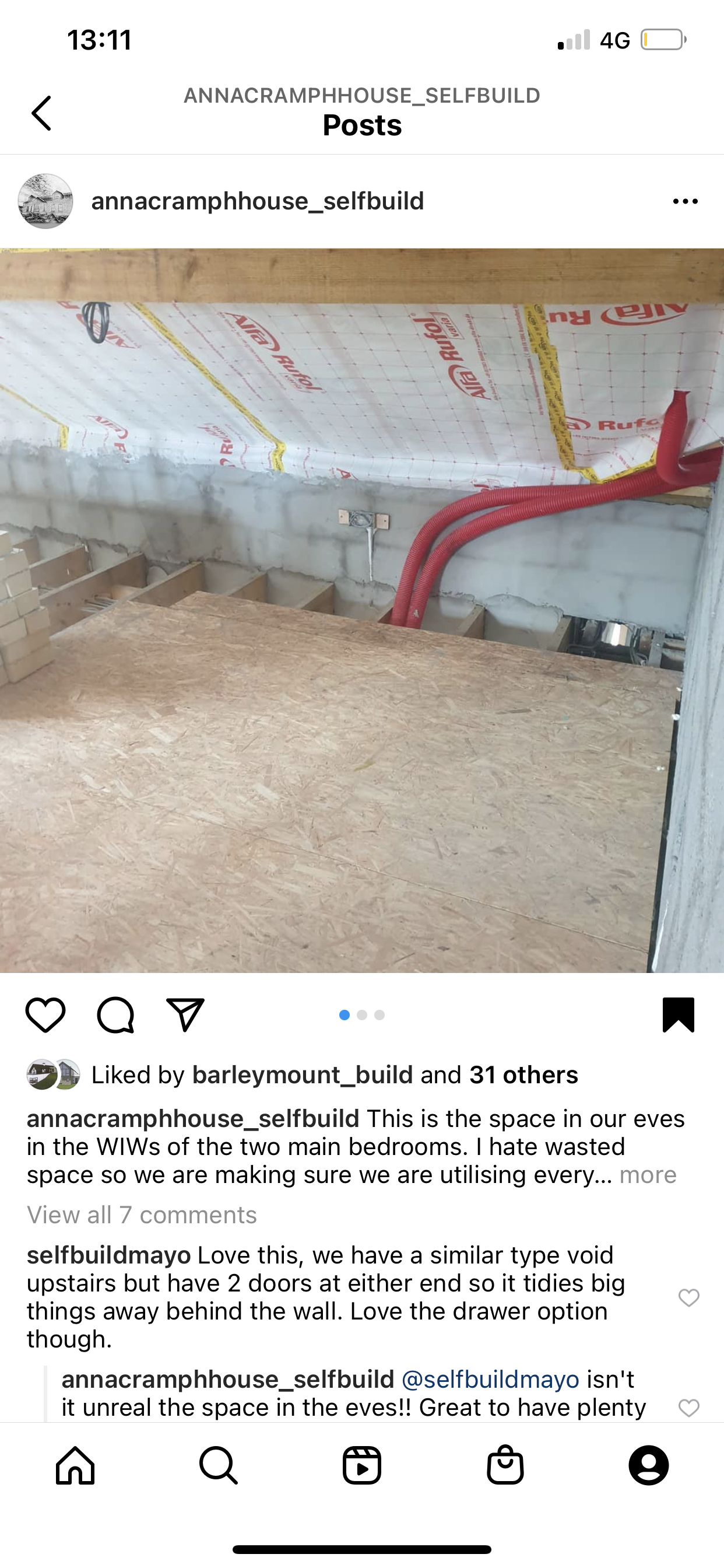

James94 Posted December 4, 2020 Share Posted December 4, 2020 I am going to either PIR the ceiling and tape all joints or use a avcl membrane then use a tape such as the fentrim 20 or pro clima contega (any other suggestion would be great) to seal to the blockwork and parge up to. Similar to this photo I have found. Do I need a VCL on the walls? Over the parge coat? Standard cavity wall build up by the way. Thanks James Link to comment Share on other sites More sharing options...
Russell griffiths Posted December 4, 2020 Share Posted December 4, 2020 No your parge coat is the vcl as long as it’s done well, you need to look at how joists will be fixed to the walls and how you seal around them. Link to comment Share on other sites More sharing options...
tonyshouse Posted December 4, 2020 Share Posted December 4, 2020 Where is the air barrier? How does it join to the adjoining ones? vcl can be an air barrier - I wouldn’t trust parge coat as a long term air barrier blocks look like aircrete and these are notorious for cracking and round joists can be very problematic an joists shrink too. Link to comment Share on other sites More sharing options...
James94 Posted December 5, 2020 Author Share Posted December 5, 2020 Joists are on hangers, I hadn’t heard of tony trays at that stage so missed the chance to install them, now I’m going to try my best to seal around these. I presumed the air barrier on the photo I attached was the parge coat that laps over the membrane to create a continuous air tight seal. Link to comment Share on other sites More sharing options...
Russell griffiths Posted December 5, 2020 Share Posted December 5, 2020 You can buy a liquid air sealing paint, paste type stuff, you either paint it on thick around all joist ends and penetrations, or spray it. I wouldn’t use sand and cement for any detail work as it will dry crack and leave gaps. Flexible is your friend. I have probably used 25 sausage tubes of air sealing paste to go around all the nooks and crannies. Link to comment Share on other sites More sharing options...
tonyshouse Posted December 5, 2020 Share Posted December 5, 2020 Where parge laps over membrane it needs a key, typically EML fixed over the edge, we used 50mm stapled to plate or blocks Link to comment Share on other sites More sharing options...

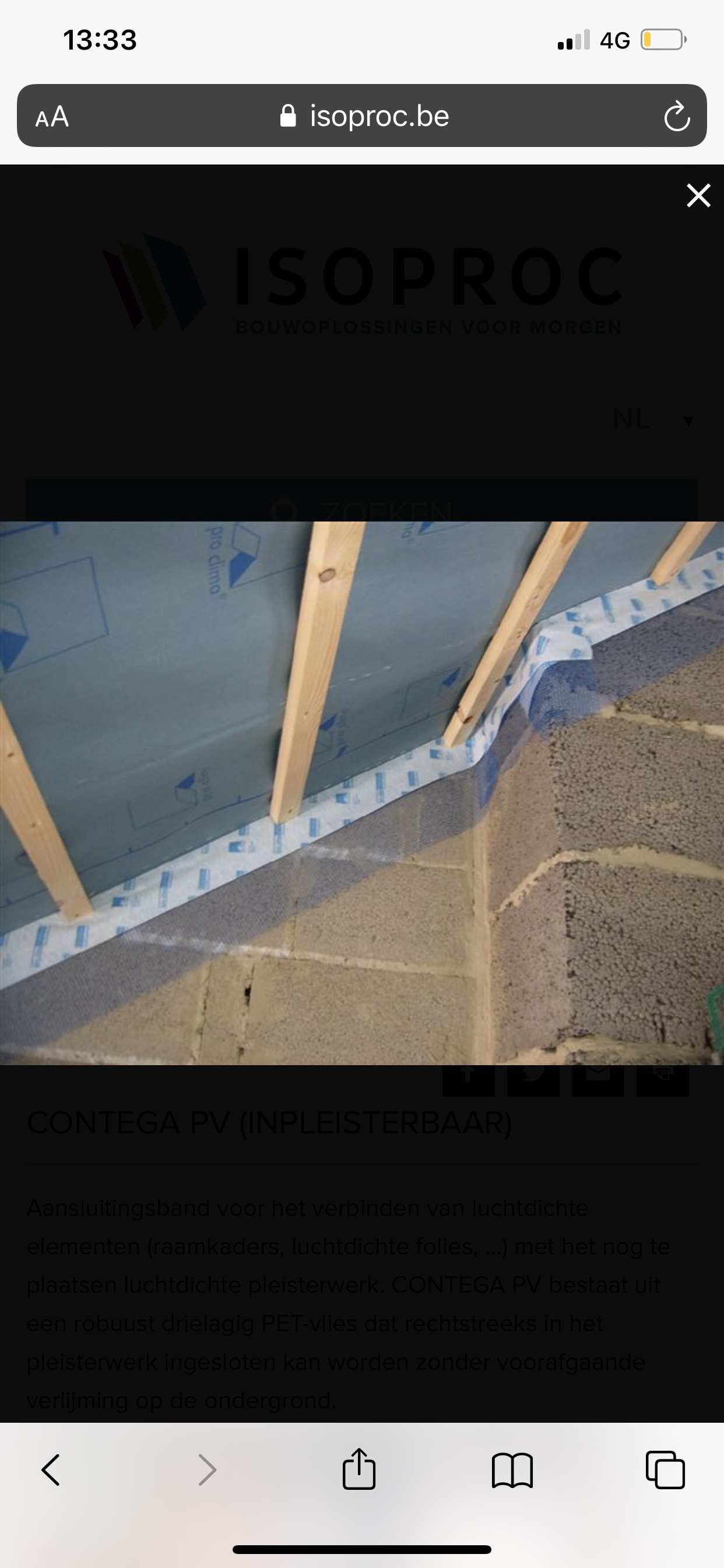

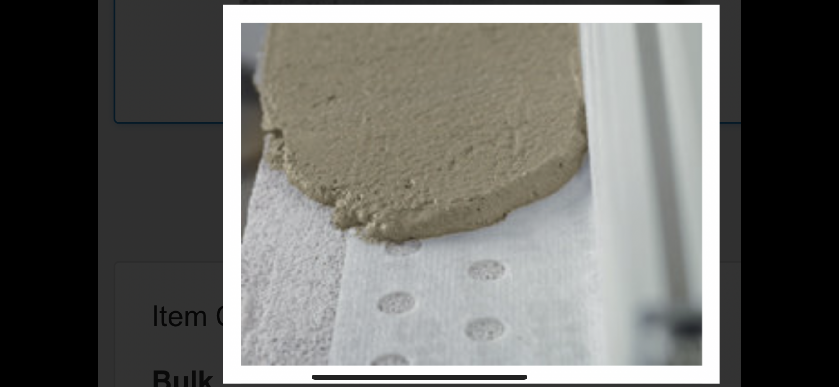

James94 Posted December 6, 2020 Author Share Posted December 6, 2020 I had considered blowerproof around joist ends, it is pricey though. So my understanding was these tapes offer a key for the plaster(see photos attached). Would you say that EML offers a better key and could I then go for a standard air tightness tape or do away with the tape completely? Thanks James Link to comment Share on other sites More sharing options...
Russell griffiths Posted December 6, 2020 Share Posted December 6, 2020 Blowerproof is a bit expensive, but if you think you will use 3-4 tubs then £200-£250 is not a lot for some good insurance. Link to comment Share on other sites More sharing options...

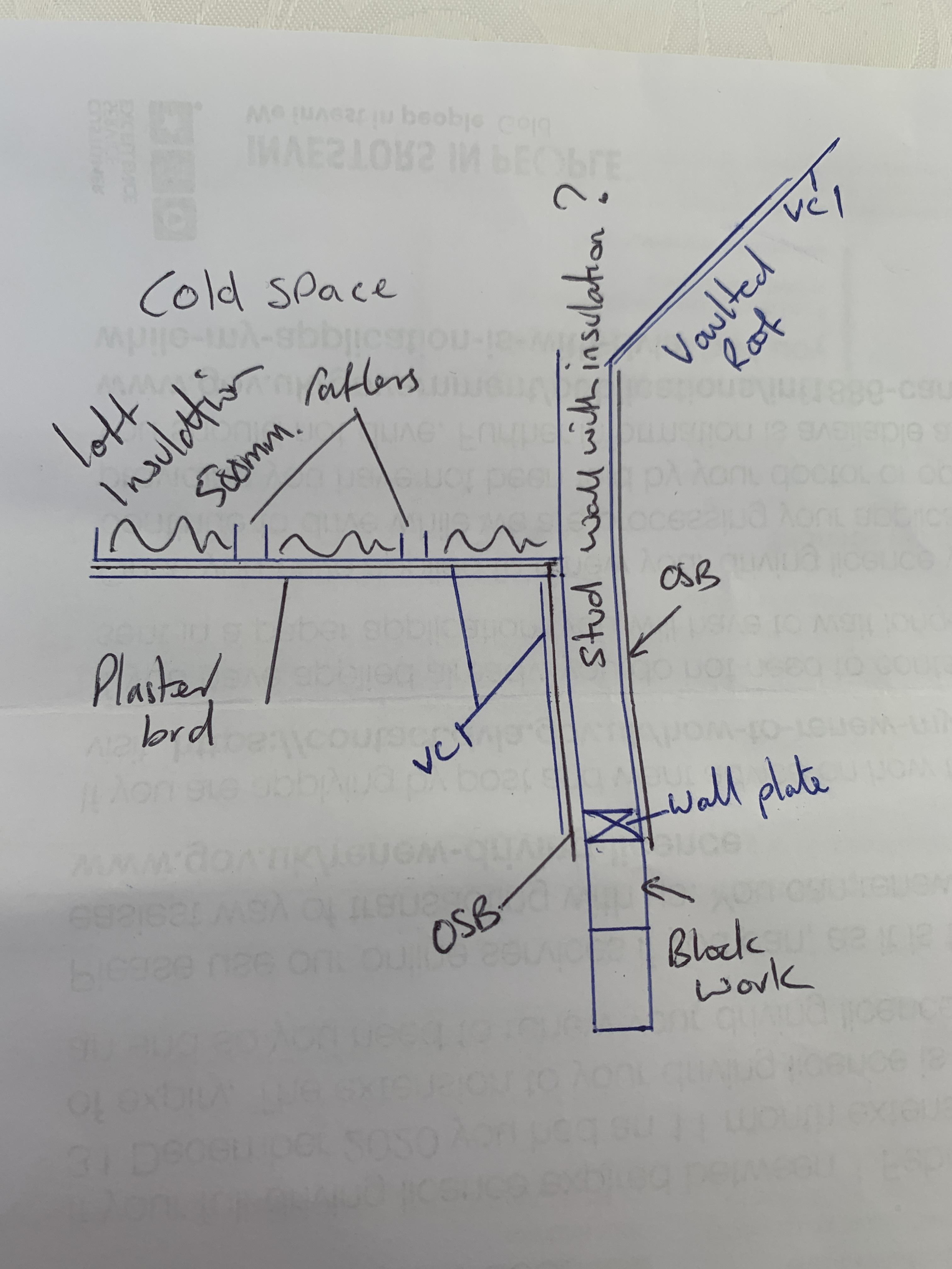

James94 Posted December 8, 2020 Author Share Posted December 8, 2020 I’m going to buy the blower proof for joist ends just to be safe. The drawing below shows a partition wall leading to a vaulted ceiling. This is how I had planned it. I would like to know if we should insulate the stud wall with PIR for thermal insulation down to ceiling level and acoustic for sound insulation down to the wall plate as these stud walls separate bathrooms from landing. Whilst maintaining the VCL. Thanks James Link to comment Share on other sites More sharing options...
Russell griffiths Posted December 8, 2020 Share Posted December 8, 2020 Those loft cheeks should have ;100mm pir in the gaps and 50mm pir over the whole face covering all the studs. Link to comment Share on other sites More sharing options...
James94 Posted December 17, 2020 Author Share Posted December 17, 2020 Sorry for not replying sooner, are you classing the cheek as the stud wall that sits on the block work up to the ceiling? Is that the proper name for it? I assume the 50mm is to stop cold bridging through that stud? The only issue with that would be creating a difference in levels to the blockwork, and encroaches to much on window frames. Thanks James Link to comment Share on other sites More sharing options...
