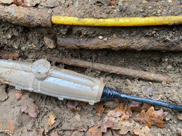

Hilldes Posted December 4, 2020 Share Posted December 4, 2020 The job in the next couple of days is to sever water supply to the house before demolition and to retain the supply to caravans and outbuildings. I've located what I believe to the the water supply pipe - see pic. The upper pipe, broken with yellow plastic insert is the gas pipe, the rusty metal pipe below this must be the water pipe? At the bottom is the newly diverted electric supply cable. If this is the water pipe, its outside diameter is 28mm (0.93 inches). A couple of questions please: What size MDPE to iron connector do I need please (the iron pipe size)? How do I cut and prepare the the pipe - sand area to but cut to remove loose rust, cut with angle grinder, the remove burs inside and out with files? I'm also considering connection right back at the water meter/stop cock at the boundary - see other pic. Yet to dig to explore the type of pipe connection here. I'm guessing this is a later addition to the 1950's supply in the other pic. This is a bit just-in-time for demolition staring Monday, so looking for a quick solution for now and something longer term for the build later next week. I can easily isolate supply at the stop cock, but can't be without water on site. Link to comment Share on other sites More sharing options...
joe90 Posted December 4, 2020 Share Posted December 4, 2020 After a friend of mine had so much trouble (leaks) with an old iron water pipe I would go right back to the water meter, job done, and piece of mind. Link to comment Share on other sites More sharing options...
PeterW Posted December 4, 2020 Share Posted December 4, 2020 (edited) Looks like 1” iron but you won’t get a decent connection to that. I would go back to the boundary and excavate that Toby and you’ll find an MDPE connector on it most likely. That would be my starting point for any connection. Crossed with @joe90..! Edited December 4, 2020 by PeterW Link to comment Share on other sites More sharing options...

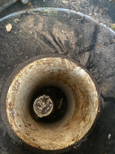

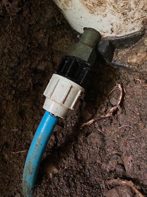

Hilldes Posted December 4, 2020 Author Share Posted December 4, 2020 So the good news is there is MDPE at the Toby. Haven't measured it yet but looks about 20mm. The question is how to sever and connect the new pipe. In the new pic the white connector goes into the Toby - the stopcock. The lower part of the pic shows the blue MDPE starting to go downhill and going into some form of solid tar like substance which I guess might be a seal around the join to the iron pipe. Can I just disconnect the white connector and put in the new MDPE pipe? Link to comment Share on other sites More sharing options...
Conor Posted December 4, 2020 Share Posted December 4, 2020 Yes, just remove the existing adaptor and use a 20-25mm MPDE coupler and attach your new 25mm pipe. Link to comment Share on other sites More sharing options...
Hilldes Posted December 4, 2020 Author Share Posted December 4, 2020 6 minutes ago, Conor said: Yes, just remove the existing adaptor and use a 20-25mm MPDE coupler and attach your new 25mm pipe. Thanks @Conor will dig out a bit more around the connector to see what's what. I'll only get one shot at this because I'll need to remove the existing section of MDPE in order to get the right angle into the Toby. If the white connector is a full coupler then I can see how I can remove the whole coupler and fix a new coupler to the remaining pipe into the stop cock. If the white coupler is more an integral part of the stock cock/Toby then I guess I'll need to reuse it and insert my own pipe into it? Link to comment Share on other sites More sharing options...
Conor Posted December 4, 2020 Share Posted December 4, 2020 2 minutes ago, Hilldes said: Thanks @Conor will dig out a bit more around the connector to see what's what. I'll only get one shot at this because I'll need to remove the existing section of MDPE in order to get the right angle into the Toby. If the white connector is a full coupler then I can see how I can remove the whole coupler and fix a new coupler to the remaining pipe into the stop cock. If the white coupler is more an integral part of the stock cock/Toby then I guess I'll need to reuse it and insert my own pipe into it? That bit of pipe you have exposed is the 1-1.m "tail" that comes out of the box that the contractor fits, that is then connected to the customers pipe. The boundary box itself usually has a push-fit connection on either side for the supply pipes. You can cut that length of MDPE wherever suits you to get the right angle for connecting to your own pipe. Link to comment Share on other sites More sharing options...
PeterW Posted December 4, 2020 Share Posted December 4, 2020 As @Conor said just make all your prep up and then cut that MDPE with a pair of pipe shears, put the insert into the tail then put your connection onto it. Don’t muck about trying to amend what is on the Toby. Link to comment Share on other sites More sharing options...
Bitpipe Posted December 4, 2020 Share Posted December 4, 2020 £12 will get you a razor sharp pipe cutting tool from Screwfix - will give you a clean straight cut on that blue MPDE. https://www.screwfix.com/p/0-26mm-manual-plastic-pipe-shears/59590 Don't forget your pipe stiffener inserts when you use the coupler. Link to comment Share on other sites More sharing options...
Bitpipe Posted December 4, 2020 Share Posted December 4, 2020 Also, don't cut too close to the white fitting as you need enough space to get the collar of your own coupler far enough away from the body of the coupler to make the join and then screw it back on (and be able to take it off again in the future). Link to comment Share on other sites More sharing options...

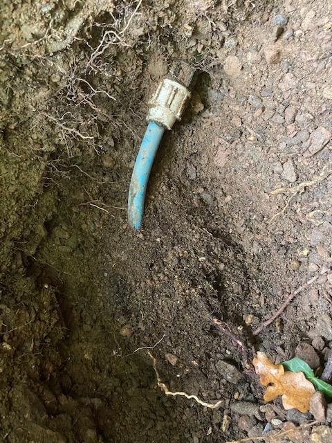

Hilldes Posted December 4, 2020 Author Share Posted December 4, 2020 Ah @Conor and @PeterW got it. The new pics shows the full connection to the Toby. So basically I won't open the white connector. I'll just sever the blue MDPE and connect to it with a new coupler. I measured the MDPE and its nearer 21mm actual O/D so assume that is 20mm pipe. Thanks also @Bitpipe I'll need to dig a bit more around the 'tar ball' to get enough room for the new coupler on the existing MDPE. Got the inserts and cutters. 1 Link to comment Share on other sites More sharing options...
PeterW Posted December 4, 2020 Share Posted December 4, 2020 Give yourself at least 2-300mm of blue to work with off that Toby just in case you have to cut and redo the joint. Link to comment Share on other sites More sharing options...
Hilldes Posted December 4, 2020 Author Share Posted December 4, 2020 2 hours ago, PeterW said: Give yourself at least 2-300mm of blue to work with off that Toby just in case you have to cut and redo the joint. Thanks @PeterW I've been carefully prising away some of the 'tar ball' it is very tough and has started to seep where the blue MDPE goes into it so I stopped. I have about 8 inches of MDPE to play with and some of that goes through a good 45 degree bend down into the tar ball - which may have deformed as it curved and I guess may not make a good joint. I plan to sever the MDPE as close to the tar ball as I can. If the coupler join leaks leaks because the pipe is deformed, then I'll cut some off and join closer to the Toby. Last resort would be to try to remove the white nut at the toby and push the new MDPE pipe straight in there. Link to comment Share on other sites More sharing options...
