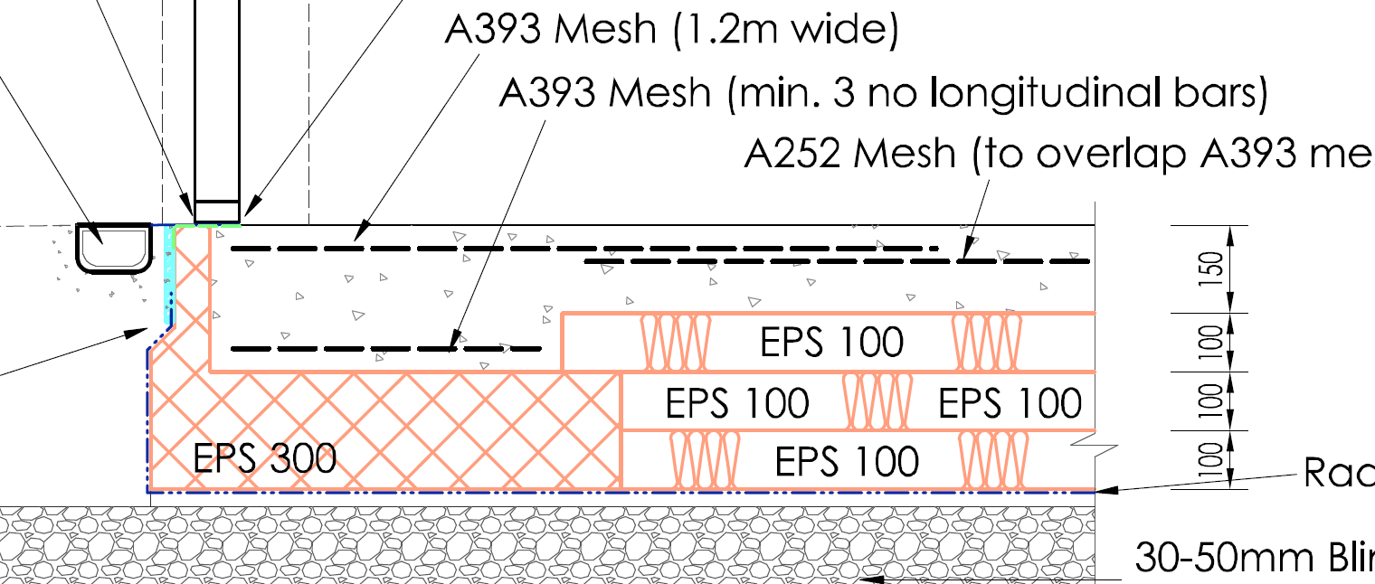

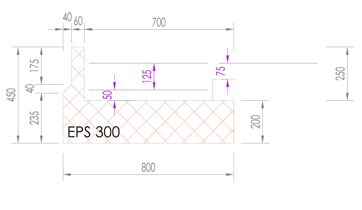

SuperJohnG Posted November 30, 2020 Share Posted November 30, 2020 I've an insulated foundation from Kore due to kick off shortly and working out all the details. Hit a little stumbling block on how to support some of the mesh. I have a 250mm deep ringbeam with 150mm thickness on the rest of slab. Tanners provided the mesh type and detail etc, but I am trying to figure out the best route for supporting the mesh. The lower A393 can be on mesh castles at 40/50mm as required - I was even thinking on doing 'mars bars' (actual name!) as that seemed even quicker. The inner A252mesh, should be easy enough also with 75mm castles or mars bars again. However I am struggling find much info on how to support that upper section of A393 mesh. I done a CAD drawing below and added some some sizes. I assume the actual spacings are not set in stone (pun not intended) as long as you have the steel in there? 75mm down from the top of the slab seemed to make sense to me, hence I have 125mm gap to fill, how is it best to do this? Are Hy chairs what should be used here? any steer appreciated. I may be overthinking it - I'm a Mechanical engineer and this building malarkey all seems a bit loose for me.. Link to comment Share on other sites More sharing options...
Alexphd1 Posted November 30, 2020 Share Posted November 30, 2020 One solution is get some rebar bent into a u shape and tie it the lower a393 mesh below. Link to comment Share on other sites More sharing options...
PeterW Posted November 30, 2020 Share Posted November 30, 2020 Can you not run 125mm triangular deck chairs to support the upper layers ..? https://tzursteel.co.uk/products/continuous-wire-chair-2m-lengths-each-spacer-from-50mm-to?variant=27962143604759&gclid=EAIaIQobChMIwueI17Sr7QIVqujtCh1EYw10EAQYASABEgKk5PD_BwE 1 Link to comment Share on other sites More sharing options...
Alexphd1 Posted November 30, 2020 Share Posted November 30, 2020 This is what I was meaning, we had more rebar in our spec. I think the triangle deck chairs is a easier solution. 1 Link to comment Share on other sites More sharing options...
Russell griffiths Posted December 1, 2020 Share Posted December 1, 2020 (edited) As peter said, steel supplier does a mesh support that is shaped like a z, you can squish them down a bit if needed. I would also use mars bars wherever you can as the plastic spacers crush if stood on by a fat concreter. Edited December 1, 2020 by Russell griffiths 1 Link to comment Share on other sites More sharing options...
LA3222 Posted December 1, 2020 Share Posted December 1, 2020 John, I used plastic mesh spacers under the bottom sheets - did look at mars bars but for the qty required they seemed expensive. In the thickened areas where two sheets are stacked I used mesh hystools and tied them to the top and bottom mesh sheets. 1 Link to comment Share on other sites More sharing options...
SuperJohnG Posted December 1, 2020 Author Share Posted December 1, 2020 9 hours ago, PeterW said: Can you not run 125mm triangular deck chairs to support the upper layers ..? https://tzursteel.co.uk/products/continuous-wire-chair-2m-lengths-each-spacer-from-50mm-to?variant=27962143604759&gclid=EAIaIQobChMIwueI17Sr7QIVqujtCh1EYw10EAQYASABEgKk5PD_BwE Thanks - yep that was the things I was thinking. 1 hour ago, Russell griffiths said: As peter said, steel supplier does a mesh support that is shaped like a z, you can squish them down a bit if needed. I would also use mars bars wherever you can as the plastic spacers crush if stood on by a fat concreter. Mars bars seemed to make sense as then you can just sit them on the EPS and then put the steel on top quickly. It'll be post xmas for me now, so no doubt the extra support will maybe required for me, ? 23 minutes ago, LA3222 said: John, I used plastic mesh spacers under the bottom sheets - did look at mars bars but for the qty required they seemed expensive. In the thickened areas where two sheets are stacked I used mesh hystools and tied them to the top and bottom mesh sheets. Thanks @LA3222 I was scouring the pics in your thread last night on the mesh castles, but I couldn't see them in there. Any advice on spacing of them? I think I will go simialr route to you, so it's all very solid to walk on. I assume the hystools are just the same as the items Peter mentioned above? Link to comment Share on other sites More sharing options...
LA3222 Posted December 1, 2020 Share Posted December 1, 2020 Yeah the hystools are triangular and available in loads of heights. They are 2m long iirc. I tended to stagger them, much like how you plant a double row hedge, but then I pulled them in slightly so all the ends overlapped by about 150mm - I was looking this morning but couldn't find any pics which clearly show it. Check your height before you order. I cocked up and ordered wrong size. I sized it off the gap between sheets, didn't think about how when A393 bars cross each other the sheet is actually 24mm thick, not 12mm thick. Link to comment Share on other sites More sharing options...
LA3222 Posted December 1, 2020 Share Posted December 1, 2020 When I tied them to the sheets I just did 4 or 5 on bottom legs and then same to top, like a zig zag. 1 Link to comment Share on other sites More sharing options...
SuperJohnG Posted December 1, 2020 Author Share Posted December 1, 2020 5 hours ago, LA3222 said: Check your height before you order. I cocked up and ordered wrong size. I sized it off the gap between sheets, didn't think about how when A393 bars cross each other the sheet is actually 24mm thick, not 12mm thick. Great wee bit of info. 5 hours ago, LA3222 said: When I tied them to the sheets I just did 4 or 5 on bottom legs and then same to top, like a zig zag. And this too - cheers Think I should have enough info to figure this part out now. Unfortunately looks like January for doing this for me - I know I shouldn't but hey ho - I need to get going! Link to comment Share on other sites More sharing options...
