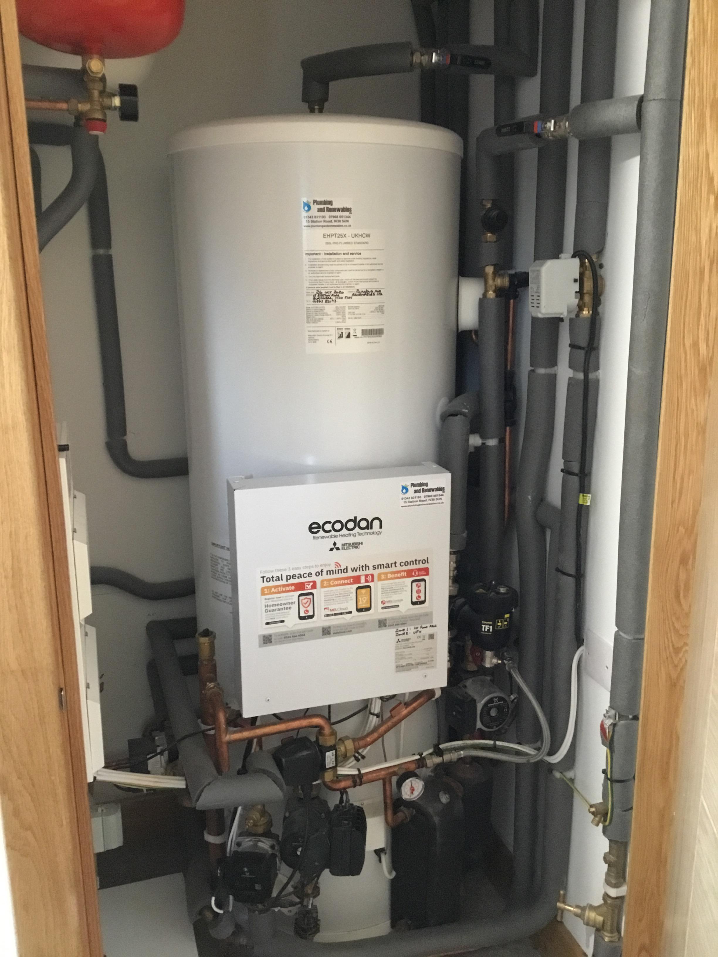

New Ecodan ASHP system.  Pre plumbed unvented mains pressure water heater.  Attachment is noise from water heater during evening when no hot water being used and central heating quite low.
Engineer has got me to turn off frost feature thing and increase bar pressure to 2.
Tonight I’ve turned off whole system, so I can sleep as like trying to sleep in a ships engine room.
any ideas?

14 hours ago, PeterW said:
What is the circulation pump set to..?
Is it definitely coming from the tank..?
I’m not sure about the pump setting the engineer (over the phone) did mention that could be an issue and may need to be adjusted (down?)
From tank ? I think so but so loud difficult to pinpoint.  Certainly to right side of equipment as opposed to expansion vessels top left.
pic attached.
thanks Peter
There are three pumps on that tank.  I would turn them down one at a time (noting their original setting) to determine which one is causing the noise.
We have this system.  As @ProDave said, you can alter the speed settings on two of the pumps.  Other option is to use the schedule function so that the unit doesn't operate overnight (or during the key hours when you are trying to get to sleep).   There are advance setting where you can set the length of time the circulation pumps continue to circulate after the actual heating DHW production has ceased.
Thanks guys, sounds like there will be settings to address this.  I’ll not touch anything for fear of buggering it up and get the installer into get it sorted.

We moved to a new build 6 months ago with the Ecodan system (FTS6) and we have the exact same noise issue. 3 of the upstairs rooms are unusable due to the stressful high pitch frequency noise that runs through them as a result. All downstairs (open plan) also has high pitch noise constantly. We’re in hell.
Mitsubishi on phone say there shouldn’t be any disturbing noises from their systems but our builder and developer claim the noises are ‘normal’ and nothing can be done. They refuse to pay for Mitsubishi to visit (£300) because a Mitsubishi engineer had already visited for a separate reason: to look at a angle grind noise from the outside pump and they state we ‘should’ have said something then. But we DID say something then! The engineer dismissed our concerns and said the noise was normal and nothing can be done. He didn’t even mention settings. We’ve stated this but it gets ignored.
On the phone Mitsubishi are clear that their systems should not cause enough noise to be a disturbance. The site manager also recently acknowledged the noise isn’t normal too but asked not to be named saying that …
Any thoughts?
@SJP try turning the pump speeds down. You can enter the advanced settings on the controller, think you hold the circular button with lines down for few seconds. That then put you into the advanced side of the menu tree. Go to the settings bit and look through all the bits in there, think the commisioing wizard bit is where the pump settings are hidden.

Thanks Peter W. Still having a nightmare with this. Independent engineer actually said our pump needed turning up because of flow rate problems …Error code and full system fail recently as well as glycol leaks. Noise reading 60 decibels but contractors claiming they can’t hear the noise, implying 60 decibels is subjective! Constant minimisation. We have a battle on our hands to sort I think. Will update.
