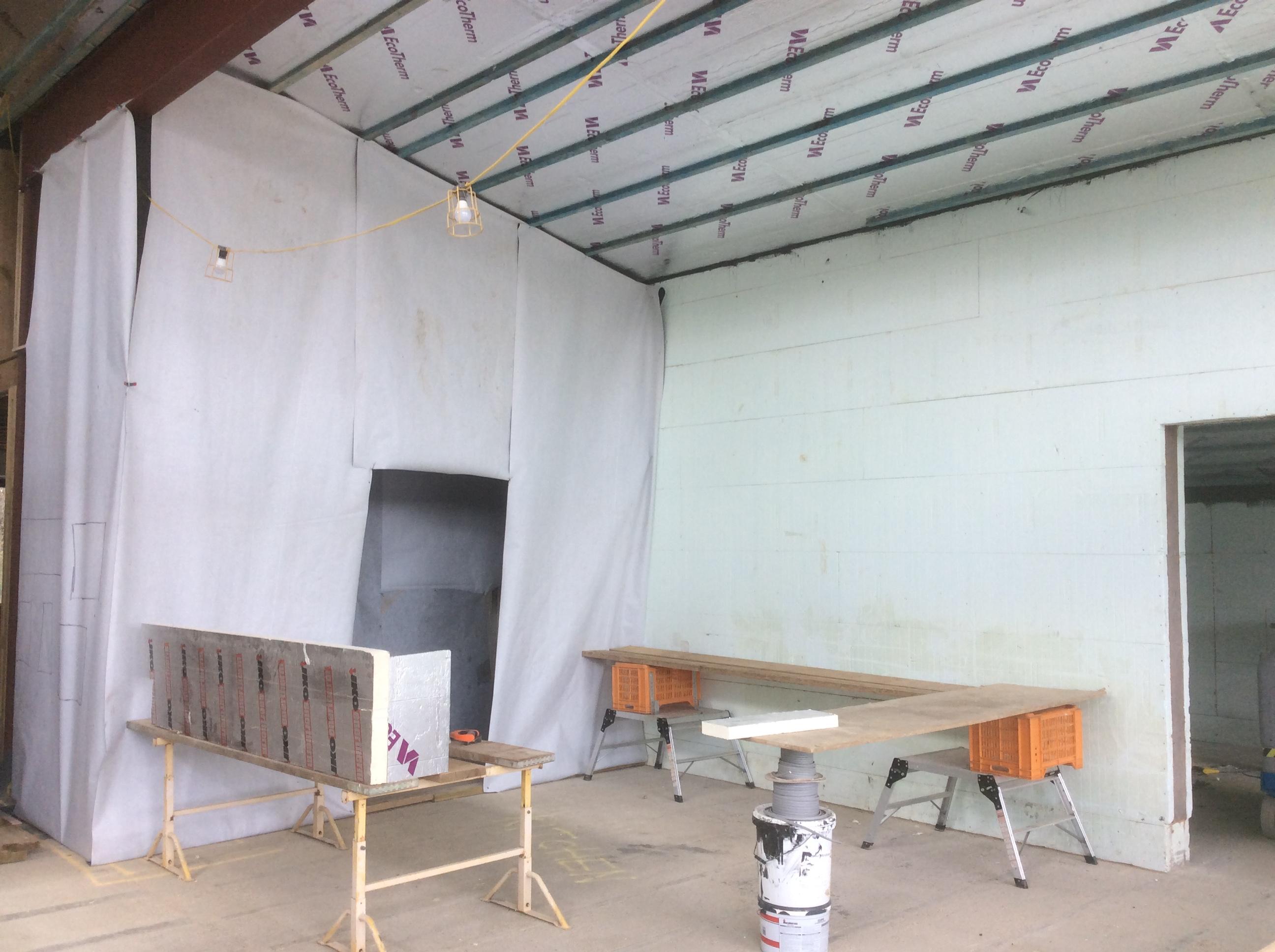

Onoff Posted November 29, 2020 Posted November 29, 2020 (edited) I've only refurbed one room here and even being on this forum I didn't quite grasp the importance of air tightness otherwise I'd have designed elements differently. It'll certainly influence what I do on future rooms. A refurb is always imo harder than starting with a clean slate of course as you have to constantly work around other people's screw ups! It also took a visit to a highly insulated, low energy house and an understanding of it's construction to make me see (as I now do), the light. Basically I renewed the ceiling joists: I infilled with pir: Foil taped the joints: The went over the lot with a membrane: That shows the membrane concept. At that point it was pretty toasty and airtight. (Still cold bridges at the joists). All this is a bit moot as I have bfo cutouts for downlights, speakers and a ginormous, ceiling mounted body dryer. I've always had a plan to reinstate the insulation and membrane at these points but it's more work, a lot of which could have been avoided (not so much the body dryer mind). I maybe SHOULD have counter battened and used low profile LEDs. Lowering the ceiling a tad with counter battens would too have helped with tiling and decreased the room volume a bit meaning less to heat. The walls followed with battens infilled with pir then a taped vcl. Ceiling vcl joins the wall vcl joins the floor vcl: The only saving grace to all this is I hope to eventually have a warm roof and ewi effectively wrapping all my mistakes in a thermal envelope. Edited November 29, 2020 by Onoff 2

Dave Jones Posted November 30, 2020 Posted November 30, 2020 On 29/11/2020 at 09:20, Onoff said: I've only refurbed one room here and even being on this forum I didn't quite grasp the importance of air tightness otherwise I'd have designed elements differently. It'll certainly influence what I do on future rooms. A refurb is always imo harder than starting with a clean slate of course as you have to constantly work around other people's screw ups! It also took a visit to a highly insulated, low energy house and an understanding of it's construction to make me see (as I now do), the light. Basically I renewed the ceiling joists: I infilled with pir: Foil taped the joints: The went over the lot with a membrane: That shows the membrane concept. At that point it was pretty toasty and airtight. (Still cold bridges at the joists). All this is a bit moot as I have bfo cutouts for downlights, speakers and a ginormous, ceiling mounted body dryer. I've always had a plan to reinstate the insulation and membrane at these points but it's more work, a lot of which could have been avoided (not so much the body dryer mind). I maybe SHOULD have counter battened and used low profile LEDs. Lowering the ceiling a tad with counter battens would too have helped with tiling and decreased the room volume a bit meaning less to heat. The walls followed with battens infilled with pir then a taped vcl. Ceiling vcl joins the wall vcl joins the floor vcl: The only saving grace to all this is I hope to eventually have a warm roof and ewi effectively wrapping all my mistakes in a thermal envelope. lights ?
Onoff Posted November 30, 2020 Posted November 30, 2020 7 minutes ago, Dave Jones said: lights ? Big holes in the vcl and insulation! ?
