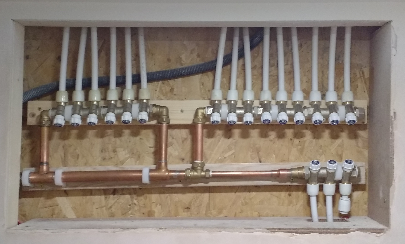

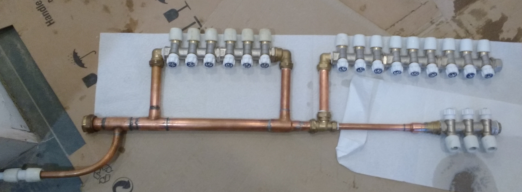

TerryE Posted February 5, 2017 Author Posted February 5, 2017 A quick update. I've added a wet 0-6 bar gauge to my home-brew pressure test setup and connected up my DCW manifold and cranked it up to 7 bar. One advantage of breaking your system down into separate subsystems if that you can assemble each on the bench and test properly before installing in place. To be honest I had a 28mm dry joint so its lucky that we did this. The problem was that the end of the 28 pipe had a shallow ding in it that I hadn't noticed -- goodness knows why -- but the result was that the end feed solder had a dry bridge, and this caused a joint failure that I needed to redo before the 7 bar test worked. The main fill will be where the 28mm endstop is to the left and the 15mm below will ultimately have a draincock on it, but it is currently a pressure test point. And this is the manifold in position. Not quite as neat as Nick, but it will do Compare this to the photos on the original post. I blame Jan for it being slightly crooked. 2
Nickfromwales Posted February 5, 2017 Posted February 5, 2017 Well, I'm happy to say, you've got the job You can start Monday. Looks neat and tidy to me, and the manifolds are a great solution for negating end-of-line isolation ( and access to more so ). Soldering 28mm is almost a skill in itself. The heat at the front of the fitting doesn't always get all the way around the pipe, so most get a dry patch at the rear of the joint, unless the heat has been applied evenly around the whole fitting. Having a dented pipe is a bitch, so you can't lose brownie points ( remember those ) for the duff joint . 9.5 out of 10. I can't give you 10 sorry, as that may steal my thunder. 1
