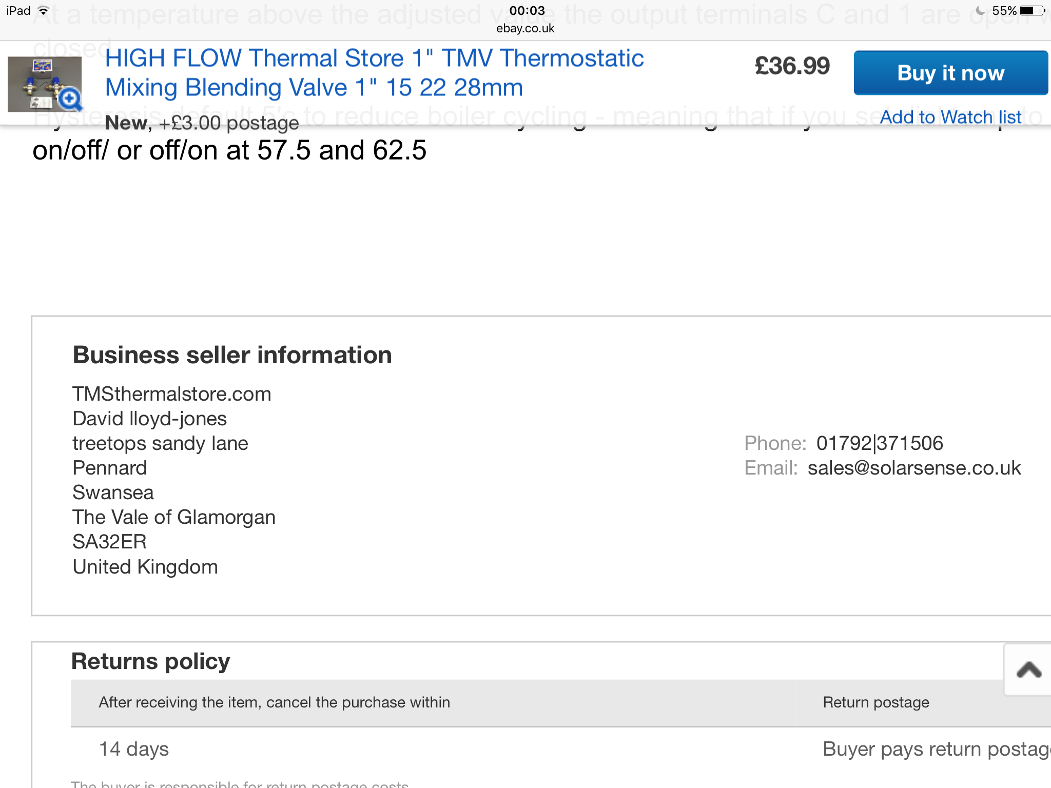

TerryE Posted January 25, 2017 Author Share Posted January 25, 2017 So what is the current wisdom on TMVs? I am talking specifically about the mix-down of the ~ 55°C output from the SunAmp with room temp or colder Domestic Cold Water (DCW) to feed the DHW manifolds. Have you guys got any personal recommendations? Is 22 or 28 best here? The 28mm TMVs seem to cost crazy money. I've got 2 × 15 outputs from the SPV into 22 and the DCW into 22. The TMV output splits again into 2×22 a few cm after the TMV output. Our current house DHW is in a mix of 22 and 15mm copper which an internal cold header tank so is at ~ 0.2 bar and we've never had any problems. Is it worth a separate 15 or 22 TMV for the low flow hand-basins set at a non-scalding temp, say 48°C? Link to comment Share on other sites More sharing options...
Nickfromwales Posted January 26, 2017 Share Posted January 26, 2017 8 hours ago, TerryE said: So what is the current wisdom on TMVs? I am talking specifically about the mix-down of the ~ 55°C output from the SunAmp with room temp or colder DCW to feed the DHW manifolds. Have you guys got any personal recommendations? Is 22 or 28 best here? The 28mm TMVs seem to cost crazy money. I've got 2 × 15 outputs from the SPV into 22 and the DCW into 22. The TMV output splits again into 2×22 a few cm after the TMV output. Our current house DHW is in a mix of 22 and 15mm copper which an internal cold header tank so is at ~ 0.2 bar and we've never had any problems. Is it worth a separate 15 or 22 TMV for the low flow hand-basins set at a non-scalding temp, say 48°C? Evening squire As you've got 2x 15mm outlets on the SPV's which are combined to give flow from both units simultaneously ( in parallel ) then there is merit to go to the 28mm TMV for reduced flow restriction and increased litres per min at the set temp. The questions are :- Do you ever see that many hot water outlets being used simultaneously to warrant such a decision? Will the incoming cold mains be man enough to allow this max velocity to be a realistic consideration? The flow through a 22mm TMV is really quite high tbh, and to give one example I previously fitted a 450ltr TS for a customer which had 22mm TMV set to 51oC. I ran both the showers simultaneously and the kitchen sink and they all ran more than adequately. There was a 300ltr cold mains accumulator to reinforce the cold main so it could maintain these rates, but the hot side certainly didn't seem to struggle at all. It may have if a bath was in the picture but running the bath whilst 2 showers are being drawn is a bit extreme. Anyhoo, a fortune? Check this TMV out. And, drum roll please........... Wales delivers once again 2 Link to comment Share on other sites More sharing options...
TerryE Posted January 26, 2017 Author Share Posted January 26, 2017 @Nickfromwales, when I get rid of this sodding man-cold that Jan's mate -- well really our mate -- gave me, I'll be starting to pressure test our system, so I will -- for the first time -- have a quantitative measure of our mains pressure, but from the subjective thumb-on-faucet test, I reckon that it's above 2 bar and below 3 -- but I might be wrong. I'm a sceptic by nature which means that hard empirical data that I trust wins out over beliefs every day. However unlike May, Trump and those other wankers, if I don't trust the data then I double check it rather that ignoring or simply rejecting it. And you might have noticed that my preferred medicine for man-cold is legally distilled and purchasable. Ho hum. Sorry other readers. Thanks to the back story on our house, we have got 1×toilet, 3×wetroom en-suites, and 1× bathroom -- in a house that will have 3 relatively dirty occupants 95% of the time (that is we bathe or shower less than once a day on average). Given that I once had 3 sweaty teenagers in our current farmhouse with its tank-fed indirect system, our new house will have at least 2× the supply capacity with 60% the demand, so I really don't envisage any issues in practice. Over the last 6 years (when there's only been 3 occupants in the farmhouse) we have averaged about 270 ltr / day mains water draw-off for all three of us, so I don't see the need for huge accumulators, even if the mains pressure proves crap. My current thinking is that we do have a DCW accumulator, so that we don't have feed issues if we do have a couple of showers going at the same time, but something relatively small -- say a 70ltr accumulator -- which should carry us over the two shower hump. However, I will order the TMW(s). Ta muchly. Mrs E doesn't think that we need a separate drop-down for the low flow basins, but she's far more likely to value your views on this than mine, so post away with your pearls of wisdom. PS. Do you ever drive over the eastern border? If you ever have to go up the M1, there's a very cheap hostelry just off J15 (This offer is also open to other selected members). Link to comment Share on other sites More sharing options...
Nickfromwales Posted January 26, 2017 Share Posted January 26, 2017 With no dependants / infirm in the house there really wouldn't be any need for the second drop down, other than for comfort / convenience. I prefer the latter, so I have one in my house. The joy of just flicking the tap on at the full hot position and having comfortably hot ( user definable of course as TMV's are fully adjustable with a simple turn of an Allen-key ) is what I like. No flicking the tap between hot and cold to get the right temp, then the pipe work temp stabilises and you have to readjust it, then someone flushes a loo elsewhere and you have to adjust it again........why do this to yourself for change of £40? @TerryE, your old farmhouse would have had a large bore ( 22mm or bigger ) DHW pipe work setup with full bore taps and no restrictive valves such as a TMV. The flow rate therefore would have been good or very good. When you introduce 15mm pipe work though a PHE, then take it through a TMV, you have to start adding the various resistances together and summise from there. As that TMV is 1" body by default, then I'd use a piece of 28mm pipe coming out, going into a 22x22x28mm compression tee, ( Demountable for servicing ). Then 22mm to each manifold. 1 Link to comment Share on other sites More sharing options...
