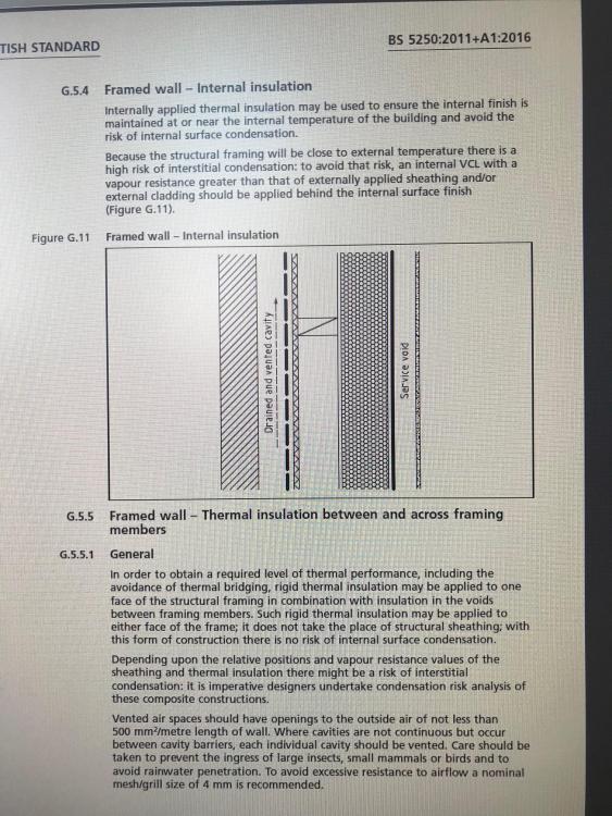

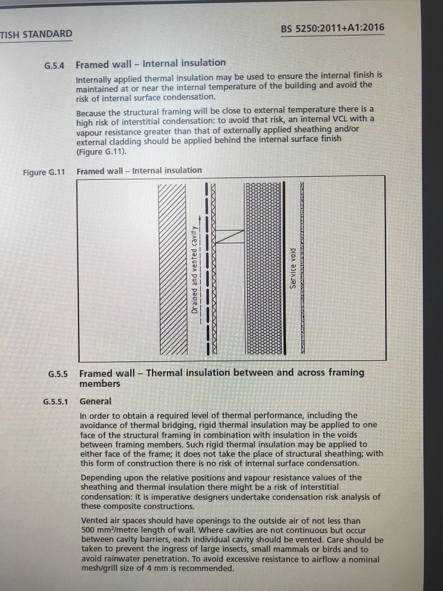

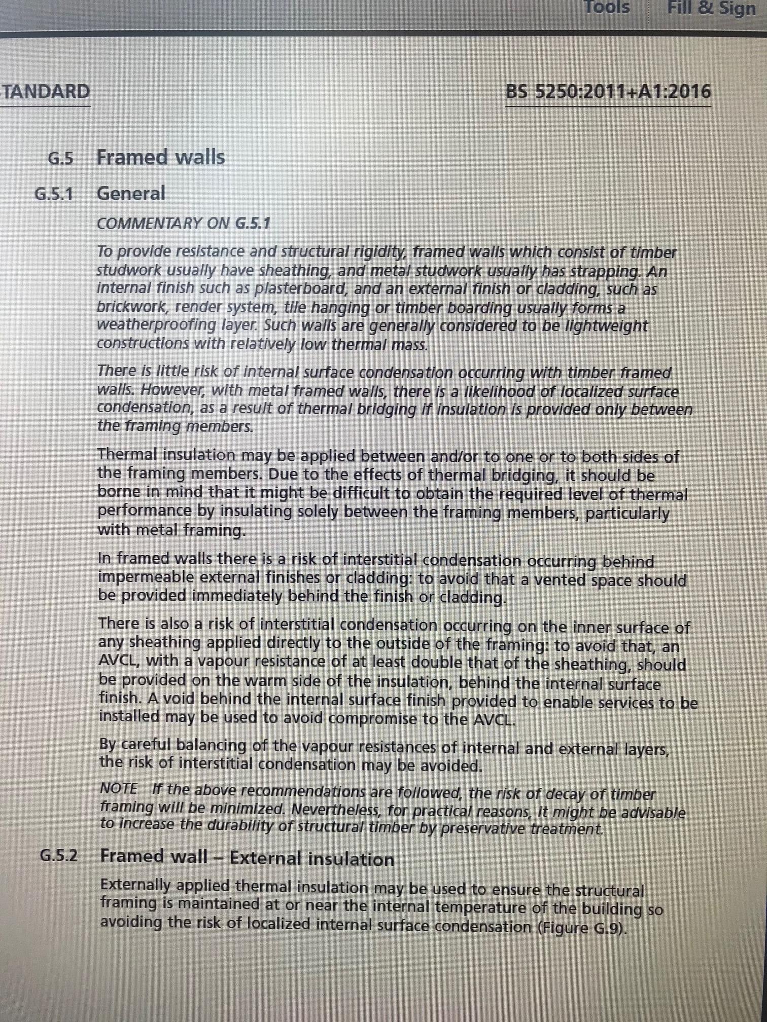

Ian Posted December 11, 2020 Share Posted December 11, 2020 With regard to condensation risk here's a couple of extracts from the current version of BS 5250: 'Code of practice for control of condensation in buildings' Some of the key points are: Page 55: A VCL with a vapour resistance of at least double that of the [external] sheathing should be provided on the warm side of the insulation. Page 92: If different types of insulation are used in successive layers, the layer with the greater vapour resistance should always be placed closer to the heated interior. Link to comment Share on other sites More sharing options...
lineweight Posted December 11, 2020 Author Share Posted December 11, 2020 27 minutes ago, Ian said: With regard to condensation risk here's a couple of extracts from the current version of BS 5250: 'Code of practice for control of condensation in buildings' Some of the key points are: Page 55: A VCL with a vapour resistance of at least double that of the [external] sheathing should be provided on the warm side of the insulation. Note though, that comment is made specifically in relation to situations where the insulation is internal to the timber frame. This is why putting the insulation on the outside of the frame is much preferable from the point of view of reducing condensation risk. Link to comment Share on other sites More sharing options...
