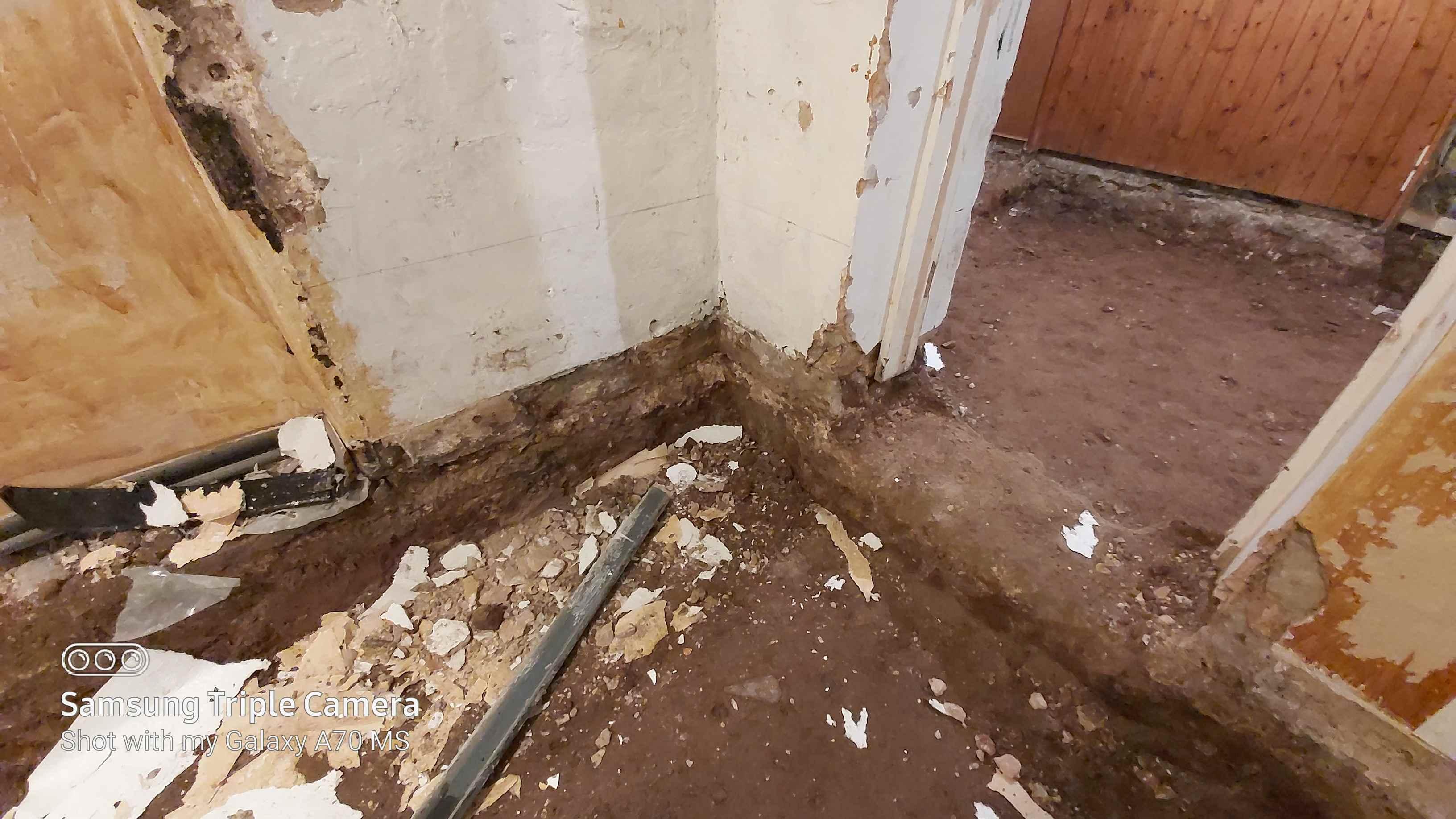

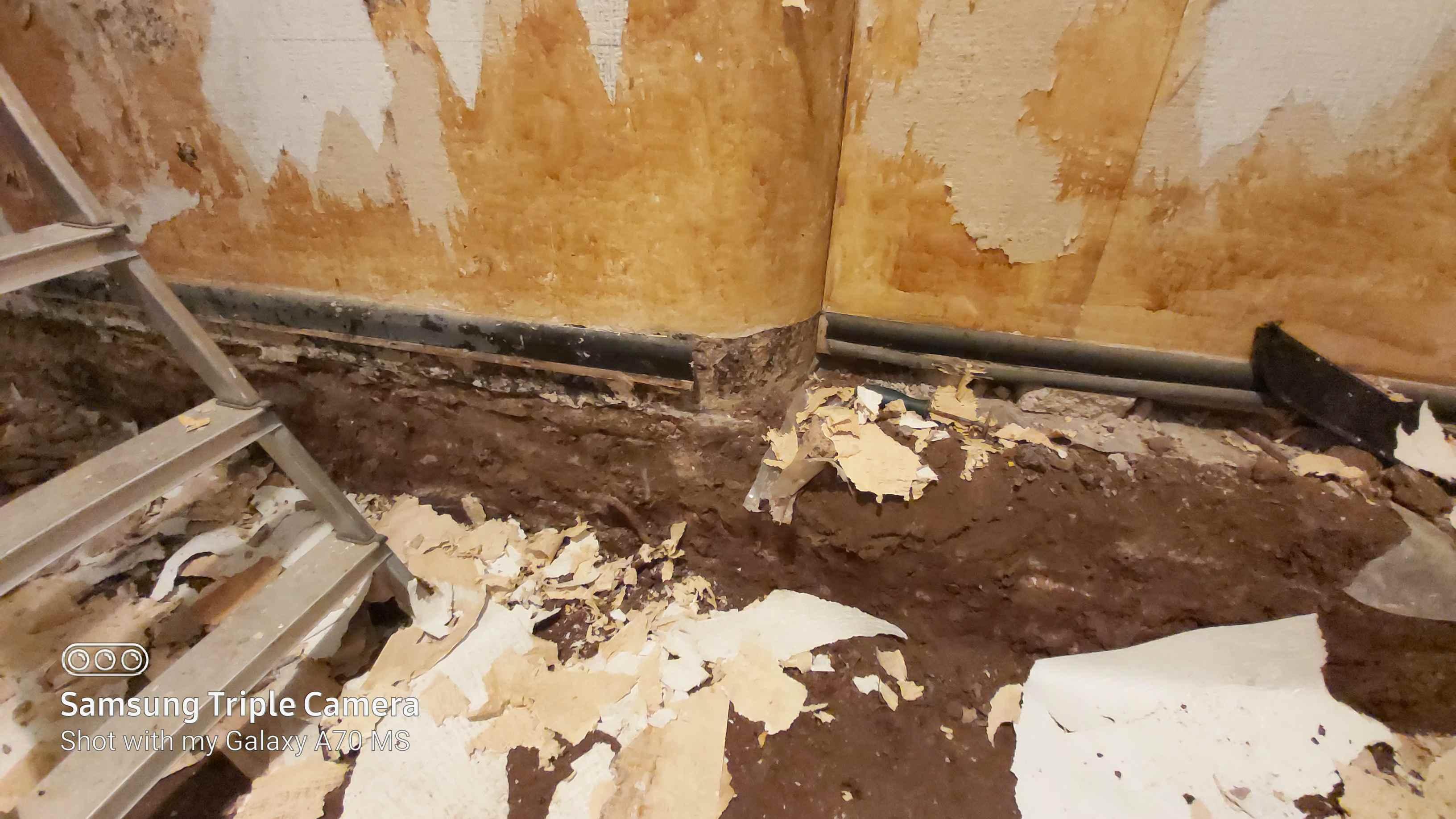

strideredc Posted November 20, 2020 Share Posted November 20, 2020 Staring to get somewhere with the underfloor so now on to what to do with the plaster when we come to do it... below floor level its damp! it's been like this since it was converted in 1976 and looks a bit ropey but it's not to bad most of the old plaster needs to come off but what/how to replace it? its stone and rubble 1.5ft thick walls but what do we put in its place? as we are on a hill it's more the back wall as that's ground level where as the front is 5++ft above ground. the underfloor htg will heat the house much more evenly than before as it going to be on a ASHP but we dont want to plaster if damp is going to be a continuous issue... lots of the old issues were guttering (now fixed)and the drainage we can improve but we dont want to do something if it's wrong! it's only an issue going 8-10 inch up the walls. Any suggestions??? Link to comment Share on other sites More sharing options...

Ferdinand Posted November 21, 2020 Share Posted November 21, 2020 The sensible, but perhaps not doable, thing would be to wait to see if it dries out - which will inform what you can do. In the absence of that possibility, there are things you could do such as install something which works not, and will allow it to continue to dry out. But for a start, what sort of wall is it - internal / external and what material? I'm guessing solid block and external? What is behind that curved corner. For an external wall one thing I have done is dry line including an insulating membrane, allowing it to dry outwards in the future. Then the new DPC in the floor wraps up into the new drylined wall. Alternatively, can you inject a DPC? May not be perfect, but it would be a vast improvement. F Link to comment Share on other sites More sharing options...

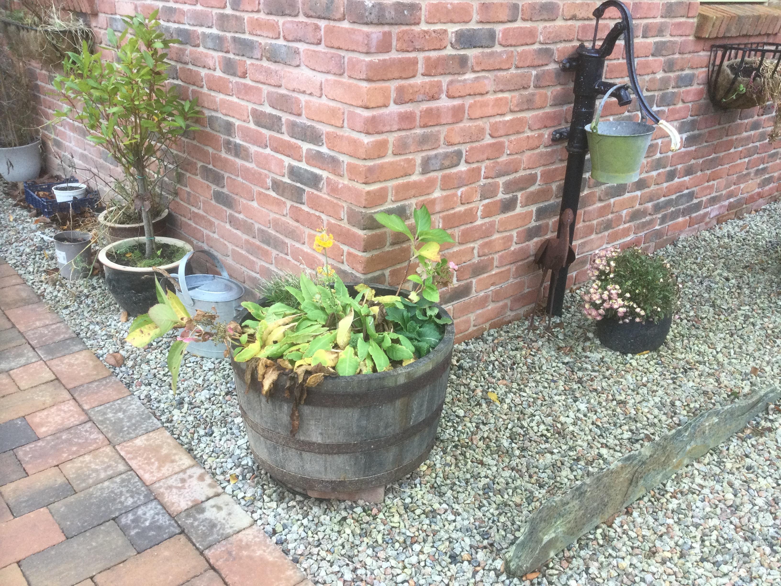

joe90 Posted November 21, 2020 Share Posted November 21, 2020 (edited) 40mm granite chips, most leaves blow away here (next to the Atlantic) but fir those that don’t I clear them up occasionally. Edited November 21, 2020 by joe90 Link to comment Share on other sites More sharing options...
scottishjohn Posted November 21, 2020 Share Posted November 21, 2020 if back wall has earth banked up to it --its always going to be good cause of damp in walls dig the earth way or you have to tank inside somehow lots of ways to do that --all cost money I have same problem with part of my old building project --suggested solution as its a total refurb -- build stud wall inside and then spray closed cell foam on wall --that is water proof only you can say how much damp there is sounds like its coming up from the floor if only 8-10" up the wall but would be suprised if its only coming from there if back wall is below ground level. Link to comment Share on other sites More sharing options...
strideredc Posted November 22, 2020 Author Share Posted November 22, 2020 thanks for the replies, the floor (not at the mo as its dug out for ufh) is level with the ground outside that consists of a cobblestone yard. no banking of earth or anything like that... I dont want to plaster and have it coming through. options are lime plaster, it's a big wall! then you have to use paint that costs a 100 quid a can! batton and insulate plasterboard with a membrane? Link to comment Share on other sites More sharing options...
jfb Posted November 22, 2020 Share Posted November 22, 2020 Lime wash isn’t so expensive. Bit different to put on than normal paint but very easy once you get a couple things right (dampen wall before painting and go for thin layers). are you planning on insulating the walls? You can still do that with a breathable buildup (lime plaster backing coat/airtight layer, wood fibre board, finish lime plaster). I’ll second putting in a french drain along the outside wall. Link to comment Share on other sites More sharing options...
scottishjohn Posted November 22, 2020 Share Posted November 22, 2020 Hi ,-- sorry i mis read your first post - and thought back wall was piled up with earth if not then the french drain at bottom of trench filled stone chips next to wall is a good solution you could always go for wainscott panelling on inside --which is one of the reasons why they used 100+years ago , -- cos bottom of wall was always prone to damp and that solved it very common in old farms and cottages Link to comment Share on other sites More sharing options...
