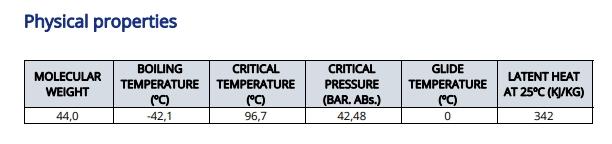

J1mbo Posted November 20, 2020 Share Posted November 20, 2020 Some R290 info is here: https://www.gas-servei.com/shop/docs/technical-data-sheet-r-290-gas-servei.pdf Link to comment Share on other sites More sharing options...
SteamyTea Posted November 20, 2020 Share Posted November 20, 2020 (edited) 5 minutes ago, J1mbo said: Some R290 info Can see why they use it, nothing is scary about it, like Goldilocks. Water does have a latent heat of 2257 though Edited November 20, 2020 by SteamyTea Link to comment Share on other sites More sharing options...
