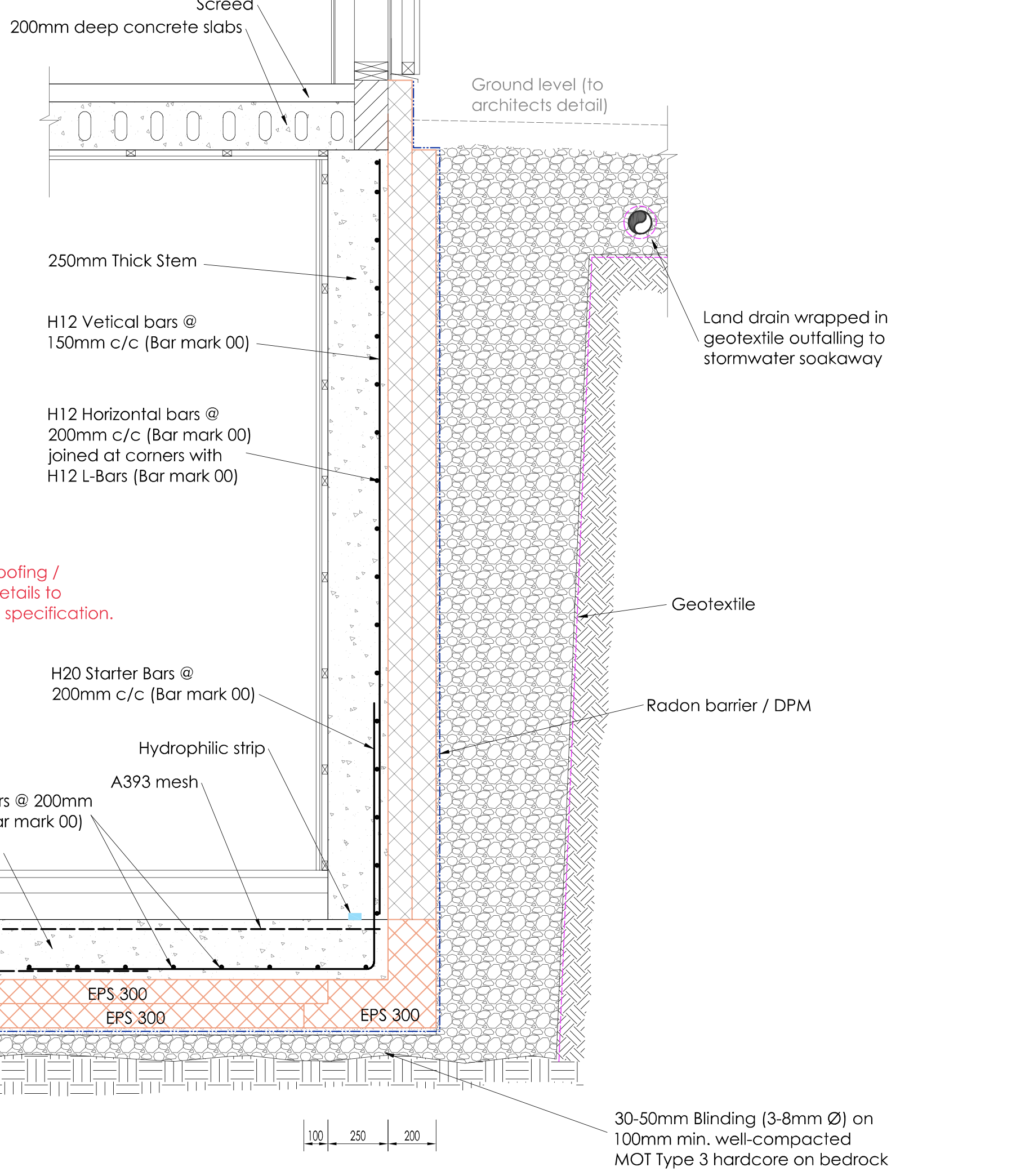

Conor Posted November 7, 2020 Posted November 7, 2020 How have you all backfilled your basements? I'm seeing various methods - from the American style of a perimeter drain and the rest earth, to various European standards of stone combinations. I'm installing the 100mm French drain with clean stone along the slab esge. The architect has suggested filling the entire excavation with 20-40mm dia clean stone from the drain to ground level. Issue with this is it will cost several thousand pounds. An alternative I've seen is after the drain is installed, stone is placed in layers against the face to a thickness of about 300mm, the rest of the trench can then be local soil. Some details show that you need a geo membrane between the clean stone layer and the soil. Any suggestions? I'm keen to sue up some of the massive mounds of risings on site... https://www.sciencedirect.com/science/article/pii/S036013231930784X
Bitpipe Posted November 7, 2020 Posted November 7, 2020 We used clean stone to backfill - fist sized lumps of various recycled stone (brick etc) but no fines. Acts as a giant French drain (perforated land drain under that which you don't want to get clogged). On one very wide section we had a 1m width of stone and some spoil vertically separated by geotextile. The most important thing about stone is it is free draining and does not compact, which is very important if you're filling a 3.5m deep x 1m wide trench around your whole house. Top layer can be spoil as you may be laying rainwater pipes etc in this but it must be well compacted. Our contractors filled in most of the basement excavation area to spec but while I was away they obviously cut a few corners at the end and used site spoil to the rear. While it all looked flat and lovely when complete, a few months later, when the scaff was up, it started to settle and dropped almost a foot. It continued to settle for the next year and then the landscaper put a lot of compacted crush on top to make up the levels and act as a solid base for the patio. Unfortunately there has been a bit more settlement and quite a few of the flags are sagging - it had a lovely even fall when laid but now getting puddling when it rains. I've lifted and relaid a few, using CT1 to bond them back down but if it gets worse I'll need to lift the whole lot and re-lay on a clean bed. Where it was backfilled to spec it is rock solid. The SE did suggest that site spoil could be used but it had to be mechanically compacted in 150mm layers - this is very time consuming but necessary otherwise it will eventually settle. So either go for stone or pay for the extra labour to compact well in 150mm layers. 1
Conor Posted November 8, 2020 Author Posted November 8, 2020 Thanks @Bitpipe. How did you lay the geomembrane between the stone and spoil? I can see it being rally akward. This is what I'm thinking for the gable end as it'll one ever be garden and quite a wide excavation due to soft ground.

Bitpipe Posted November 8, 2020 Posted November 8, 2020 5 hours ago, Conor said: Thanks @Bitpipe. How did you lay the geomembrane between the stone and spoil? I can see it being rally akward. This is what I'm thinking for the gable end as it'll one ever be garden and quite a wide excavation due to soft ground. The contractor did it - basically they unrolled about 15m of it (it's 4m wide) and weighed it down with a few rocks and flapped it away from the rock infill side. They put a layer of rock down and then flapped it the other way and put a layer of subsoil, repeat until you reach the top.

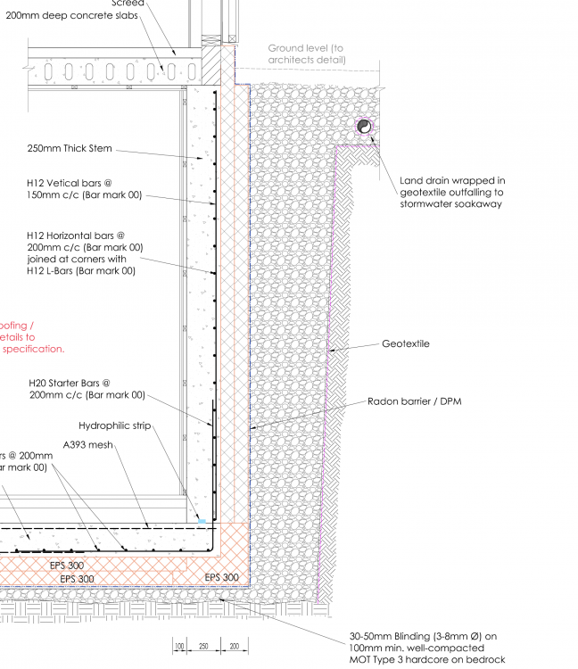

Bitpipe Posted November 8, 2020 Posted November 8, 2020 3 hours ago, Thorfun said: thanks for the great advice as usual @Bitpipe. our SE is TSD and they've designed the insulated slab using the Kore system. I'm not sure what the loads are but at some places they're so high that we've got to add Foamglas instead of the EPS to deal with those loads. As such I trust that they've done their calculations correct when specifying the EPS300. I'm not sure why the land drain is specified so high I just assumed it should be but you make a valid case and I will question this one and ask why it's not at the base of the slab level. I wonder if it's due to the basement having to tie in with the 'arms' of our building and so the land drain is dealing with the water from those insulated slabs as well? I will ask the question though thanks. I did wonder if it was Kore given the detailing. Are you putting any UFH in the basement slab? We decided against and haven't regretted it as that part of the house is always at a comfortable 20o year round.

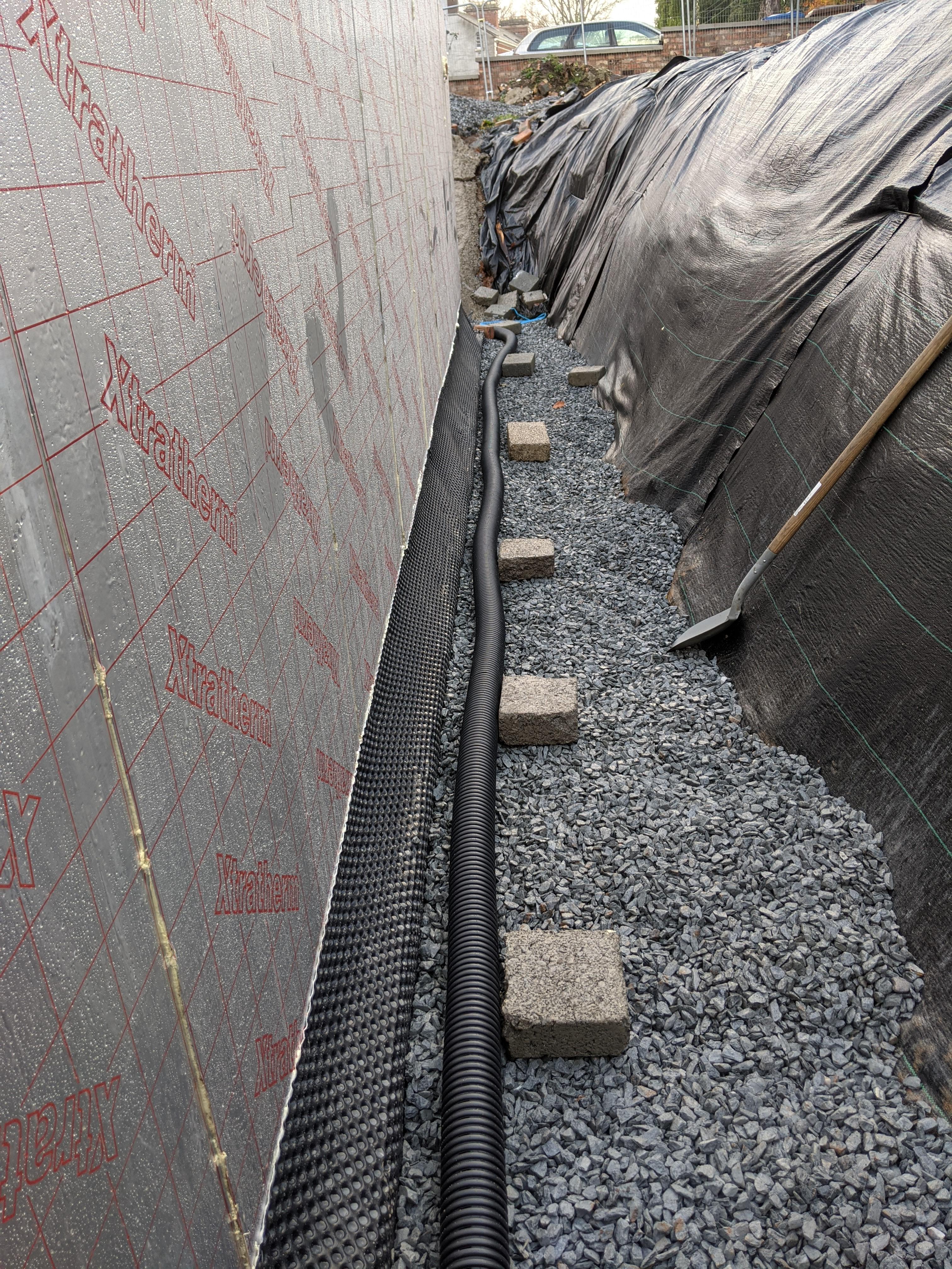

Adam2 Posted November 8, 2020 Posted November 8, 2020 On 07/11/2020 at 08:18, Conor said: How have you all backfilled your basements? Slightly different to the above: 100mm perforated drain around perimeter of slab toe sitting in pea shingle about 100mm below and 100-200 above. Membrane placed around the shingle. The drain then flows off into our soakaway. Above this we have 2 types of back-fill - where the back-fill will be built on we can't use site material as the SE says is not granular enough (mostly sand/sandstone) so have to use 6F5 compacted in 150mm levels to a certain number of passes depending on type/size of compactor. Where we're not building but will landscape, we'll mix in some 6F5 with the sand so we buy less 6F5 and pay less to remove our lovely sand!

Adam2 Posted November 8, 2020 Posted November 8, 2020 I figured this was about reusing onsite materials for backfill so didn't mention that. Me - BASF membrane, double drain, EPS sheet 25mm then backfill. Also under slab membrane and water bar at junctions of pours (ICF on concrete raft).

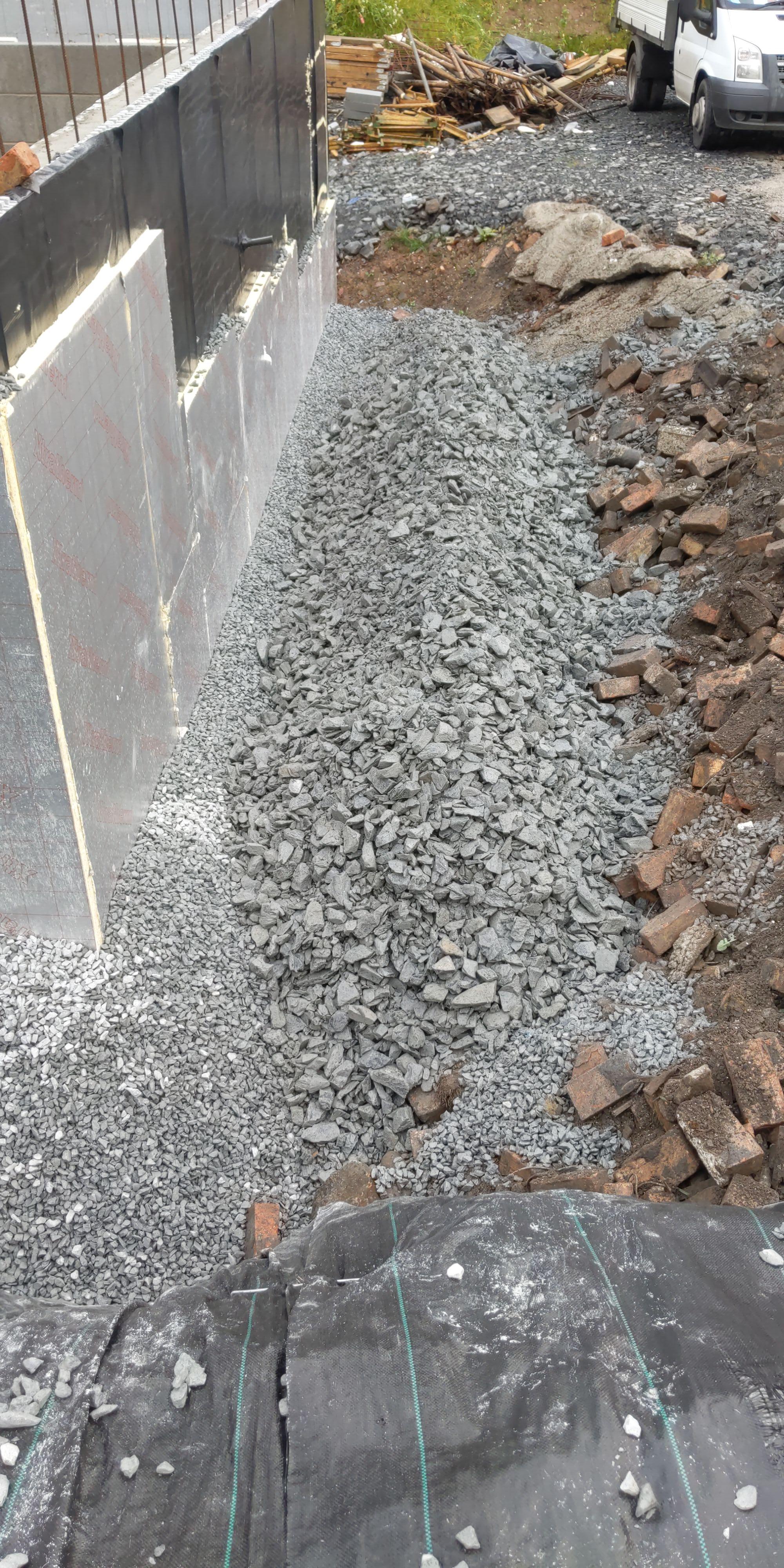

Conor Posted November 9, 2020 Author Posted November 9, 2020 So we've come with 14mm chippings for the base and around the drain. Keeping at least 300mm of that against the face and we fill up. Ordered 100mm clean stone for the rest... Fat from clean but we're on a tight schedule and have to make do! Going to lap the geomembrane over the top of the clean stone to the face once we are about 300mm from FGL and compact come type 3 to make the surface.
