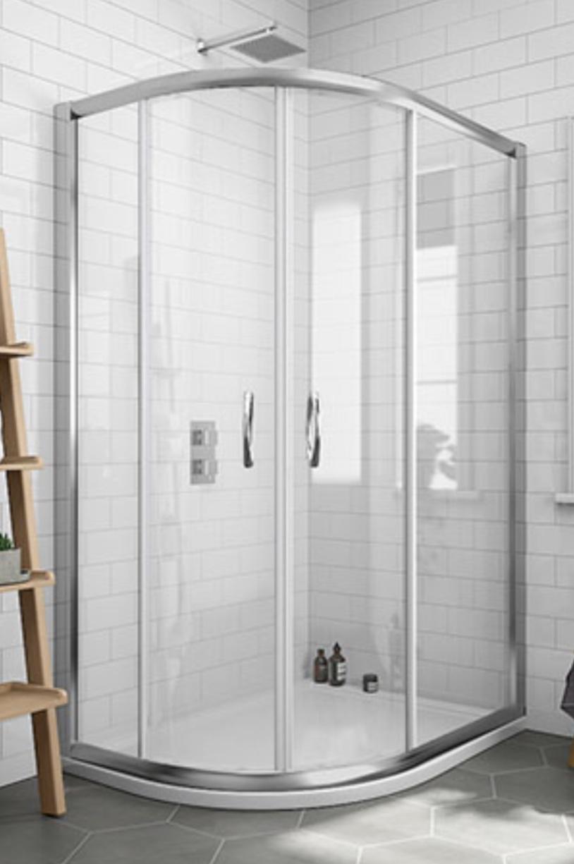

Cpd Posted November 6, 2020 Share Posted November 6, 2020 I am needing to replace a bath with a shower at parents house, the existing plumbing is bad as the waste cannot be any lower than it is which is a couple of inches of the floor..... this means that the shower tray will need to be raised of the ground on a plinth. The layout of the bathroom suggests that the best shower will be a 900 x 1200 quadrant design. I had narrowed my search down to a CORAM tray and glass surround (I have used them before) but there is a supply issue and it looks like at least 3 weeks until they are restocked. I like the Coram tray as it has two big upstands at the back that I can bring my wall boards down over and adjusting feet that gets me above the waste, it’s a known product for me as I fitted one in my cabin a few years ago and it’s still going strong. I am sure there are loads of people on here who have fitted showers and I was looking for a brand recommendation for a tray and surround. The big issue is the tray as it needs to be raised and i don’t want something really heavy as I would have to rip up the floors and add supports etc. Anyway I am trawling the web and will go into various builders merchants but if someone knew a solution / combination that was readily available and could RECOMMEND it that would be reassuring. Thanks cpd. the picture is random but it is what I am looking for BUT with a raised tray and a know recommended brand. Link to comment Share on other sites More sharing options...
