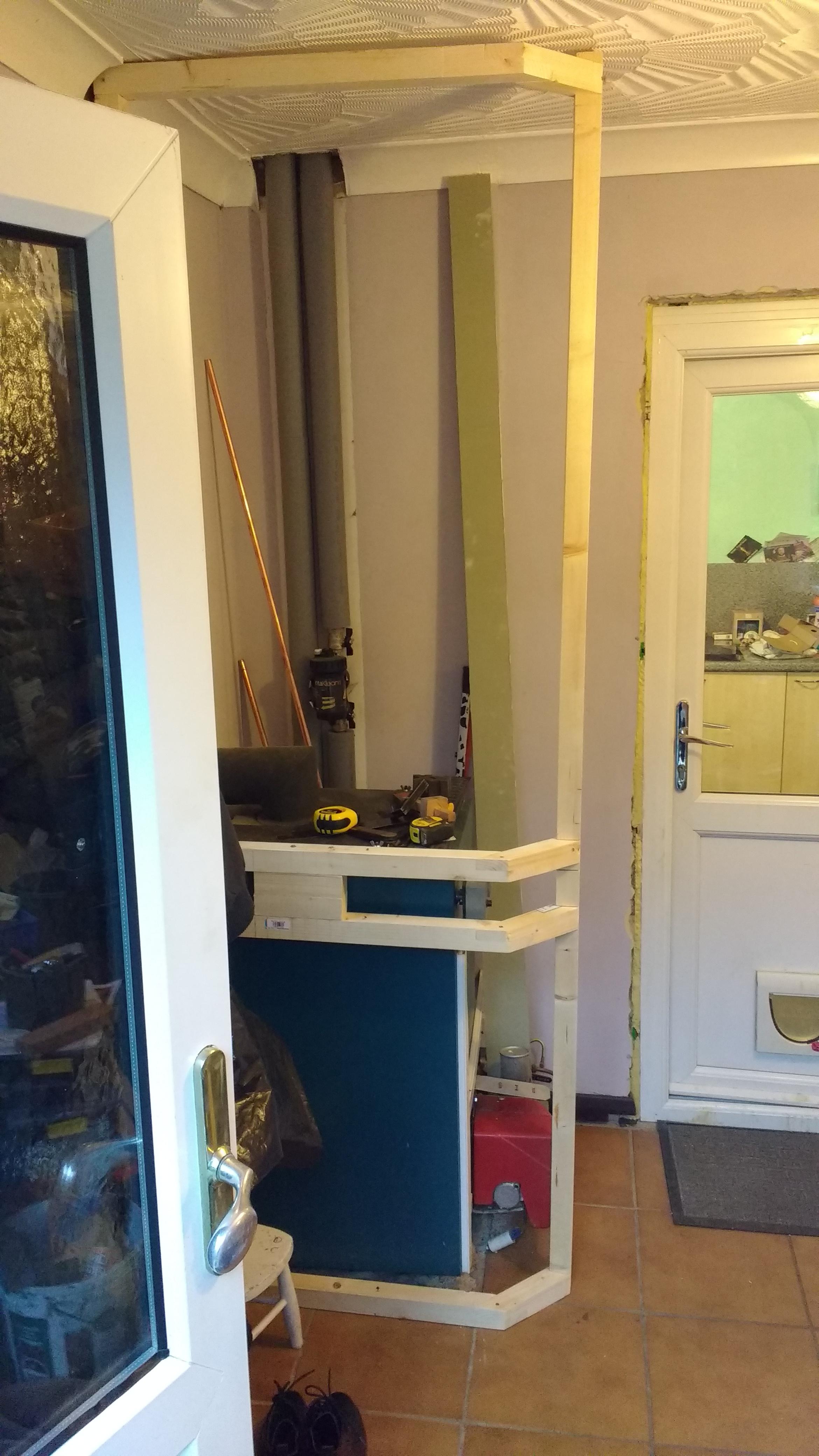

Onoff Posted December 27, 2020 Author Posted December 27, 2020 14 minutes ago, Gav_P said: How did the final boxing in turn out? Coming along: (You haven't been here long have you? ?) 2

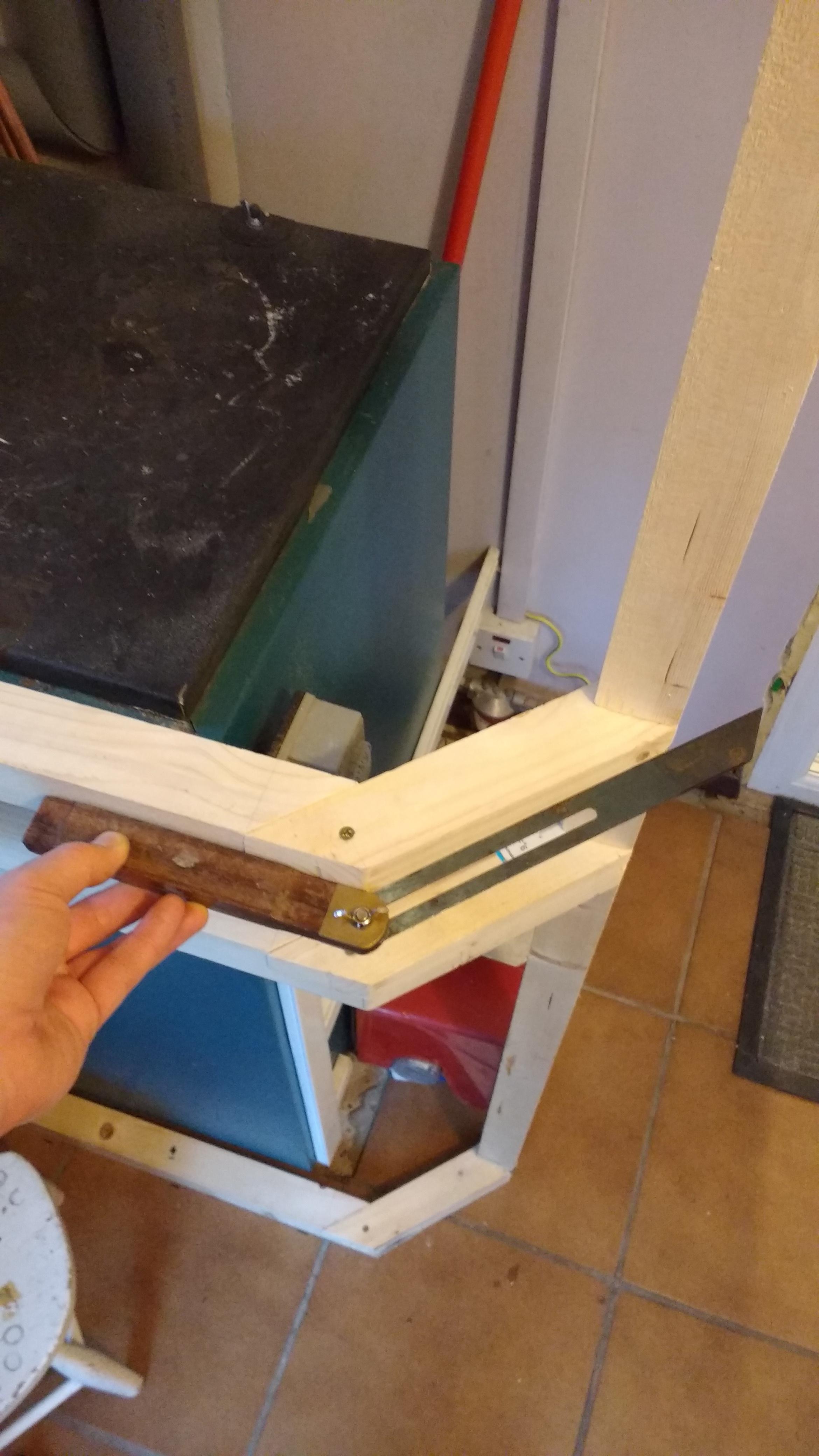

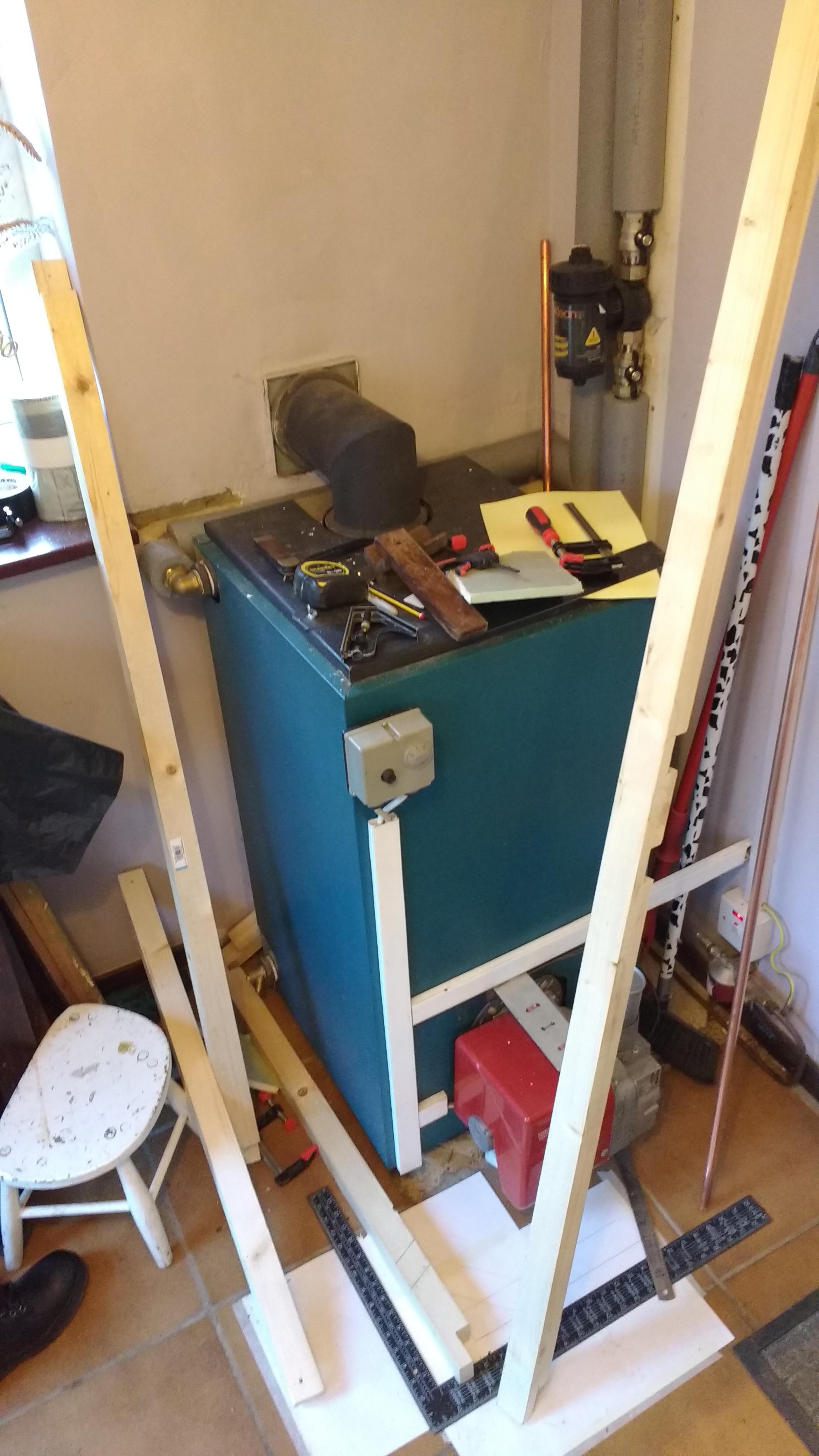

Onoff Posted December 27, 2020 Author Posted December 27, 2020 In can't be ar$ed, on a downer, no mojo mood. Made one cut on the saw then put it away. Bored with it now. Can't decide how best to make this angle joint super solid. Probably a lap joint/biscuit/screw/gorilla glue. Tomorrow or the next day...
Gav_P Posted December 27, 2020 Posted December 27, 2020 That appears to have gone backwards? You had a side frame up at one point. ? Havent you got a 3D model in Catia ? Surely that’s the first step. 1
Gav_P Posted December 27, 2020 Posted December 27, 2020 24 minutes ago, Onoff said: In can't be ar$ed, on a downer, no mojo mood All been there... I’m still putting off yesterday’s job.
Onoff Posted December 27, 2020 Author Posted December 27, 2020 13 minutes ago, Gav_P said: That appears to have gone backwards? You had a side frame up at one point. ? I've decided to mitre the corner to soften the look. That whole side will be on hinges like one big door.
Gav_P Posted December 27, 2020 Posted December 27, 2020 1 minute ago, Onoff said: I've decided to mitre the corner to soften the look. That whole side will be on hinges like one big door. Still doing floor to ceiling or are you stepping it back in over the top of the boiler?
Onoff Posted December 27, 2020 Author Posted December 27, 2020 2 minutes ago, Gav_P said: Still doing floor to ceiling or are you stepping it back in over the top of the boiler? Floor to ceiling still, unless that looks crap.

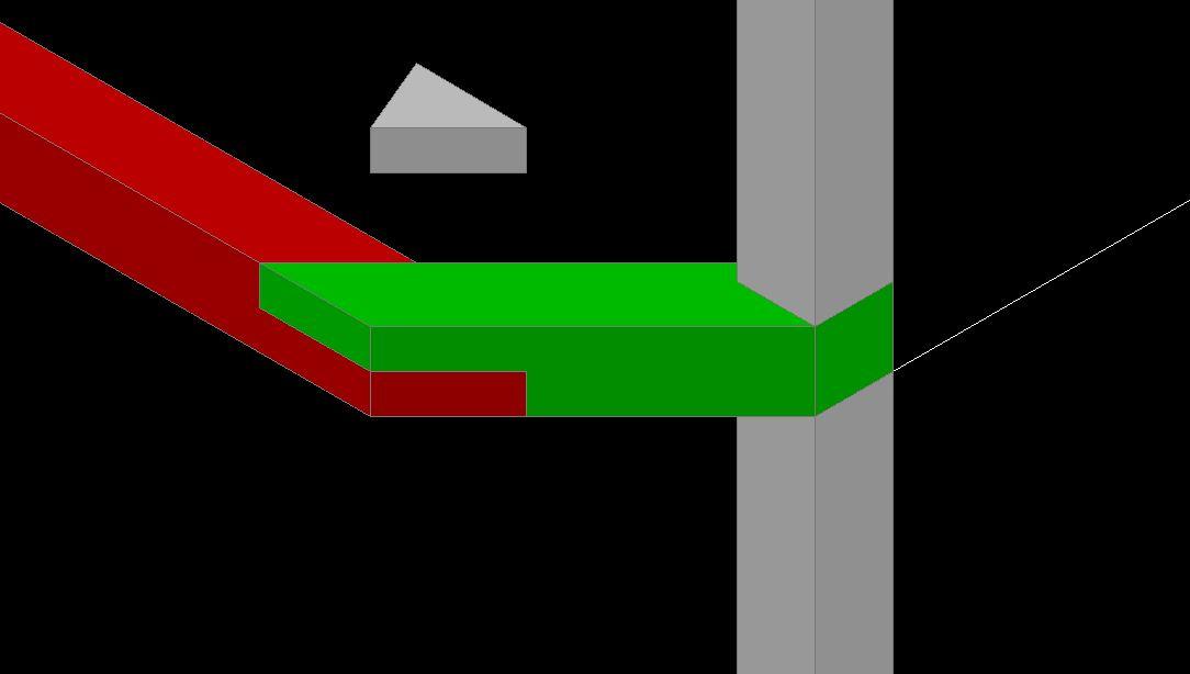

Onoff Posted December 27, 2020 Author Posted December 27, 2020 1 hour ago, Gav_P said: Havent you got a 3D model in Catia ? Surely that’s the first step. I have been playing in AutoCAD: 1 1

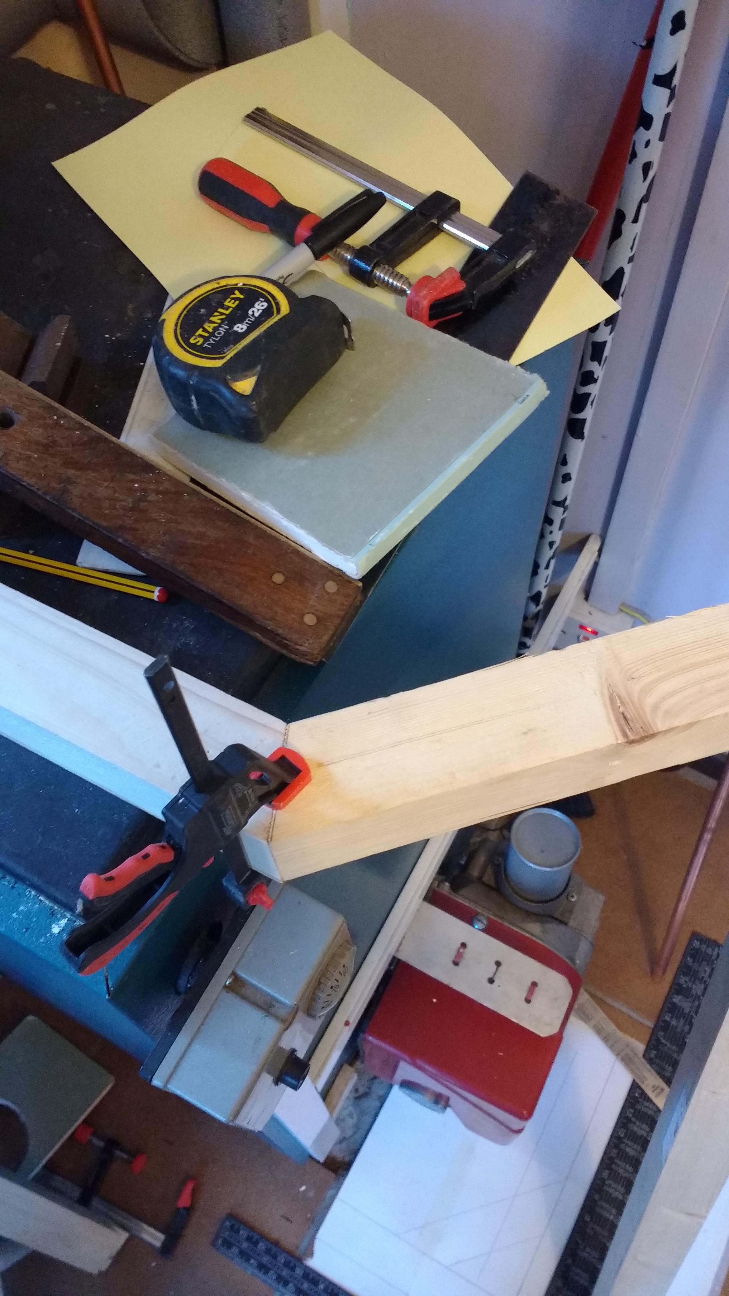

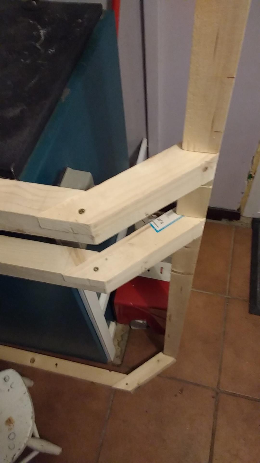

Onoff Posted December 28, 2020 Author Posted December 28, 2020 (edited) Chamfering the corner does indeed seem to soften the look. The Fakita recip saw and Parkside multi tool made an appearance. The 45deg lap joints done on the DeWalt radial arm saw. I'll trim the top one once the Gorilla glue has set. Reckon I might need another vertical member at the change of angle. This is going to be one big, hinged door covered in plasterboard. It'll look a bit tidier with a good sanding. The black marks are from the coating on the Saxton blades coming off and mixing with the Gorilla glue. Edited December 28, 2020 by Onoff 1

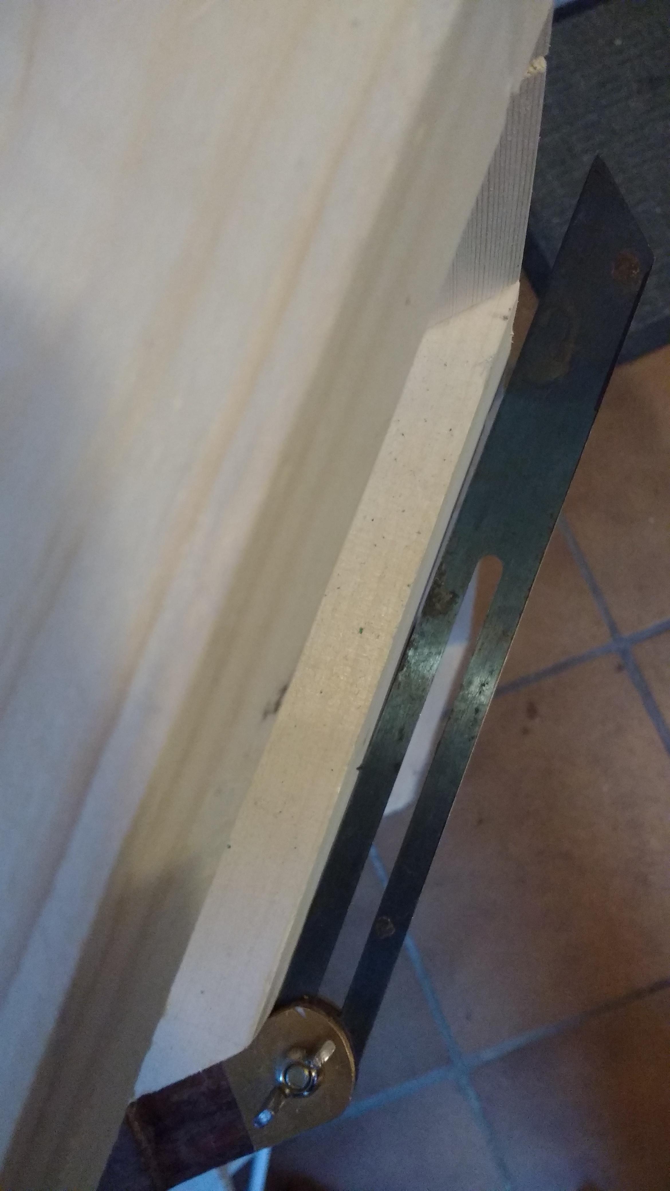

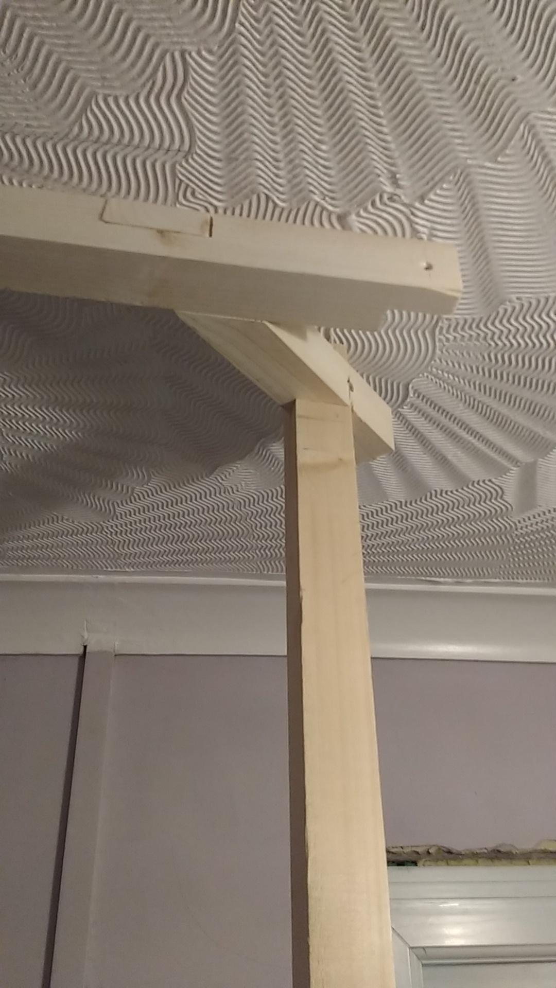

Onoff Posted December 29, 2020 Author Posted December 29, 2020 Idiot boy I am! ? I should have glued the angle joints first and let them set. Only having one screw in, when I then screwed the upright on it's likely slightly twisted along its length. This has pulled two of the angle joints to less than 45deg. Perfect 45deg: The one below, less than 45deg: Too eager with the glue! I should have left the glue out for now. (Makes it harder anyway to do extra housing joints in the pieces). It might improve when I get the glue snots off and plane the slight joint overhangs but not enough I don't think. Guess the plasterboard cover will just have to "give" a bit!

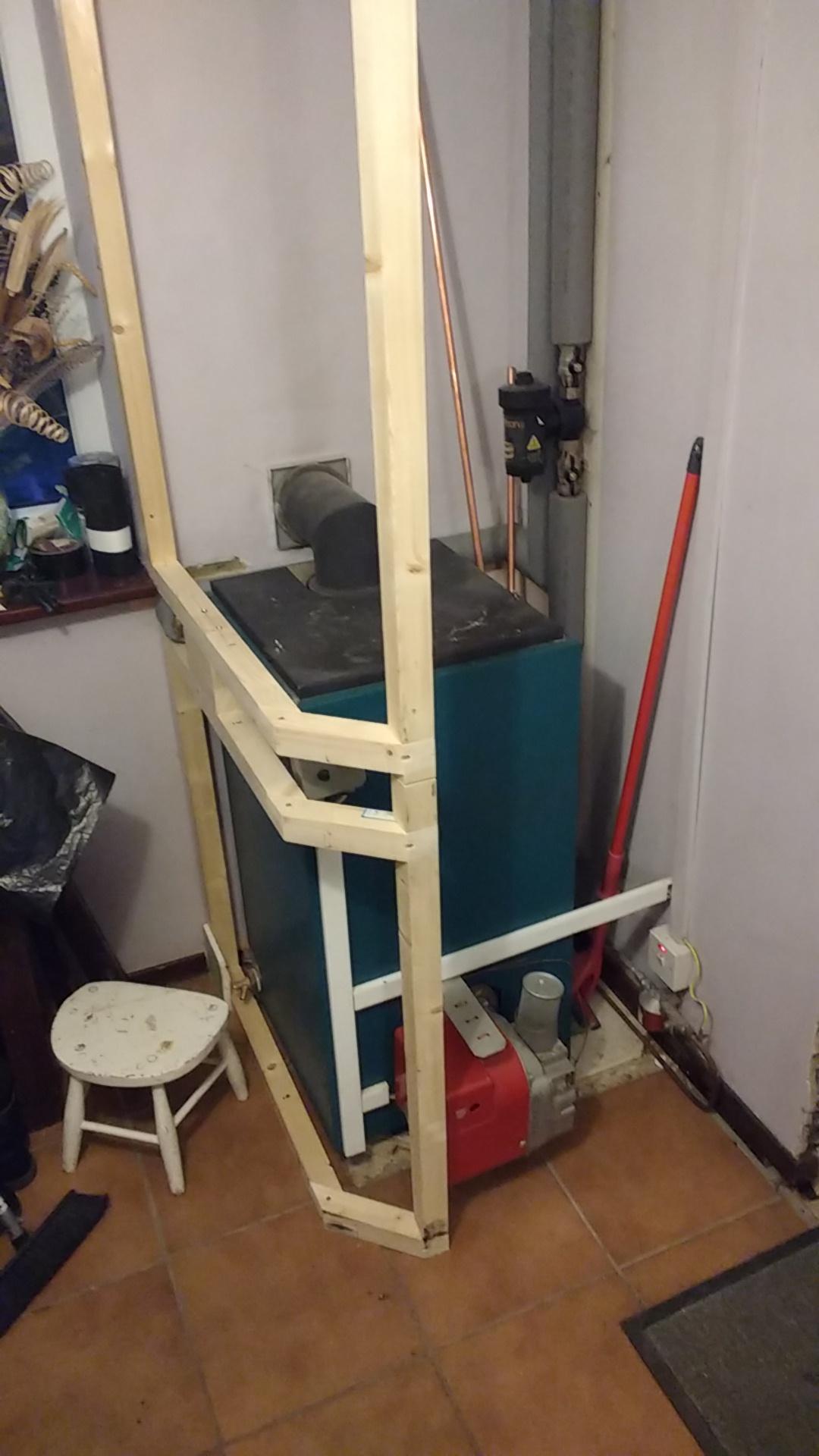

Onoff Posted December 30, 2020 Author Posted December 30, 2020 Tidied up a bit. Bit of planing and sanding. Not finished yet. I was going to cover this with fire resistant pb. Thinking maybe instead to cover with MDF, maybe 9mm. Would I get away with 6mm? MDF will take a paint finish better than pb and be lighter I reckon. It'll all be infilled with sound absorbing Rockwool. Might do the hinge side next.

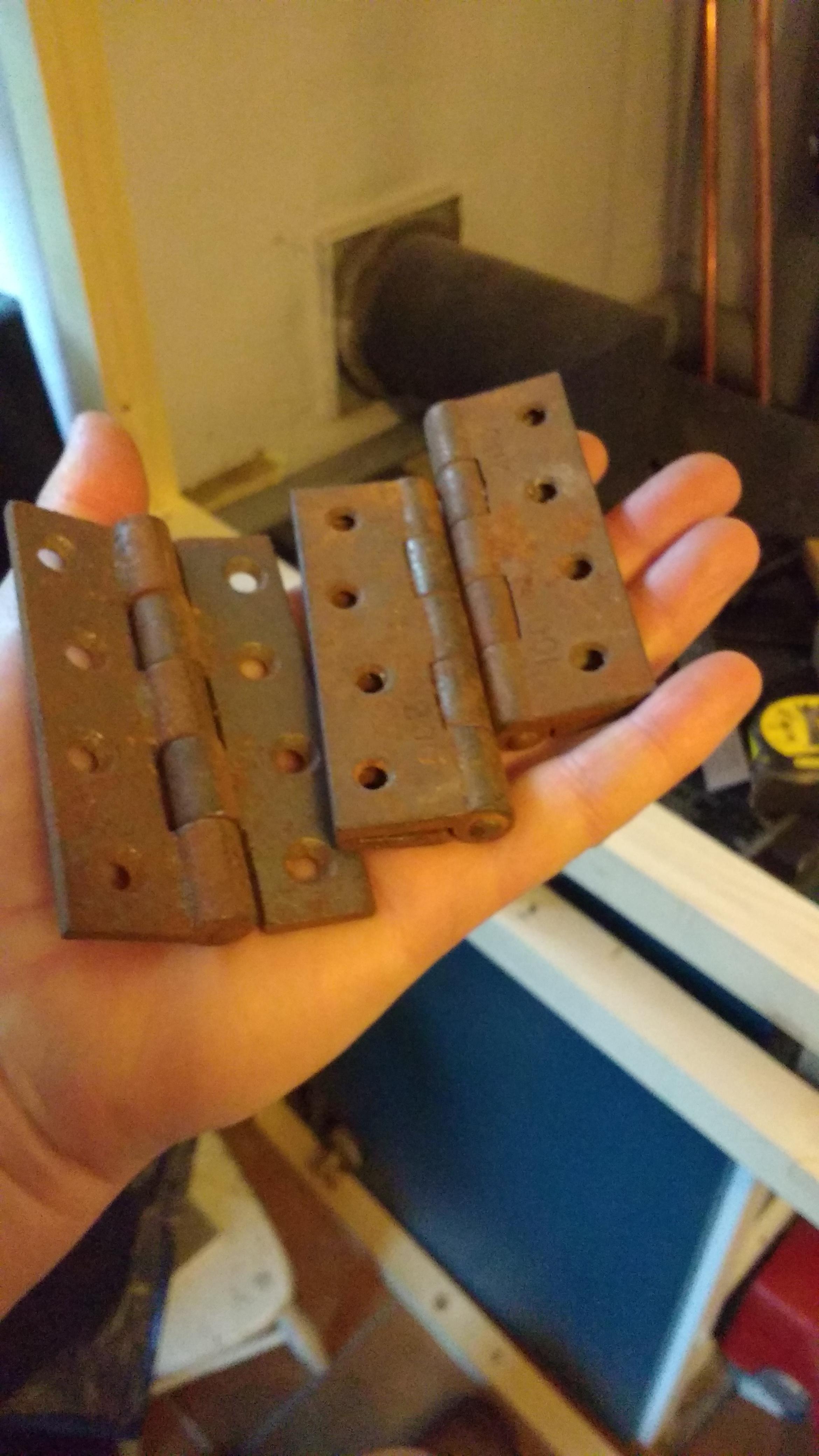

Onoff Posted December 31, 2020 Author Posted December 31, 2020 Found 3 old, plain steel, slightly rusty, 100mm hinges, they'll do for my "door". Really heavy duty. Might give them a quick citric acid bath as a treat. I always seem to make up a hinge jig per project, for whatever hinge I'm using and then scrap it! For use with my diddy Bosch router. Always come out a treat mind, even in crappy softwood or reclaimed rough stuff. Usually out of flooring t&g offcuts or MDF. Might try and keep this one and write on it what it's for then give it a coat of varnish. 1
