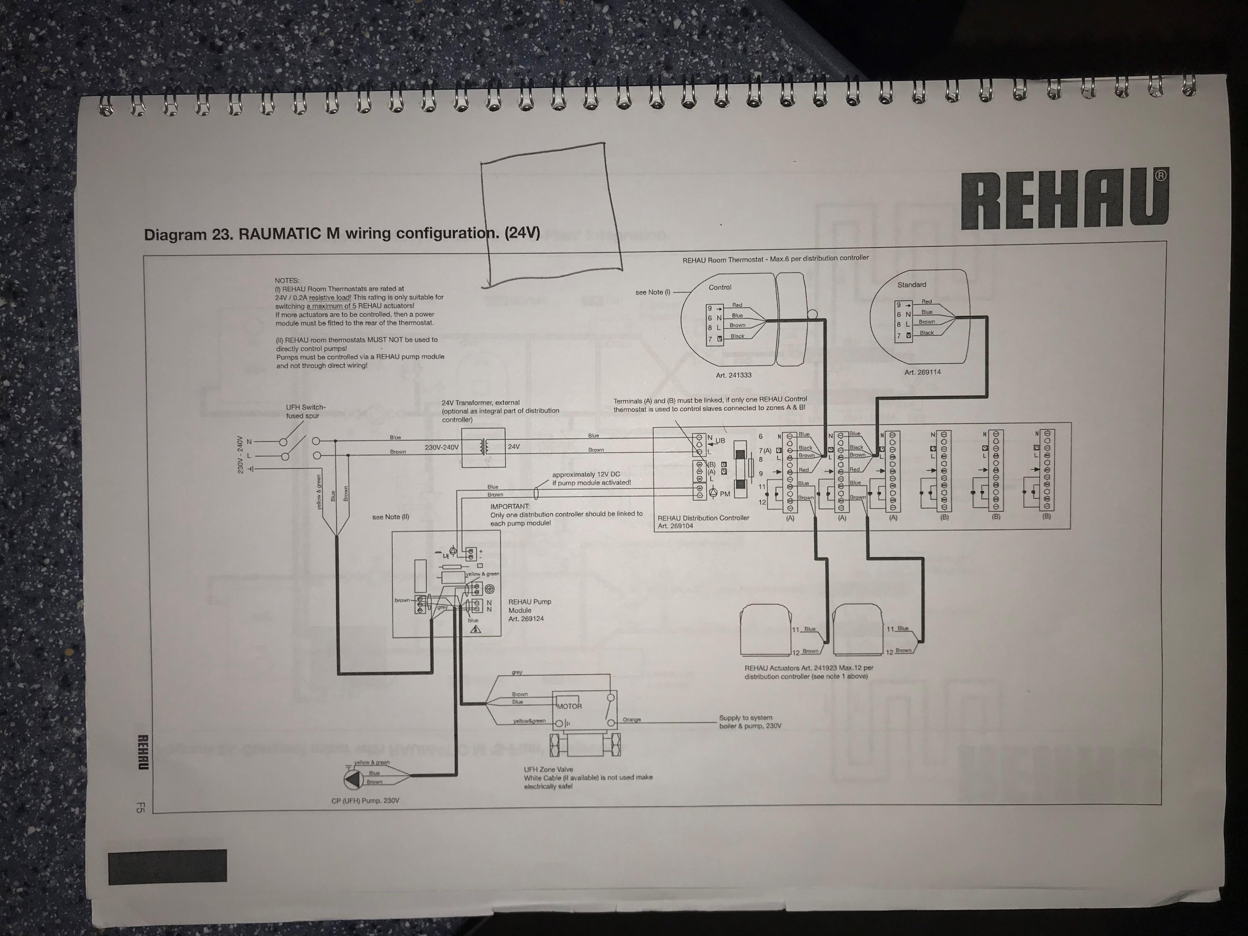

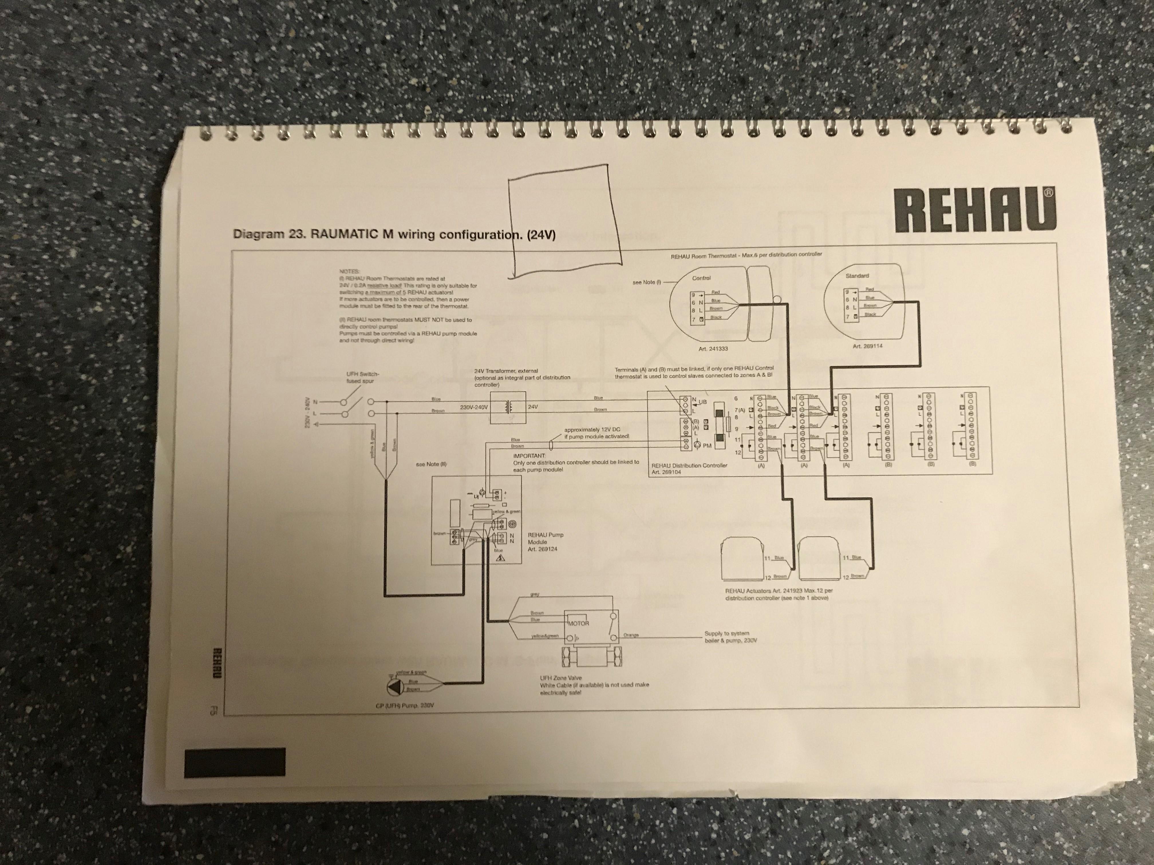

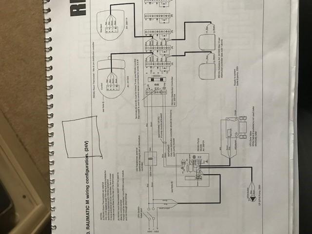

mike 15 Posted November 1, 2020 Author Share Posted November 1, 2020 Thanks for the responses. The UFH controller switched fused spur is itself fed from the boiler switched fused spur. I've attached the wiring diagram for the UFH system. The controller is 24v. The bit we are interested in is the pump module which is effectively just a relay. The module has 240v feed (again coming from the same circuit as the boiler and the controller). This feed is switched through to the pump and to a motorized valve. When the valve is fully open a switch is triggered which then provides 240v signal to the boiler. Fiendishly clever! Anyway, it's that last bit of wiring that I was asking about - single line feed. What kind of cable to use? Link to comment Share on other sites More sharing options...

ProDave Posted November 1, 2020 Share Posted November 1, 2020 I can't read that drawing, even if I zoom in, it's too fuzzy to read. Can you take a higher resolution picture. Be VERY careful, that is a 24V UFH controller, you might need a relay to connect to the boiler if it does not already have a volt free contact output but I can't tell from that drawing. Oh and rotate the camera so it posts the right way up, my neck was getting a crick trying to read it. (meant in the nicest possible way) Link to comment Share on other sites More sharing options...

mike 15 Posted November 1, 2020 Author Share Posted November 1, 2020 Link to comment Share on other sites More sharing options...
ProDave Posted November 1, 2020 Share Posted November 1, 2020 thanks that's a readable version. Have you got that 2 port motorised valve shown in the diagram? Link to comment Share on other sites More sharing options...

mike 15 Posted November 1, 2020 Author Share Posted November 1, 2020 Thanks I was trying to avoid unnecessary complication by describing the set up as per the diagram. In actual fact there are no radiators so there is no motorised valve. There are multiple room stats and pipe circuits all controlled from the manifold/controller. So to run a feed to the boiler (orange in the diagram) the connection would be made straight from the pump module (grey in the diagram) giving the desired result. Interesting comment about the earth wire. I can connect the earth both at the boiler and at the pump module no problem. But out of curiosity, isn't it the case that many room thermostats as an example which act as a 240v switch using 2 wire layout don't need to be earthed and don't actually have an earth terminal? So am I right in thinking that 2 core wire is used in these cases without an earth wire? Link to comment Share on other sites More sharing options...
ProDave Posted November 1, 2020 Share Posted November 1, 2020 You must be 100% SURE that the boiler AND the UFH manifold are indeed connected to the SAME circuit before you make that assumption. Not only the same circuit, but possibly the same sub circuit. i.e you may have a "heating" circuit from the consumer unit that feeds the boiler via one Fuses Connection unit and feeds the UFH manifold via another Fused connection Unit in a different place. It would not be acceptable to link the grey to the boiler call for heat under that situation. If you had the motorised valve you could connect the grey and orange to the boiler L and SL but you don't Unless you can be more certain about how it is all wired, the only safe way I can advise at the moment is a relay with a 240V coil connected where the motirised valve brown and blue are shown, and the relays NO contact connected to the boiler L and SL. Link to comment Share on other sites More sharing options...
Nickfromwales Posted November 1, 2020 Share Posted November 1, 2020 6 hours ago, mike 15 said: Thanks I was trying to avoid unnecessary complication by describing the set up as per the diagram. In actual fact there are no radiators so there is no motorised valve. There are multiple room stats and pipe circuits all controlled from the manifold/controller. So to run a feed to the boiler (orange in the diagram) the connection would be made straight from the pump module (grey in the diagram) giving the desired result. Interesting comment about the earth wire. I can connect the earth both at the boiler and at the pump module no problem. But out of curiosity, isn't it the case that many room thermostats as an example which act as a 240v switch using 2 wire layout don't need to be earthed and don't actually have an earth terminal? So am I right in thinking that 2 core wire is used in these cases without an earth wire? The whole picture is necessary to get a full set of ( correct ) replies "Elaborate away". Yes, just a cable from the grey to the LR and you're done. That's all 230v so all good. I've never done anything less WRT earth and 230v in the same cable tbh, so someone drummed that into me somewhere! Almost every double insulated controls I've ever fitted ( and I've fitted countless number of every kind going ) have had an earth terminal for looping a continuous earth path through. That has not been connected to the equipment, but just a stray terminal set in a bit of plastic / whatever that is a junction to maintain earth continuity, should it be that a downstream bit of kit requires a reliable earth arriving at it. Link to comment Share on other sites More sharing options...
