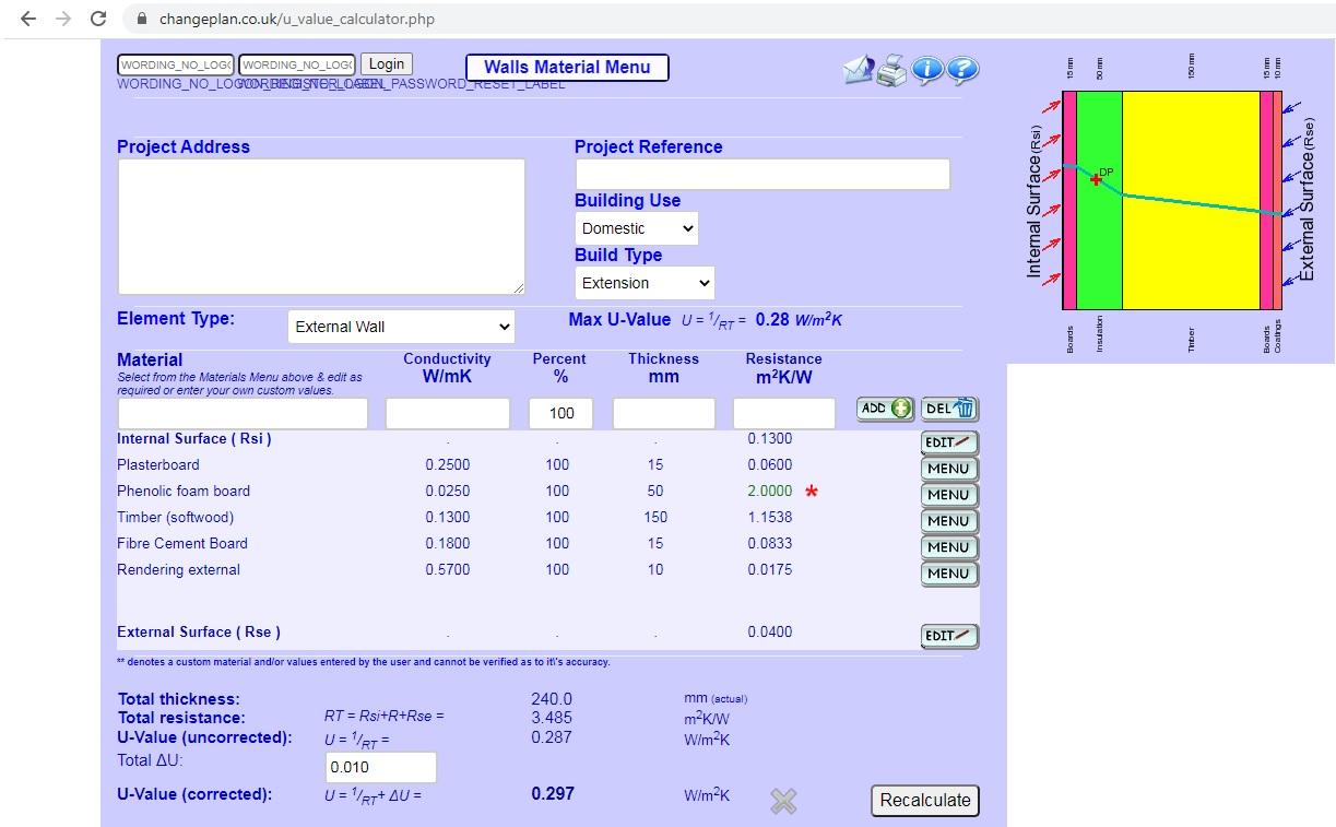

tanneja Posted October 20, 2020 Share Posted October 20, 2020 Not for me, for a friend. Have a first floor extension in timber, 100mm timber frame with 90mm celotex cut and offered into the frame space between noggins. Internal detail planned was just plasterboard, externally cement board, membrane and render. Surely the areas of the wood frame (maybe 10-20% of the wall) will just be 100mm of timber U value equivalent? I've heard them say they will put 20mm of PIR internally, but by my math that gets to around U=0.53 over any wood element. To reach 0.28 for extensions the online calculator tells me 65mm of PIR needed. Whats the sensible approach? Is a room calculation % based given some areas are frame but others the 90mm PIR? Is the tennant better to insist on thicker insulation to have no spots breaching U0.28? I should add I am aware that space in the room is a premium. Thanks in advance for any wisdom. Link to comment Share on other sites More sharing options...

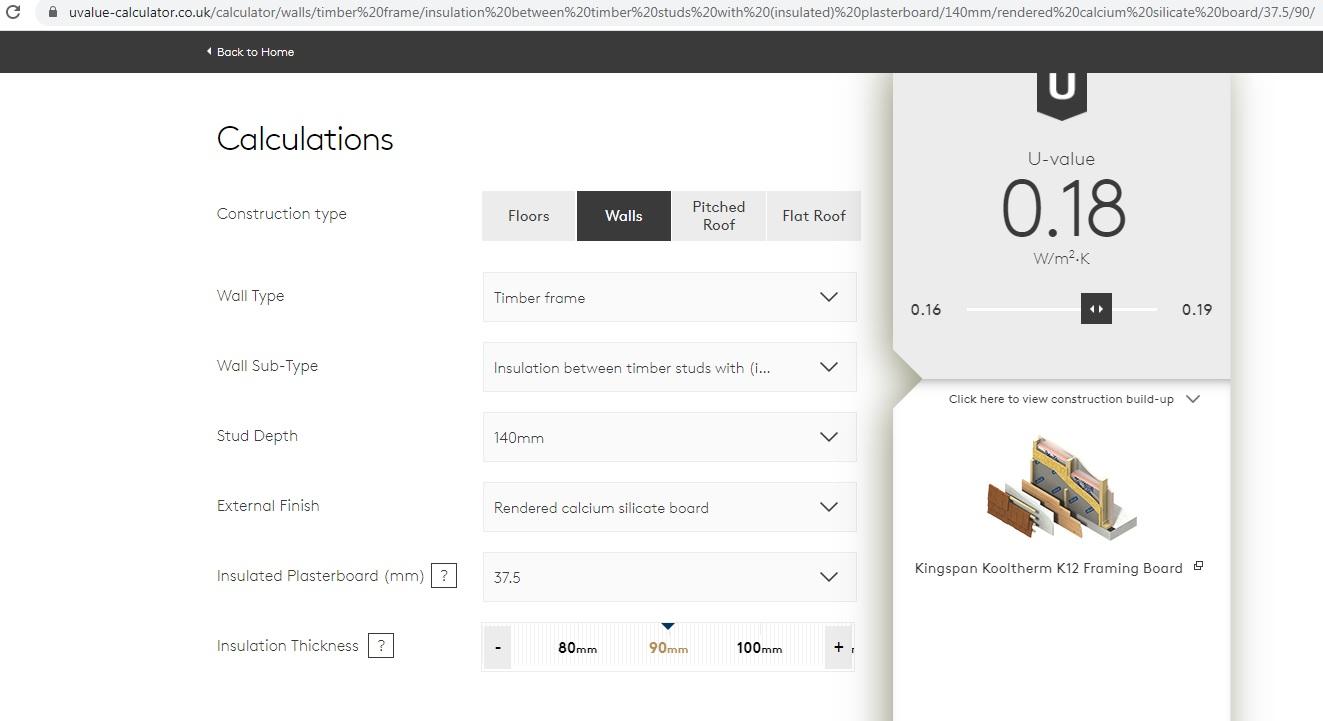

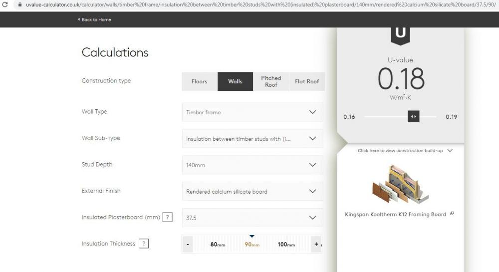

the_r_sole Posted October 21, 2020 Share Posted October 21, 2020 (edited) what calculator are using for those values? Kingspan calc gives a lot better on those thicknesses https://www.uvalue-calculator.co.uk/calculator/walls/timber frame/insulation between timber studs with (insulated) plasterboard/140mm/timber cladding/37.5/80/ Edited October 21, 2020 by the_r_sole 1 Link to comment Share on other sites More sharing options...
tanneja Posted October 21, 2020 Author Share Posted October 21, 2020 @the_r_sole This was my attempt. I am aware that this only applies to the areas where the studs are, those lengths will have localised poorer U value than the areas between them (which are packed with PIR within the studwork voids). Still it feels like that comprises a non-trivial area of the wall (10-20%) so presumably you want to bring that amount of area at least up to the extension Regs min? I may be incorrectly using the U value Calculatiors Link to comment Share on other sites More sharing options...
the_r_sole Posted October 21, 2020 Share Posted October 21, 2020 the kingspan/celotex/any other manufacturers calculations all account for the amount of timber in the wall construction, the uvalues are area weighted, you don't do different calcs for each bit of the wall 1 Link to comment Share on other sites More sharing options...
ADLIan Posted October 21, 2020 Share Posted October 21, 2020 Default is to use 15% bridging of the insulation in timber frame - manufacturers will take this into account in their U-values. 90mm Celotex in the above wall will achieve approx 0.35 W/m2K. adding a further layer of say 25mm internally would drop this to approx 0.24 W/m2K 1 Link to comment Share on other sites More sharing options...

tanneja Posted October 21, 2020 Author Share Posted October 21, 2020 (edited) @ADLIan my apologies, but just to ensure I use these calculators correctly going forward, I see the below for your 90mm celotex and 25mm internally, getting materially different overall U value, can you see what I am managing to mess up? (fyi it says the 37.5mm insulated plaster board is made up of 12.5mm plasterboard and then the remianed (25mm) is PIR)) Edited October 21, 2020 by tanneja Link to comment Share on other sites More sharing options...
A_L Posted October 21, 2020 Share Posted October 21, 2020 2 hours ago, tanneja said: getting materially different overall U value, can you see what I am managing to mess up? here is my version of your wall, U=0.23, if I remove the 15% timber fractions the U value falls to 0.18 1 Link to comment Share on other sites More sharing options...
