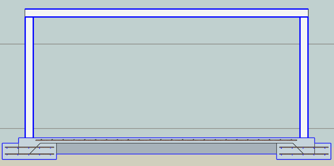

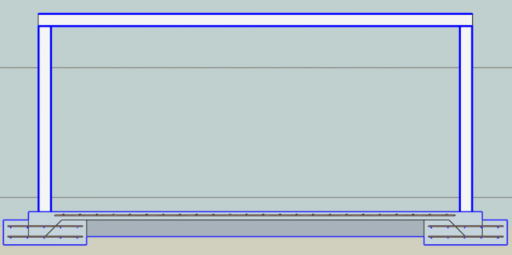

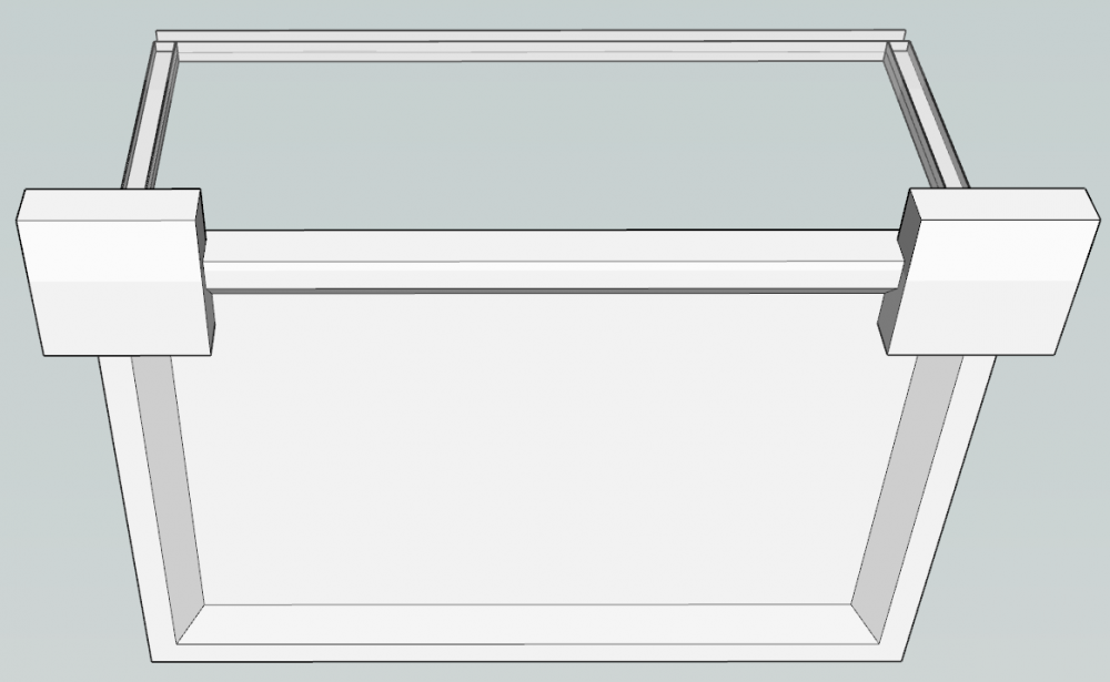

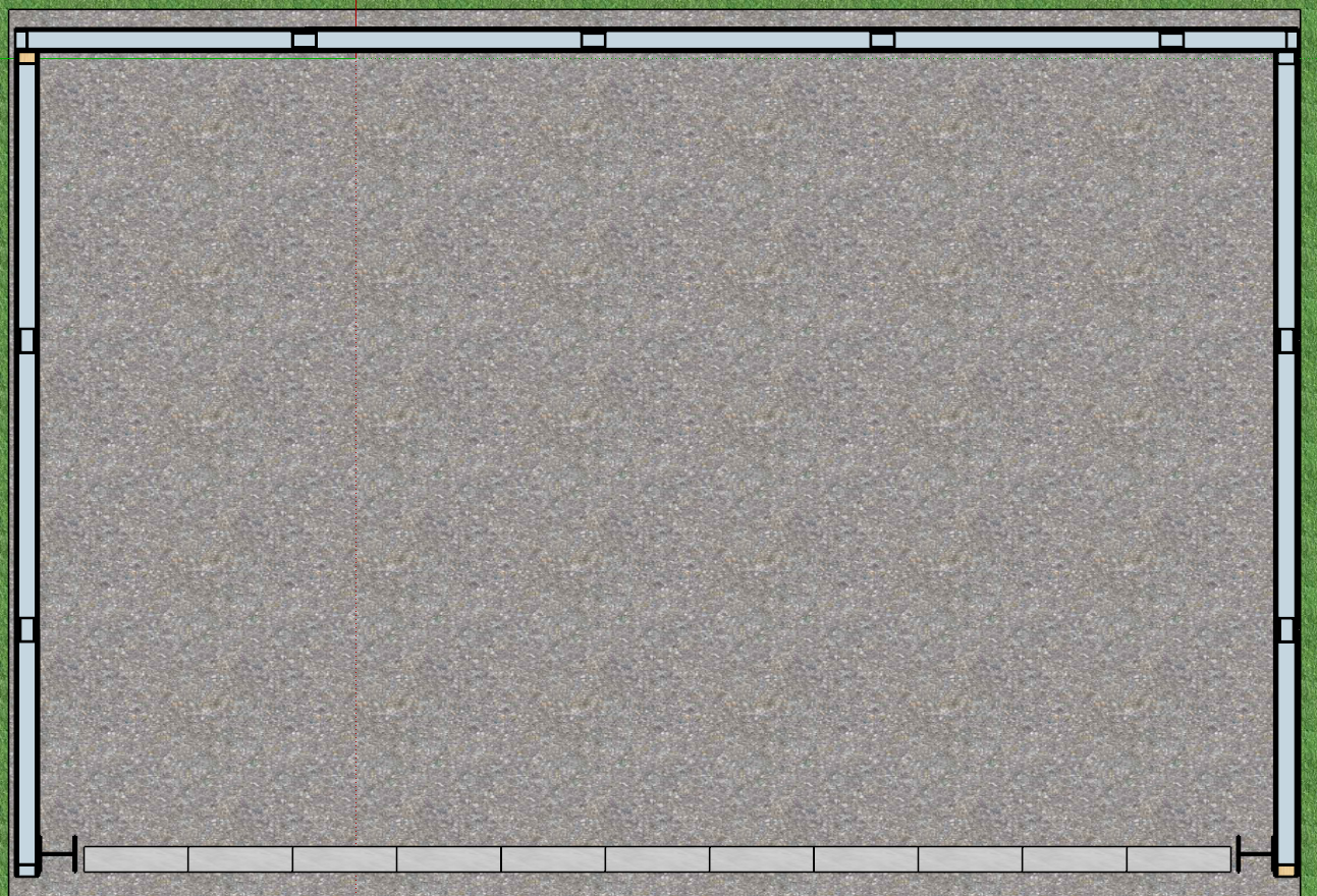

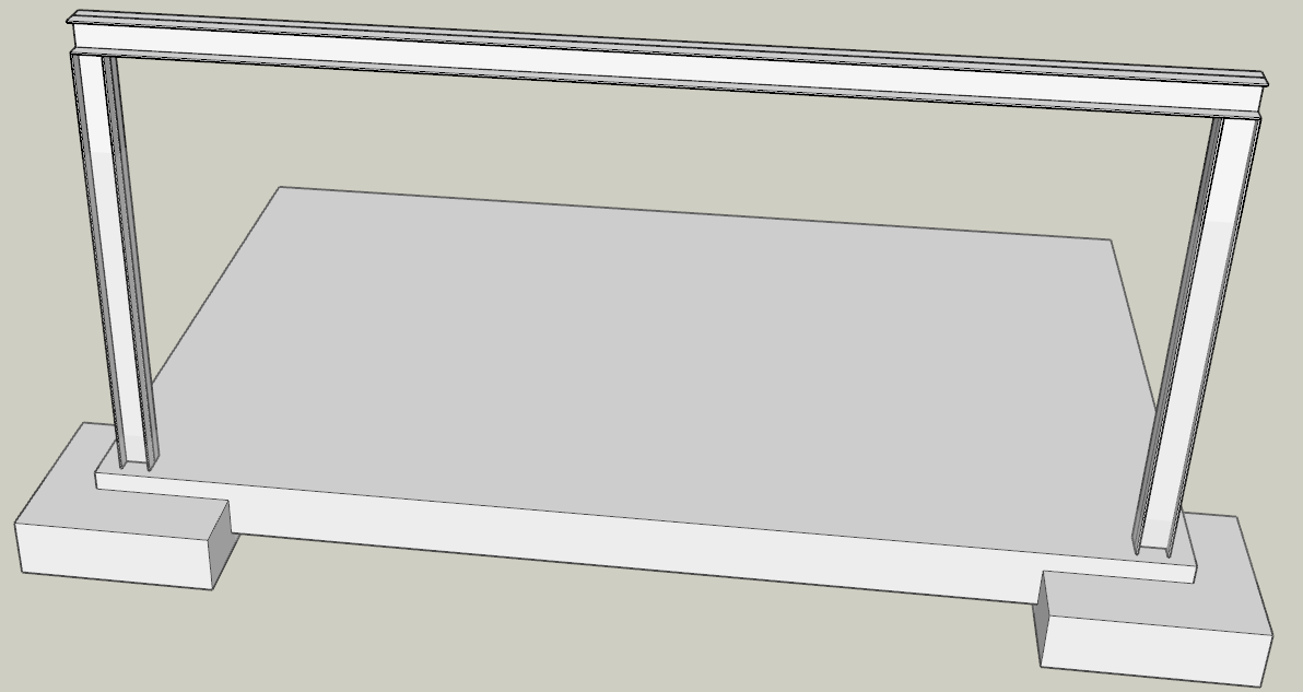

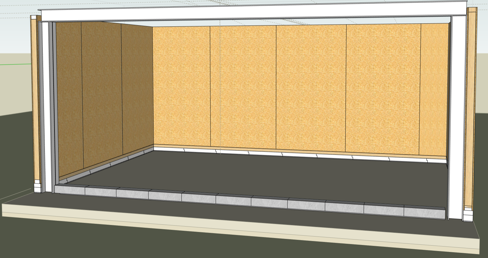

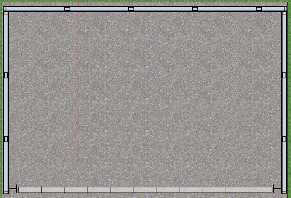

Jamie McNaught Posted October 19, 2020 Share Posted October 19, 2020 This might be the wrong forum, but I think this is more specific to the foundations than the RSJ (but feel free to re-direct this to the RSJ forumn if needs be). We're building a garden office, but given the small size of the garden we want to include a 4.8m bifolds to try and keep as large an open space as possible. Rest is standard marmox+100mm sips+ cedar cladding. We've included a UC 152x152x30 goalpost to support the bifolds / avoid deflection and the rest of the SIP build. Calcs assume: 250kg doors 120kg oak rsk cladding + 50% of 908kg (SIP's, skylight, wood and snow - we're in Camb, but you never know) - the other 50% is assumed to be loaded on the rear wall (we've ignored loading on side walls). This gives a total load of appox 820kg on the beam, causing a deflection in the middle of 3.75mm which we'll compentate for with a timber slightly thiner in the middle to hang the bifolds from (I think - it might be 3.75mm is fine). So...... with 820kg load + 282kg goalposts can we put this onto a standard raft slab of 100mm conrete in centre and 300mm concrete at sides? Do we need to thicken this up / re-enforce at the goalpost feet, or is the weight really too trivial? Sketchup below - yes, I'm aware the feet are missing from the goalpost. Link to comment Share on other sites More sharing options...
Mr Punter Posted October 19, 2020 Share Posted October 19, 2020 I think you will need some reinforcing under the column bases. It depends on the soil type. If they were just pads they may need to be 1000 x 1000 x 300 with 2 layers of A393. With your slab you could just place this locally as long as the thicker bit is fairly wide. You need proper base plates on the columns and grout under. Link to comment Share on other sites More sharing options...
Jamie McNaught Posted October 19, 2020 Author Share Posted October 19, 2020 Thanks Mr Punter - afraid I don't know the soil type - I shall ask our builder who will lay the foundations. Is there an easy way to tell soil types? (Googling is not helping thus far). If I understand you correctly (soil type dependant), if the slab was thickened to 300mm with 2 layers of A393 mesh for areas of 1000mm x 1000mm with the RSJ base plates in the centre, then this would be sufficient? And yes, base plates will be added to the drawing (and the steelwork!). Link to comment Share on other sites More sharing options...
Mr Punter Posted October 19, 2020 Share Posted October 19, 2020 I am no engineer and I am just going by other jobs I have seen. Your slab as proposed may be fine but half a tonne would be quite a point load. Because this looks quite expensive it is probably worth getting some calcs from a structural engineer. Sometimes they can save you money by simplifying. Is this structure outside of the scope for Building Control? Link to comment Share on other sites More sharing options...
Jamie McNaught Posted October 19, 2020 Author Share Posted October 19, 2020 21 minutes ago, Mr Punter said: I am no engineer and I am just going by other jobs I have seen. Your slab as proposed may be fine but half a tonne would be quite a point load. Yes, I appreciate all of this is "best guess".... yours will be a lot better than mine! 28 minutes ago, Mr Punter said: Because this looks quite expensive it is probably worth getting some calcs from a structural engineer. Sometimes they can save you money by simplifying. We're almost at the point where we could hand this to a structural engineer (i.e. we know the building weight, loads etc), but budget is very tight now - I'm trying to get this in below £10k (which I know I am going to miss, but hopefully not by much) with me doing most of the graft once we're out the ground. If anyone knows a SE who can provide rought calcs and isn't wanting to get super detailed I'd be grateful... I suspect (and I could be very wrong) that given the small weights and size, over specing the foundations etc is probably going to be cheaper than an SE doing super detailed calcs to try and save costs. 27 minutes ago, Mr Punter said: Is this structure outside of the scope for Building Control? It should be Permitted Development - height will be 2.4999m (when the roof light is retracted) ? Link to comment Share on other sites More sharing options...
PeterW Posted October 19, 2020 Share Posted October 19, 2020 3 hours ago, Jamie McNaught said: Thanks Mr Punter - afraid I don't know the soil type - I shall ask our builder who will lay the foundations. Is there an easy way to tell soil types? (Googling is not helping thus far). If I understand you correctly (soil type dependant), if the slab was thickened to 300mm with 2 layers of A393 mesh for areas of 1000mm x 1000mm with the RSJ base plates in the centre, then this would be sufficient? And yes, base plates will be added to the drawing (and the steelwork!). Soil type ..?? Dig down about 18” and get a handful of the soil from the bottom and look at it .. then squeeze it in your hand, the more it stays together the more clay it has. Then drop it onto a concrete slab from about 3ft up. If it deforms into a flat blob then chances are you are on clay that is shrinkable so you’ll need a decent edge foundation all round with good sized pads at the front. The more sandy it is, the better with depth and mass. I would I be chucking a couple of sheets of mesh into the whole slab and make it all structural. Link to comment Share on other sites More sharing options...
Jamie McNaught Posted October 19, 2020 Author Share Posted October 19, 2020 31 minutes ago, PeterW said: Soil type ..?? Dig down about 18” and get a handful of the soil from the bottom and look at it .. then squeeze it in your hand, the more it stays together the more clay it has. Then drop it onto a concrete slab from about 3ft up. If it deforms into a flat blob then chances are you are on clay that is shrinkable so you’ll need a decent edge foundation all round with good sized pads at the front. The more sandy it is, the better with depth and mass. Thanks, soil descriptions are helpful. I'm assuming if it hits the ground and crumbles (rather than remaining as a flat blob) then it's more sandy than clay? By edge foundation do you mean strip foundation or do you mean thick edge on the raft? I thought raft / slabs were ideal when on clay and strip foundations were going to get prohibitively expensive? (Appologies, to this point I've ignored foundations and got on with the design of the stuff above ground). 31 minutes ago, PeterW said: I would I be chucking a couple of sheets of mesh into the whole slab and make it all structural. Yes, looking at the cost of A393 this doesn't seem like a huge cost. Would including this below the RSJ's have the affect of reducing sheering issues with the load fron the RSJ's on the slab? I'll try to knock up a more detailed slab drawing - builder wants to show this to an SE now. Link to comment Share on other sites More sharing options...

Jamie McNaught Posted October 20, 2020 Author Share Posted October 20, 2020 17 hours ago, PeterW said: I would I be chucking a couple of sheets of mesh into the whole slab and make it all structural. 23 hours ago, Mr Punter said: I think you will need some reinforcing under the column bases. It depends on the soil type. If they were just pads they may need to be 1000 x 1000 x 300 with 2 layers of A393. With your slab you could just place this locally as long as the thicker bit is fairly wide. You need proper base plates on the columns and grout under. Something like this? 100mm slab (inc 1x A393) 300mm at edge 1000x1000x300mm pads to support RSJ (inc 2x A393) all cast in a single pour hopefully? Link to comment Share on other sites More sharing options...
Mr Punter Posted October 20, 2020 Share Posted October 20, 2020 Would it be easier to do the pads with a concrete mixer, chock up and bolt down the base plates so your goal post is nice and level, then pour the rest with readymix? Don't want to be messing with heavy bits of steel and finishing concrete on the same day. Link to comment Share on other sites More sharing options...
Jamie McNaught Posted October 20, 2020 Author Share Posted October 20, 2020 15 minutes ago, Mr Punter said: Would it be easier to do the pads with a concrete mixer, chock up and bolt down the base plates so your goal post is nice and level, then pour the rest with readymix? Don't want to be messing with heavy bits of steel and finishing concrete on the same day. I might be adding confusion as the feet are not acutally in that diagram - they're not 'under concrete'. See below. I'm imagining shuttering it, including the 100m slab and pouring in one to ensure it forms a single slab with no weak joins. Hopefully, the lower pads wont overflow due to weight of concrete pushing down from the 100mm slab (like this Could the bolts for RSJ's be put in while concrete is wet using some form of template to ensure they all line up for when actually attaching the pillars when contrete is dry? Or would you drill and stick them in with resin afterwards? Link to comment Share on other sites More sharing options...

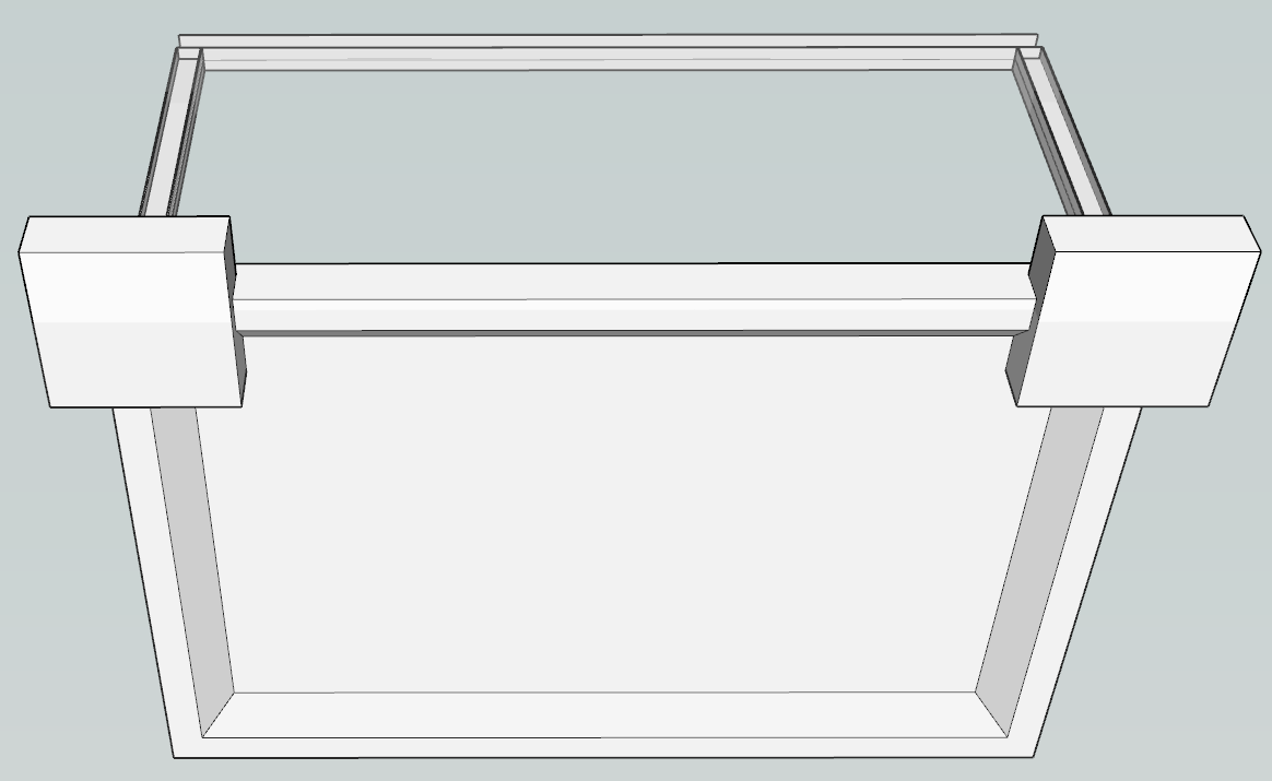

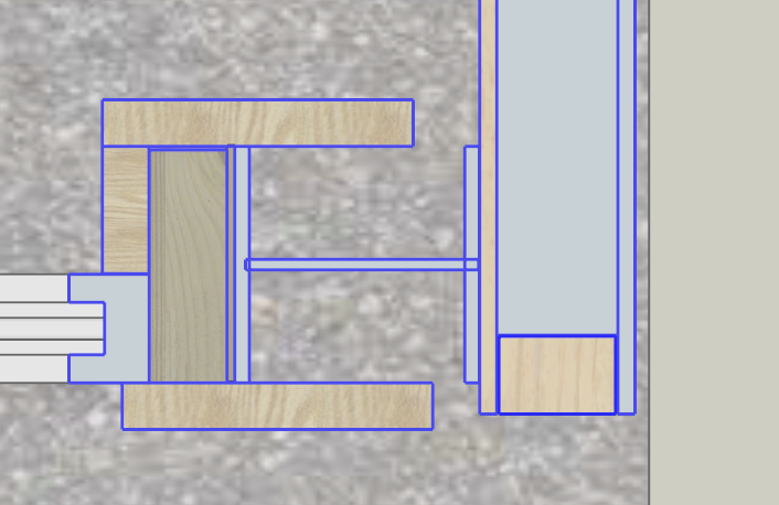

Jamie McNaught Posted October 20, 2020 Author Share Posted October 20, 2020 (edited) 31 minutes ago, Russell griffiths said: Any reason your posts are uc I would use a 90x90 box section as I believe it will be easier to insulate around and clad over. I've been using this, so choices are a bit limited. If you can point to another tool or resource that'd be good - I know little about OC / UB / box sections. https://shop.mrbeam.co.uk/ work in progress pillar cladding plan below - pine 2x6 spacer to bifold frame + oak cladding. There will probably be another pine strip to hold the inner oak in place (which will be longer). The outer oak pannel will be secured to the battons for the cedar cladding (with Tyvek house wrap behind it. The rest of the ibeam volume would be filled with PIR/celotex. Pretty much same detail for cross beam. Edited October 20, 2020 by Jamie McNaught 1 Link to comment Share on other sites More sharing options...

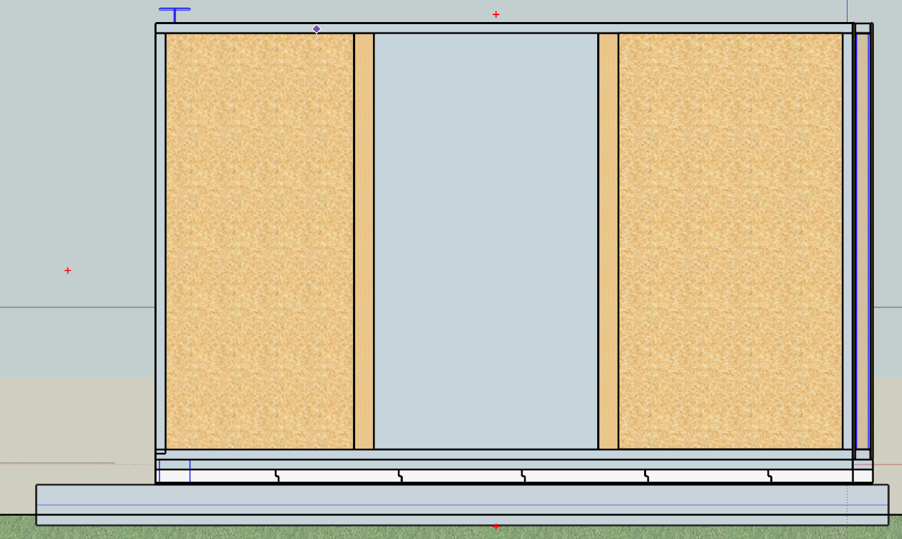

Gus Potter Posted October 21, 2020 Share Posted October 21, 2020 Hi Jamie. I would go back to basics before you open the wallet/ purse / gourd or raid the money tree in the garden. You have three walls and a roof with no openings. You do have quite a "stiff box" to work with. Most walls and roofs are pretty stiff. Think about them as deep beams, the roof, if it is detailed well it acts like a deep beam and thus able to transfer load down to the foundations quite adequately via the walls. If you have bottom supported bifolds, then yes they are heavy but when you work out the horizontal loads that appear at the head of the doors (when they are open) you may often find that they are no more onerours than the loads that occur when the doors are shut and the wind is sucking them outwards. It's just my view but bottom supported bifolds are more common now. Logically it's ok to float one part of a structure and connect it to another. You just need to design for the differential movement. Ask this. Say you have an 18 th centuary house, you add an extension, both will move differentially relative to the seasons, temperature and so on. Both the old house and the new extension often still float on the ground (unless maybe on similar rock), just they move up and down differently. All materials are elastic and some can also expand/ contract differently if the are sensetive to moisture. Before you go down the "steel route" and the associated foundations, deal with the cold bridging etc then it may be worth while going back to basics and avoiding all the extra interfaces and assosciated labour cost. This way you may be able to bring it all in budget and still have a competant structure / safe design that will still allow you to connect the house to it later. In summary you may get this within budget if you go for bottom hung doors, do away with all the steel, base plates and thickened founds and approach the design in a different way. 1 Link to comment Share on other sites More sharing options...
Jamie McNaught Posted October 22, 2020 Author Share Posted October 22, 2020 (edited) 16 hours ago, Gus Potter said: In summary you may get this within budget if you go for bottom hung doors, do away with all the steel, base plates and thickened founds and approach the design in a different way. Thanks for the reply Gus, I really appreciate it - please bear with me on this.... I'm really keen for your input on an alternative to RSJ's. Contrary to my earlier comment, I do agree with you that the door frame, attached to the roof will not pull/deflect outwards at the top - the roof when assembled is strong enough absorb this. The issue I think we currently have is that we somehow need to span the roof either left to right (using the side sip walls) or front to back (using the rear SIP wall and RSJ or an alternative) (the original plan). I'm aware the side walls (in a front to back span) will transfer roof weight to the ground - calcs I've done for RSJ don't take this into account as that's complex to do and I was aiming for a 'worst case' scenario. Options: span left to right - the span is 5.2 -> 5.4 (building width) to support the roof. SuperSIPs (http://www.supersips.uk.com/index_htm_files/span table.jpg) insist on 2x5 (x1), 2x6 (x2) & 2x5 (x1) for 4.8m, without a roof light. With a roof light + 5.4m span we don't have details - trying to get this. We could use glulam as a replacement for (or addition to) the 2x6, but as the standard height for glulam is 225mm v's 150mm SIP thickeness means we lose the flat ceiling. We'd need a minimum of 3 spans of this with 1.2m sips inbetween. 3 Gluman 90x225x6m is £465 (https://www.bucklandtimber.co.uk/glulam-beam-cost-calculator/). This seems expensive and results in a ceiling with two joists - we are tight on ceiling height. And I've no idea if it works! span front to back - this needs something for the beams&sips to rest on at the front. Original plan was the RSJ. I'm not sure what the alternative is. Possibly Glulam again, but we're back into worries about downwards deflection affecting the operation of the bifolds - I know we can get a gluman that can handle this but no idea of specs - I'm working on calcs. Additionally, the glulam will need support at each side - the SIPS are not strong enough for this point load at the front - so probably kiln dried 2x6's or some other post. This then gives us the goalpost config we had before with the roof load transfering down in the same way as the RSJ, albeit the glulam is lighter than RSJ (half?). At which point we're back to looking at pads to transfer the weight - albeit not as much. Steel goalpost RSJ is £570 and I know it will work / not deflect. Yes, it technically needs larger foundations, but the load at the feet would not be much more than Glumam. If we try to span left to right, we have a huge span that I don't know how to handle. So, am I missing some alternative solution? Am I too worried about the span left to right? (will get back with options for spanning 5.4m in SIPs as soon as manufacturer gets back to me). Edited October 22, 2020 by Jamie McNaught Fixed sentence. Link to comment Share on other sites More sharing options...
Jamie McNaught Posted October 23, 2020 Author Share Posted October 23, 2020 SIP manufacturer has suggested a flitch beam - this should provide much of the strength of the RSJ without the cold bridging / cost and can be hung from the sips. Any thoughts? Link to comment Share on other sites More sharing options...
Mr Punter Posted October 23, 2020 Share Posted October 23, 2020 I would try to span the roof between your panels rather than on a beam. Could you then get rid of the goalposts and extra footings? Flitch beam is a good plan to span the top of the opening. Link to comment Share on other sites More sharing options...
