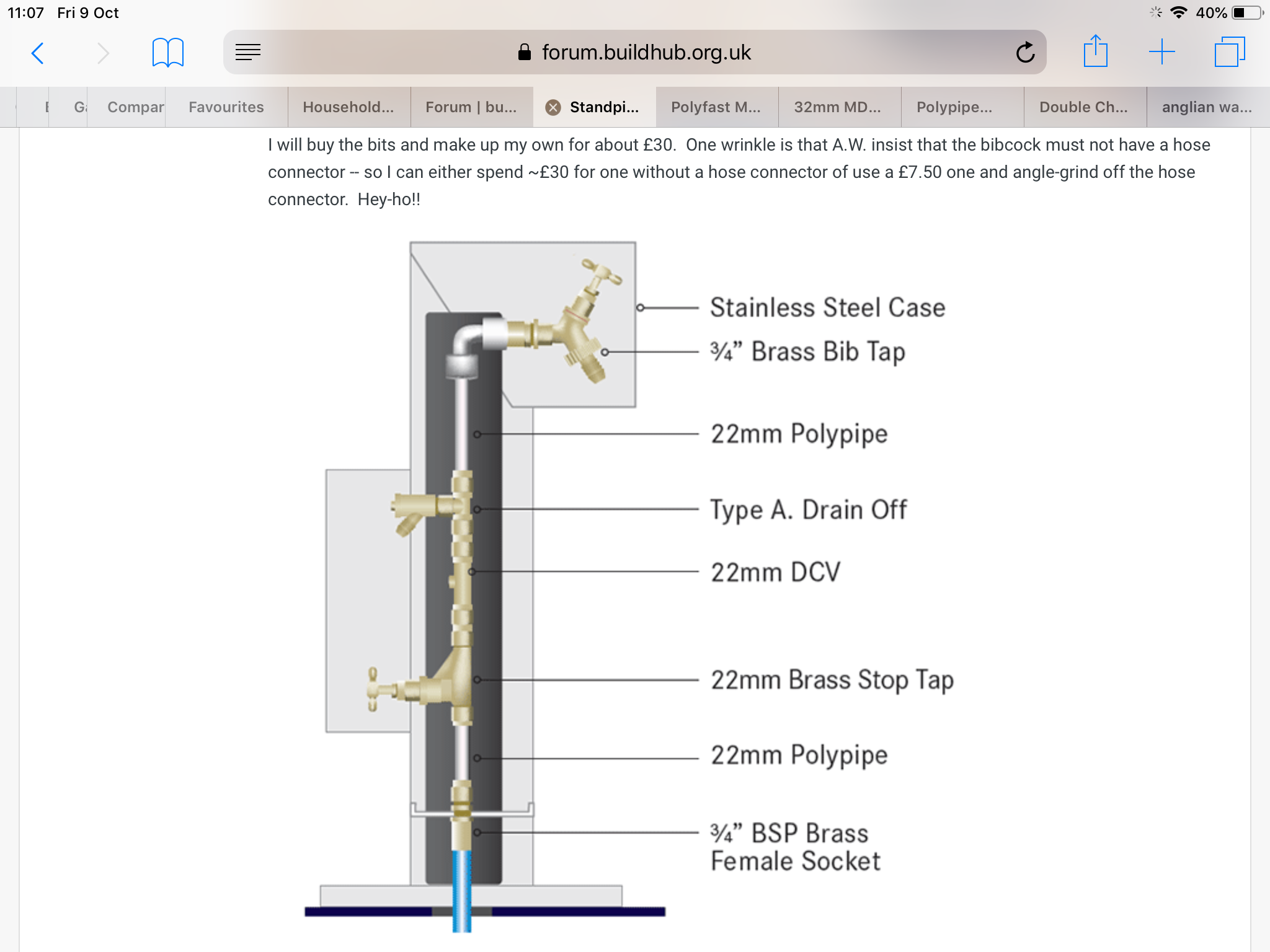

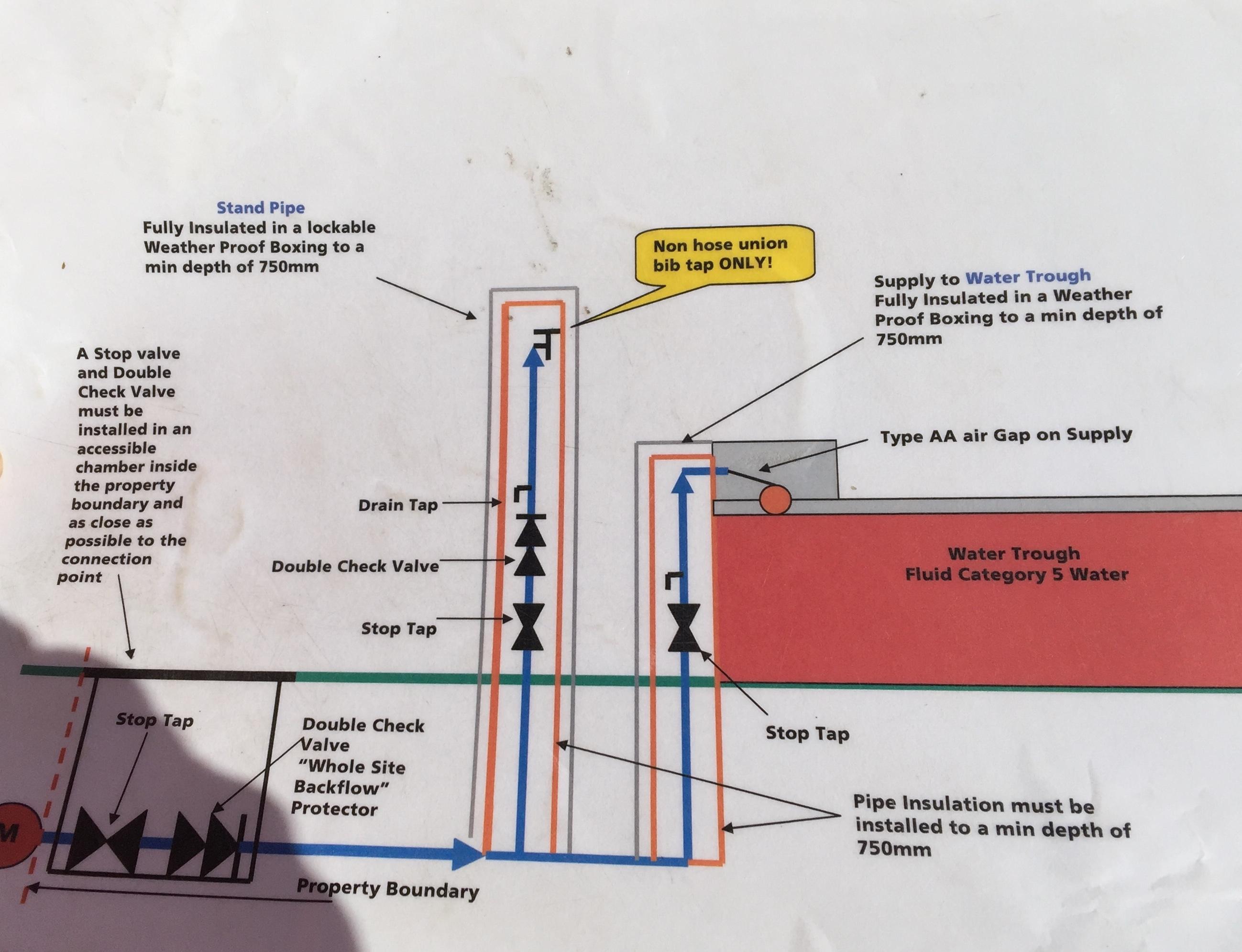

James94 Posted October 9, 2020 Posted October 9, 2020 Hi all Just looking for some advice on a new temporary water supply we’re having connected, looked around the forum and there are a few Bits from 2016 so not sure if regs have changed much. We are having a tap as close to the boundary as possible so as little digging as possible.Anglian water are going to dig up the road connect a water meter at the property boundary and we have to do the rest. Here are a few pics thar I’ve found are we looking for the same thing? Does anyone have any pics to share and maybe some tips on making box and where to get materials. Looked into this and think this will be best option as we don’t have to organise all the services together we will be able to lay water without any further inspection. Regards. James

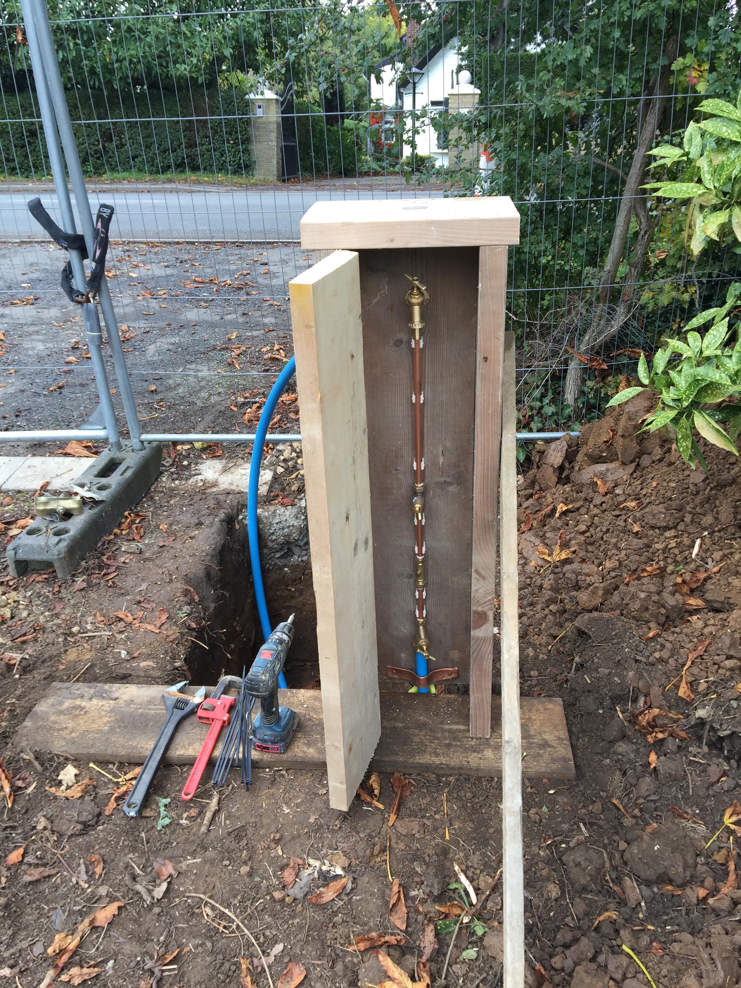

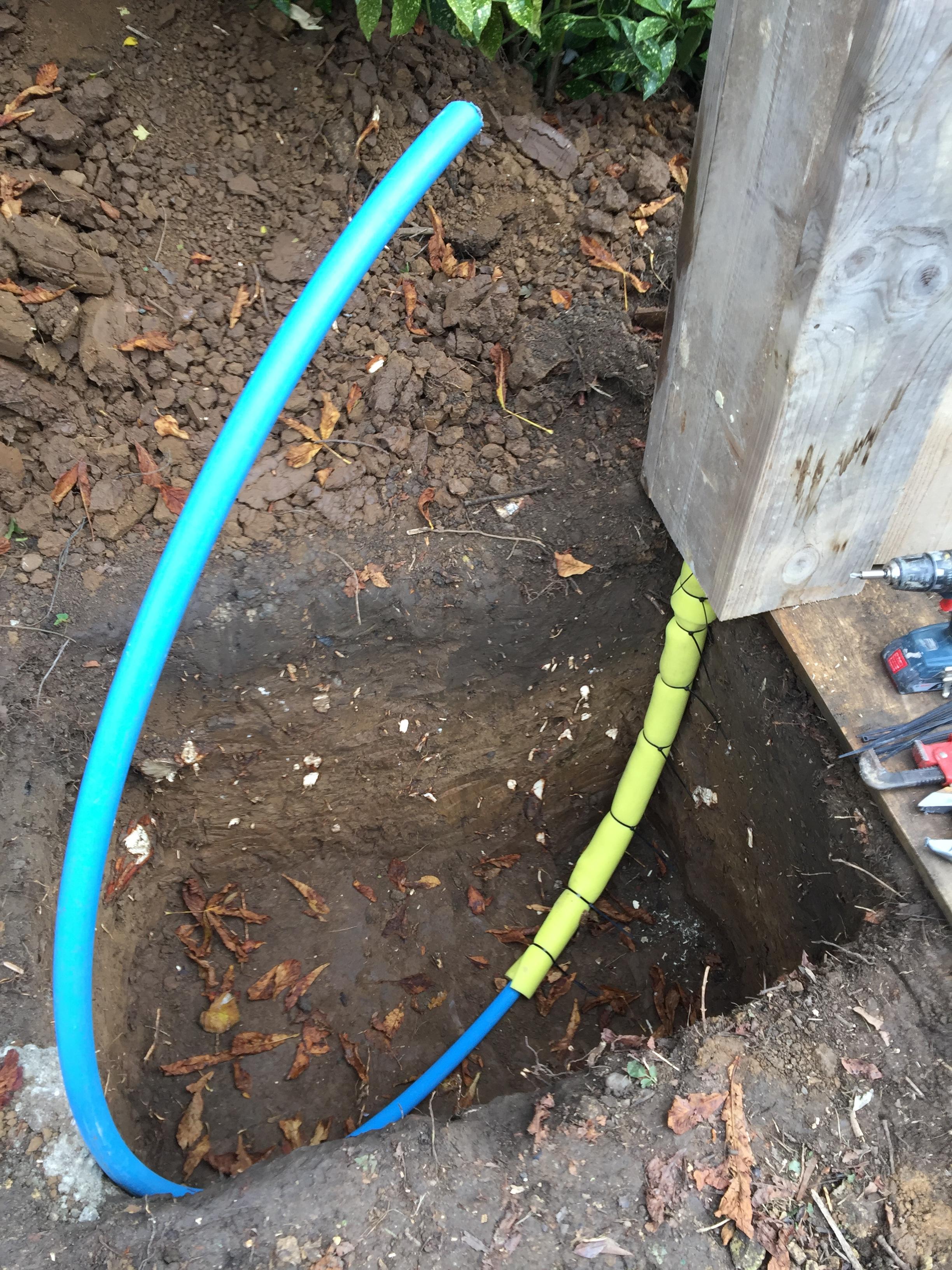

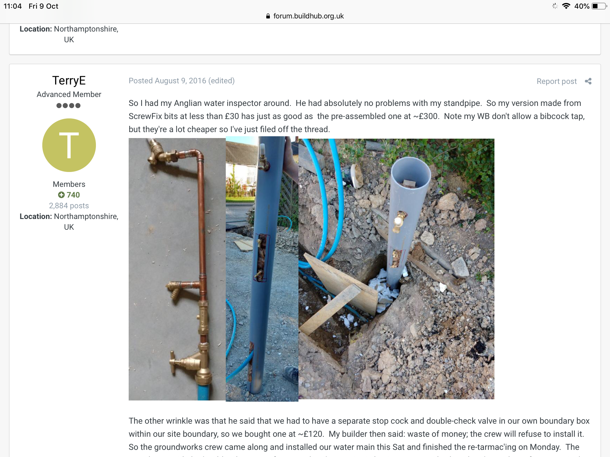

James94 Posted October 13, 2020 Author Posted October 13, 2020 Just an update, copied what TerryE has done but have had to put it in a lockable box with insulation. Still not sure about the stop valve and the double check valve in a chamber, just have to wait to see what he says at inspection. 1 1

Randomusername Posted October 23, 2020 Posted October 23, 2020 (edited) @James94 - can you tell me where the specification diagram in the first post in this thread came from please? Anglian Water have supplied me with a much less onerous spec for my standpipe! I’ll see if I can attach it here. 2020-10-16_02-32-57%7eTemporary_Building_Supplies.pdf Edited October 23, 2020 by Randomusername
James94 Posted October 25, 2020 Author Posted October 25, 2020 This was a photo which i took from a sheet he brought out his van, looks like your drawing is out of date. Regards. James
Randomusername Posted October 28, 2020 Posted October 28, 2020 On 25/10/2020 at 20:41, James94 said: This was a photo which i took from a sheet he brought out his van, looks like your drawing is out of date. Regards. James It was supplied to me very recently.
Randomusername Posted October 28, 2020 Posted October 28, 2020 (edited) 26 minutes ago, James94 said: It’s from 2010? They sent it to me via Inflow last week. Very odd Have you had the inspection done yet? Edited October 28, 2020 by Randomusername
James94 Posted October 29, 2020 Author Posted October 29, 2020 Yeah he came round yesterday to inspect it and said it was all ok, there is no need for the double check valve and stop tap that is shown in the diagram above. They just connect to the end of our pipe, he said something about a small chamber to gain access to the connection valve at a later date when we switch over from temporary supply or we could just bury it our choice. regards. James was looking at the date on your picture says 2010 but maybe that was just the design date. 1

Randomusername Posted November 17, 2020 Posted November 17, 2020 So if you trim a fair bit off along the split, it’s possible to get 28mm x 13mm thickness pipe insulation into a 63mm duct, and just about leave space for a 25mm MDPE water pipe. Tight though!
