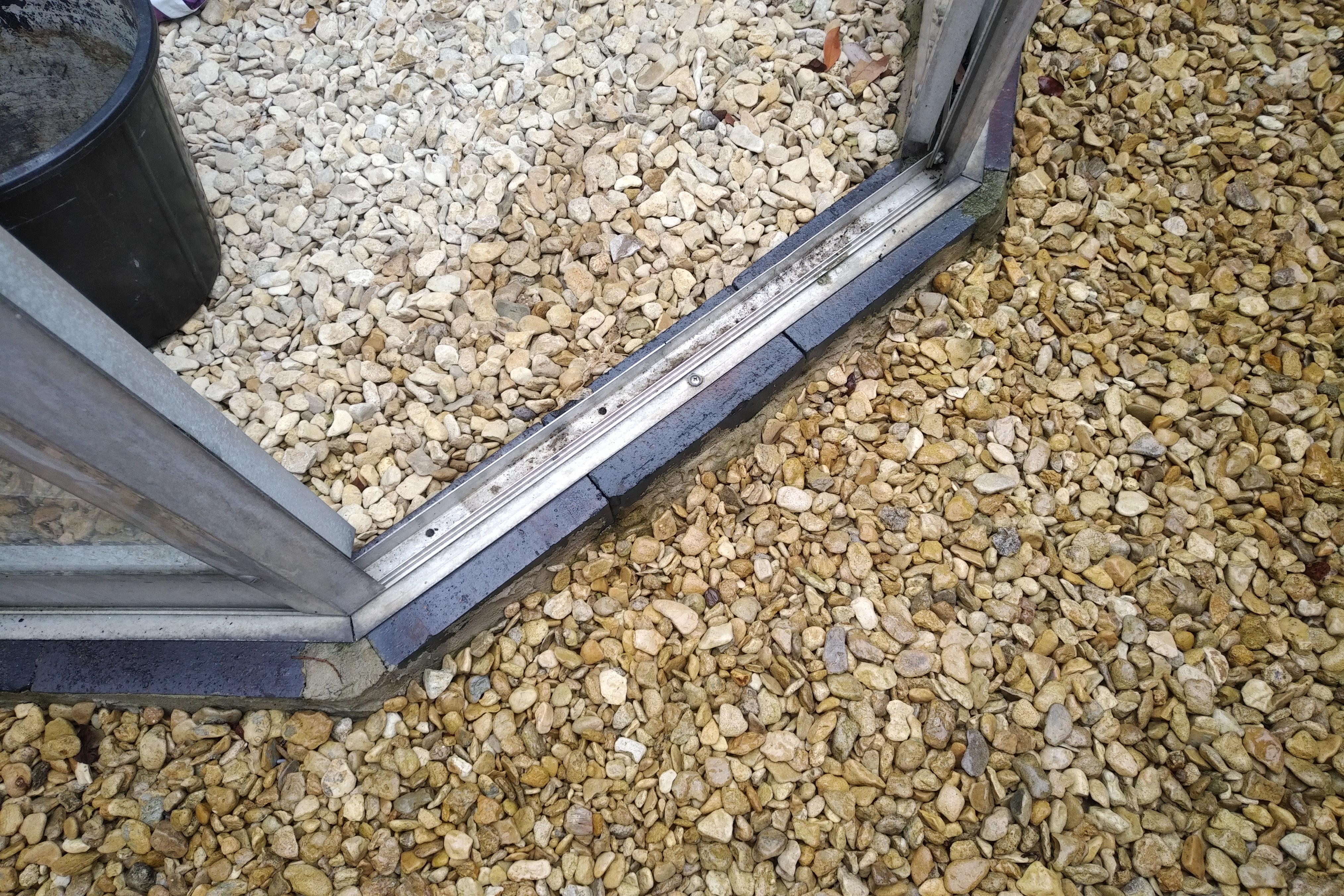

Our greenhouse is 9-sided. I cast a concrete ring-beam roughly to size/shape and then laid engineering bricks to the actual shape. Frame is then screwed into rawplugged holes in the bricks as per pic.

I did one recently and cast a ring beam with wire in it and bolted to that, worked great.
I think the concrete ring beam is the way forward; what size do you reckon?  Will 20cm x 20cm do it?  Straight on to soil?  Any reinforcement required?

20x20 will be around half a cube of concrete so it won’t be going anywhere ..! Blocks set in a dry haunched mix may be better and quicker.
