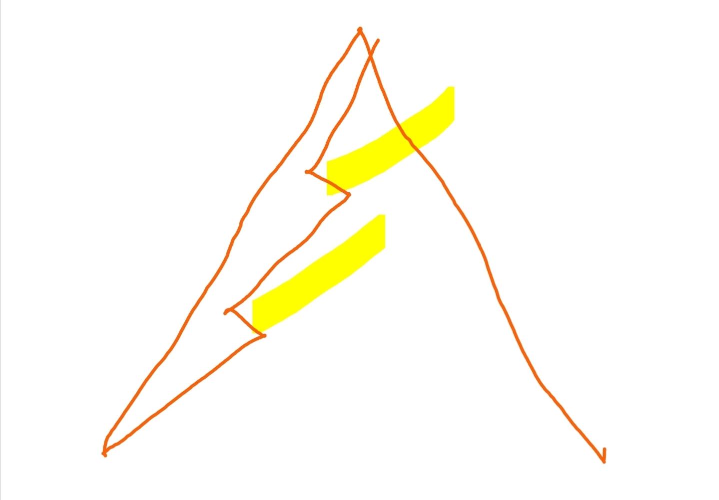

Posted
Following with interest. I have a very good idea for adding led strips in steps pointing up the way in the vault in mine.
I have attached the sketch I made in my onenote...when the idea occurred to me..late at night after drinking excessive  amounts of wine.
Thata a vaulted roof. One side showing the steps which would be hidden from view below but light up the roof further uo. Done with plaster in profile's.  I'll make a proper drawing in autocad soon.
Similar idea to temps middle pic above.
