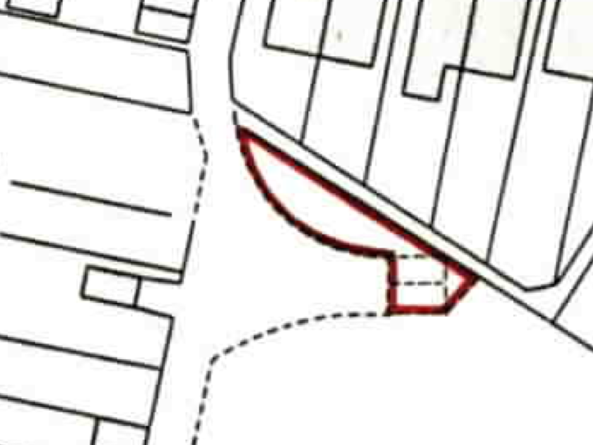

Rich Pen Posted October 1, 2020 Share Posted October 1, 2020 Twenty years ago the previous owner of my plot had planning permission refused twice.( Which Im my opinion was a rediculous design and had zero chance of being approved). There still are the same two neighbors who have back gardens butting up to the site in question who very strongly objected to those applications. My application on the same plot has just been submitted and I may get lucky. One elevation of my new build finishes very close to those same neighbours 1.8 meters high close boarded fence boundary and there is going to be very very strong opposition to my application.There are no structures or foundations within 10 meters of the boundary and fence. if planning is granted I then have to ask the same very angry people for permission to build and probably a party fence wall agreement. What sort of journey can I expect to have to travel to be able to proceed. Any idea of what it could cost me and how long it could take. Advice would be appreciated. Cheers. Link to comment Share on other sites More sharing options...

Rich Pen Posted October 1, 2020 Author Share Posted October 1, 2020 Thank you.The unusuall situation is that those neighbours have encroached by about 1.3 meters over a twitten / footpath up to my boundary.The footpath as far as I am aware was not a public right of way but a official footpath that ran along the back of a few rows of houses around here. If they had not encroached my build would be very much easier plus they objected to the historic application on the grounds that the project would abutt there property. In my view they brought the close proximity of my elevation upon themselves. Any thoughts. Link to comment Share on other sites More sharing options...
Ferdinand Posted October 1, 2020 Share Posted October 1, 2020 Aha - the one with the services going through the eye of a needle. ? Had not twigged to your other question. F Link to comment Share on other sites More sharing options...
Temp Posted October 1, 2020 Share Posted October 1, 2020 13 minutes ago, Rich Pen said: they objected to the historic application on the grounds that the project would abutt there property. If they try that this time I would download their title plans from the land registry web site (<£10 I think) and look on google earth etc to find evidence of the encroachment. Then send the planners a reply to the their objection. Its quite likely they have never formally filed for adverse possession so they don't officially own it yet. 1 Link to comment Share on other sites More sharing options...
Rich Pen Posted October 1, 2020 Author Share Posted October 1, 2020 Could be useful.I do have a screen shot from GOogle Earth showing the footpath still open. I know the people in question to say hello to.My architect says maybe I should just let them know that my application has been submitted.Or shall I keep schtum. Thanks very much all. Link to comment Share on other sites More sharing options...
Rich Pen Posted October 1, 2020 Author Share Posted October 1, 2020 Don't blame you if your glazing over now.My title plan clearly shows the twitten north of my plot. Link to comment Share on other sites More sharing options...
