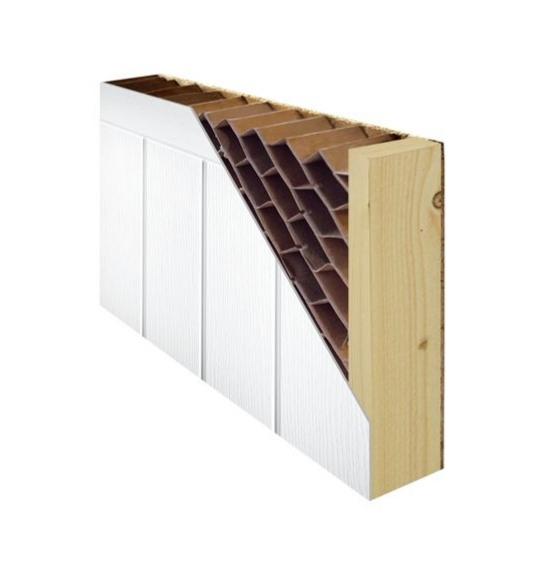

Onoff Posted September 24, 2020 Posted September 24, 2020 In the case of cheap, paper honeycomb doors, the face material is often MDF just a few mm thick. Internal construction is something like this: Wanting to put some decent coat hooks in, without them pulling out (or compressing the door) I'm trying figure a way of strengthening this area: Half a thought to Starrett a round hole all the way through and glue in a round of softwood the same thickness as the door. Any ideas? There's always those hook over coat racks I suppose.

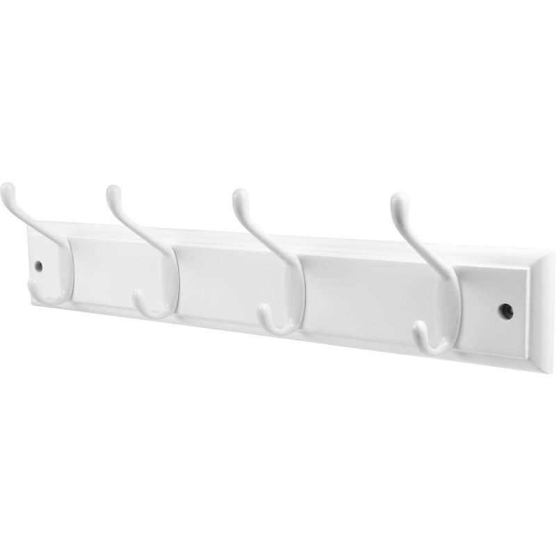

daiking Posted September 24, 2020 Posted September 24, 2020 Back of bathroom door with a couple of bathrobes on it. No prizes for style but 4 years and solid. Geometry of the hook doesn’t do funky things to the door. Think I used an advanced plug in there (Rawl4All ?), probably a squirt of grab adhesive in the hole and then plenty on the back of the hook to stick to the door when screwed on. FWIW, it was the brown grab stuff not the white everbuild instant nails stuff I normally use.
Ferdinand Posted September 24, 2020 Posted September 24, 2020 (edited) Can you glue a piece of wood on, and screw into that? Or get one of the Wilko coathook blocks (about £10) and glue that on? I have about 5 of those, and it still is not enough ?. Ferdinand Edited September 24, 2020 by Ferdinand

Onoff Posted September 24, 2020 Author Posted September 24, 2020 26 minutes ago, PeterW said: CNC a slot into the top of the door, 27.49mm by 43.16mm, then insert a long piece of timber 377.45mm long with a 0.75 degree chamfer on all sides ... Then screw the fixing into the timber behind the facing .... You joke but I was seriously considering routing out that thin piece of timber they edge the top of the door with and dropping in a block of timber.
