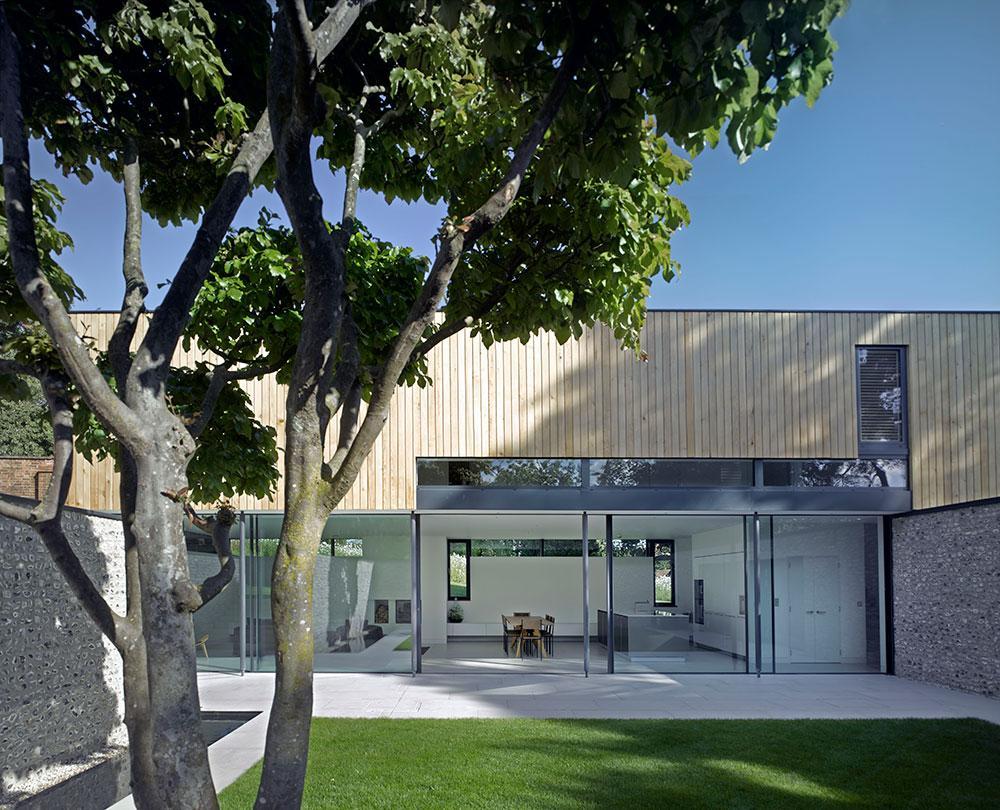

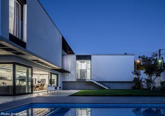

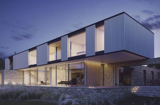

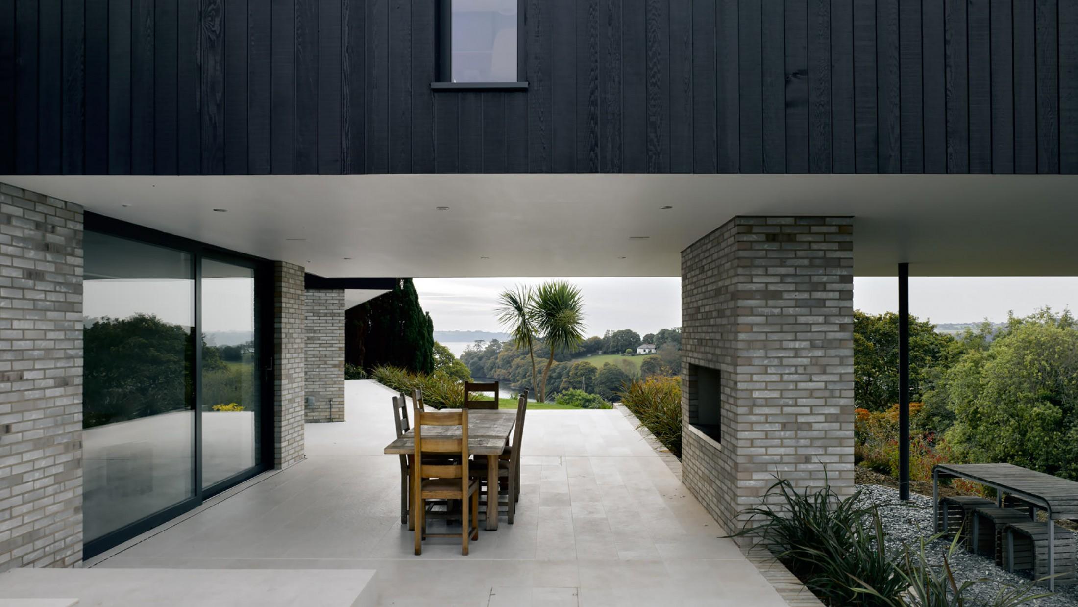

This definitely sounds like a viable option to explore. In fact one of my favourite architect companies says on their website:
"The majority of our projects are on sites where we are demolishing an existing house. In many ways, this makes life easier, as the principle of development is already established."
Our dream is to build a modern / contemporary style home of approx. 300 sqm. (to help illustrate the style of house we have in mind i'll add a few images to the post).
Question being, if we are hoping to build something like this (and i appreciate it's not to everyone's taste) does it have a bearing on what style and size of 'dilapidated' house we look for? Meaning does the house we demolish need to be of a similar style and size to begin with? In other words, how do we make an informed decision on a house purchase without knowing if we'll be able to build what we hoped for after buying it?
My fear would be that we sell our current house, buy the dilapidated house and live in it for a few years, then start the design and planning process only to have our plans fail to get permission leaving us stuck with an old house we need to sell so we can move on and start the process all over again.
Is this a likely scenario and if so, how do we avoid it?

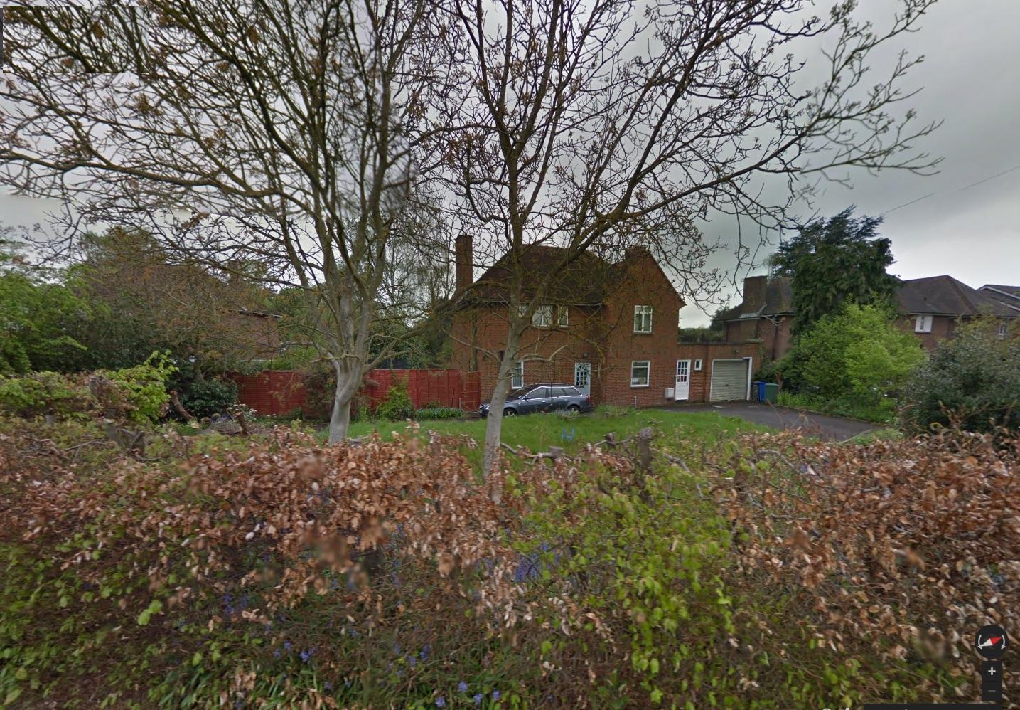

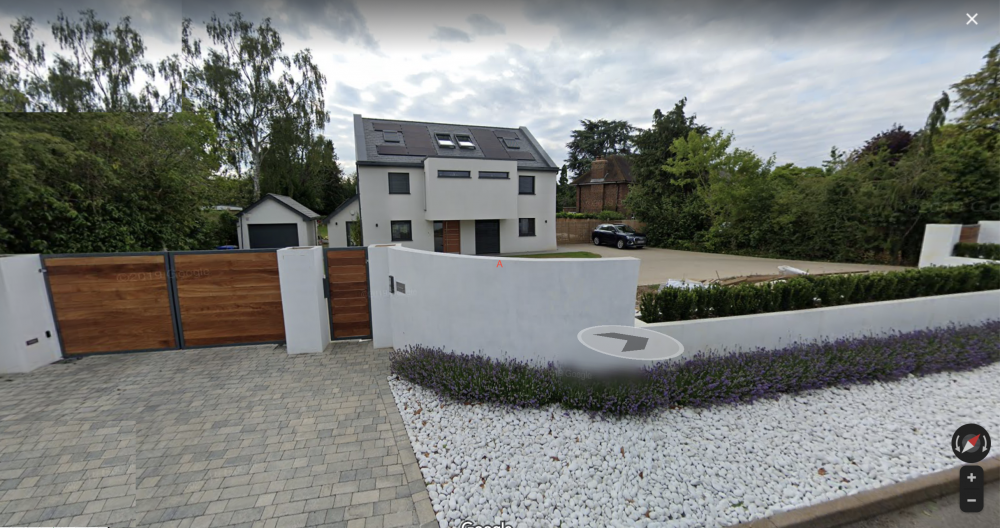

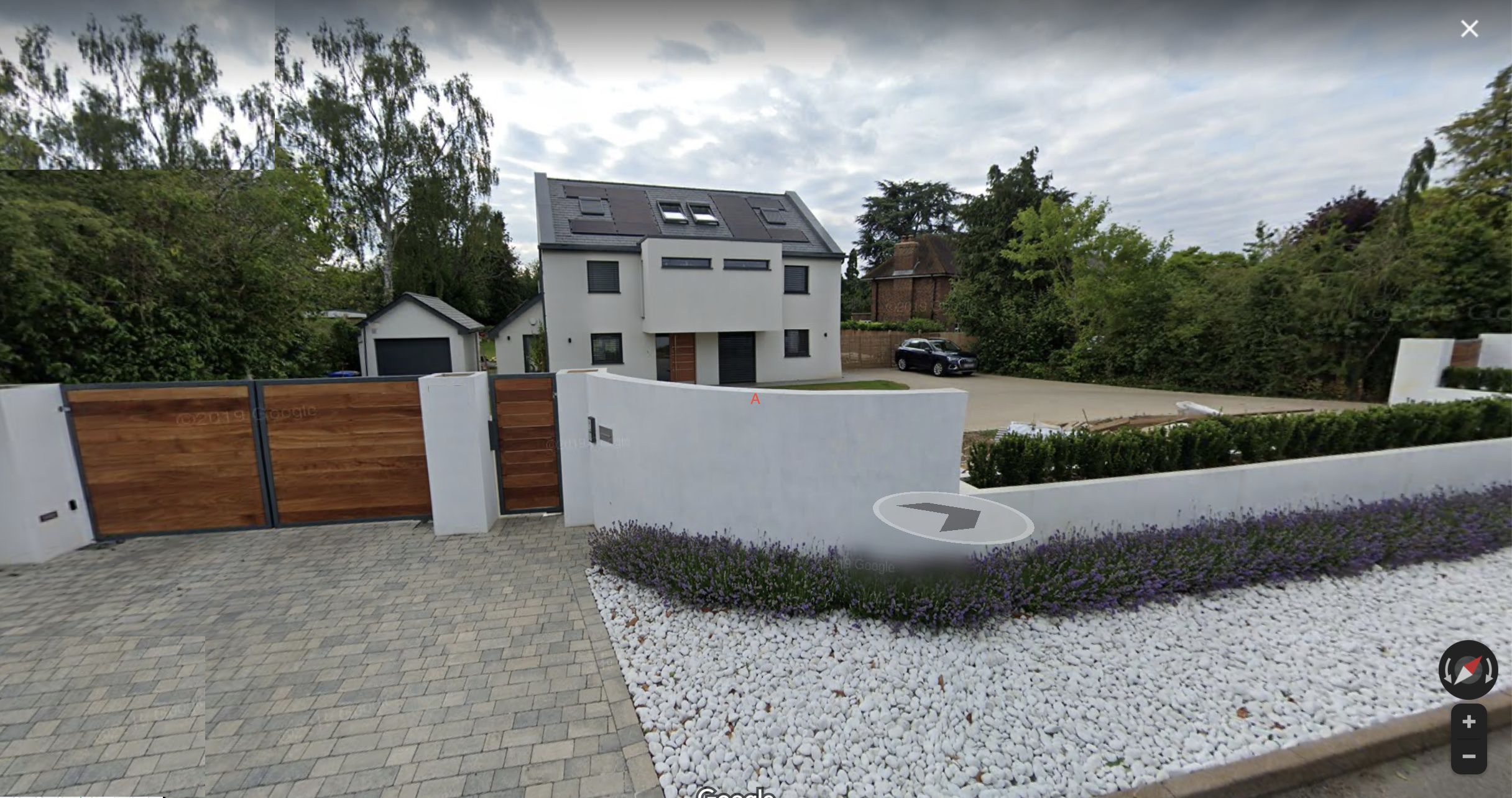

Unless you're in a conservation area or ANOB etc then you should be fine. You will have to make a judgement call on the houses/plots you visit to see how established and uniform the street scene is.
We purchased a 50's red brick detached in-between two nearly identical versions. Rest of street is a bit of a mix.
We got planning for a contemporary white rendered house about 3 times the footprint (ok, 1/3 underground in form of basement).
Neighbours objected but planners did not care that much, we had to compromise on a few features but that's all part of the process.

I must say £650k for 300m2 is too optimistic if you want to hire award winning RIBA architect. You should budget at least £3k/sqm + 20% on top to cover the fee for professionals. (architect, SE, M&E planning consultant etc)
I wanted to stay in London, so I looked the particular area on Google map satellite view and spotted a few opportunities for the land, and luckly ended up buying the garages site directly from the land owner.
This auction site is good one to look at if you are looking for in South East.
https://www.cliveemson.co.uk/properties/
Good luck.

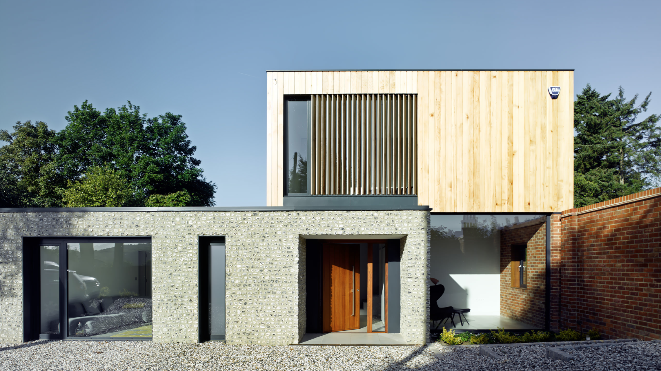

Yes i agree, these reference images are just for inspiration, i'm confident we can build something 'in the style of' for £650k with a good architect, we may need to compromise on size and location of course and be mindful of materials and finishes.

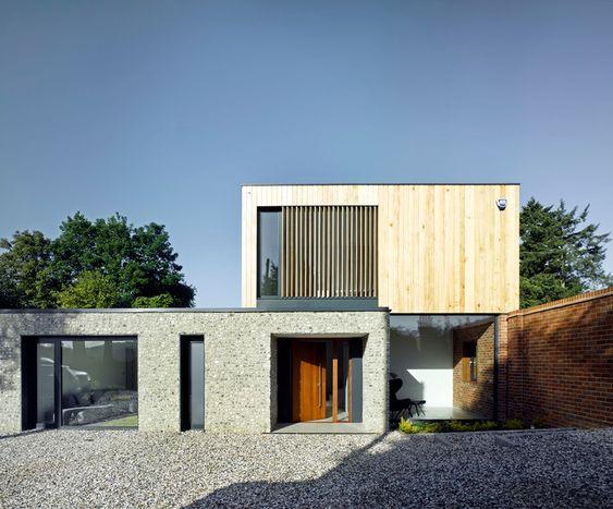

The top image is by an architect company in the UK whose build's start at £3.5k per sqm!
However the fourth image down has a 'contract value' listed as £750k on the architects website.
What does 'contract value' actually stand for by the way, is this the total cost to design and build?
Edited by bpk101
"Contact value" is usually the build cost, the contract sum total to the contractor. Usually all the professional fees (%) are based on this figure.
You need to budget this and +20% on top (if the contract value is £750k then £150k) for the architect, structural engineer, M&E, QS, building control, planning fee, party wall fee.
Some of the modern one-off houses cost far more to build than the final value and are considered niche.  Have a good look around for existing ones and I think you could save a lot of hassle and money.
