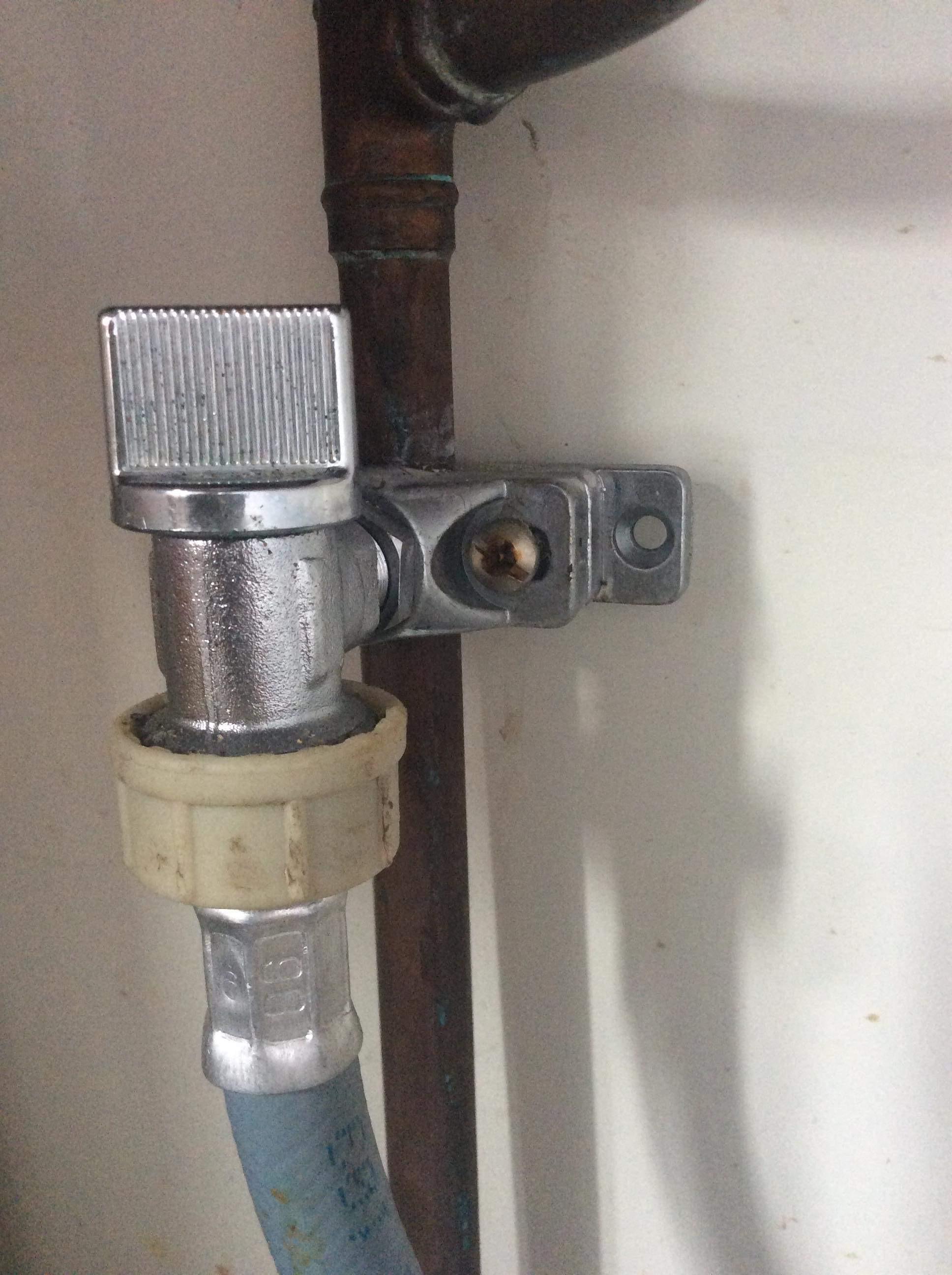

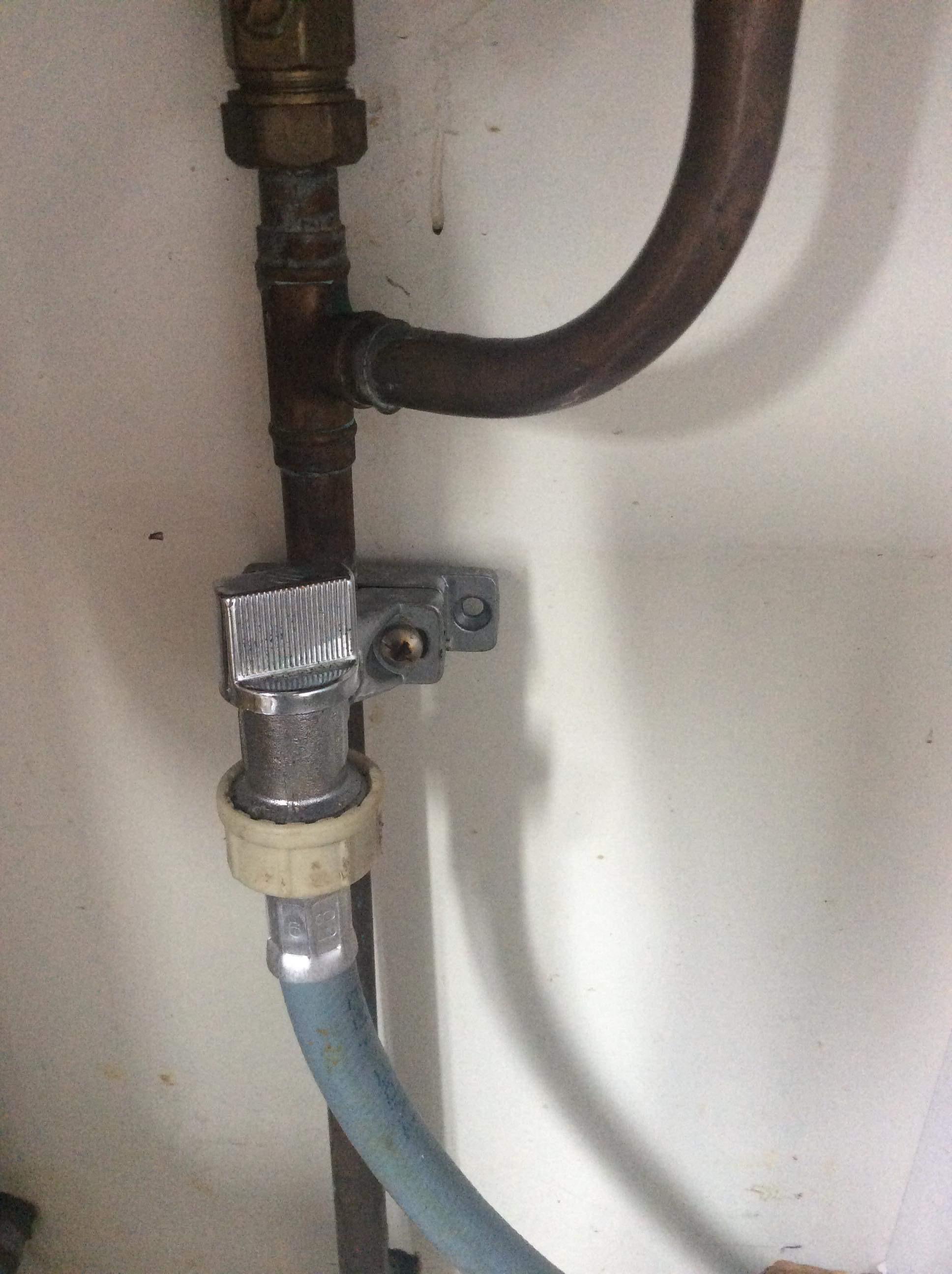

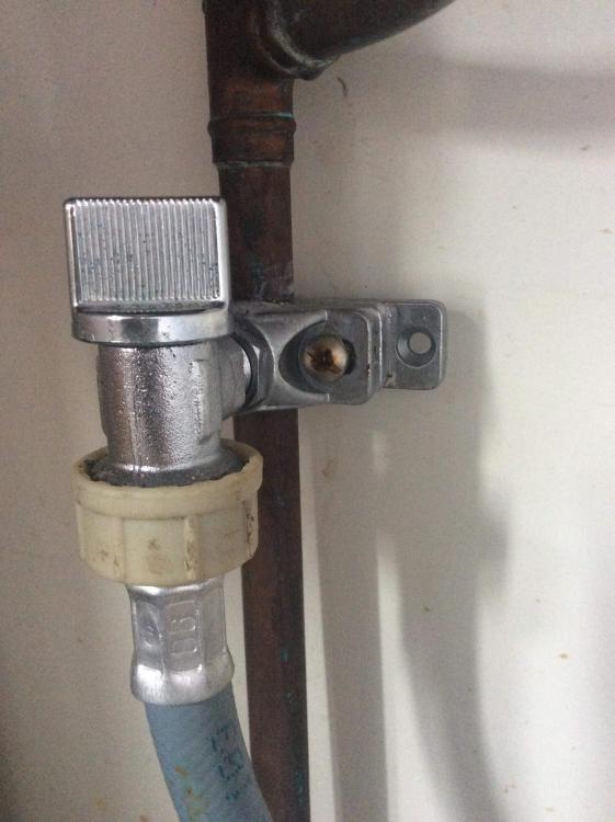

recoveringbuilder Posted September 19, 2020 Share Posted September 19, 2020 My friend has sold her flat and is preparing to move however she has to remove her dishwasher as it’s not working so she cannot leave it behind, her problem is the way it’s connected (see pictures) , her son believes this to be a self cutting valve and is unsure how to proceed. I’ve only seen the photos but my thinking is the silver bit at the top should turn off the supply therefore she could then remove the dishwasher hose without having a flood on her hands, she says this bit does turn so am I correct in my assumption? Link to comment Share on other sites More sharing options...
Alexphd1 Posted September 19, 2020 Share Posted September 19, 2020 Yeah, the top bit will rotate a quarter turn which will close the valve. 1 Link to comment Share on other sites More sharing options...
Onoff Posted September 19, 2020 Share Posted September 19, 2020 Yep. Turning the silver bit should isolate. Then unscrew the off white plastic bit. Have a washing up bowl ready as you'll likely get some water come out of the pipe. Go gentle removing that pipe as those self cutting valves are crap. Clip the removed hose to the clips on the back of the wm. 1 Link to comment Share on other sites More sharing options...
MJNewton Posted September 19, 2020 Share Posted September 19, 2020 (edited) ...and if the valve refuses to fully stop the water despite being closed then screw on a blanking cap. (I prefer to do that anyway with any unused valves for belt and braces) Edited September 19, 2020 by MJNewton 3 Link to comment Share on other sites More sharing options...
recoveringbuilder Posted September 19, 2020 Author Share Posted September 19, 2020 7 minutes ago, MJNewton said: ...and if the valve refuses to fully stop the water despite being closed then screw on a blanking cap. (I prefer to do that anyway with any unused valves for belt and braces) I had thought of that , her son is usually quite handy but he is a bit wary about starting screwing at it in case he ends up with the whole thing coming out! Link to comment Share on other sites More sharing options...
SteamyTea Posted September 20, 2020 Share Posted September 20, 2020 Tie a knot in the flexible pipe. Link to comment Share on other sites More sharing options...
Nickfromwales Posted September 20, 2020 Share Posted September 20, 2020 3 hours ago, SteamyTea said: Tie a knot in the flexible pipe. Try doing that lol. Just use kitchen roll to plug the flexi until it’s outside then lay it on its back to drain it fully. Link to comment Share on other sites More sharing options...
