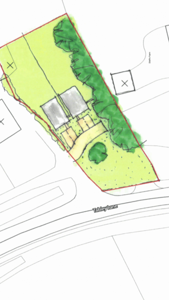

scottishjohn Posted September 20, 2020 Posted September 20, 2020 I would suggest you invest £2-300 in a topographical survey -don,t rely on the one they have done for thier planning before i have what i have now i looked at a plot for 2 houses planning passed ETC WITH PLANS I did my own topo survey and found they were way off anyway -some one has now bought it and have spent 4 weeks pecking rock out to get the plot down to heights on plan and it still is not there rotten rock 2 ft under soil --so how they ever did the percolation tests for the septic system- or going to fit drains etc So i am guessing another plan will be drawn up soon the answer is they did not --and knew it would only come to light once anyone started building so beware of other peoples plans
