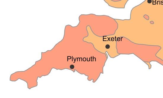

Moonshine Posted September 17, 2020 Share Posted September 17, 2020 Following on from this thread I am have a dilemma and keep going round in circles to which one to build. Build a masonry cavity wall (rendered) with PIR and a residual cavity (125mm total cavity), or fully filled 150mm cavity. Both have the same U value, and I am in a severe wind driven rain area. Which one would choose and why? Link to comment Share on other sites More sharing options...
joe90 Posted September 17, 2020 Share Posted September 17, 2020 As per your last post, I have 200mm full fill with batts, BBA certified for full fill, I know it does not wick moisture, easy to fit lt can be stuffed in awkward corners, does not need accurate fitting/glued/foamed, and yours is rendered mine is brick. No brainier . (IMO). Link to comment Share on other sites More sharing options...
joe90 Posted September 17, 2020 Share Posted September 17, 2020 5 minutes ago, Moonshine said: Both have the same U value, and I am in a severe wind driven rain area. so am I!? Link to comment Share on other sites More sharing options...
Moonshine Posted September 17, 2020 Author Share Posted September 17, 2020 47 minutes ago, joe90 said: so am I!? Aren't you in the very severe exposure zone? Link to comment Share on other sites More sharing options...
joe90 Posted September 17, 2020 Share Posted September 17, 2020 56 minutes ago, Moonshine said: Aren't you in the very severe exposure zone? YES!,!,,!,,,,,!, Link to comment Share on other sites More sharing options...
SteamyTea Posted September 17, 2020 Share Posted September 17, 2020 2 hours ago, joe90 said: YES!,!,,!,,,,,!, and you are about 150 m high. Link to comment Share on other sites More sharing options...
joe90 Posted September 17, 2020 Share Posted September 17, 2020 3 minutes ago, SteamyTea said: and you are about 150 m high. well I didn’t know that, I just know it’s very flat! Link to comment Share on other sites More sharing options...
