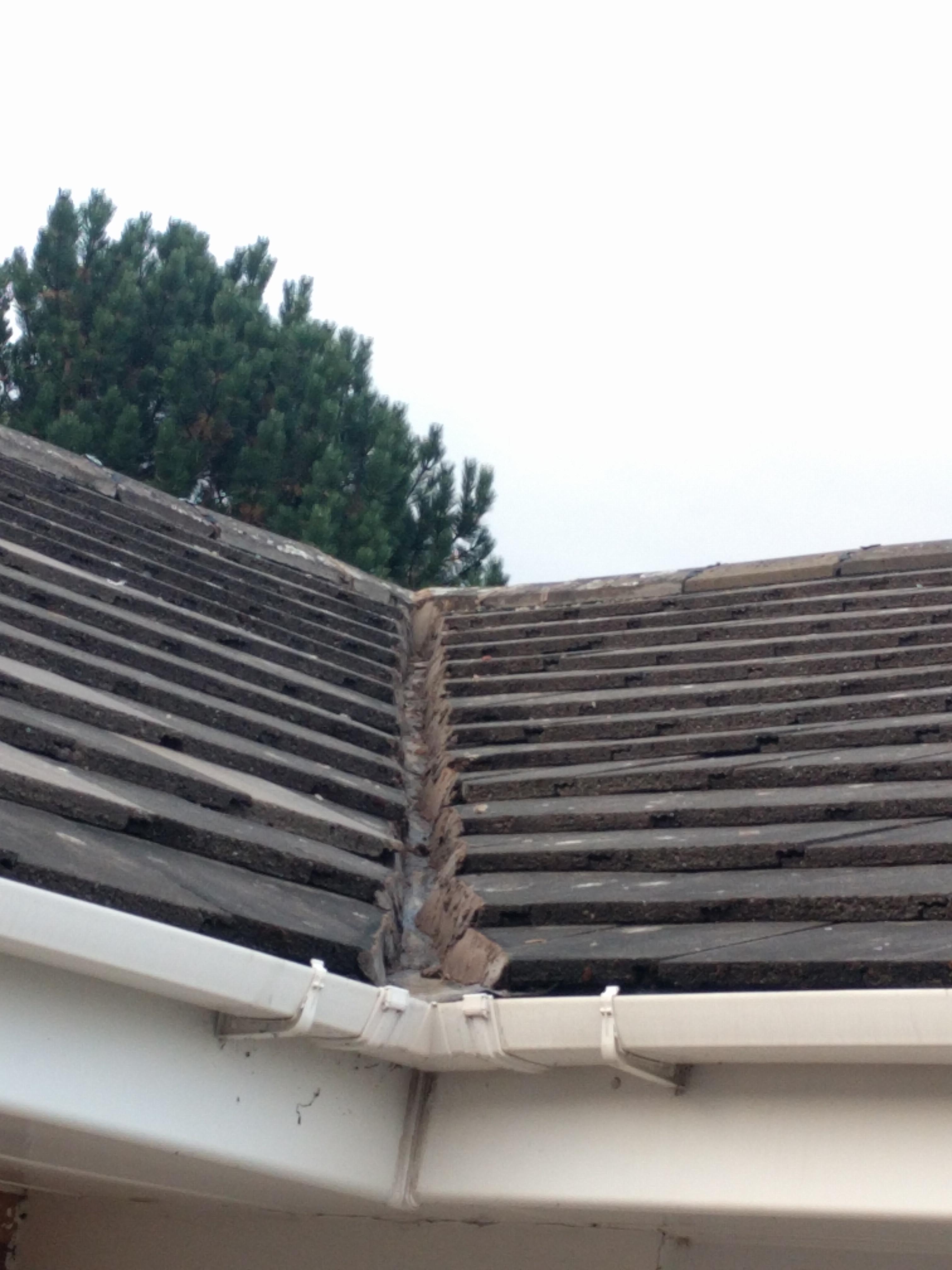

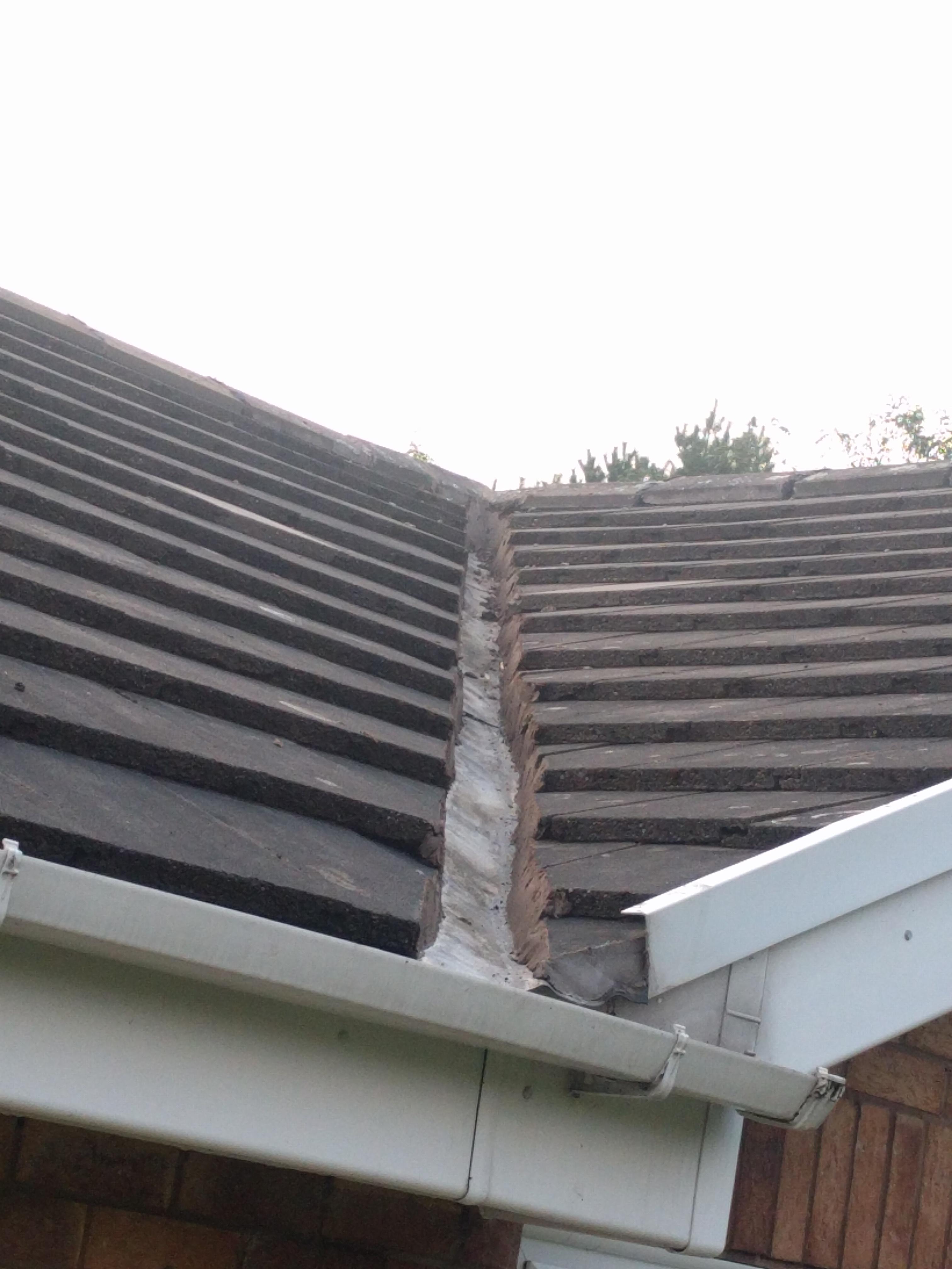

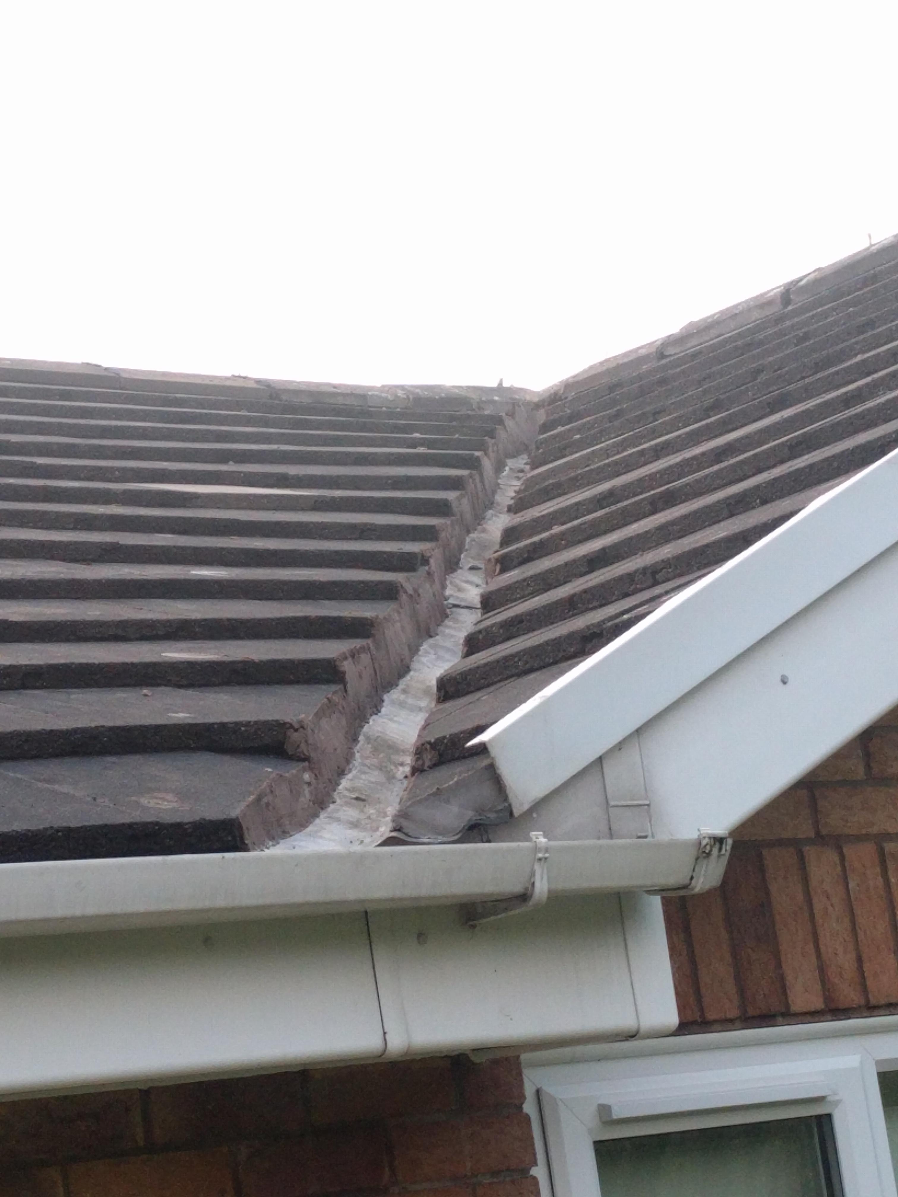

BobAJob Posted October 5, 2020 Author Share Posted October 5, 2020 What do you think of this valley pointing work? Link to comment Share on other sites More sharing options...
Declan52 Posted October 5, 2020 Share Posted October 5, 2020 That's not pointing. That's smoothing mortar with the back of a shovel. Not good and For the few seconds extra it would have taken to smooth that out. 1 Link to comment Share on other sites More sharing options...
BobAJob Posted October 5, 2020 Author Share Posted October 5, 2020 New roofer has suggested ripping all the mortar pointing out and redoing them. Both valleys. £1300 which seems expensive. He'll also replace the 4 cracked tiles on the first valley that the previous roofer decided not to replace. The quote also includes taking the ridge tiles at the top of the valleys off, reseating and remortaring them. I feel so disappointed and let down by the original roofer. We hired him to redo the mortar in the valleys and clean some moss of the roof and then it turned into badly fitting a dry ridge system and not doing the valleys properly either and now I find out the roofer has a bad reputation locally and has been known to get violent. All we wanted was a relatively simple job done and now it's a mess and will cost us more to put right. Link to comment Share on other sites More sharing options...
makie Posted October 5, 2020 Share Posted October 5, 2020 1 hour ago, BobAJob said: What do you think of this valley pointing work? It's terrible, I could do that better and we don't use cement in valleys much in Scotland. 1 hour ago, BobAJob said: New roofer has suggested ripping all the mortar pointing out and redoing them. Both valleys. £1300 which seems expensive. Seems steep but would depend on where you are based, how busy the roofer is etc Get 3/4 quotes and make a decision from there. Link to comment Share on other sites More sharing options...
BobAJob Posted October 5, 2020 Author Share Posted October 5, 2020 30 minutes ago, makie said: It's terrible, I could do that better and we don't use cement in valleys much in Scotland. Seems steep but would depend on where you are based, how busy the roofer is etc Get 3/4 quotes and make a decision from there. Do you think it needs ripping out? The new roofer said he may have to completely rebuild the valley, which sounds expensive to me. Link to comment Share on other sites More sharing options...
Declan52 Posted October 5, 2020 Share Posted October 5, 2020 5 minutes ago, BobAJob said: Do you think it needs ripping out? The new roofer said he may have to completely rebuild the valley, which sounds expensive to me. Think he is maybe worried about what else he will find if he starts to remove mortar. If the lead is ok, no holes and nailed with copper nails, and it's turned up properly under the tiles then it's only some sand and cement. A string line from top to bottom would have been a good idea to keep the edge straight. That's been done by eye and that person must have a squint. The problem is the mortar is hopefully packed in enough so it will last a few years so its just a question can you live with it as it sits as long as the rain will run down the lead. Or every time you walk by will you look up and get a tad angry with yourself for not fixing it. Link to comment Share on other sites More sharing options...
BobAJob Posted October 5, 2020 Author Share Posted October 5, 2020 18 minutes ago, Declan52 said: Think he is maybe worried about what else he will find if he starts to remove mortar. If the lead is ok, no holes and nailed with copper nails, and it's turned up properly under the tiles then it's only some sand and cement. A string line from top to bottom would have been a good idea to keep the edge straight. That's been done by eye and that person must have a squint. The problem is the mortar is hopefully packed in enough so it will last a few years so its just a question can you live with it as it sits as long as the rain will run down the lead. Or every time you walk by will you look up and get a tad angry with yourself for not fixing it. It's not lead in the valleys. It's some kind of thick plastic. I think the lead was replaced many years ago. Link to comment Share on other sites More sharing options...
