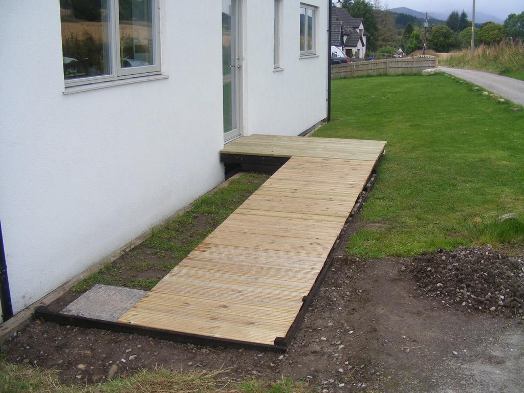

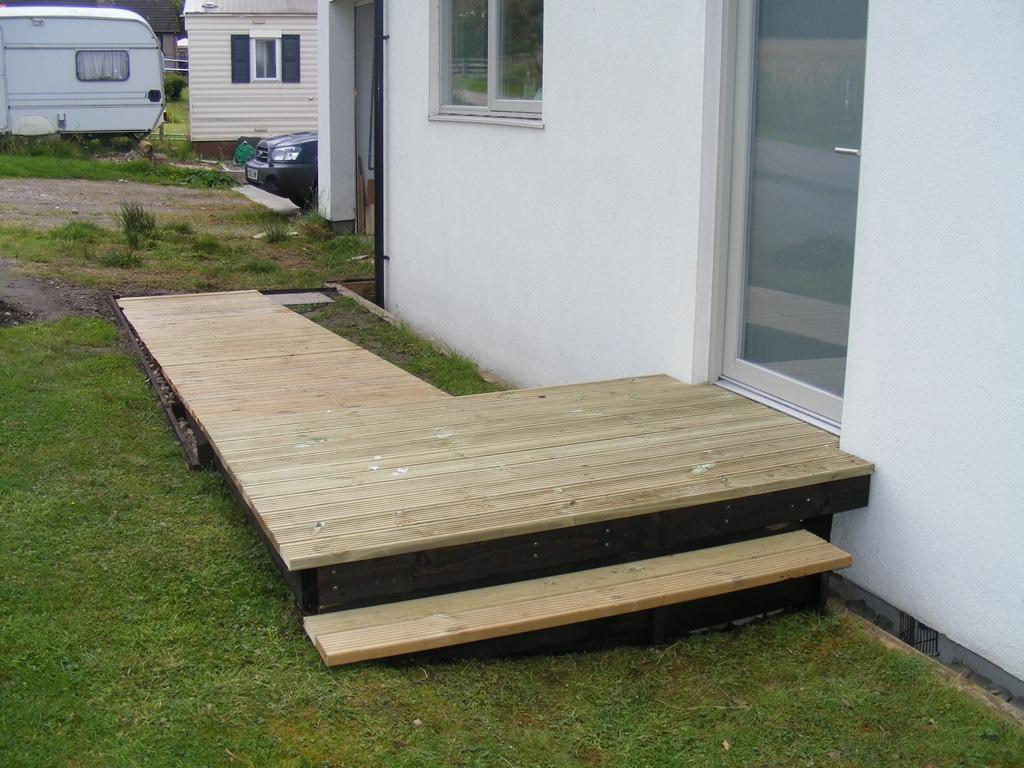

ProDave Posted September 10, 2020 Posted September 10, 2020 Another project long in the making finally completed today after finally managing to find some more boards yesterday. It's a timber ramp, built as a permanent structure, so hopefully it won't get shot down by building control. The sloping part is made with non slip deck boards while the flat part is standard deck boards. The flat area at the top of the ramp is 1.5 metres by 2 metres, way more that the required 1.2 metres square. I was conscious that a structure like this could be prone to rot, so the area under the ramp was dug out, so the joists are not sat on the ground, but supported by a number of posts concreted in. Where the grass adjoins the ramp, a sacrificial strip of wood has been attached, spaced off from the joists and the soil / grass only touches that, not the joists, and the gap between them is filled with loose stones. The slope of the ramp is a lot shallower than it could be, I basically took the length I had available and made the ramp that long to make it a gentle slope. 1
Onoff Posted September 10, 2020 Posted September 10, 2020 So you don't have to have handrail, kickboards etc to stop the partially sighted, wheelchair or infirm taking a tumble?
the_r_sole Posted September 10, 2020 Posted September 10, 2020 You'll have to slope the ground up to it around it or put an edge/handrail around that for building standards (it's amazing how often they dissappear after completion...

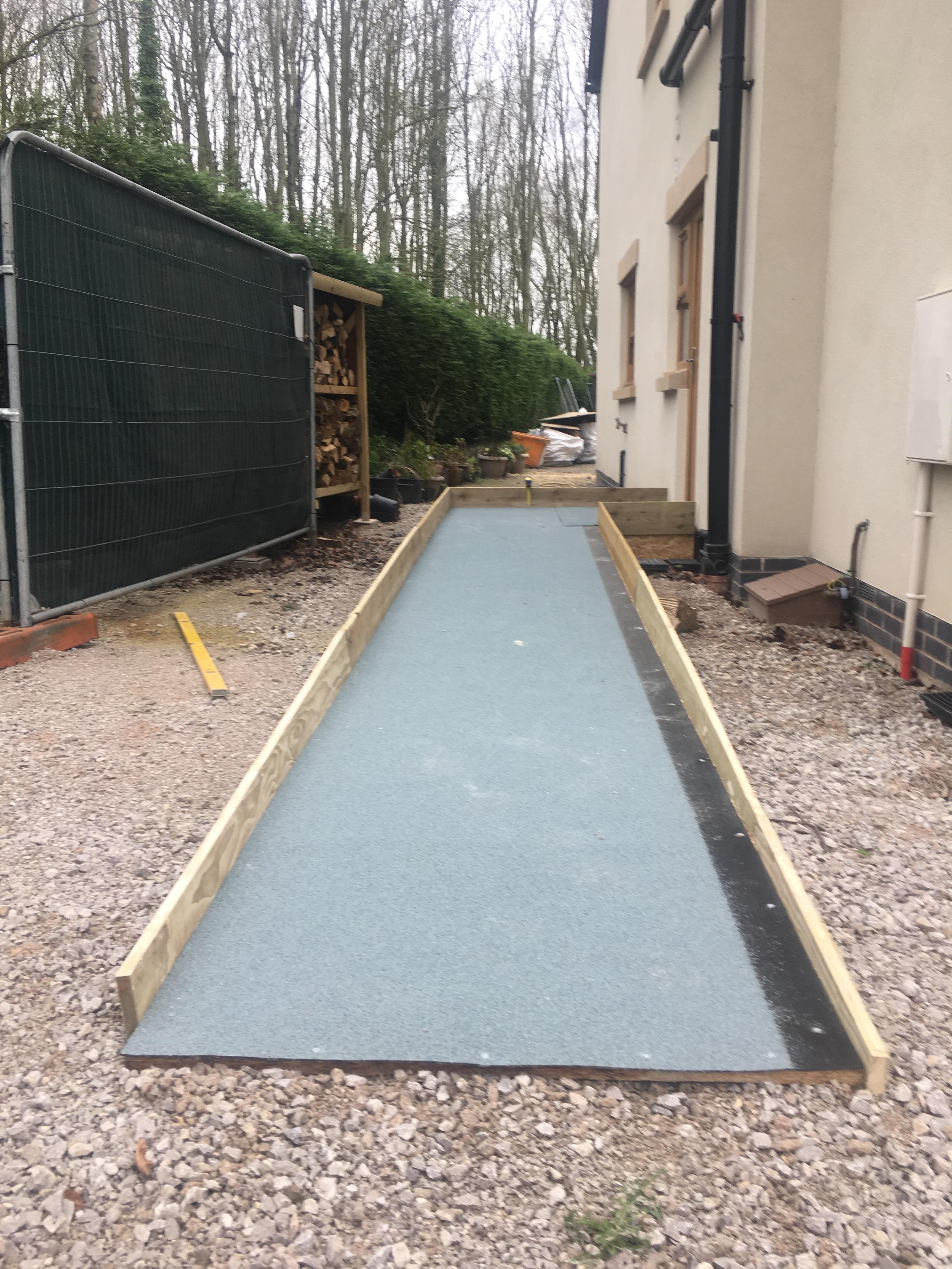

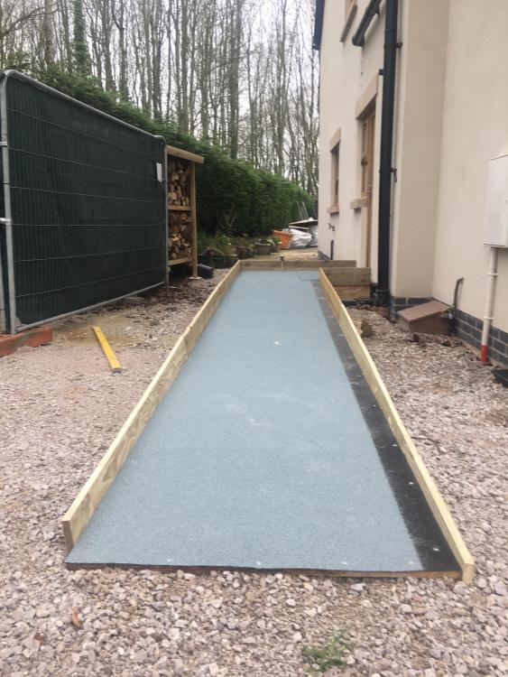

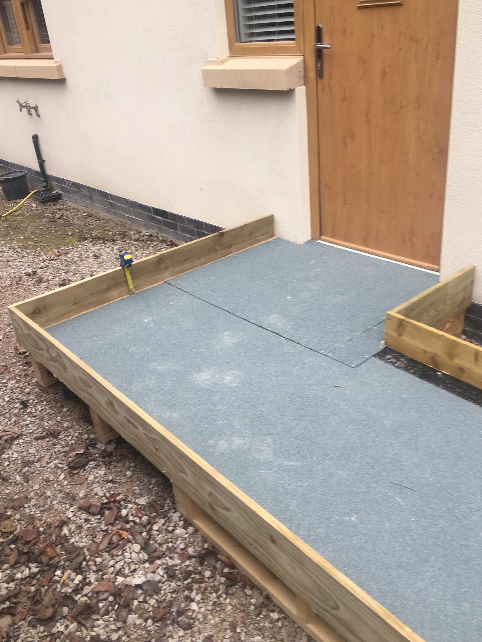

nod Posted September 10, 2020 Posted September 10, 2020 2 hours ago, ProDave said: Another project long in the making finally completed today after finally managing to find some more boards yesterday. It's a timber ramp, built as a permanent structure, so hopefully it won't get shot down by building control. The sloping part is made with non slip deck boards while the flat part is standard deck boards. The flat area at the top of the ramp is 1.5 metres by 2 metres, way more that the required 1.2 metres square. I was conscious that a structure like this could be prone to rot, so the area under the ramp was dug out, so the joists are not sat on the ground, but supported by a number of posts concreted in. Where the grass adjoins the ramp, a sacrificial strip of wood has been attached, spaced off from the joists and the soil / grass only touches that, not the joists, and the gap between them is filled with loose stones. The slope of the ramp is a lot shallower than it could be, I basically took the length I had available and made the ramp that long to make it a gentle slope. Ours just asked me to add 100 mill bumpers and make sure the platform in front of the door is level both ways Should sail through 1
nod Posted September 10, 2020 Posted September 10, 2020 2 hours ago, Onoff said: So you don't have to have handrail, kickboards etc to stop the partially sighted, wheelchair or infirm taking a tumble? Kick boards yes Hand rail no As it’s wheel chair access
the_r_sole Posted September 10, 2020 Posted September 10, 2020 18 minutes ago, nod said: Ours just asked me to add 100 mill bumpers and make sure the platform in front of the door is level both ways Should sail through They don't always like the bumpers, it's just your luck, I've seen some interesting ramps put in for completion inspections ?
nod Posted September 10, 2020 Posted September 10, 2020 47 minutes ago, the_r_sole said: They don't always like the bumpers, it's just your luck, I've seen some interesting ramps put in for completion inspections ? Flying colours ?

ProDave Posted September 10, 2020 Author Posted September 10, 2020 If they want bumpers, I will fit them. then remove them after completion as I think they are a trip hazard.
nod Posted September 10, 2020 Posted September 10, 2020 14 minutes ago, the_r_sole said: You're on the list @nod with that ? Two different building BC where impressed with it One tried to lift it Both had to concede that it did indeed qualify as a DA All be it temporary It was on the non fire the following day 1 1
