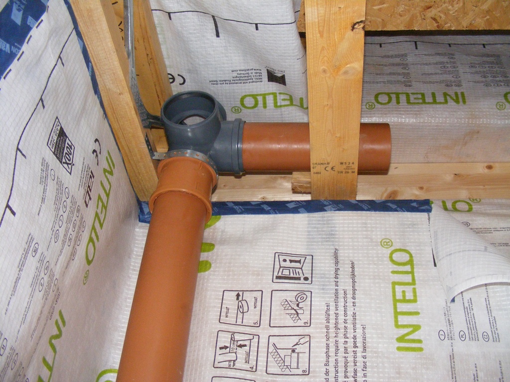

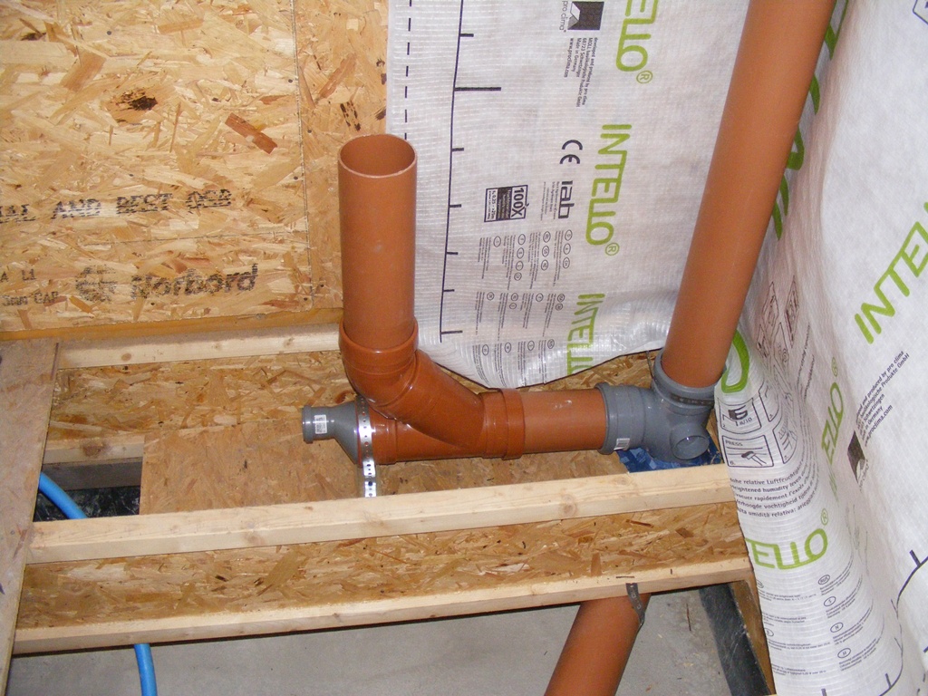

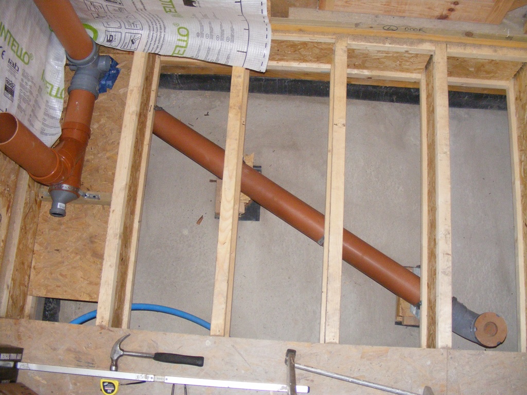

ProDave Posted February 1, 2017 Author Posted February 1, 2017 You wanted some pictures..... That's the stack rising in the right hand corner. you can see the branch under the floor that leads to the "provision for a shower" drain point. To the left of that is the riser for the WC, the branch and 45 degree bend just fit within the floor make up, allowing for the UFH build up, so the socket of the 45 degree bend will be a few mm above FFL. The 50mm will continue left about a metre before turning upwards to come up under the sink unit. (I don't have any 50mm yet) Looking down from above, that's the branch for the shower. It will remain capped in the joist space and will only ever get connected to if anyone installs a downstairs shower. And the top of the stack. That's the corner branch that started the thread, Left hand outlet will feed toilet #1 and the right hand outlet will branch again to feed toilet #2 2
Onoff Posted February 1, 2017 Posted February 1, 2017 Erm.....I think Nick meant photos of your copper plumbing! V.neat & tidy though!

joe90 Posted February 2, 2017 Posted February 2, 2017 Nice work on the underfloor plumbing, that's what I think I would have done. I am on my site today putting my first fix soil pipes in whilst the builders are putting the I joists down so I can feed the pipes through the webs as you can't do it afterwards.
