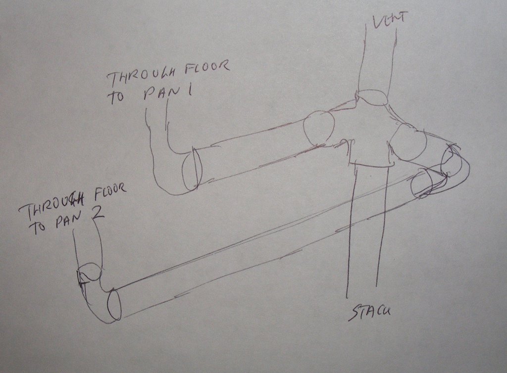

ProDave Posted January 7, 2017 Share Posted January 7, 2017 I have been putting up the stud walls that define the bathroom and en-suite rooms. That means having a think about the layout of both rooms so I know everything will fit and the doors are in the right place etc. At the same time I have been thinking about how I will plumb all the wastes, and have hit a problem. I can't seem to find the waste fitting that I will need. I will try do describe it: Imagine the 110mm waste stack coming up from the room below (the utility room) right in the corner. as you stand looking at that corner, I want one 110mm pipe to branch left along the front wall of the house to serve one toilet, and I want another 110mm pipe to branch off to the right, along the side wall of the house to serve the other toilet. So I need a 110mm branch that will take TWO 110mm pipes in at 90 degrees to each other. I can't find one. I have seen a double branch with inputs 180 degrees apart, but not 90 degrees apart. It has to be all in one fitting as I want both branches to travel to their respective WC's within the posi joists, so stacking two branches one above the other won't work. Any ideas? Link to comment Share on other sites More sharing options...

ProDave Posted January 7, 2017 Author Share Posted January 7, 2017 I can't see that happening unless the stack is not well ventilated. One toilet will be close to the branch, the other about 3 metres away. the two branches will run within the posi joists then turn 90 degrees to go up through the floor to each pan. What I want to avoid is the two toilets sharing a common horizontal pipe run. that's why I want them to branch at the stack. Link to comment Share on other sites More sharing options...
Nickfromwales Posted January 7, 2017 Share Posted January 7, 2017 You mean a corner branch ? http://m.ebay.co.uk/itm/111911500778?_mwBanner=1 1 Link to comment Share on other sites More sharing options...
ProDave Posted January 7, 2017 Author Share Posted January 7, 2017 That's exactly what I mean. as usual it's a case of knowing the correct name for what to search for. I had a feeling it must exist, I could see no reason why someone could not make one, but I have never seen one, and they are not in the common places like TP, Screweys, toolstation unfortunately, that one "does not post to Scottish Highland" But I see several people selling the same thing, so I am sure one of them will post it here. Question. Looking at that, it appears both branches are push fit with a ring seal, but why are the details of the two branches different? Link to comment Share on other sites More sharing options...

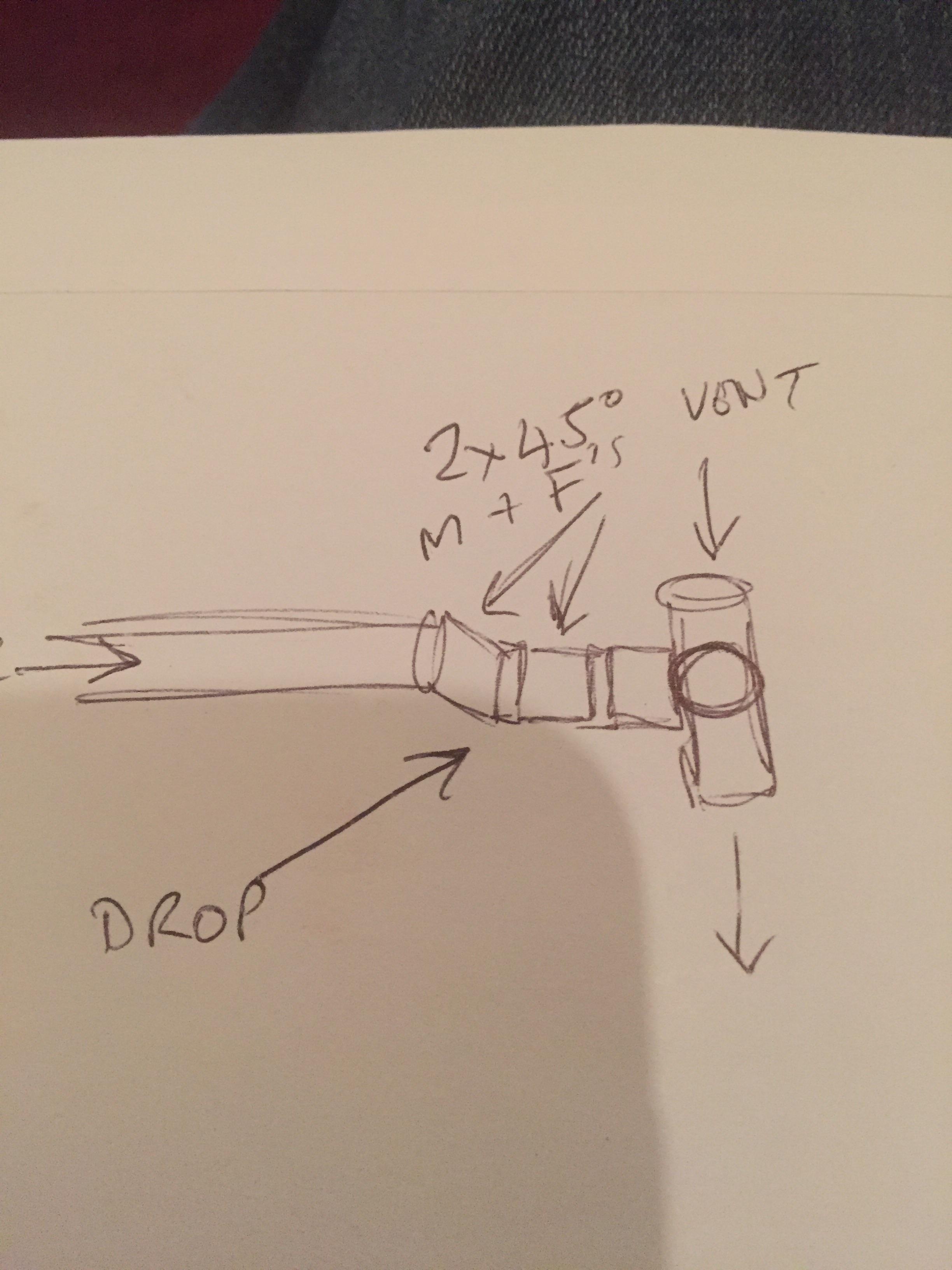

Nickfromwales Posted January 7, 2017 Share Posted January 7, 2017 Fack knows Check out this bad boy. Come out of this with two M&F bends to rectify back to horizontal and then you'll have no issues with what Joe mentioned ( which is with merit I assure you ). 1 Link to comment Share on other sites More sharing options...

Nickfromwales Posted January 7, 2017 Share Posted January 7, 2017 I think these would do it. Make the branch lower than the soil so you deffo don't get any cross flow. TBH, that issue is more problematic with a 180o offset rather than a corner branch, but if it was me ( and more importantly you have the room / distance ) I'd still endeavour to 45 into it to make a 'sump' at the branch. Link to comment Share on other sites More sharing options...

ProDave Posted January 7, 2017 Author Share Posted January 7, 2017 Well I have just ordered one of Nick's first link, but from a different ebay seller. And it was a bit cheaper. I can see the "swapping contents" issue if you just branch at pan outlet level, and have two very short runs to the two pans, but I am branching under the floor, 2 runs under the floor then each turning up and through the floor to it's respective pan. I HOPE I won't be starting a "swapping contents" thread in the future when it eventually all goes live. Link to comment Share on other sites More sharing options...

ProDave Posted January 7, 2017 Author Share Posted January 7, 2017 My drawing skills are not as good as Nick, but this is what I want to achieve: the left hand branch follows the front of the house (in between two joists) and then turns 90 degrees up through the floor to pan 1. the right hand branch travels a short distance, through one or possibly two posi joists, before turning 90 degrees to run between joists, then turning up 90 degrees to go up to pan 2 in the other bathroom adjacent. I can't see there being a "swapping incident" Link to comment Share on other sites More sharing options...
Nickfromwales Posted January 7, 2017 Share Posted January 7, 2017 25 minutes ago, ProDave said: I can see the "swapping contents" issue if you just branch at pan outlet level, and have two very short runs to the two pans, but I am branching under the floor, 2 runs under the floor then each turning up and through the floor to it's respective pan. That'll be fine. And unless the invert is in excess of 1300mm, you really don't need anything for air admittance at the pans, just a vent or AAV at the top of the branch. Link to comment Share on other sites More sharing options...

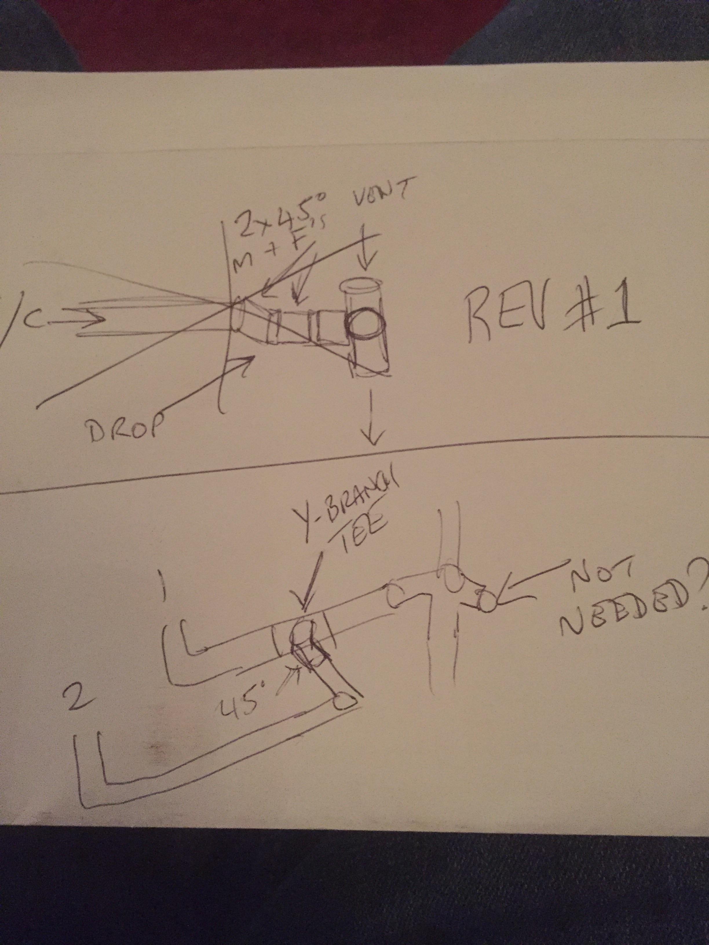

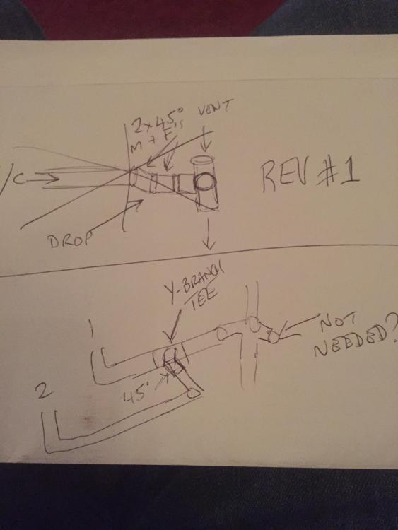

ProDave Posted January 7, 2017 Author Share Posted January 7, 2017 I thought if I did that, then when you flush pan 2 it might suck pan 1's trap dry unless you have another AAV. I thought it best to not have any shared horizontal runs? Link to comment Share on other sites More sharing options...

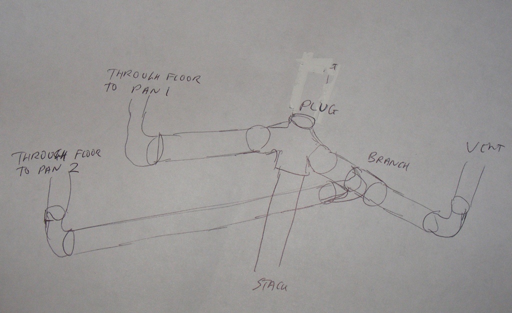

ProDave Posted January 7, 2017 Author Share Posted January 7, 2017 Another revision, would moving the vent cause an issue: Taking the vent straight up, would mean more "boxing in" If instead, I made the turn to pan 2 a branch, that could then continue and turn upwards to the vent through a bit that is already being boxed in. Would that cause issues? Link to comment Share on other sites More sharing options...
Nickfromwales Posted January 7, 2017 Share Posted January 7, 2017 9 hours ago, ProDave said: I thought if I did that, then when you flush pan 2 it might suck pan 1's trap dry unless you have another AAV. I thought it best to not have any shared horizontal runs? It would never happen. As soon as the slug of water has cleared the first bend you'll get what's called an "air break". That means the water cannot physically occupy the whole diameter of the pipe and therefore cannot create a vacuum. Vacuum issues are typically only associated with vertical drops after 1m fall or more. I believe ( iirc ) BR are happy with a vertical drop ( invert ) of 1300mm before they require an AAV. The T option ( Y-branch ) will work perfectly well. ? Link to comment Share on other sites More sharing options...
Nickfromwales Posted January 7, 2017 Share Posted January 7, 2017 16 minutes ago, ProDave said: Another revision, would moving the vent cause an issue: Taking the vent straight up, would mean more "boxing in" If instead, I made the turn to pan 2 a branch, that could then continue and turn upwards to the vent through a bit that is already being boxed in. Would that cause issues? That would work. As long as air can get to the vertically falling slug of water then vacuum deficit would be taken care of. No probs with that arrangement, as long as the branch is a Y with a 45 in it to rectify back to 90o. Essentially your then sending the 'products of nourishment' from pan 2 towards the corner branch, rather than stalling at a regular branch and then relying on the fall ( from the vent ) to direct the flow. 1 Link to comment Share on other sites More sharing options...
