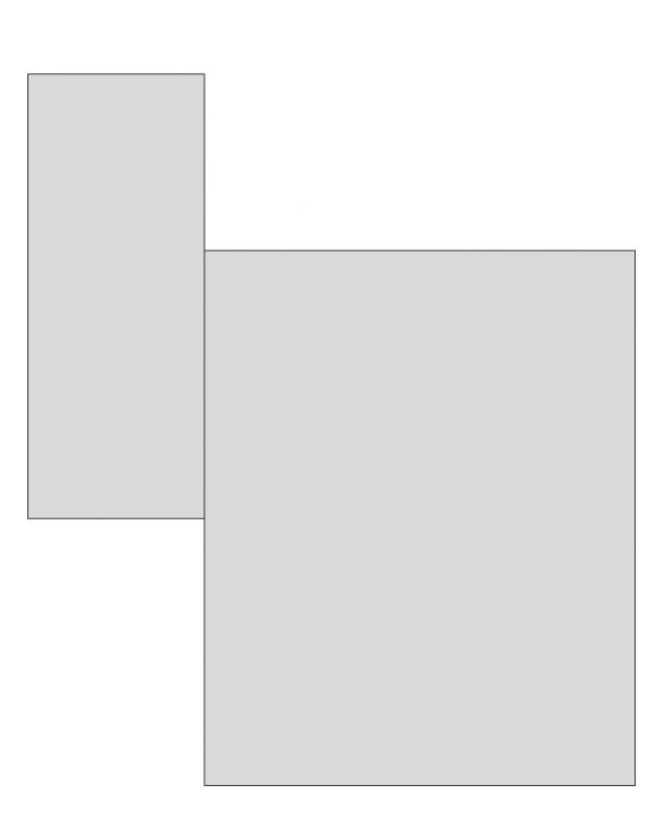

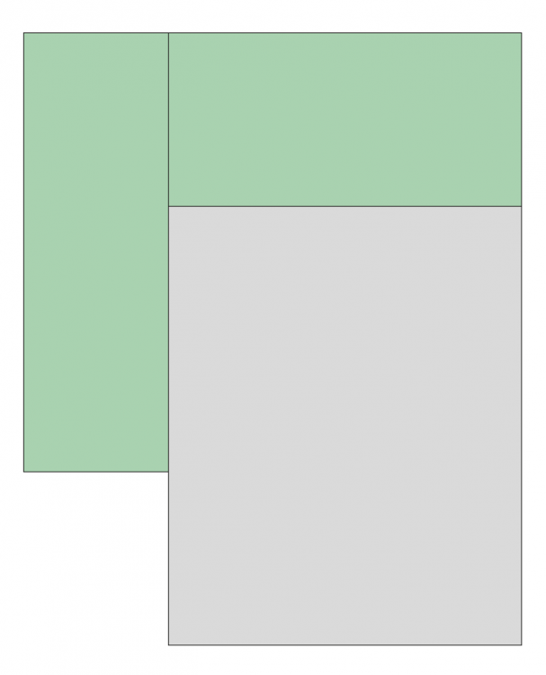

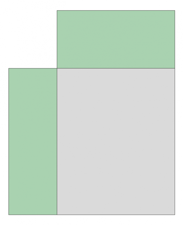

tp1 Posted September 2, 2020 Share Posted September 2, 2020 Hi all Apologies for another newbie question. I am looking to extend out the back and side and am under the impression that a wrap-around extension does not fall under Permitted Development. If I was to extend "separately" out the side and out the back would this be ok (under PD) and would there be much difference in price given its the same size? Neither direction is going beyond 3m from house or should cause any other PD issues) Many thanks in advance Pictures might help: 1. Current house footprint (including old out building to be demolished) 2. Potential wrap-around extension 3. Potential "separate" extensions Link to comment Share on other sites More sharing options...
DevilDamo Posted September 2, 2020 Share Posted September 2, 2020 Some wrap around extensions can be carried out via PD providing they meet the PD criteria for both side and rear extensions, so they’re not completely ruled out. Number 2 would require formal Planning and number 3 would normally be considered PD. That is assuming you are talking about single storey extensions? If so, then if number 2 is your preferred option, what’s stopping you from going down the formal Planning route? Link to comment Share on other sites More sharing options...

Gav_P Posted September 2, 2020 Share Posted September 2, 2020 (edited) No 3 would need formal PP for the side extension. Rear could be done under PD. Of course this is just my opinion... and could be complete tripe. Edited September 2, 2020 by Gav_P Link to comment Share on other sites More sharing options...

Temp Posted September 3, 2020 Share Posted September 3, 2020 (edited) I think a lot depends on if they consider the outbuilding to be part of the original house. Was the outbuioding constructed before 1948?. The original building is defined as... Quote “Original” - means a building as it existed on 1 July 1948 where it was built before that date, and as it was built if built after that date. If before 1948 then option 3 might need planning because you are extending forward of the original front elevation. Eg the outbuilding is not an outbuilding and you are extending it forwards. Edited September 3, 2020 by Temp Link to comment Share on other sites More sharing options...
Gav_P Posted September 3, 2020 Share Posted September 3, 2020 14 hours ago, DevilDamo said: @Gav_P I think you need to read up on the PD rules ? Your quite right.. I was talking complete rubbish. No 3 is obviously achievable by PD. But why would no 2 need PP? Because the side extension projects beyond the rear of the property? Link to comment Share on other sites More sharing options...

DevilDamo Posted September 3, 2020 Share Posted September 3, 2020 3 hours ago, Temp said: option 3 might need planning because you are extending forward of the original front elevation. But there isn't anything stopping the OP from removing the "outbuilding" (although an outbuilding is usually a separate/detached structure) and then building a single storey side extension the full length of the original dwelling. Link to comment Share on other sites More sharing options...
DevilDamo Posted September 3, 2020 Share Posted September 3, 2020 2 hours ago, Gav_P said: But why would no 2 need PP? Because the side extension projects beyond the rear of the property? No but because the extensions would join together meaning the PD rules for side extensions would not be met, i.e. more than half the width of the original house. 1 Link to comment Share on other sites More sharing options...
Temp Posted September 3, 2020 Share Posted September 3, 2020 (edited) 5 hours ago, Gav_P said: Does that matter? The side extension can go as far forward as the building line (front of the house). I believe if built before 1948 the front of the outbuilding would also be considered the front of the original house. See top of page 15 in the technical guide. and the definition of original... “Original” - means a building as it existed on 1 July 1948 where it was built before that date, and as it was built if built after that date. So if built prior to 1948 it doesn't matter if the outbuilding was an extension its considered part of the original building. Edited September 3, 2020 by Temp 1 Link to comment Share on other sites More sharing options...
